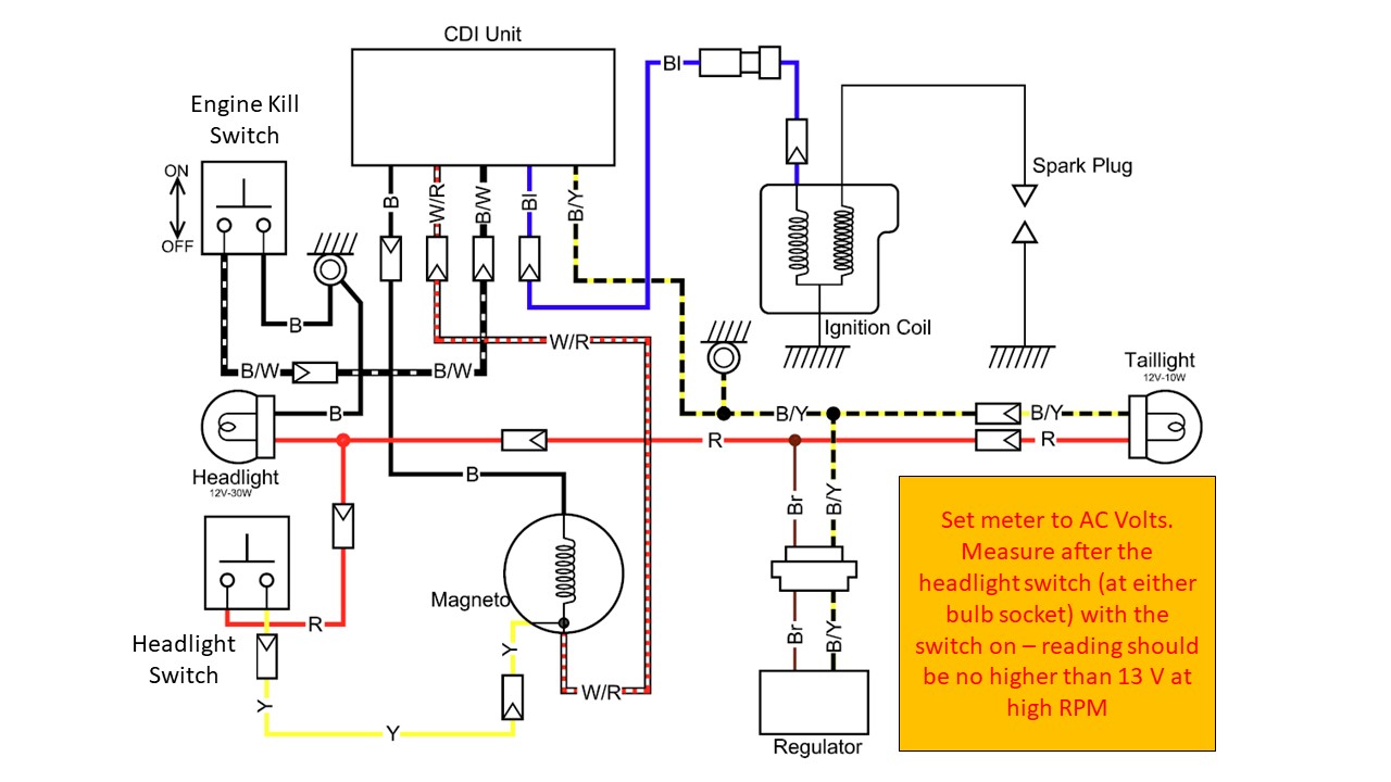

Voltage will be lower at idle, it should not climb much over 12 volts when you rev it, thats the easiest way to check your voltage regulator. It won't keep the voltage from being low (which is why the lights are dim at idle) but will keep you from blowing out bulbs.
KDX Wiring.jpg (118.8 KiB) Viewed 1628 times

Voltage varies SUBSTANTIALLY between idle, 1500rpm, 3000rpm, & 7000rpm. It's only a 35W stator, it barely powers dim incandescent lights. I ran into a wire roll type fence on my 1st KDX because the lighting output was so dim with the stock stator.
If you were getting 36 volts after the regulator, you would blow your light bulbs unless there was a problem with the wiring somewhere that wasn't getting 36 volts to the light bulbs.
You said something about getting 4 volts to the light bulb socket with the switch on, but 0 volts with it off? Your readings leave a bit of information out that is critical, & you didn't mention any voltage reading on the output side of the switch. Are you sure you are testing on AC voltage and not DC on your meter?
