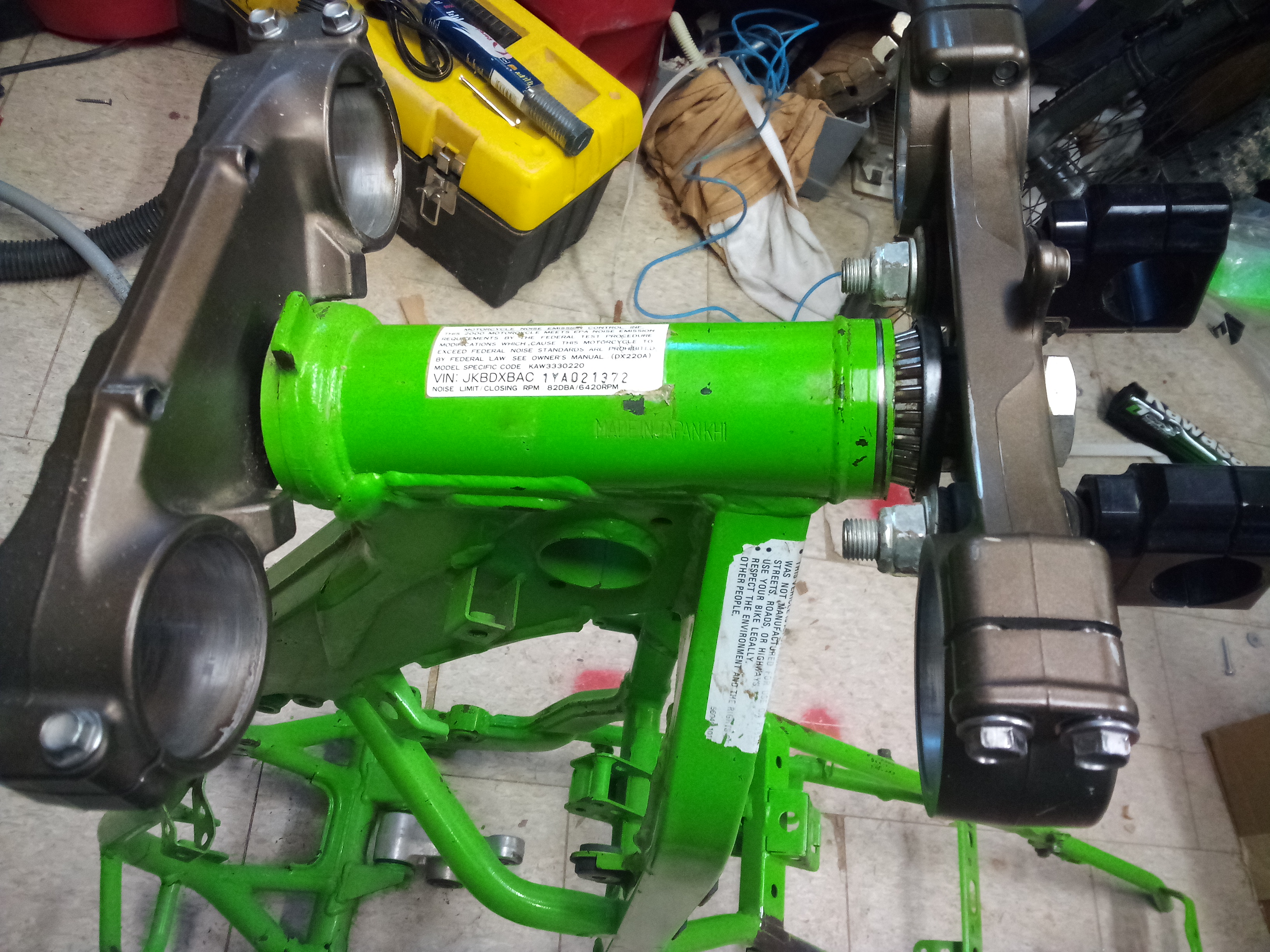

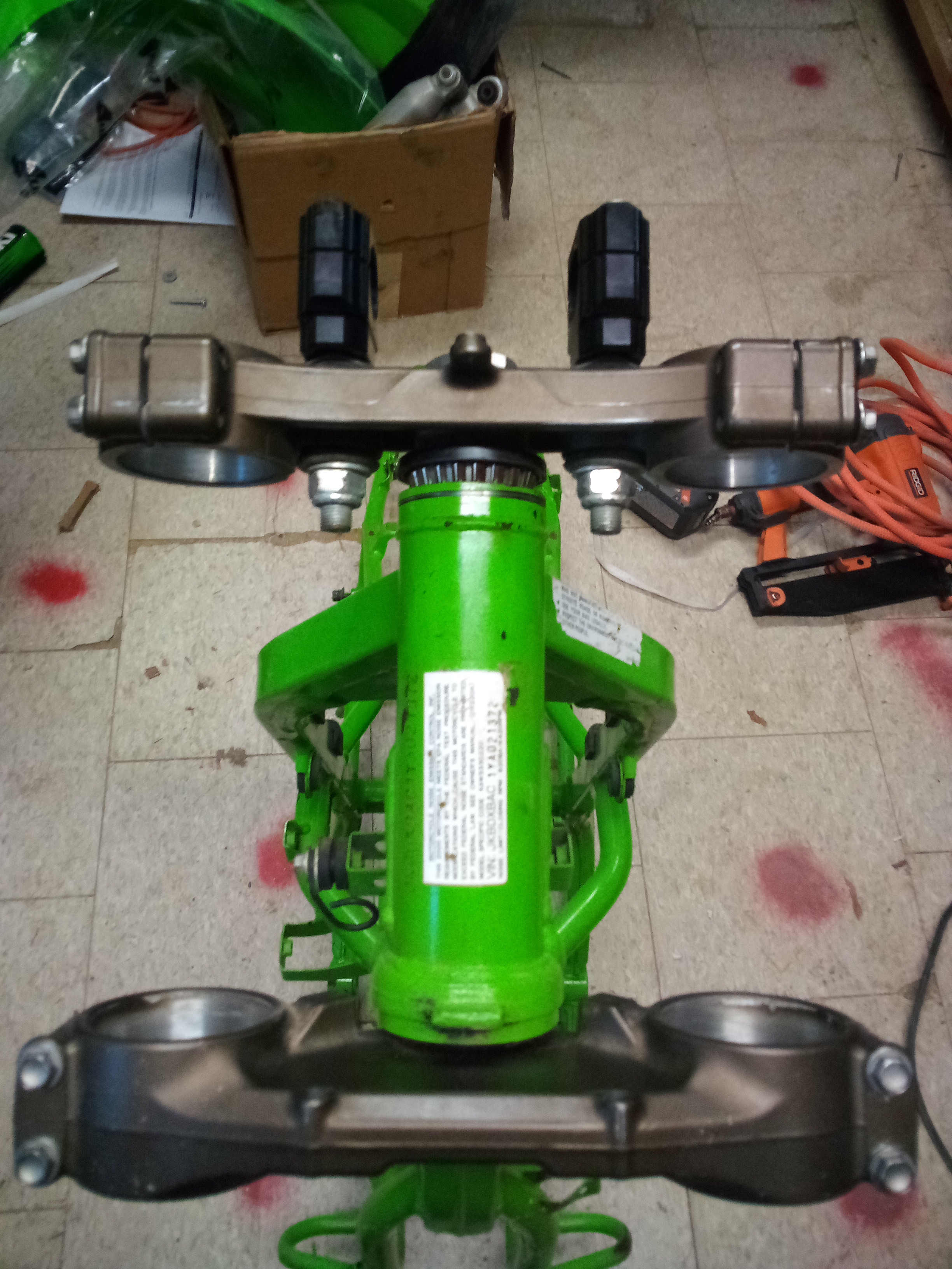

Ok yes the KX450 stem is a tad longer if not the same length. It's hard to know exactly how long either is because they are still pressed into the lower clamps. It does appear that the upper bearing is the first issue and the second would be a simple spacer. Ahh yes I noticed that on RBs design I see that upper wider area of the spacer. So that part is the part that is the vertical spacer and the rest takes up the space in the upper clamp's mounting hold to accommodate the stem of the KDX. In this case I think my situation is a bit different because of my choice of "doner" parts from the 2006 KX450F.bufftester wrote: 05:33 pm May 11 2023 Assuming the KX stem is the same length or longer than the KDX stem I would pursue looking for bearings first. With the KDX stem you would need to shim the top clamp hole (which has been done and is documented on this site), but bearings are way easier then you just have to worry about spacers for stem length. RBs design is a spacer/bushing that fits in the KX upper clamp to reduce the hole to that of the KDX stem, and the spacer part on top accounts for the difference in stem length. If the KX stem is shorter than the KDX stem then you're back to using the KDX stem and finding a shop that can press the stems in and out and machine the bearing seat area on the lower clamp. Take a long walk through the fork swap forum on here, there have been a lot of different styles done. And ask questions, we have a lot of smart fabricator dudes on here
I've attached the KX450 clamps and stem with the factory bottom bearing (seems to fit perfectly into the KDX lower race). The upper bearing is far too large but if I could find the right bearing and have a space made I might be okay.

- Posts: 6057
Re: RB Designs retired? Any recommendations?
Simplest way is to swap the KDX stem in to the KX450 lower triple. Sometimes this requires knurling for a proper fit but not in all cases. He did two of mine, '90 KDX stem in to ''96 KX125 lower and '98 KDX stem in to '06 KX250F lower, and neither required knurling. Some people instead of using his spacer shimmed the stem and used large washers to fit the the upper triple clamp. It's not the perfect solution by any means but it has been done.
To fill the space between the KDX stem and KX OEM upper RB made a spacer to fill the diameter and the extra height. I can make these spacers. I also can do the stem pressing for the lower. If anyone is interested I will do it for the same cost as RB charged, $45 for the spacer plus shipping or the complete steering stem removal from the KDX lower and press, and knurl if necessary, the stem in to the KX lower along with the spacer at $145 plus shipping.

ahhh.. SS109. Yes I would like to send this stuff to you. With Ron Black out of the mix now I thought this was going to be a nightmare to find someone to do this for me. With all the talk about "KX" fork conversion I assumed that everybody was talking about the older 2 stroke bikes not the new KXF line of bikes. I learned that he 06-09 KX250F fork were 47mm Showa and used appropriate clamps. The same year(s) 450F had 48mm Kayaba with the appropriate clamp. I found this out the hard way. The length of the 450F stem seems very very close in length as the OEM KDX.
I thought the spacer that RB made was for the older KX two stroke bikes only...no? Have you got a chance to work with 2006-2008 KX450F clamps/stem?
So based on the pictures I posted here you still think that he better way to go is by using the KDX stem even though it appears that the KX450 stem will work IF and this is a big IF...if I can find the correct size upper bearing?

SO the 200/220 and the 450F have the same lower bearing which is good news. The upper bearing for the 200/220 is 25X47X15, the upper for the 450F is 28X52X16. In theory you just need a 28X47X16 bearing, unfortunately they don't make one in that size that I know of which kind of puts you back in the KDX stem swap area.

All of the modern KX's from at least 1996 and up, both 2T and 4T, have a larger top bearing, and hence stem, and this is what the spacer was designed for. I have the spacer on my '06 KX250F front end and it fits perfectly and it was the same spacer on my '96 front end. To be up front, no, I have never played specifically with a KX450 front end conversion. However, I don't recall anything being special about the steering stem on them vs the KX250F. I know the '06 KX250F and 450F use the same steering head bearings so I would imagine the stem is most likely identical as a cost saving measure on Kawi's part.soup-n-sandwich wrote: 07:04 pm May 11 2023 ahhh.. SS109. Yes I would like to send this stuff to you. With Ron Black out of the mix now I thought this was going to be a nightmare to find someone to do this for me. With all the talk about "KX" fork conversion I assumed that everybody was talking about the older 2 stroke bikes not the new KXF line of bikes. I learned that he 06-09 KX250F fork were 47mm Showa and used appropriate clamps. The same year(s) 450F had 48mm Kayaba with the appropriate clamp. I found this out the hard way. The length of the 450F stem seems very very close in length as the OEM KDX.
Anyway, I can do it and mock it up on my '98 KDX just to make sure everything fits properly. Of course, steering stops would be your responsibility just like with RB.
