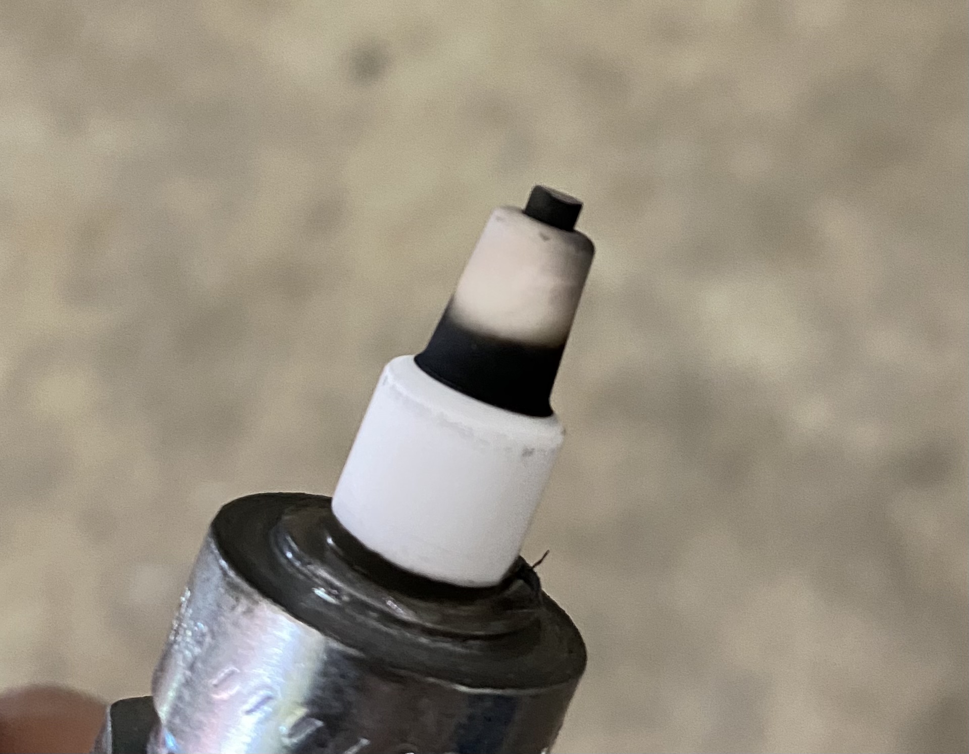

Ok thanks, do you see anything wrong with this plug? Looks like the center electrode is misshaped to me.SS109 wrote: 02:23 am Apr 28 2023 Please don't believe the old wives tail that two stroke plugs foul with regularity. They only foul plugs when a bike is in poor running condition and/or the jetting is way too rich.
Ok, to answer your question, yes, a lean condition can make a plug run too hot causing pre-detonation. You can see this on the plug as it tends to leave little specs on the insulator. If it gets real bad you will see much more obvious damage as no center electrode, cracked/missing insulator around center electrode, and/or melted ground strap.

If that plug has been in a the bike even a couple hours, it should be having some color to the top and middle. A coffee with creamer color or chocolate milk color is good.
That plug looks lean 0-1/4 throttle (top of plug) and lean 1/4 - 3/4 throttle (middle of the plug) and too rich on the “main jet”. I know you’re using a lectron that’s why I didn’t say pilot and needle.
You still haven’t done the leak down test yet? It’s quick to do and at least then you’ll know if you have a problem or not. I’d say especially for your engine and the previous problems, it should be the first thing on the list. It should not foul plugs ever.

I 100% agree!John_S wrote: 11:30 pm Apr 28 2023 If that plug has been in a the bike even a couple hours, it should be having some color to the top and middle. A coffee with creamer color or chocolate milk color is good.
