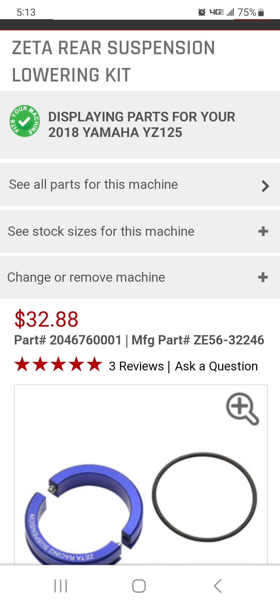

So, I am going to rebuild my shock with nee seals and replace the bumper. Has anyone lowered the rear by internal means? I found a spacer from Zeta for a 2000 kx250. Just wondering if it would fit.

I assume such a product would not work, as it is for a 46 mm body, not the 44 mm of the KDX.

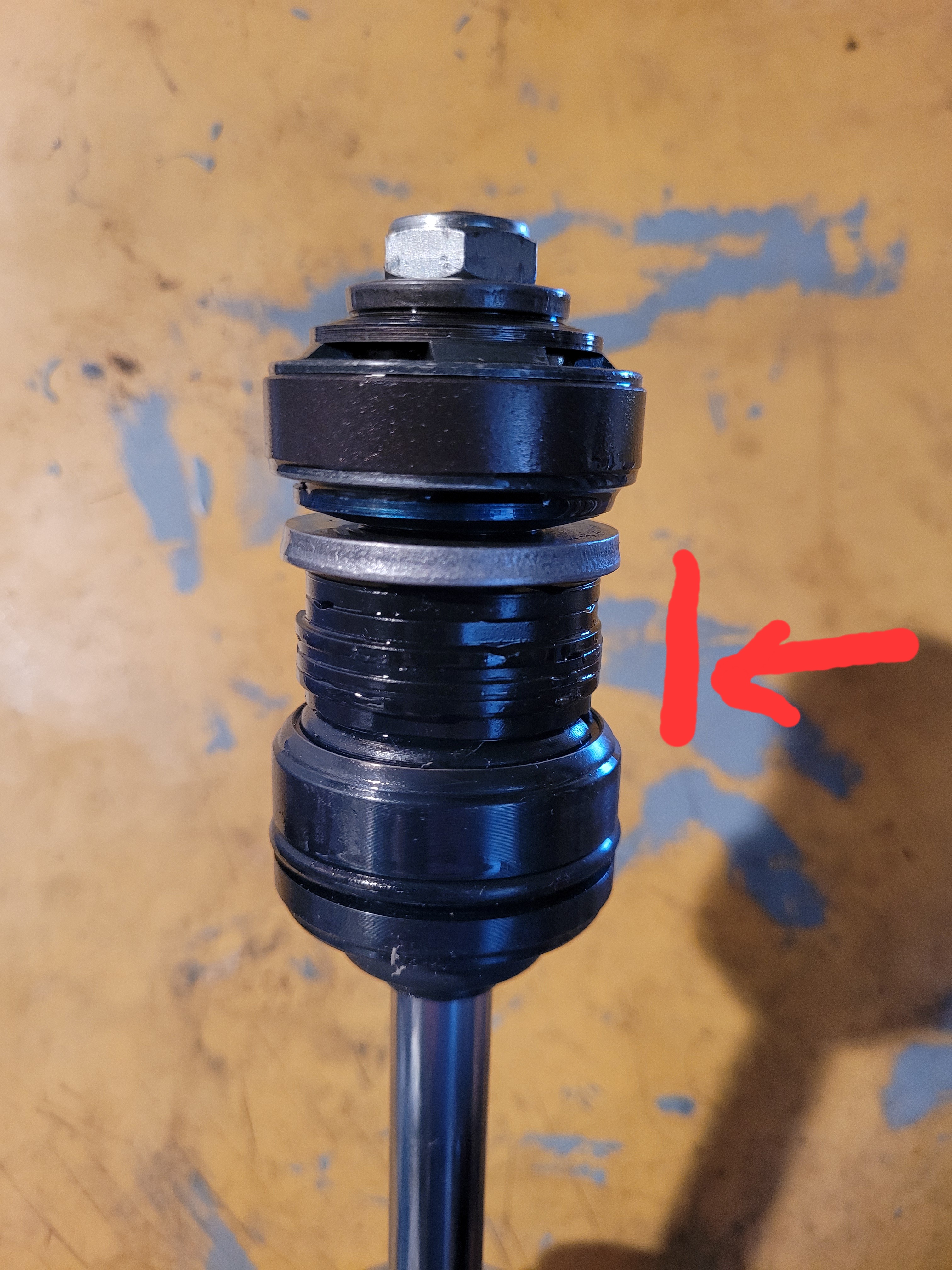

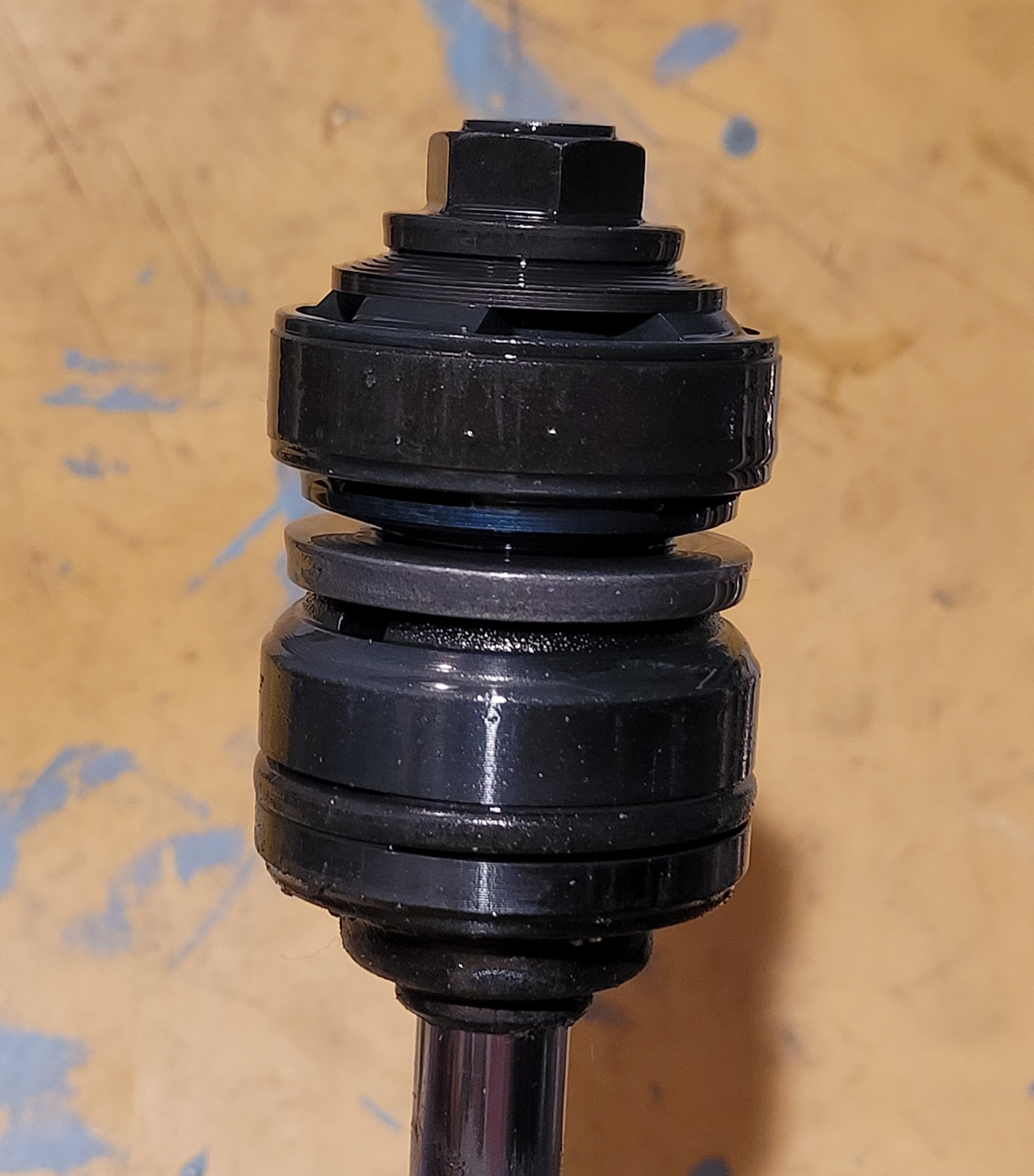

Ewbarger, I can't see how that Zeta ring can be used. Here are BEFORE (OEM) & AFTER (shims inserted) photos of rear shock. FYI, the shim stack is not 50 mm thick. It's 16 mm (0.6 inch). The swing arm & linkages provide relationships that factor with shim stck thickness to achieve desired lowering.

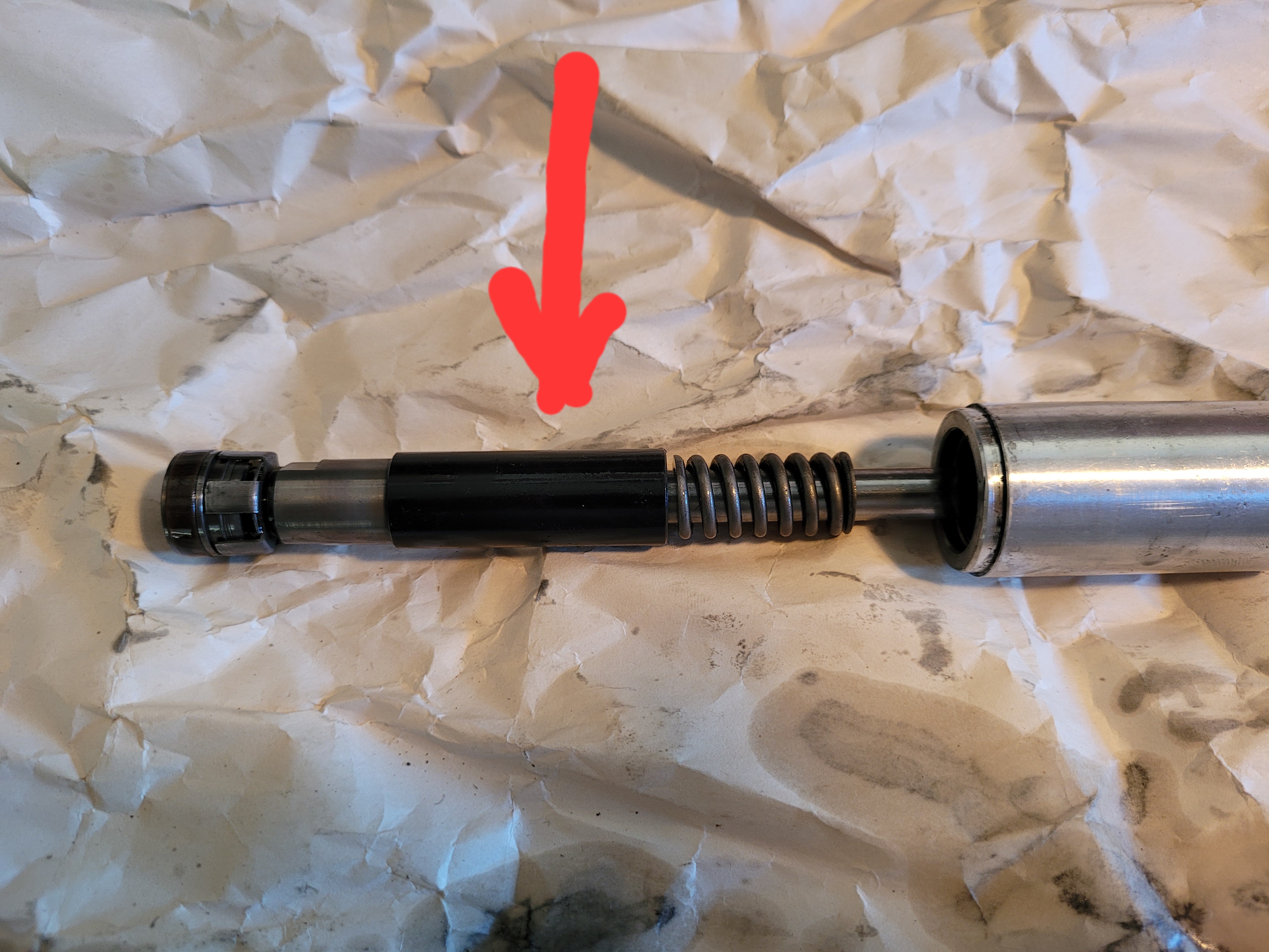

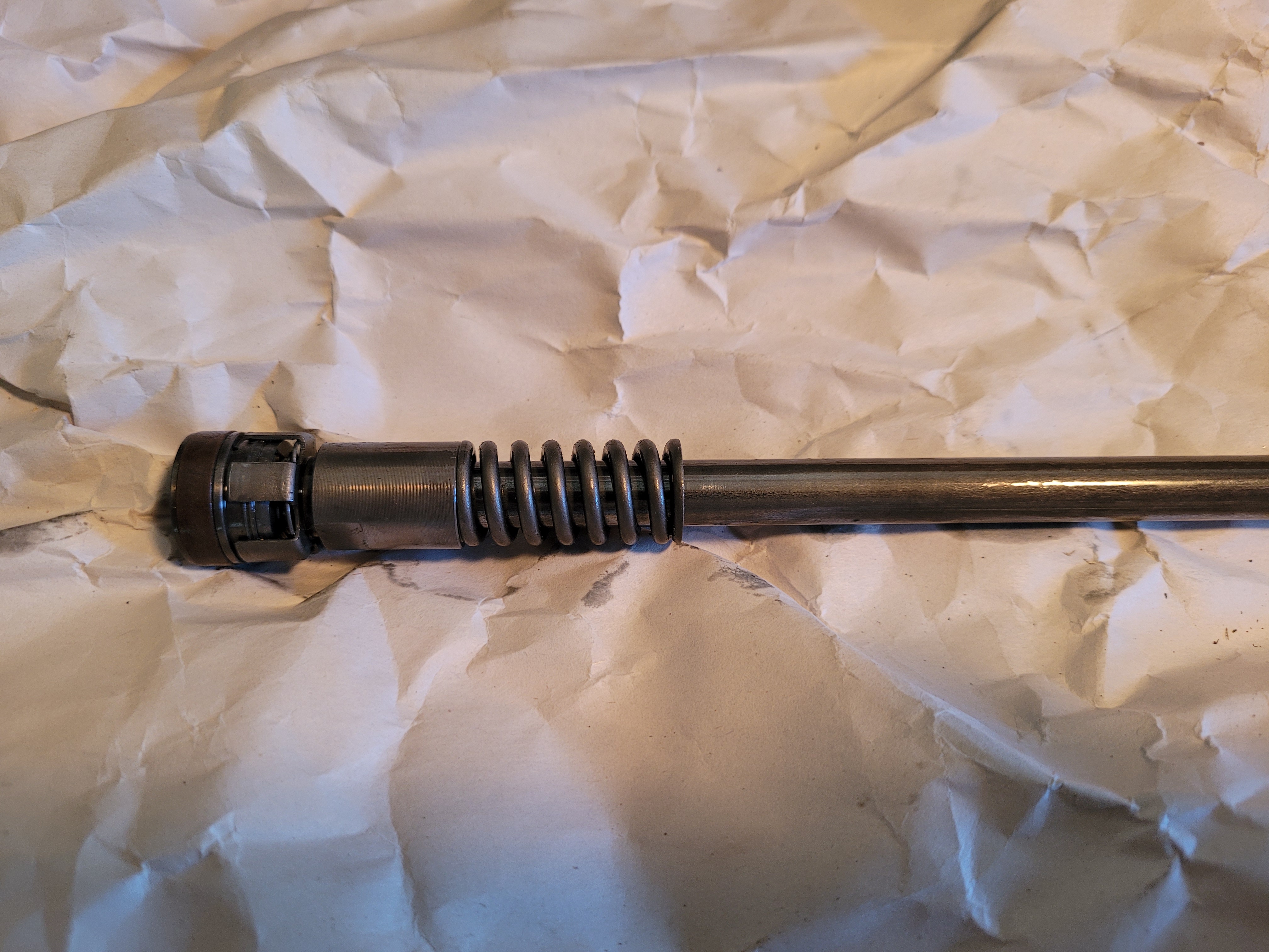

Here are BEFORE (OEM) & AFTER (spacer inserted) photos of one front fork. The spacer is a sleeve. Spacer length is 38 mm (1.5 inch) because I kept the 12 mm (0.5 inch) OEM spacer. Installing spacers in front forks and shims in rear shock is easy.

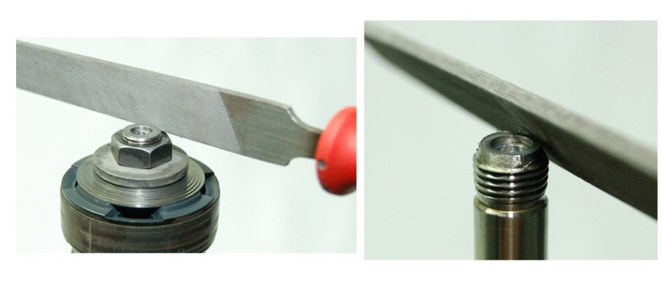

- KDXGarage mentions the stock (steel) piston rod in the rear shock is peened (and a nightmare to rebuild). If you look closely at my 1st photo above, then you can see a flat surface above the black nut. This is the peened end mentioned by KDXGarage. Also, you can see it's treatment in the images provided immediately below. It's not often that KDXGarage and I disagree on things KDX. I'll offer a counterpoint by reiterating it's easy to re-build and/or shorten KDX suspensions. Don't forget to finish-off the bevel with a wire wheel.
