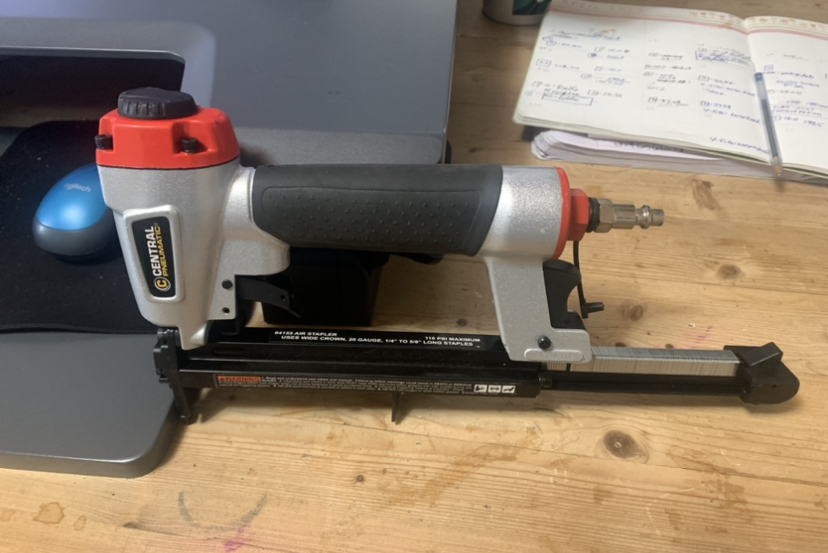

Re: Seat Cover - help...what's powerful enough to staple through the plastic??
I got this one from harbor freight, specifically to do seat cover. Seemed to work good.
- IMG_3346.jpeg (346.16 KiB) Viewed 1245 times
