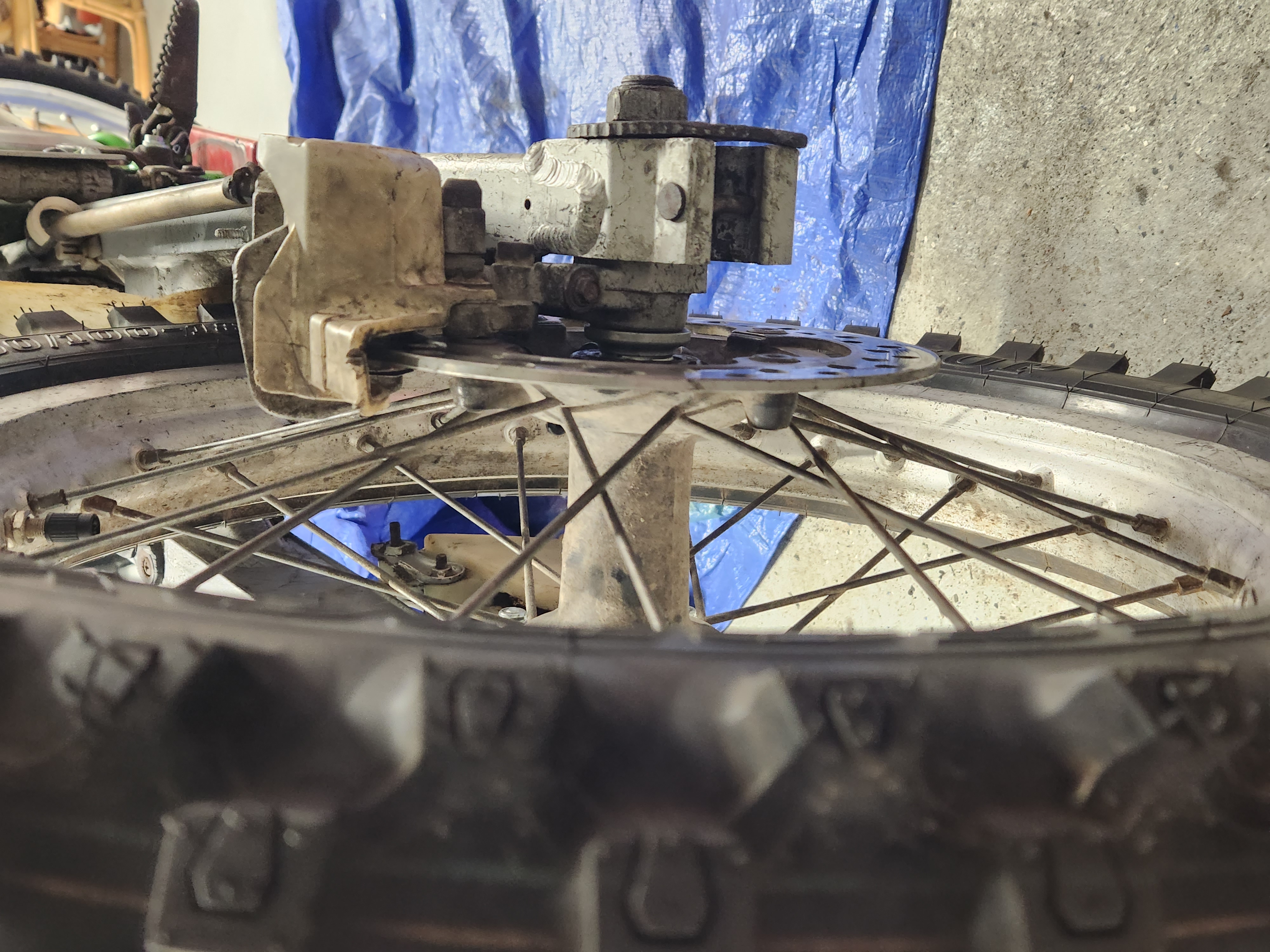

Hey guys,
I'm having a tough time on this....worked/fit when I took off the rear wheel but only rode the "new" bike once.

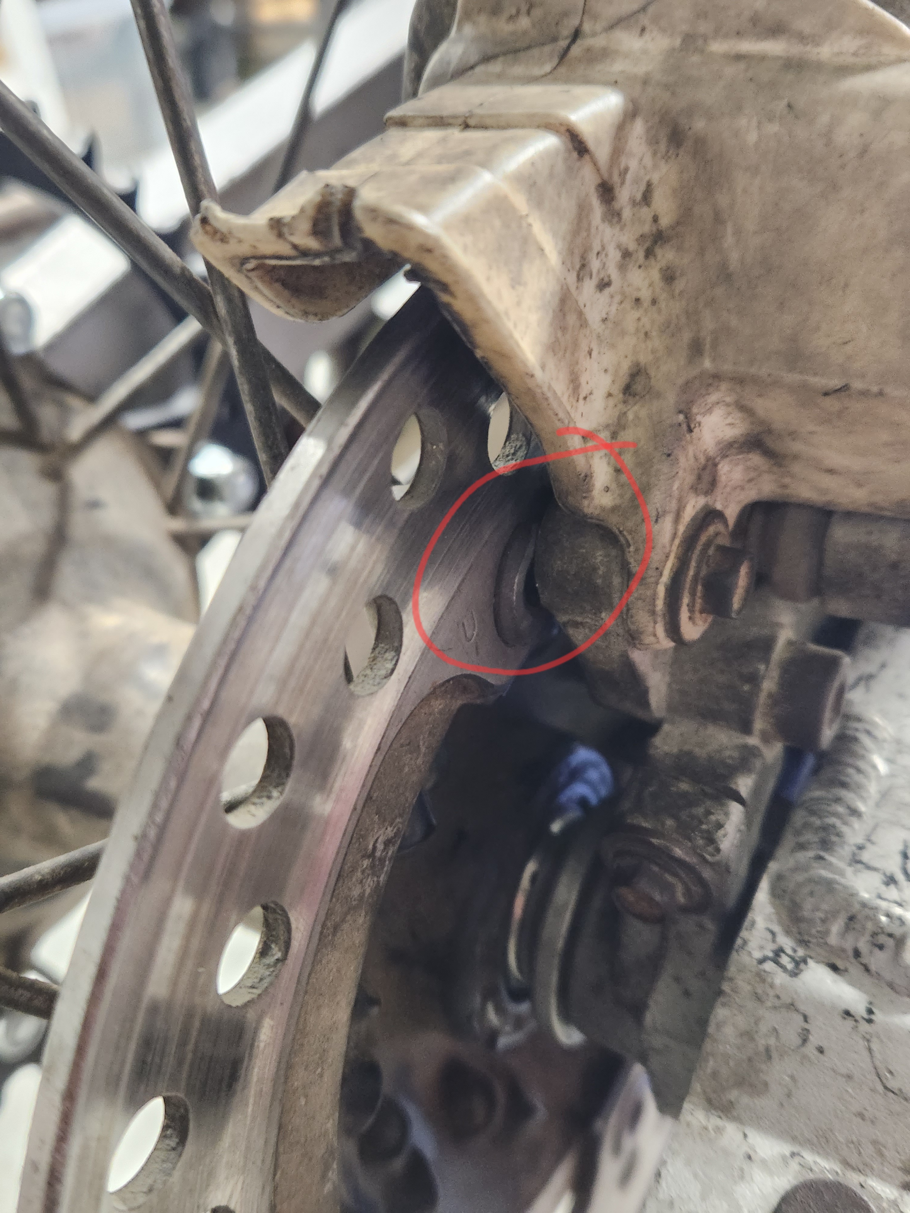

Put on a new rear sprocket and can't get the wheel back on without the rotor rubbing against the brake "bracket/assembly" (area circled in red).
I'm dealing with a non-KDX (I believe it's from a Honda) rear hub....but again it all fit fine before I took it off.
The left side (just inside the swingarm) had a washer on there. I put that back in the same spot but have an issue now....
Should I try a washer/spacer from a hardware store on the right side to help keep that brake assembly part from rubbing on the brake rotor?
Tried taking wheel off about 10 times and re-doing it....not sure what the hell is going on...
I don't remember dropping the brake assembly or anything so don't know how it could have bent in any way...
Wheel spins without rotor rubbing on bracket before I torque the nut down but once it starts to get tight the rubbing comes back....
I hope all this makes sense!
Thanks!

Looks like the dust shield on that side is backwards. The silver part between the hub and caliper mount.

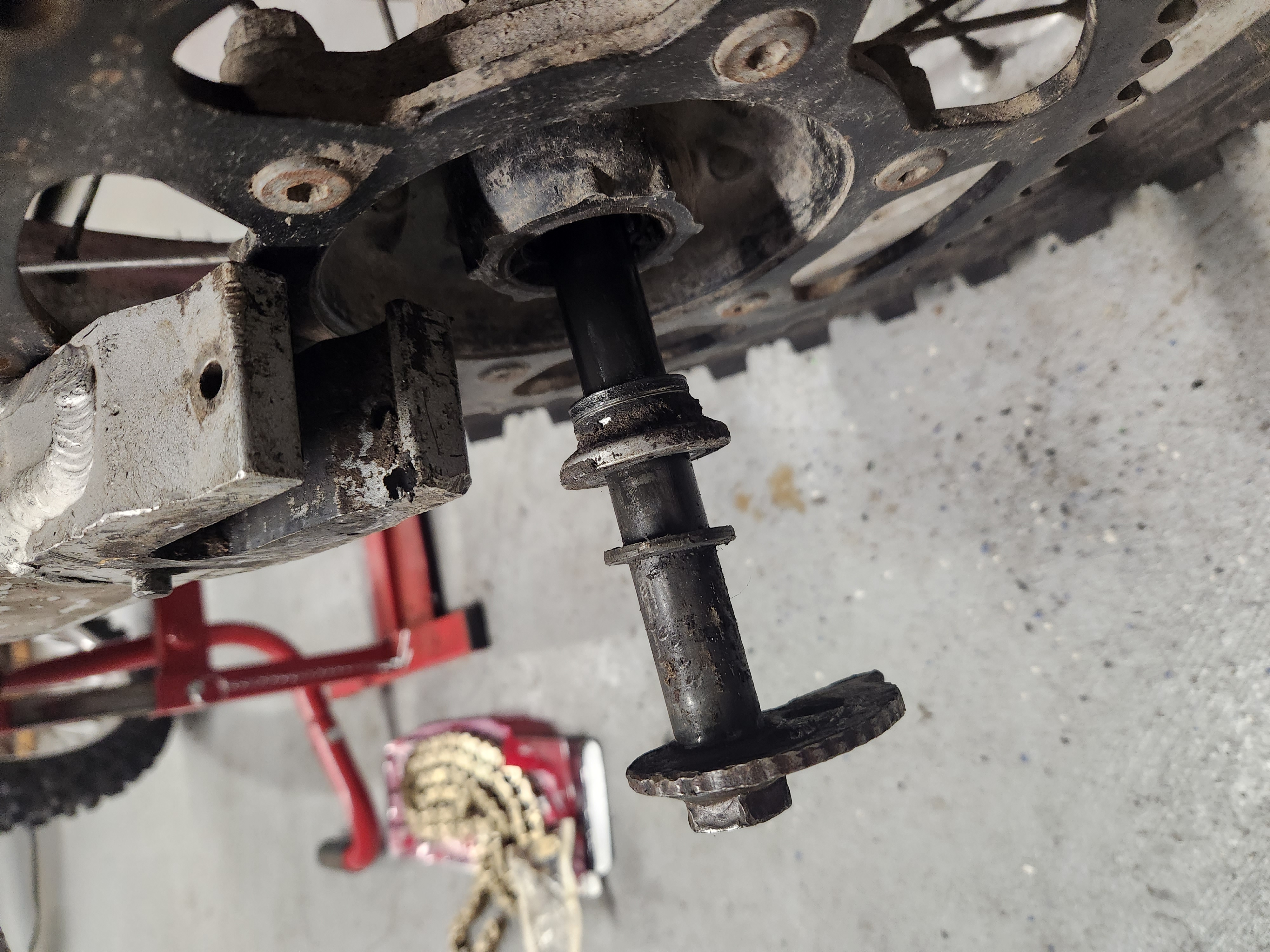

I have a pic of left side before i went to put it back together.....don't both spacers go in this orientation?
Will take it apart again later today & take a look when I'm back with the bike.

Definitely called that one, Nick. Wheel spacers are flipped. The wide end acts as a dust cap over your bearings. I usually stuff it with grease which protects the outer bearing seals and holds the caps on the hub when remounting and lining up for the axel.

Hold up, those are not KDX wheel spacers. You can't install the wide side in to the wheel as they're a solid piece of aluminum. I don't know what they're from but they're definitely not E or H series KDX. Also, that washer in the last pic, there is no reason for it to be there. I'm assuming it was being used as a spacer between the actual wheel spacer and the brake caliper bracket to get the clearance you need from the bracket.

That washer was between the left side swingarm and the actual wheel spacer on the left side.
I didn't find any extra spacers/washers on the right side between the brake caliper bracket & actual spacer on the right side (but now sure seems like it's needing one).....

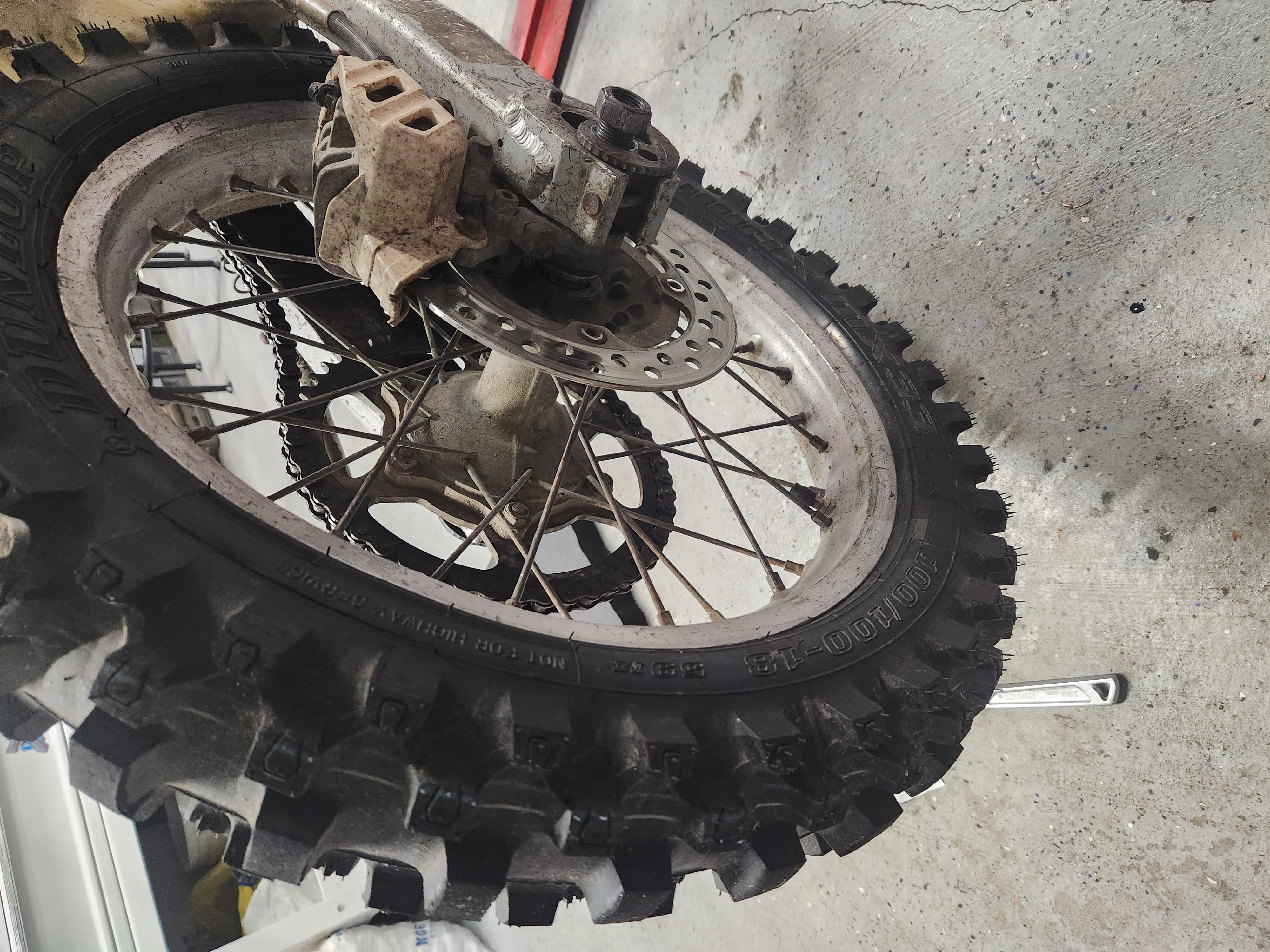

Here's a pic from before I ever messed with it (only loosened the nut)

Might be the angle in the first pic but looks like the rotor bolt isn't fully tightened

They're fully tightened....was thinking that for a bit.bufftester wrote: 08:23 pm Feb 16 2023 Might be the angle in the first pic but looks like the rotor bolt isn't fully tightened

That can’t be the proper wheel for that bike. The rotor bolts are already worn down. It’s been rubbing for awhile.

First off, regardless of whether its a KDX hub or not, the wheel spacers definitely go on with the smaller diameter facing in, just as he has it in the pics above. The smaller end rides against the inner race of the bearing. On the KDX there is a separate dust shield that goes on to cover the bearing. As for the specific problem here, measure the distance from the inside face of the swingarm on one side to tthe other. Then measure the width of the hub, the spacers, the brake mount and the washers. It should be the same. From your pics above, the washer on the left side likely needs to go on the right to space your rotor properly. Then you need to be sure that the sprocket lines up with the countershaft sprocket and tighten everything down. Obviously a KDX hub and spacers is the preferred answer, but not the only one.
