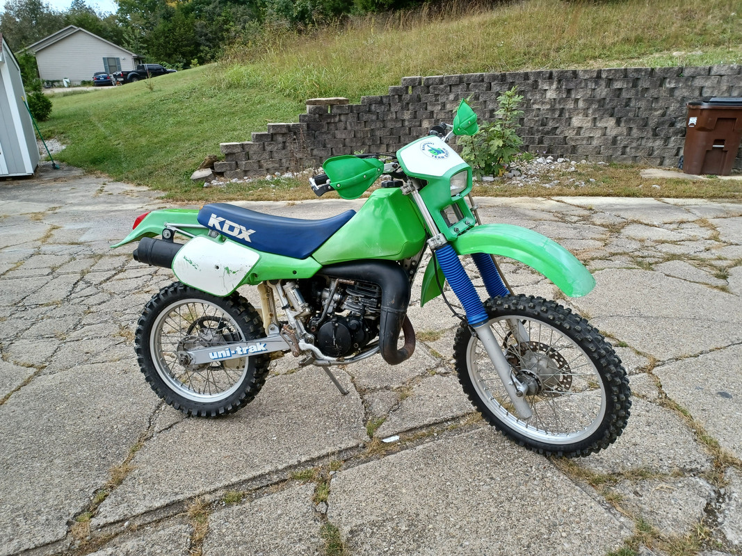

Nice bike, by the way. That tank looks like it's in fantastic condition. It's good not to tinker too much with a nice, complete, original bike.

Nice looking '87!

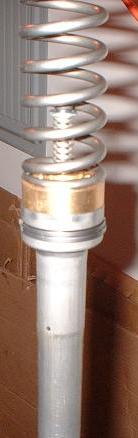

Here is a pic I took about 18 short years ago.
This is from my 1987. I never rode them, so I have no ride report.
