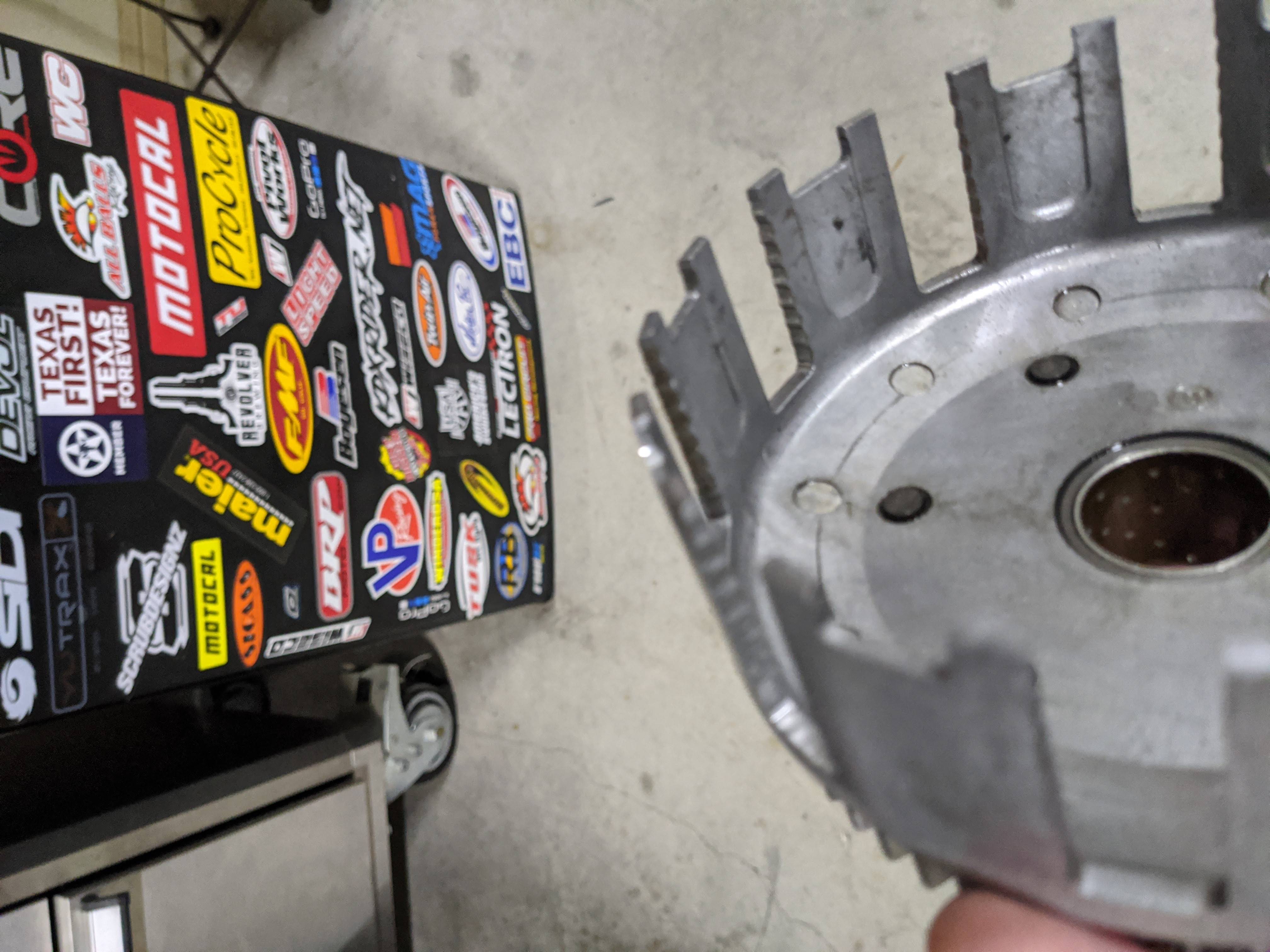

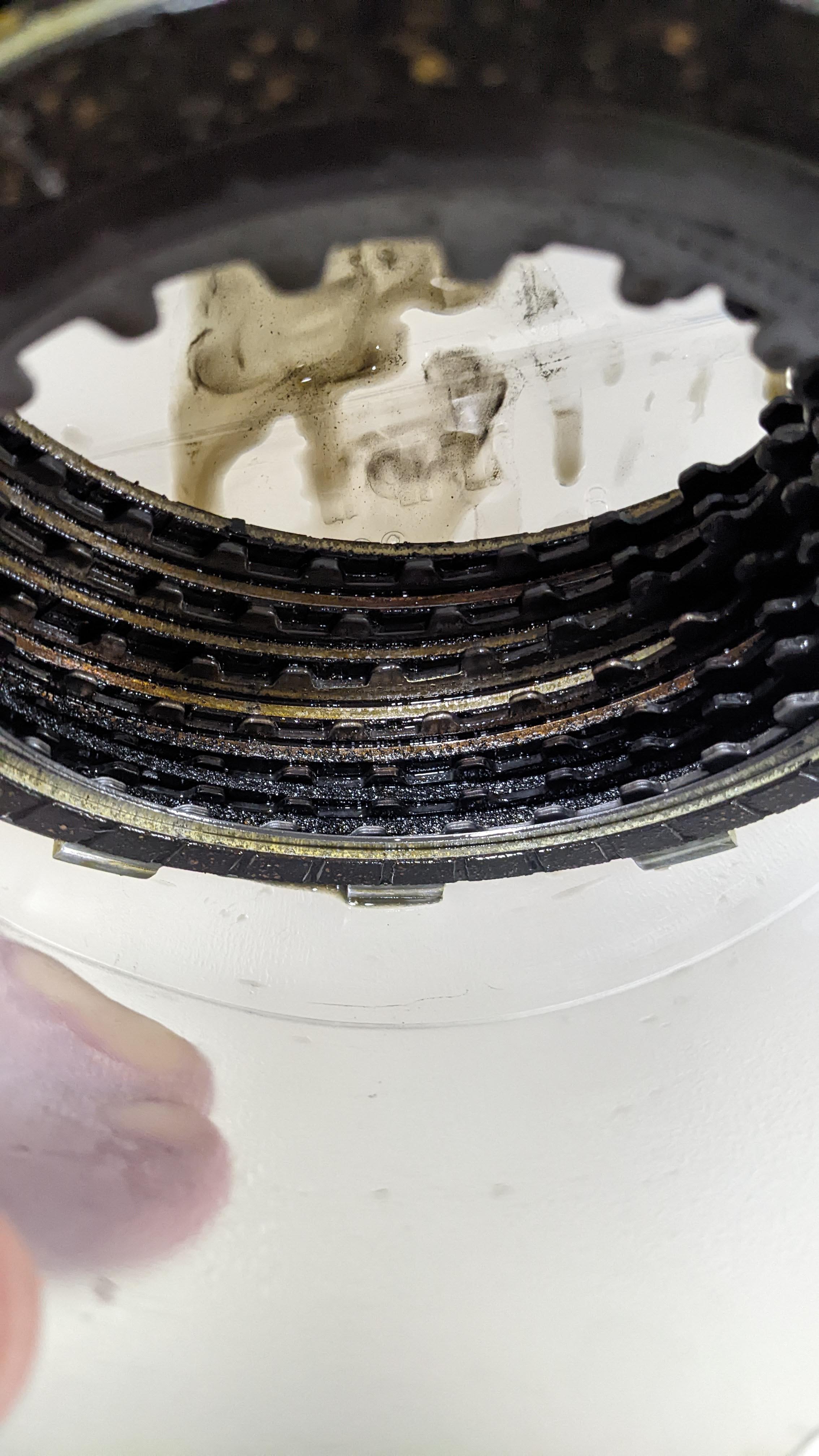

A little back history...I've always run Barnett clutches with heavy-duty springs. A few months back I started getting minor slippage from the clutch that had been in the bike for many years. I decided to replace it. After reading reviews, I thought I'd go cheap and try one from Tusk. I burned it up on the first ride, deep in the woods on a steep rocky uphill riding up a gear...slipping the clutch...searching for traction. I'm hard on a clutch.
Lesson learned...Upon inspection, this is what I discovered.

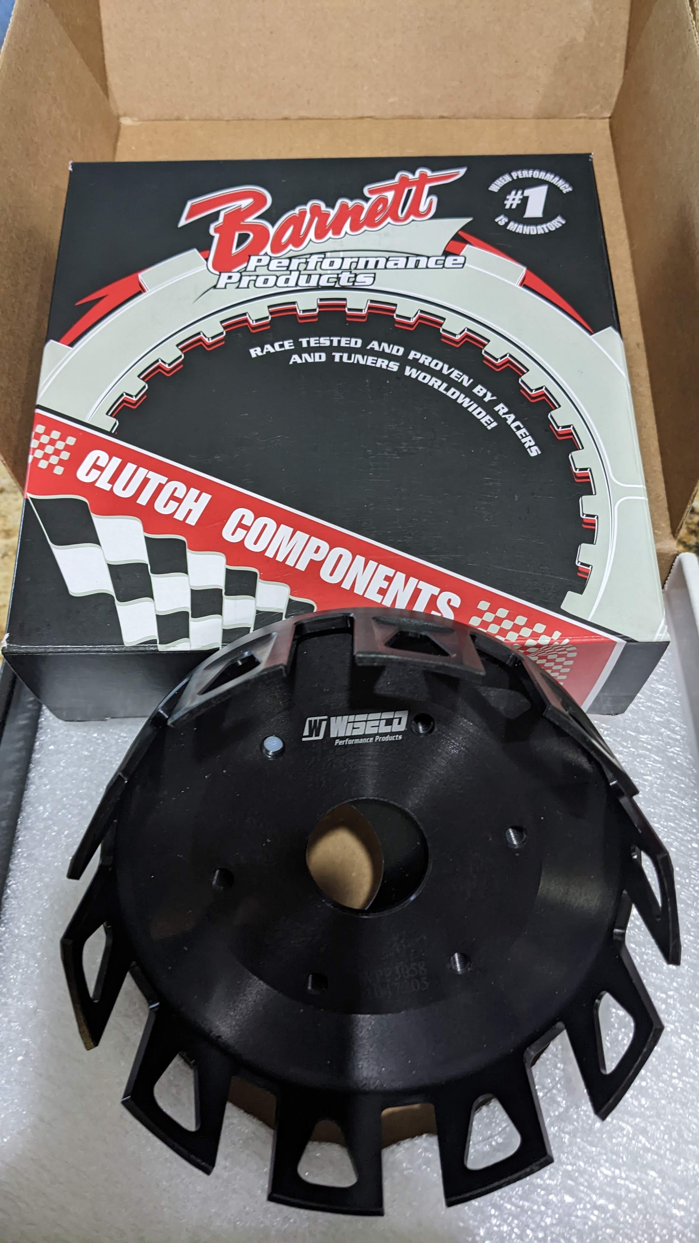

I ordered the "old faithful" Barnett with kevlar pads and heavy-duty springs. Due to the notching, I also ordered a new Wiseco basket.

Wow, those Tusk frictions really crapped the bed. I'll make a note not to use them on a KDX down the road as I'm somewhat hard on my clutch as well. Of course, I believe it has to with the springs they supply as I've heard they are not up to OEM spec which could have led to their early demise.
As to the noise, I know the Wiseco baskets are excellent so, unless there was a manufacturing error, we can eliminate that as the problem. I would pull the clutch back apart and check for odd wear patterns on both the frictions and steels. One solution that has worked for some has been to sand the steels slightly. I would probably use a red scotch brite pad to do that.

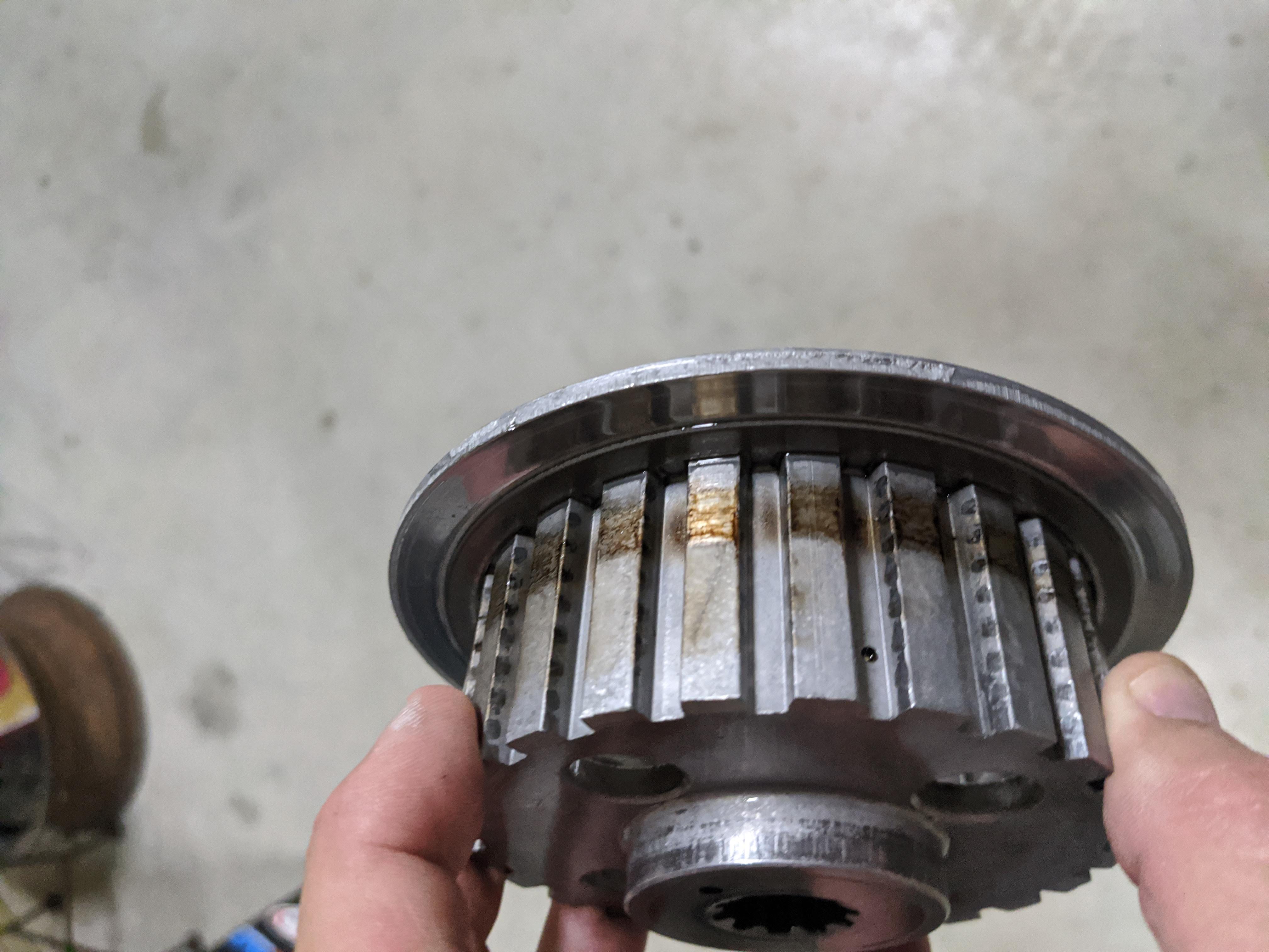

Another thing, does your inner hub have notching as well? I notice some very prominent marks on it. If so, that could contribute to noise as well.

The notches on the inner look much worse than they are. It's more discoloration with some very minor notching.
