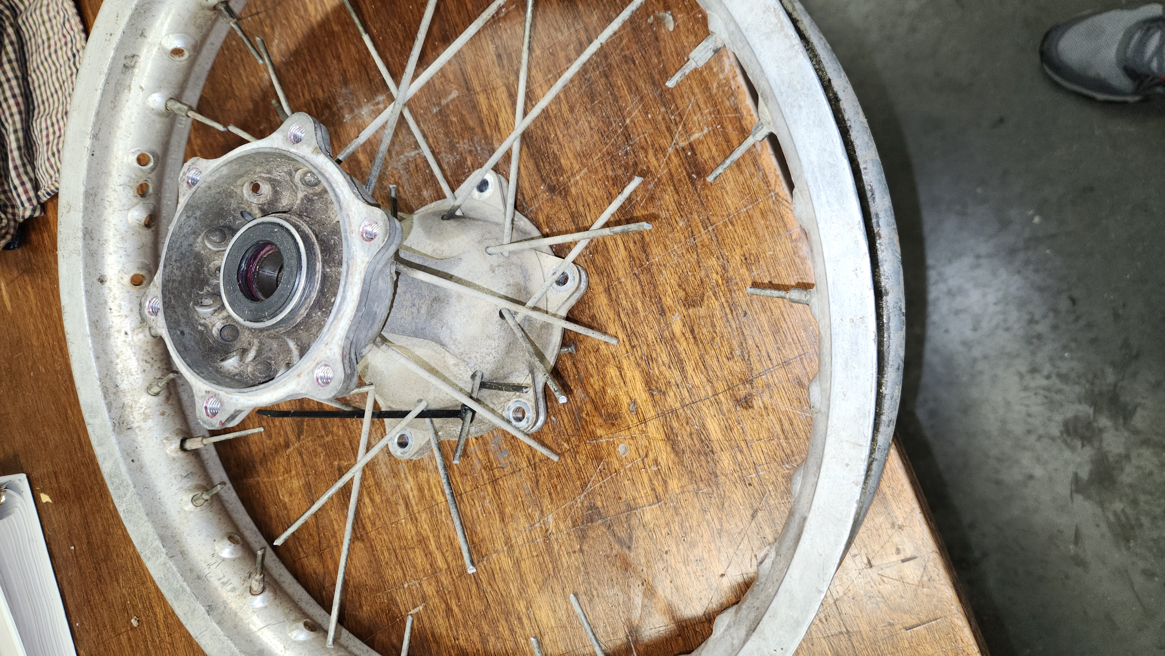

Tusk wheel truing stand and Warp9 spoke torque wench should be here next week. All old spokes are seized so I guess I'm going to do some cutting!

I think cutting them off with a cut off wheel is the better route anyways, 10x faster than unthreading and taking each one out.

DO NOT cut any spokes before recording wheel dish!! (offset it has it)

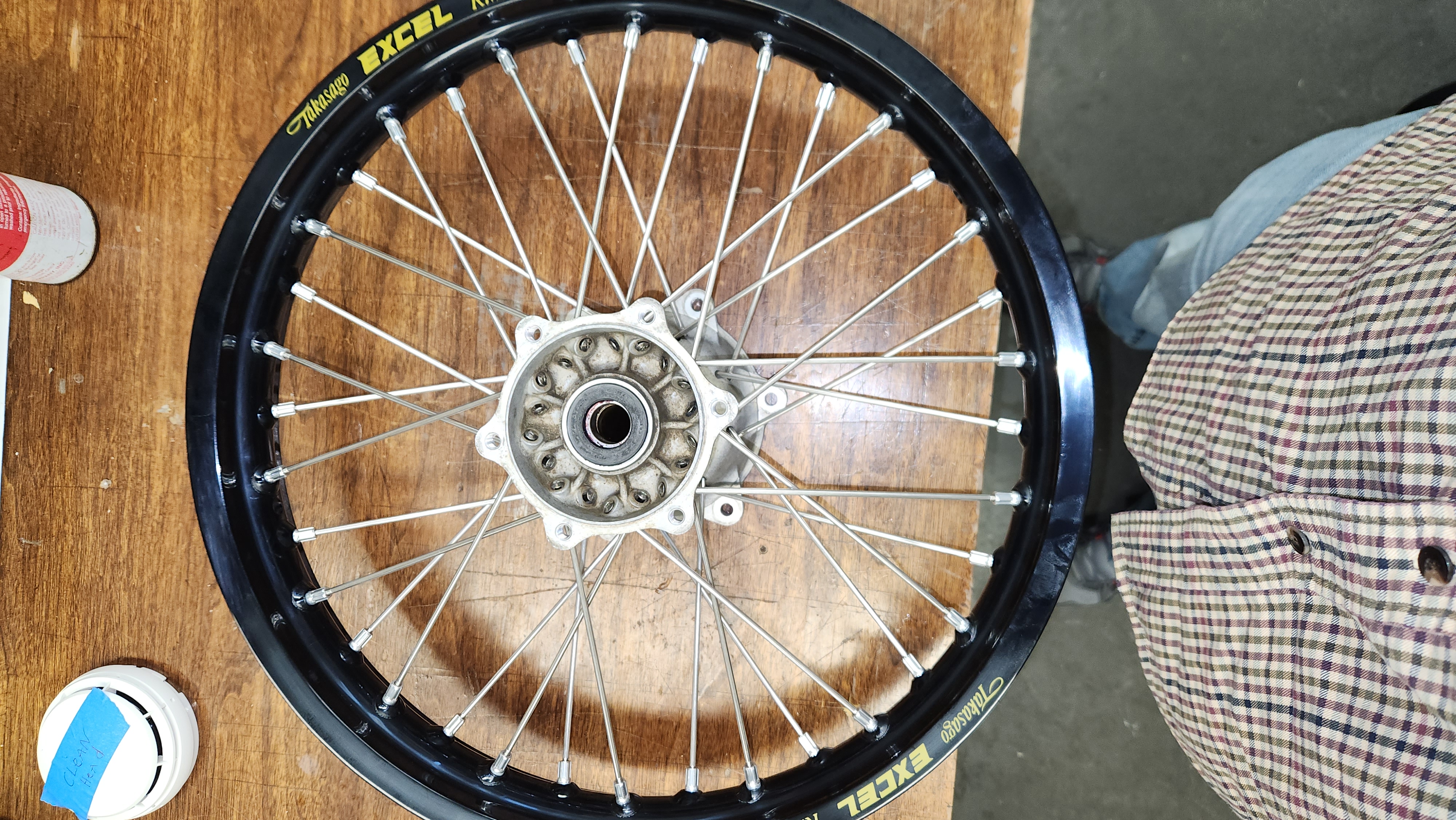

Well, it's been awhile. I have the rim together but still working on getting the dish right. I measured the old wheel with brake side down and it was 3 cm and the sprocket side was 5cm. Rig
ht now I have 4cm.

It wasn't that bad. I still need to get the dish right. The one thing that I'm pissed at is, one dang nipple is stripped. The spoke and nipple kit is Excel. The nipples are aluminum and I only tighten them to 10 in pounds. So I ordered a nipple set not knowing if I'm gonna have fitment issues.

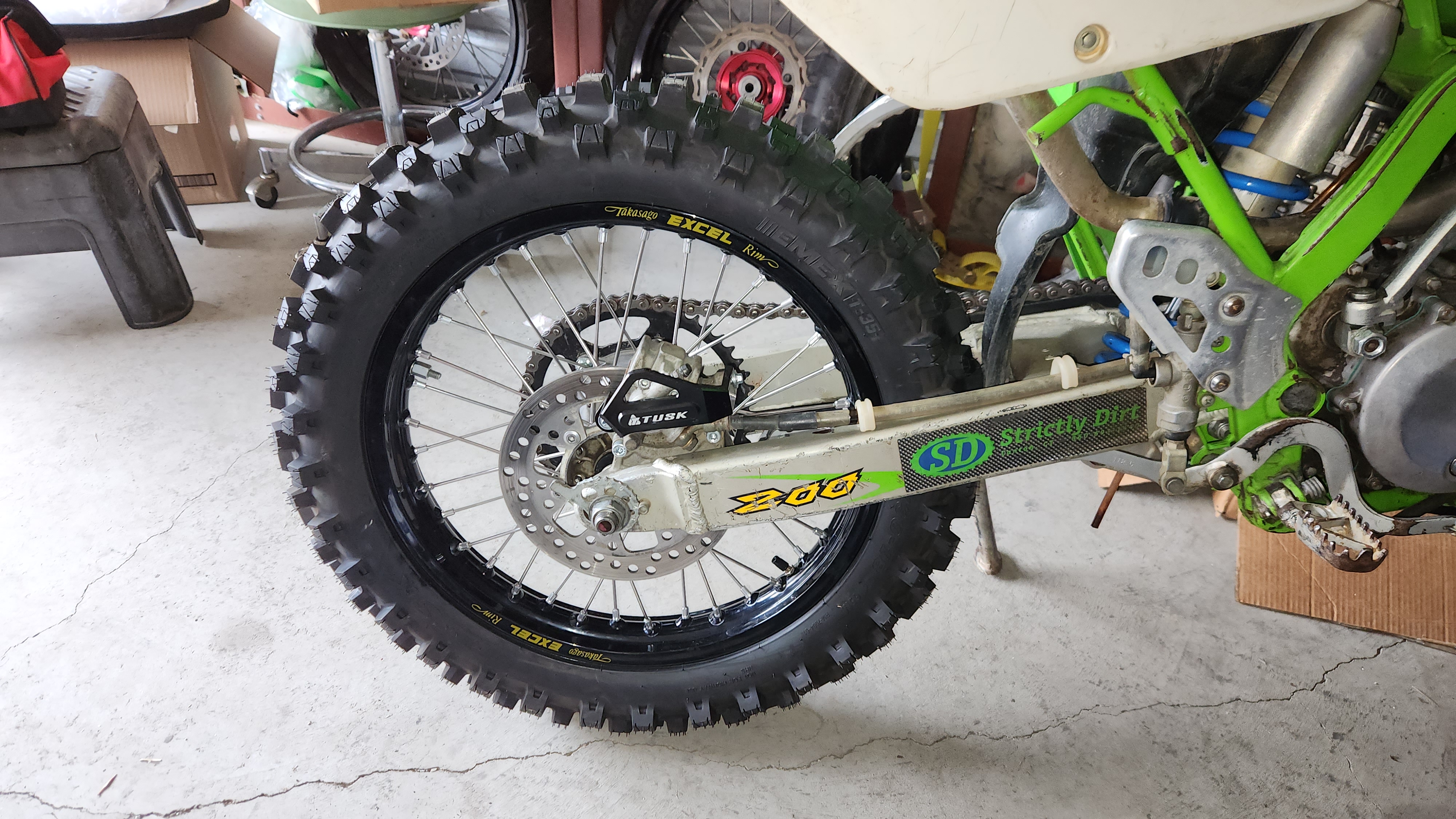

by Ewbarger
Finally got it all together.
