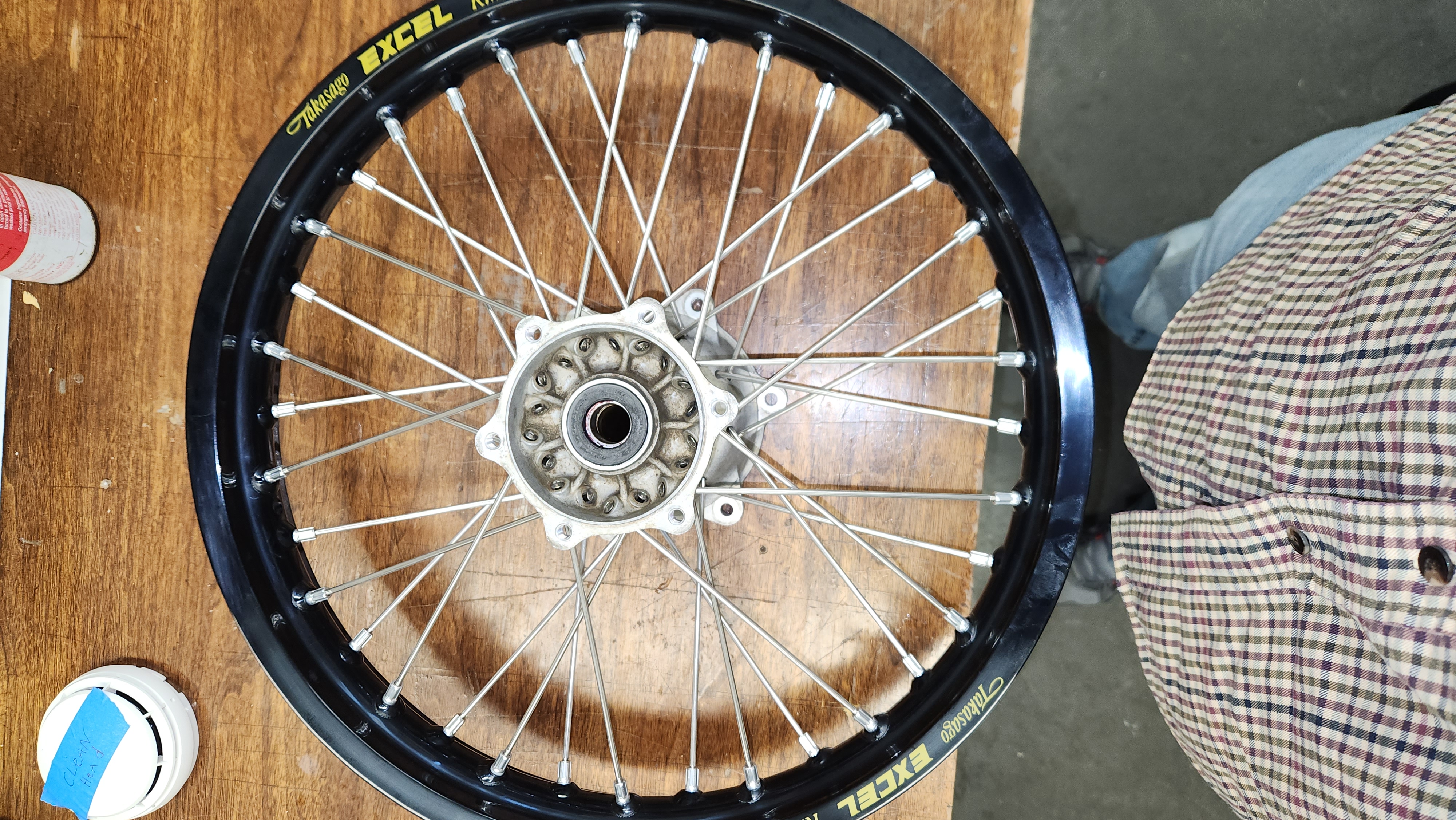

Well, it's been awhile. I have the rim together but still working on getting the dish right. I measured the old wheel with brake side down and it was 3 cm and the sprocket side was 5cm. Rig
ht now I have 4cm.

It wasn't that bad. I still need to get the dish right. The one thing that I'm pissed at is, one dang nipple is stripped. The spoke and nipple kit is Excel. The nipples are aluminum and I only tighten them to 10 in pounds. So I ordered a nipple set not knowing if I'm gonna have fitment issues.

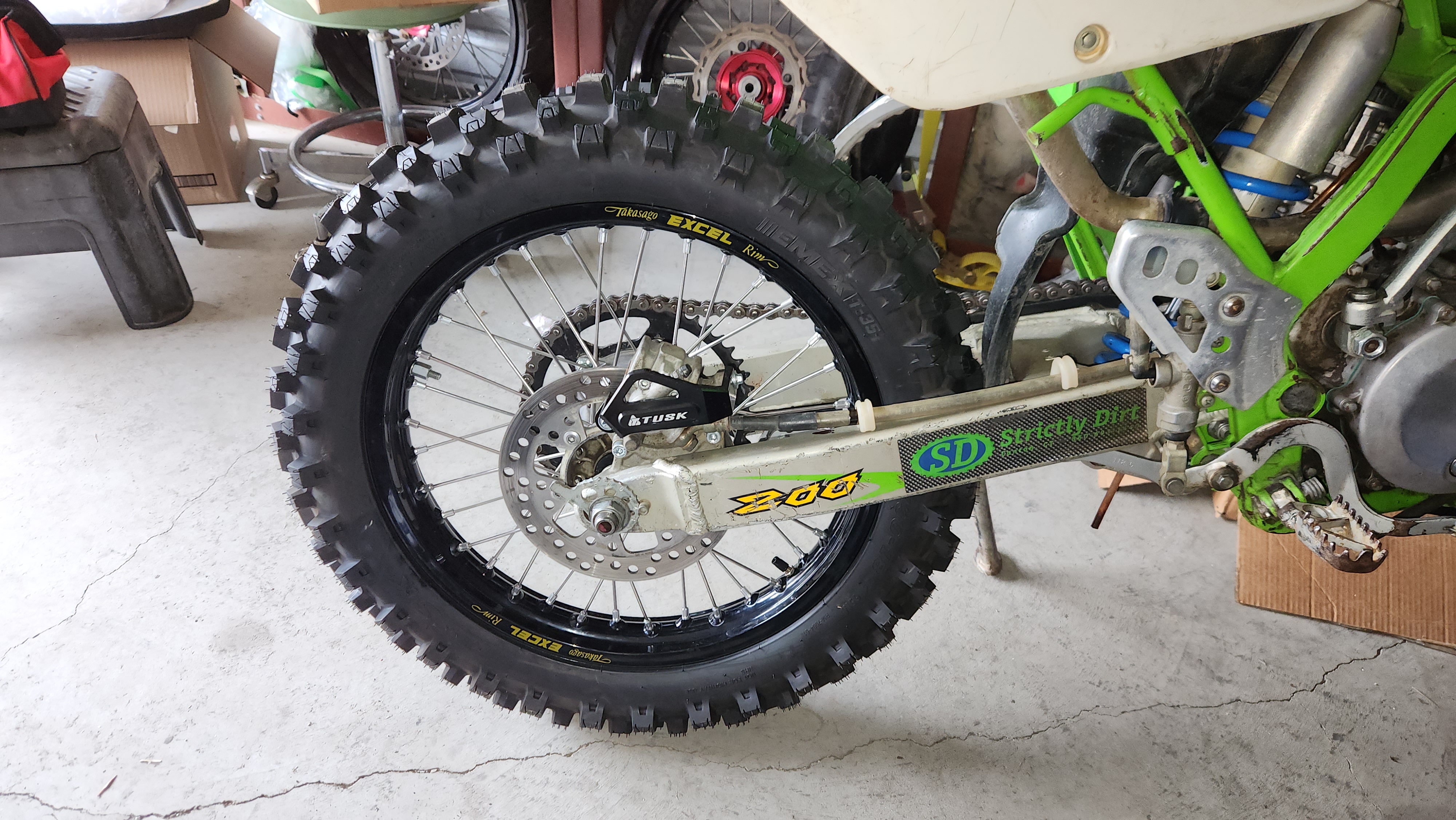

Finally got it all together.
