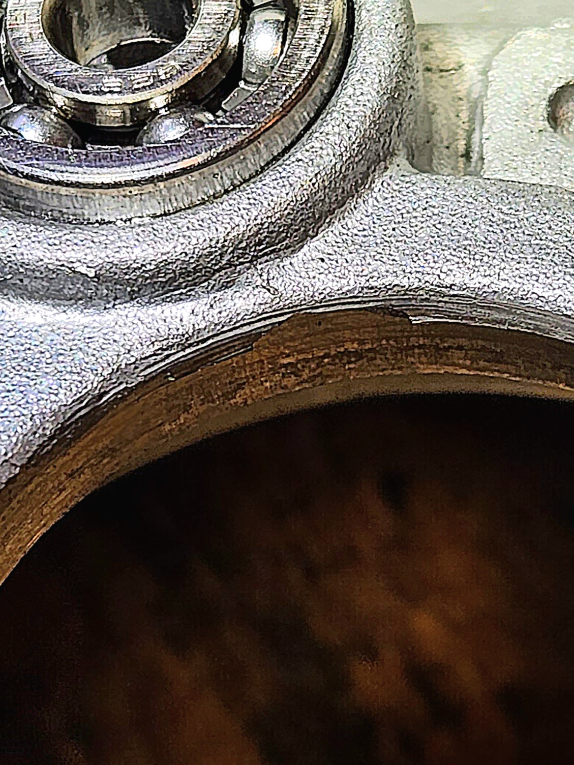

Hello fellow KDXers!

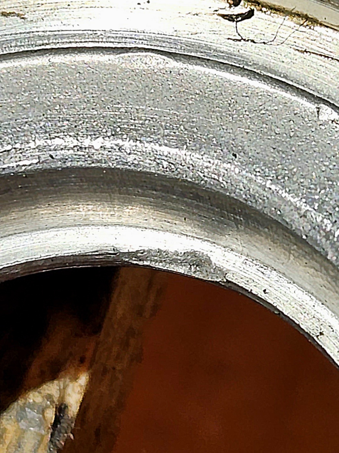

I put a small chip in the right crankshaft seal "seat" when trying to remove it, see pics.
On a scale of 1 to 10 with 10 being very serious and 1 being barely serious...How serious is this damage?
Is it fixable? How?
If not say why.
Other concerns?
Thank you all!
Bike is 2004 KDX200

Do you have the piece that chipped off?

No I do not, this actually happened last year.
Posts: 6117
Re: Chipped Crankcase help!
IMO, that is rated a 0 = non-issue. It is only the depth stop for the seal and doesn't carry any load. The only thing I would do to it is file/grind/sand it smooth and forget about it. I would only do that as to relieve any possible stress risers.

Yeah you'll be just fine.
