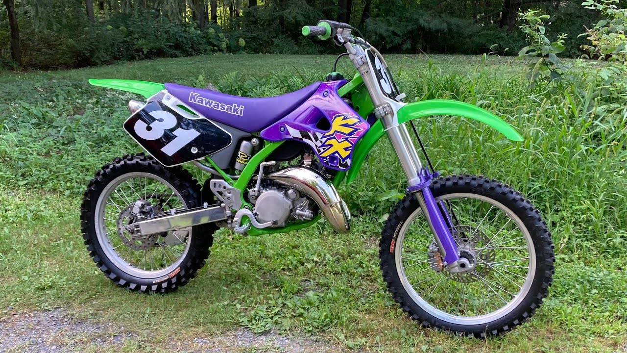

96 KX125 purple
96 KX125 purple

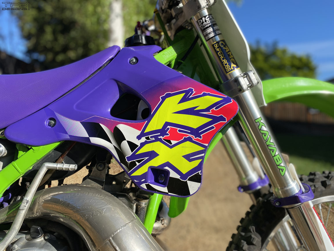

I LOVE my purple KDX plastics and graphics, so if I did a KX144, it would obviously lean towards the years that are compatible with the purple 96 plastics and graphics, but SKDA out of Australia make purple checkered flag '96 KX styled graphics for all KX/KDX/KLX/KX-F models 1995+, so that opens it up to anything 1996+ KX125 2-strokes.
https://us.skda.com.au/96-factory-kx-full-graphics-kit/
The purple with checkered flag graphics really does it for me... But now I see I can get this style from TFB to fit '03+ KX125 shrouds, & SKDA offers variations on this to fit all '95+ KX/KDX/KLX/KX-F models, I'M SOLD!!!!

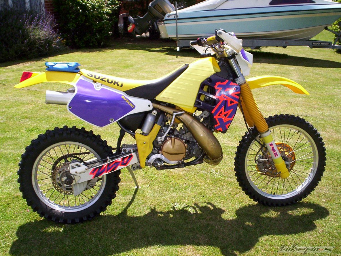

One other cool thing if I ended up doing an RM144 vs a 94-98 KX144 in 96 purple plastics/graphics - I wanted to get the 1998-ish RMX250 radiator shroud graphics like the 96 RM & KDX lettering/font, all black plastics (Clarke or IMS 3.0 or 3.4 gallon black 96-00 RM250 tank), & run the RM125 144cc big bore as an "RMX 150" by using the RMX shroud graphics and the RM 125 / RM 250 swingarm decals cut and spliced to make a 150 in the retro 1990's font, so that it'd be an all black plastics RM125 "RMX144" model... I was pretty excited at the thought, and they came STOCK with the Showa suspension that I'd want...98 49mm Showa Twin Chamber conventional forks being the absolute #1 pick.
Here's the later RMX250 for reference, with the same lettering/graphics style as the 96-97 RM125/250:
Picture the similar appearing but smaller framed and all black plastics are in 125 with a shroud graphics and the swingarm decals spliced to make the same style but "150"... RMX150...cool
