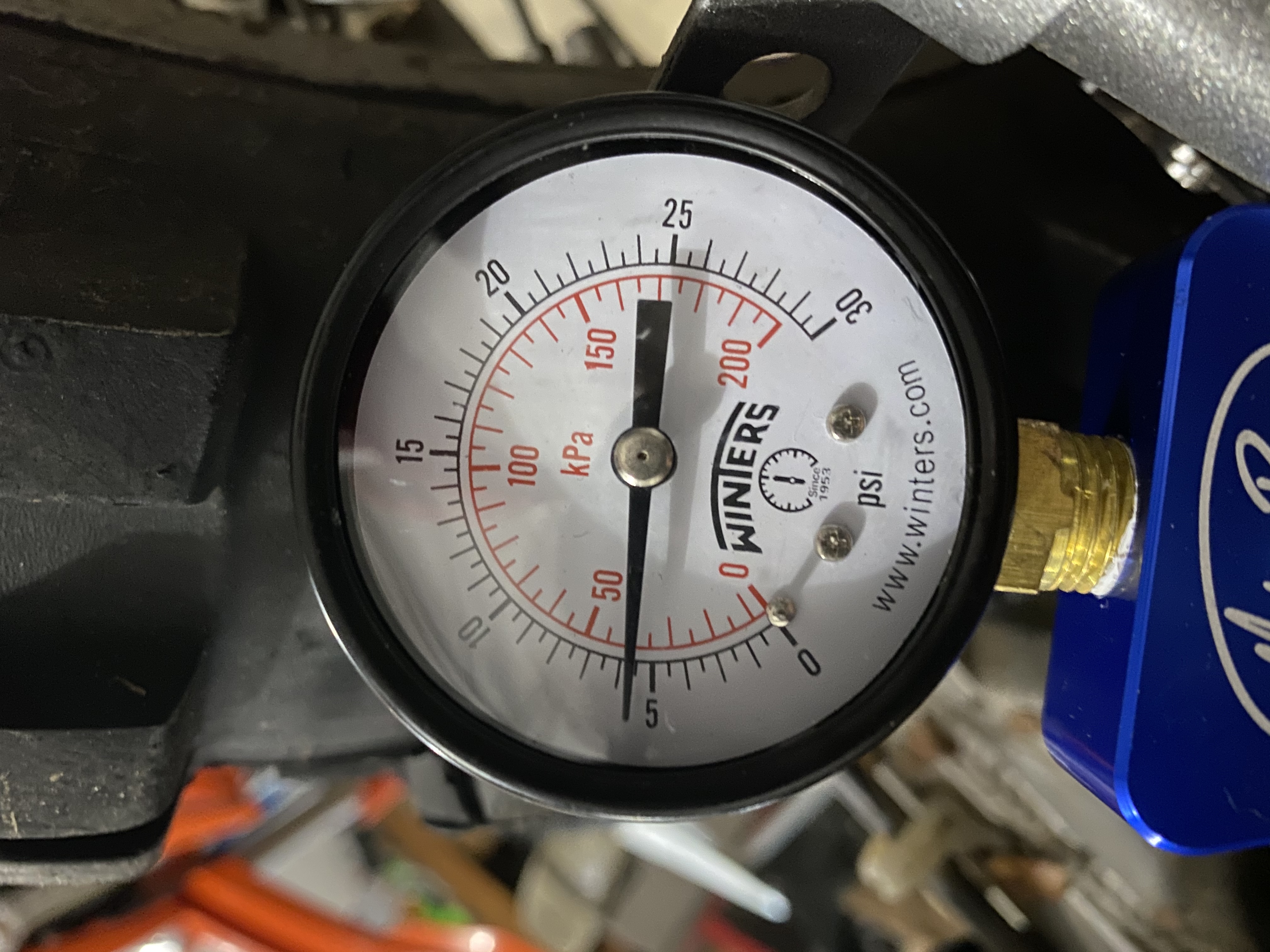

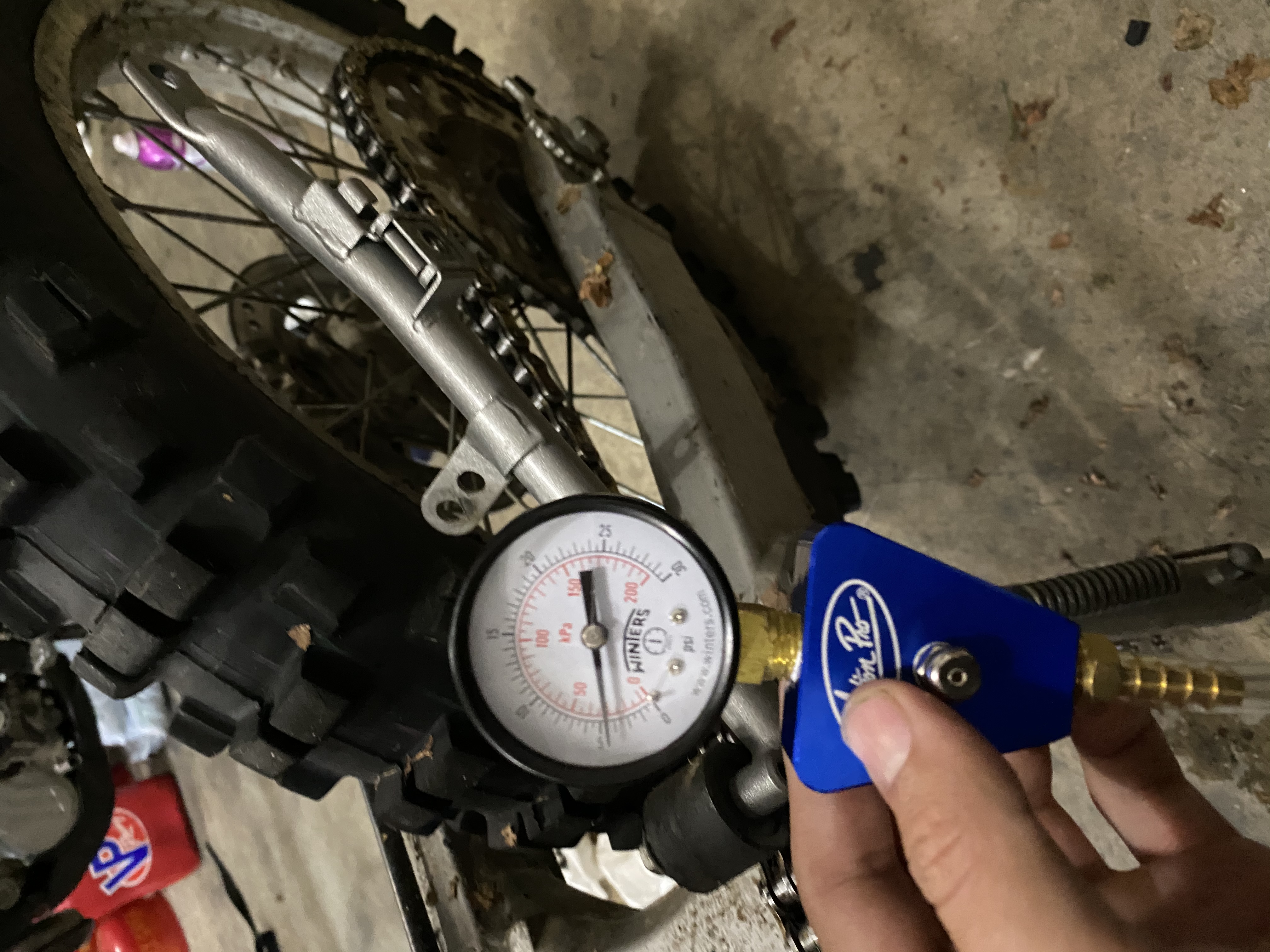

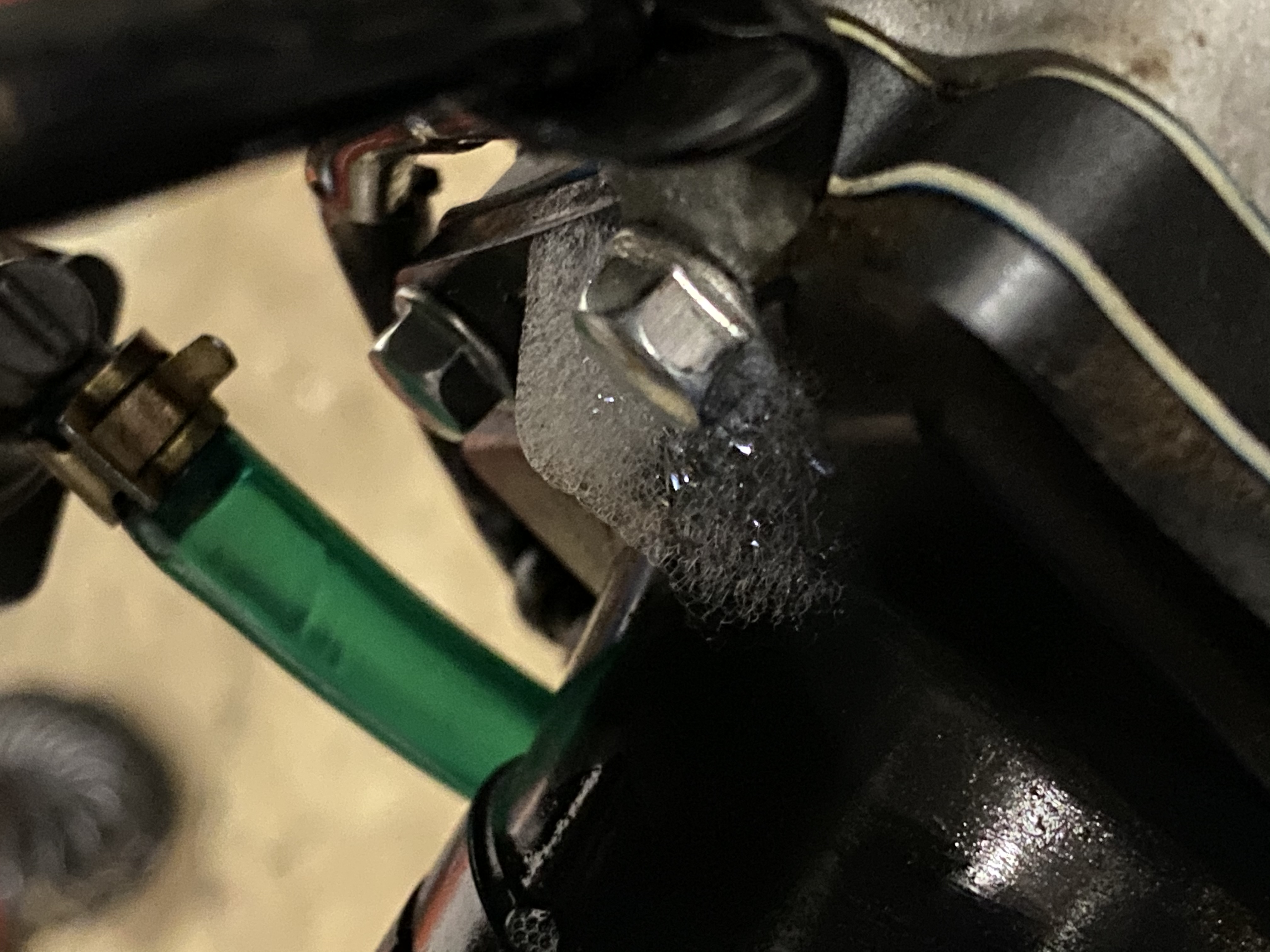

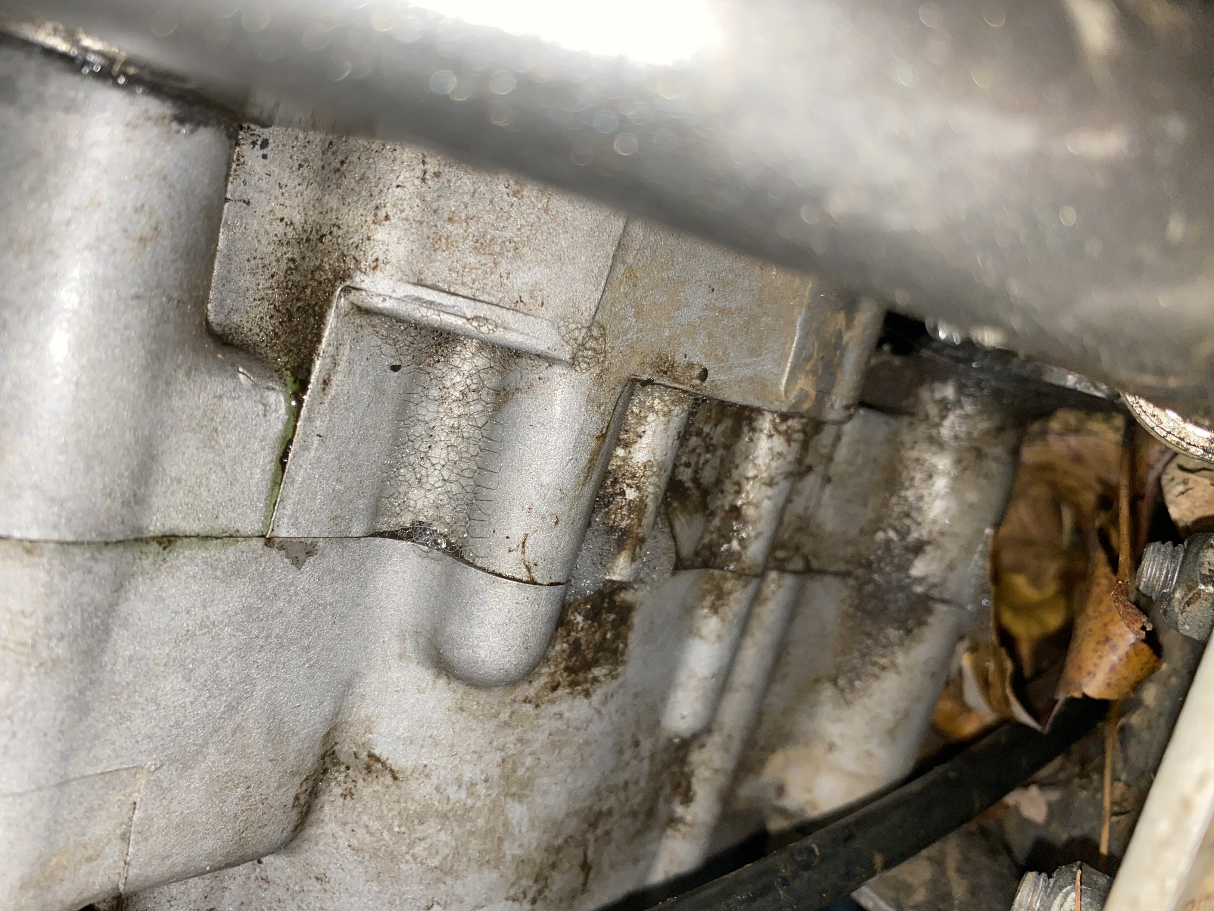

I decided to look a bit harder for leaks during a leakdown test today. I found a total of 4 different leaks. The first leak I found was around the kips inspection cap, the second was the bolt with the two copper washers that sits below the inspection cap. The third leak is around the top right reed cage bolt. The fourth and most disappointing was along the front crank case seam under the cylinder. I’m 100 percent positive these are all air leaks. Is this really typical for an engine fully rebuilt with 12 hours on it? I can imagine that the crank seals leak. I may pull the flywheel and stator to check the left side crank seal but their is no oil under the stator cover. Ignore the coolant, it dripped when I removed the cap and migrated. Thanks

If the case is leaking that is a big one. It could explain the poor running, oil consumption, and the impossible to get it jetted correctly issues. No, at 12 hours you shouldn't be seeing anything like this.

:shock: Thanks man. Sent Jeff an email of the picture maybe he can make this right. If he doesn’t respond I’m just going to move on. I’m relieved to have found this finally but, I’m exhausted of all the testing and everything I have done to try to get the bike enjoyable to ride since June.

I’m sending the engine back and it will be moved to the front of the line. I asked them to replace the crank seals again as I was still losing trans fluid. I’m also going to have them inspect some wierd cylinder markings. They look like they were caused by overheating.
