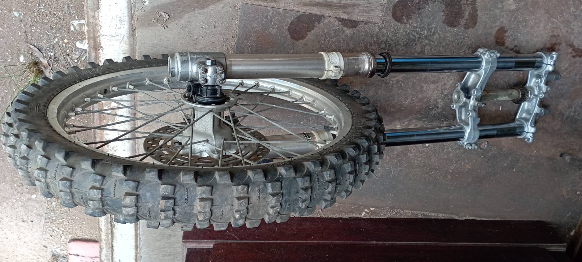

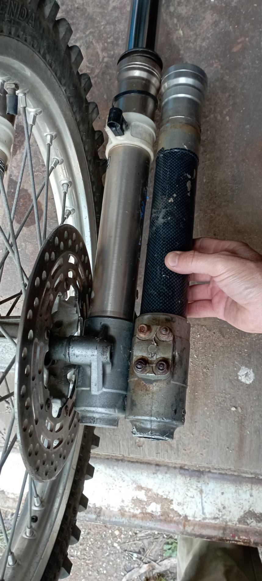

just bought a whole drz250 front end,as you can see from the photos the drz250 does not use the same lower fork tubes as the xr400, when i pull it apart and if i find anything different with the internals i will do a comparison

I remember reading that the valving on the DR-Z 250 forks was entirely non-conventional, not your typical base valve and shim stack. I think I recall something along the lines of some progressive check plate stack?Please post photos of what you find! Race Tech does not have any info on these in their database unfortunately.

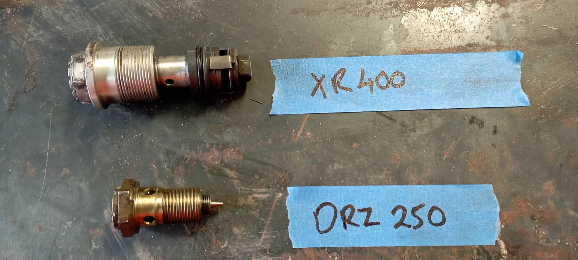

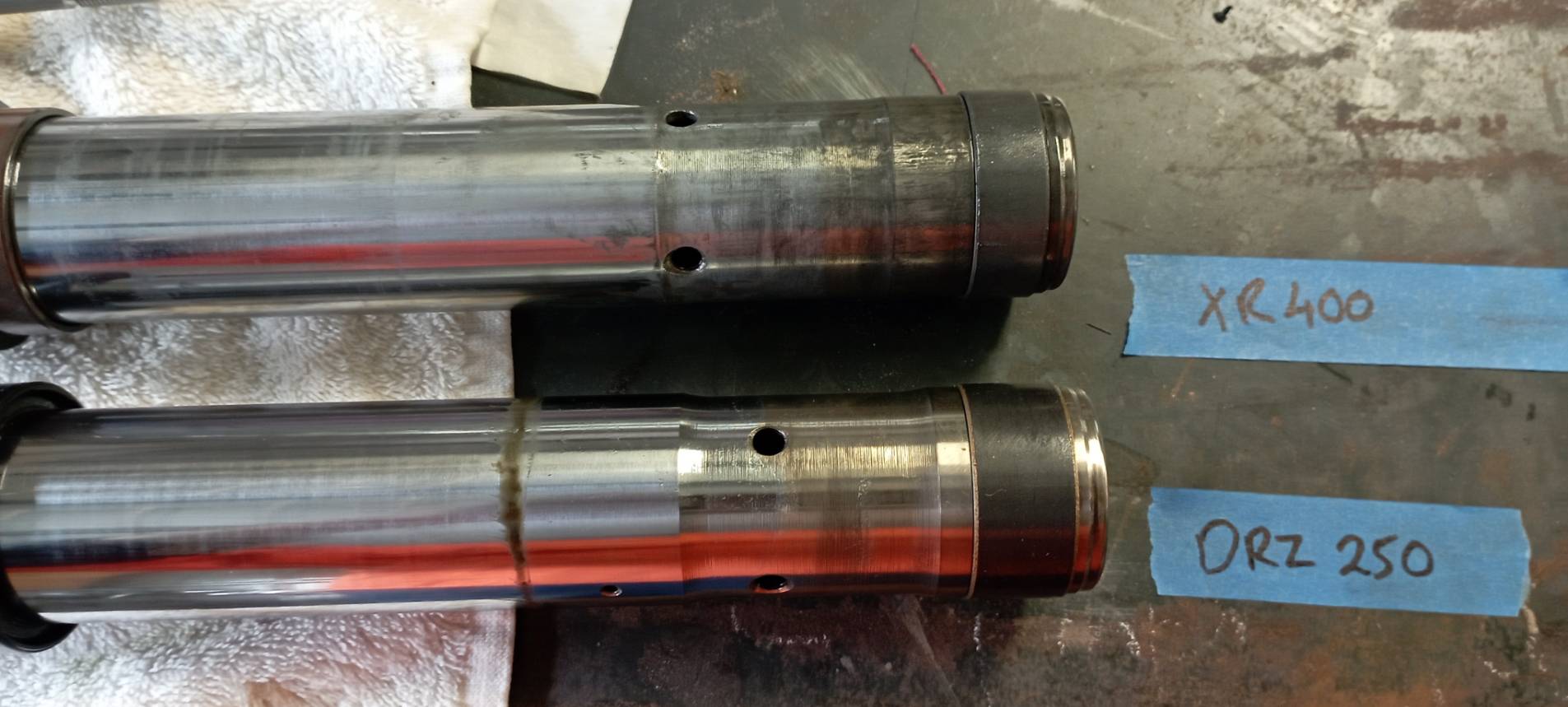

ok drz250 forks pulled apart and i can say the only thing they have in common with xr400 forks is the forks seals, absolutely everything is different and nothing interchanges, i attached some photos, as chuck said the base valve is completely different, looks like the shim stack is pressed in to the cartridge and cannot be removed hence why racetech doesn't have any offerings
the spring is progressively wound,which to me is interesting as i have no experience with progressively wound springs, i plan to try it and compare in my xr400 forks against the stock xr400 springs and see if there is a difference
the xr400 forks on the surface seem to be higher spec but i know through experience higher spec doesn't mean better for a given task, ive rode a few ktms with their high tech suspension and couldn't wait to get off due to the harshness, given my lightweight and slow riding i am all about plushness
