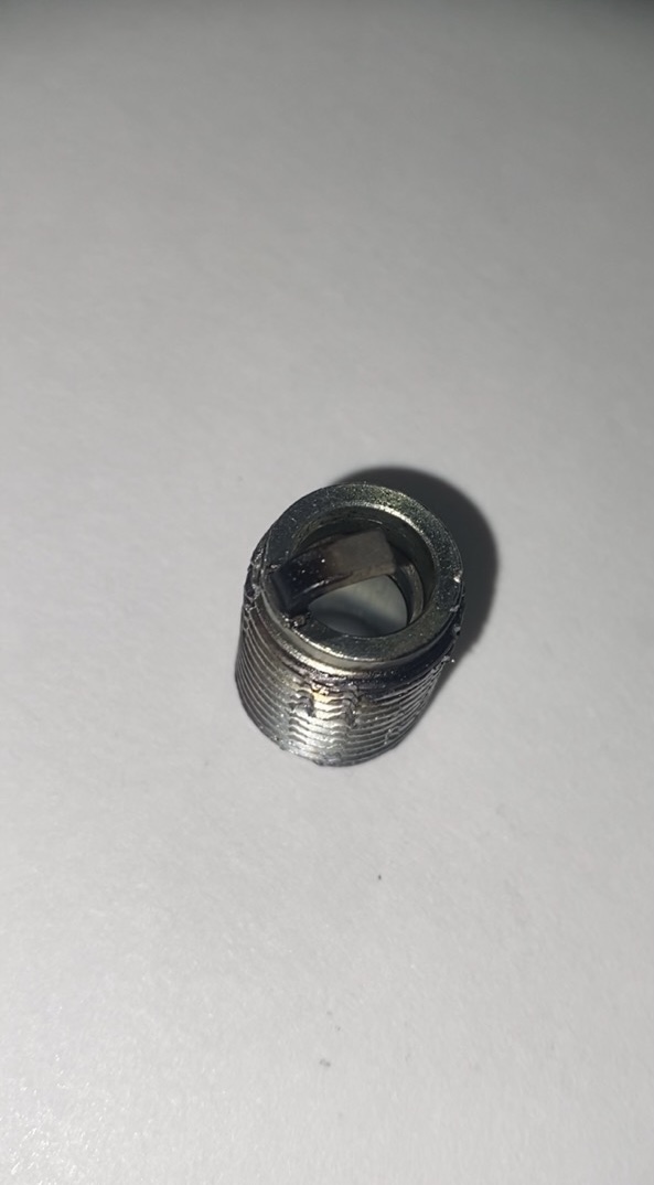

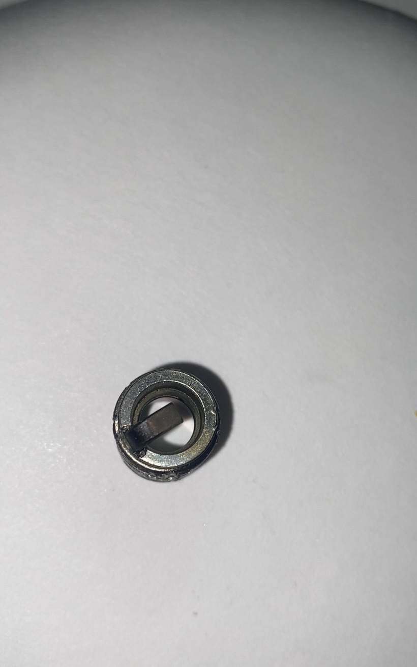

Just revisiting this as the consensus from other people is that I am running the bike too lean in general. These are some pics of what I am talking about. This plug had a couple of hours on it. My jetting for the rb carb is 40 pilot, dek needle 2nd clip, and 155 main. I feel it ran best on the 2nd clip because when I try the 3rd their is some slight hiccups. I think If I go to a 150 main, I can bring it back to the 3rd clip. I’m still very confused on why it keeps looking this way every time I have taken the spark plug out.KDXGarage wrote: 01:29 am Oct 23 2022 The plug should look like hot cocoa.

- 101C4704-D960-4859-833C-8E42C54471A5.jpeg (68.67 KiB) Viewed 5998 times
- 4F5A6C00-F8C7-44B8-BD9E-ACA1A0B2FADC.jpeg (231.1 KiB) Viewed 5998 times
- Posts: 14676
- Has thanked: 66 times
- Been thanked: 20 times
Re: White deposits on spark plug ground strap.
wow
too lean
richen up something somewhere :-)
too lean

Here's a Vespa plug pic off the internet. It should be pretty close to this after some hours.
- Posts: 3557
Start with the pilot and get the right one in there, that'll richen up the entire band, then work through the rest of the jetting guide

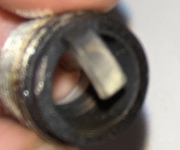

Gotcha. Wasn’t sure, I know on older 4 strokes without accelerator pumps that can be an issue. I rode for about a half hour with the colder plug. Did ride quite as hard as I typically would have but thought I’d share the pics I took. Looks like this is actually may the correct heat range based on the strap. But the ring around the threads has basically no color at all which would tell me it’s still lean. Ignore the messed up threadsJohn_S wrote: 07:57 pm Oct 26 2022 No such thing as twisting it too quick. Just richen up a little at a time until you get it.
- 471F8C44-6572-42BF-90F4-5D2E6828A562.jpeg (92.56 KiB) Viewed 5939 times
- 312E3224-1BBE-405B-8D52-E4969D9186B0.jpeg (119.62 KiB) Viewed 5939 times
- 924B16FE-1767-4ED7-898C-F80317240E81.jpeg (86.37 KiB) Viewed 5939 times
That's a bit too dark. Years ago, I struggled with a 9 in my '94. My jetting was not perfect, but I went from daily fouling to monthly fouling with going from a 9 to an 8.
Yes I think I’ll go back to the 8. I’ll test it with a bigger pilot and see how that goes. I’m hoping that makes a difference in how clean/white the plug was in my first pics.KDXGarage wrote: 10:15 pm Oct 26 2022 That's a bit too dark. Years ago, I struggled with a 9 in my '94. My jetting was not perfect, but I went from daily fouling to monthly fouling with going from a 9 to an 8.
