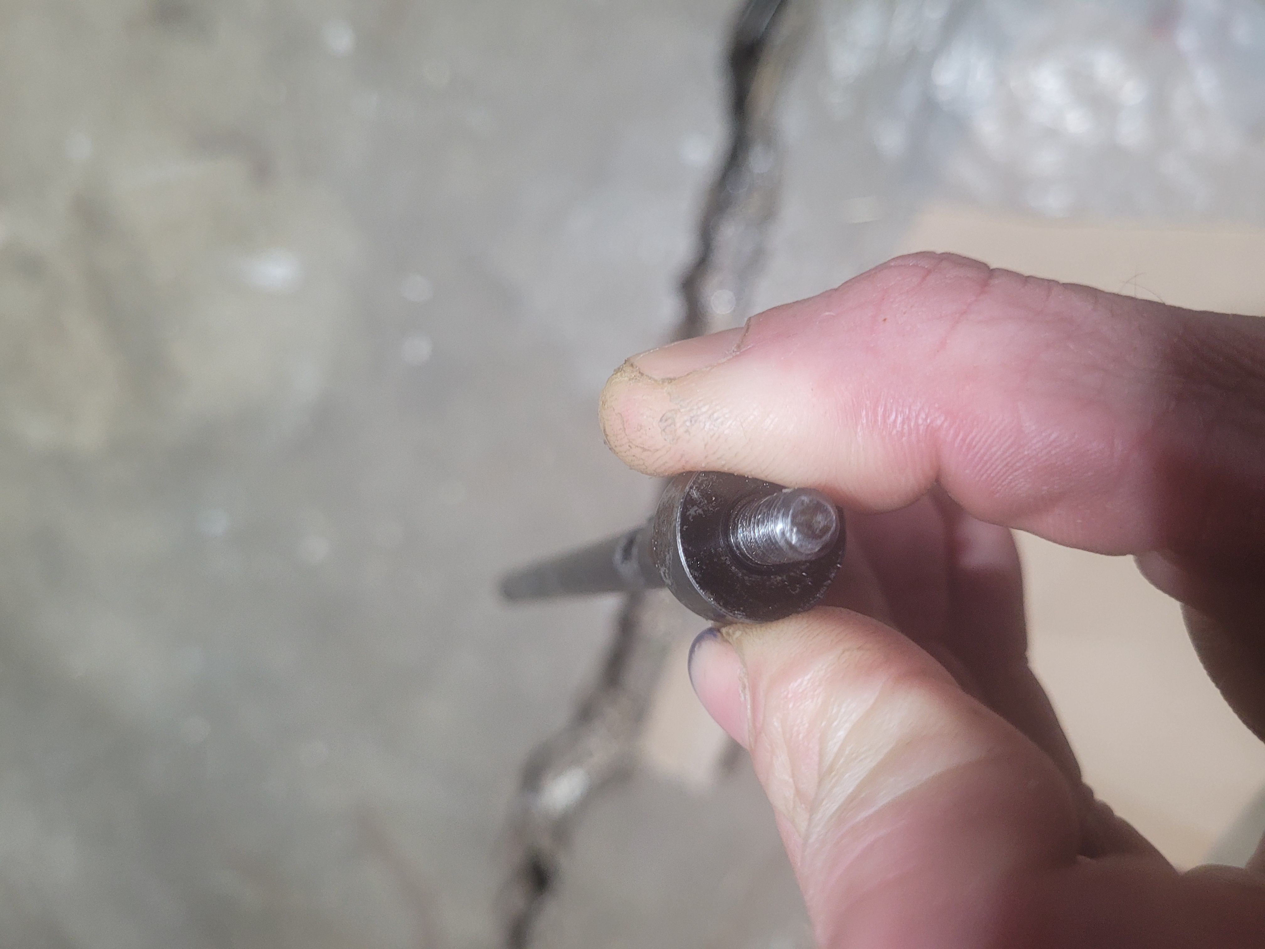

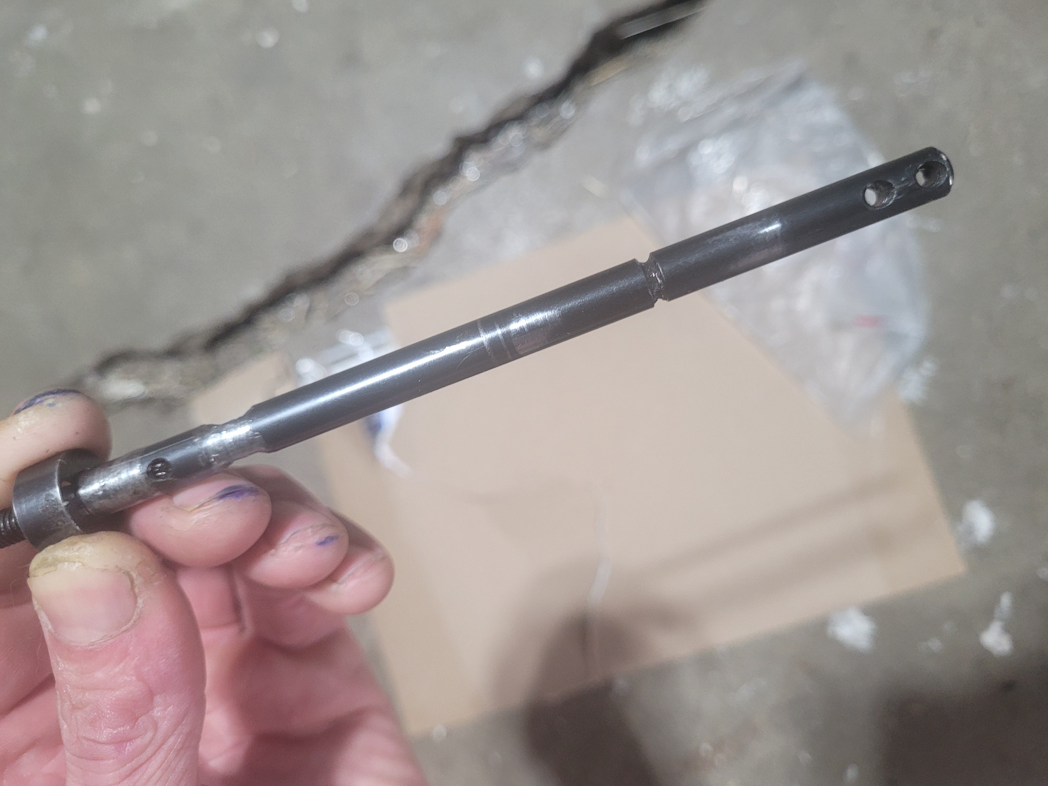

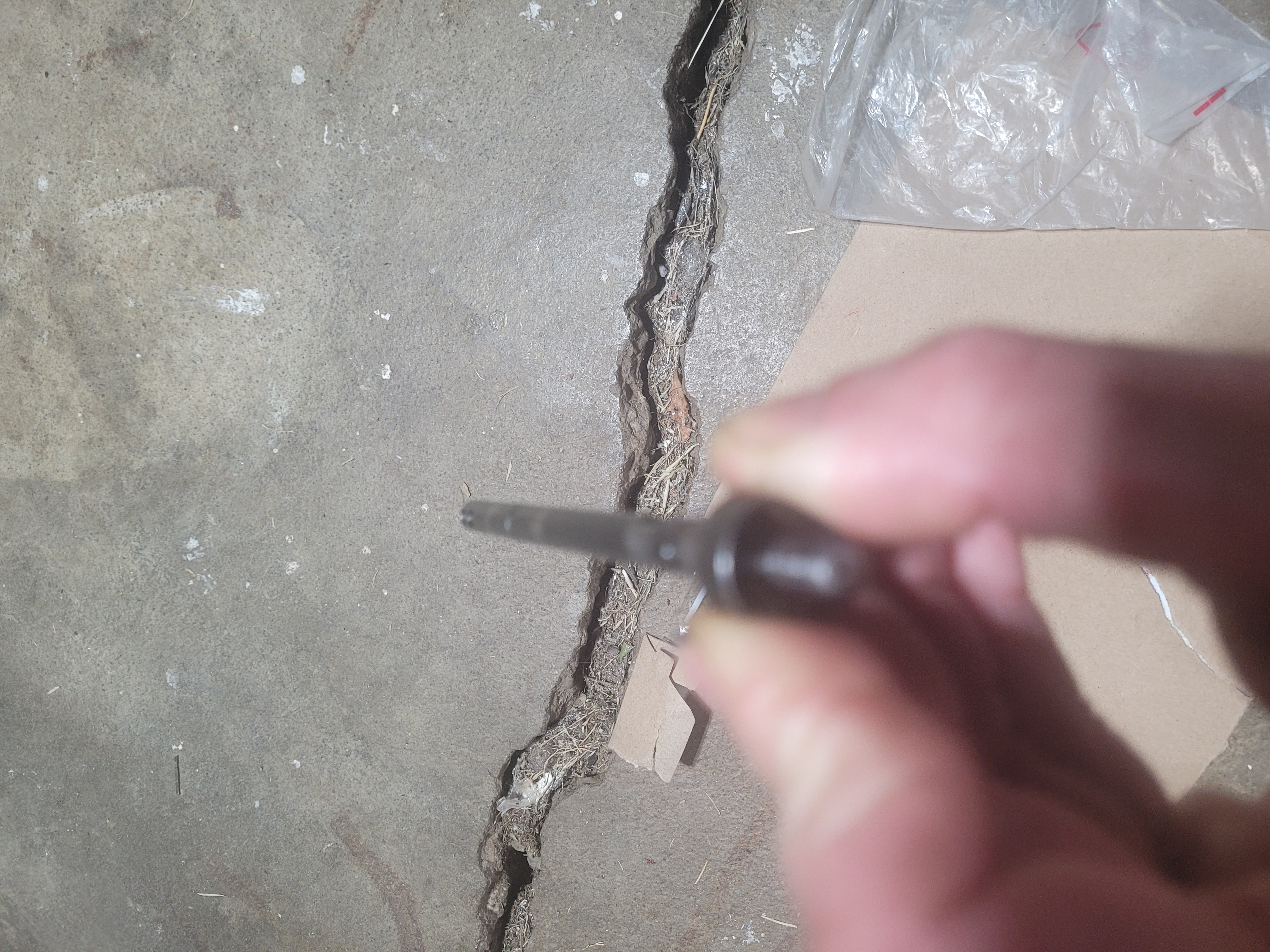

I apollogize in advance for the length of my post. I want to be very thorough as I know that every detail matters. I bought my 95 KDX 200 10 months ago. It would start first kick and ran well, but extremely rich. It was obviously due for a top end rebuild as there was oil leaking from the RH advancer lever cover. I pulled the head and upon dissassembly of the KIPS,
noticed that one of the sub-valves was missing and the other aluminum sub-valve was severely twisted and stuck in the open position. With the head pulled-off, I was able to free the mangled sub-valve from the port. I was also surprised to see that the actual pistion rings were still intact with very low wear of what appeared to be the stock piston ( marked with a C from factory) With the help of previous KDX RIDER posts, I found a pair of used subvalves from an 02 KDX 220 that were in decent shape, then reassemble and time them according to the manual (Although after seeing how badly the aluminum can wear, i strongly recommend a pair of steel ones from the U.K.). I was finally making progress the KIPS properly functioning, or so i thought. Upon firing it up, I quickly noticed that the advancer was not activating the lever. So I pulled the side cover, rebuilt water pump (I could see coolant in oil), and noticed my comp lever pin was broken off and in the bottom of case with what looked like a piece of a metal washer. Eager to find out what this was, I dissassembled the exhaust advancer and noticed 1 of the needle bearings and 1 spacer were damaged. I replaced the broken parts (92026/92046). This leads me to my current issue, I removed the governor shaft with the positioning pin (92043A), screw (220), and replaced oil seal (92049A), yet upon assembly to the side cover, it gets stuck and will not fit in without extreme force. I'm assuming this is wrong and perhaps the shaft may be bent. Any insight or knowledge relating to my situation would be gratefully received. Upon inspection the shaft looks pretty marred up around the support slot.
- 20221003_131654.jpg (2.69 MiB) Viewed 2653 times
- 20221003_131652.jpg (3.53 MiB) Viewed 2653 times
- 20221003_131703.jpg (2.63 MiB) Viewed 2653 times

Ok...After ordering a new side cover, I now realize that Im in the exact same situation I was in when I began this thread. I was able to find one from an '03 on EBAY. It looks to be in great condition. It came with the impeller and shaft already assembled. Bufftester was right, I must have incorrectly installed the mechanical seal, etc. because this one spins freely. There was much resistance while spinning the impeller in my other side cover. Anyways...Unlike before, when i was able to insert the advancer rod (part# 13234-1101) into the side cover with some movement, it doesnt lock into place correctly. If i get it to the right position, it is very difficult to rotate. I'm positive that the rod is bent or warped. I've only been able to locate ONE on EBAY (part was discontinued). If anybody knows of any place I could find a new one, please let me know. Meanwhile, I'm researching what kind of metal this is made of to see if i can have some kind of machinist straighten it. Does anybody have any suggestions or comment? I'm just getting my feet wet when it comes to working on bikes (or any motored vehicle) and I must admit that I've discovered another level of patience that I never knew existed
. I'd be lost if it weren't for this forum
. Thanks again.
Send It!
- Posts: 6117
Re: Governor Shaft
Are you sure they're discontinued? Anyway, any 1995 and up 200/220 use the same shaft so you have a better chance finding one used.
