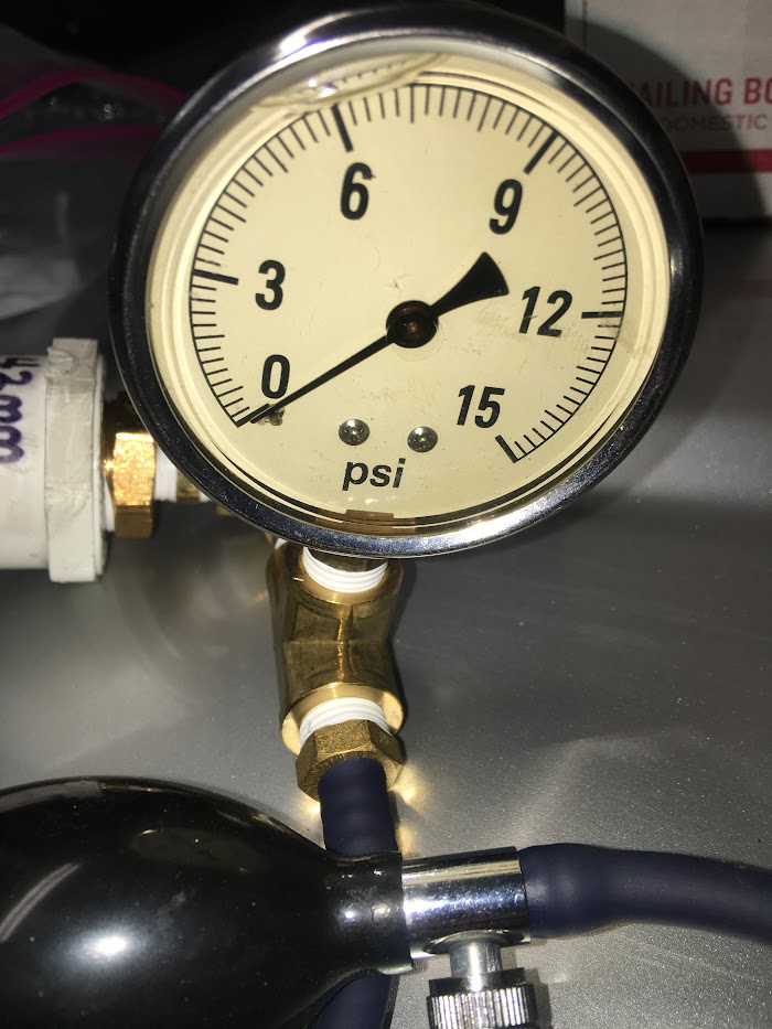

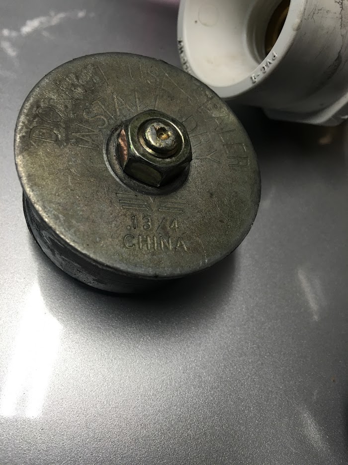

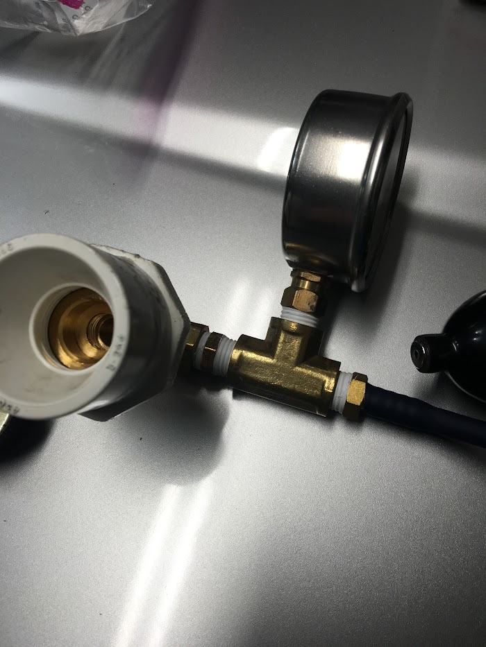

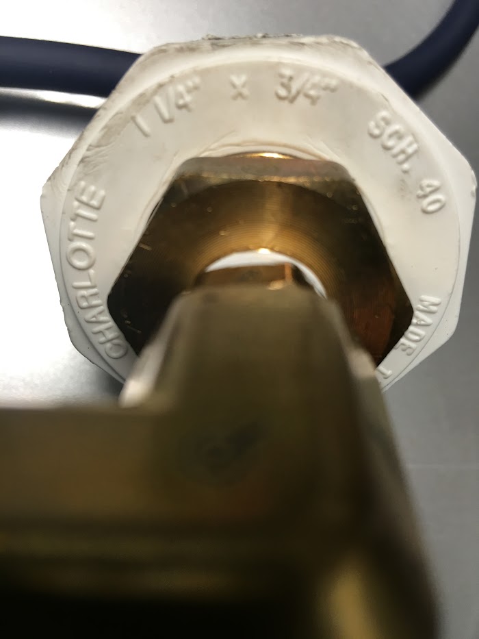

This is an easy to make leakdown tester. Everything is from Ace Hardware except the blood pressure bulb. Instead of the bulb you can just install a shrader valve and then fill it up with a tire pump. I would use a handheld and not a compressor to fill it up. You have to take off your carb and pipe.
Put the tester in the carb boot and the plug in the cylinder where the pipe mounts and crank everything down. 5psi for 5 minutes (or 6 for 6) with no loss is what you're after.
Edit: I just saw a post from SS and that reminded me....take your radiator cap off while doing the test to make sure you don't have any bubbles showing up there.
