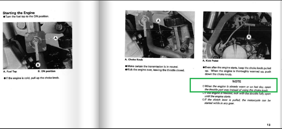

KDXGarage wrote: 02:05 am Sep 02 2022 hereyago.png
Is the something I should be able to click on?

JZ05220r wrote: 06:23 pm Sep 03 2022
Is the something I should be able to click on? Never mind just needed to load. Thanks
Oh their we go. Awesome response. Thanks
