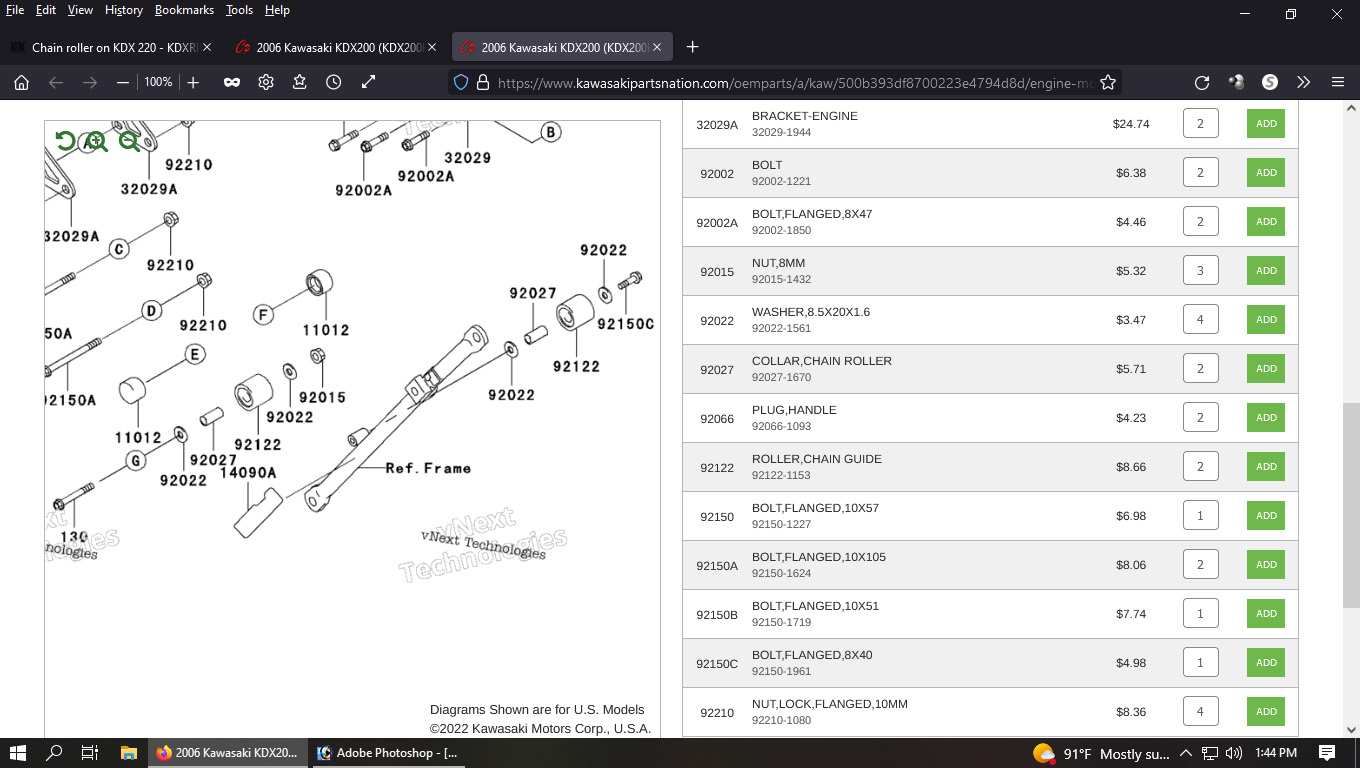

Hello all. I lost my chain roller (bolt and roller) last ride. I did not remember loosening it for my rebuild…so maybe I did but it is now gone!
I cannot find the parts in the diagram so I bought this: https://www.allballsracing.com/79-5001.html
The bolt is too short. Can you confirm that I only need 1 bolt, 1 washer and the roller and that’s it? No bracket there of any kind?
Anybody have the parts number for this?
Thanks.
Chain roller on KDX 220

Re: Chain roller on KDX 220
The factory parts are listed under the "Engine Mounts" section in the various online parts suppliers.
Anyway, no extra bracket. You didn't say which chain roller you lost, the upper or the lower. The upper consists of roller, one bushing, two washers, and the bolt. The lower is roller, one bushing, two washers, one bolt, and one nut.
I lost the lower one. Thanks for pointing it in the diagram!
