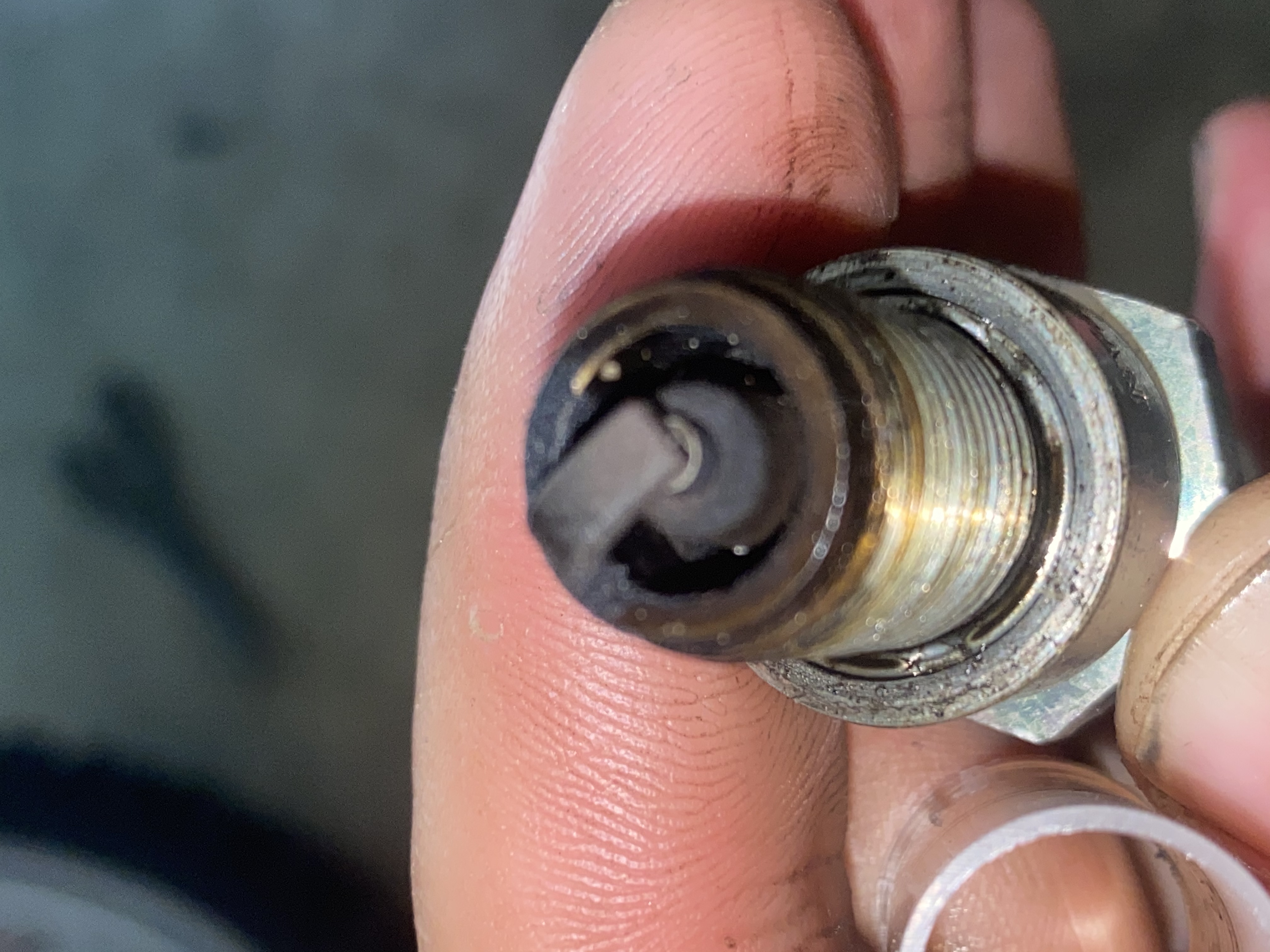

Re: 220r only 90 psi after 4 hours on FRP ported top end
What is your technique on measuring the compression?
Can you please post a picture of the end of the spark plug?
Thank you.

Was that a fresh plug?

Posts: 662
Re: 220r only 90 psi after 4 hours on FRP ported top end with cheap gauge. Will update with better gauge.
What are those sparkly shiny aluminum specks on your plug?

Molly's 70 wrote: 03:41 pm Jul 12 2022 What are those sparkly shiny aluminum specks on your plug?
I think they are from sitting open in the garage for a few days. I swapped the plug at one point so it was just lying around for a bit.
