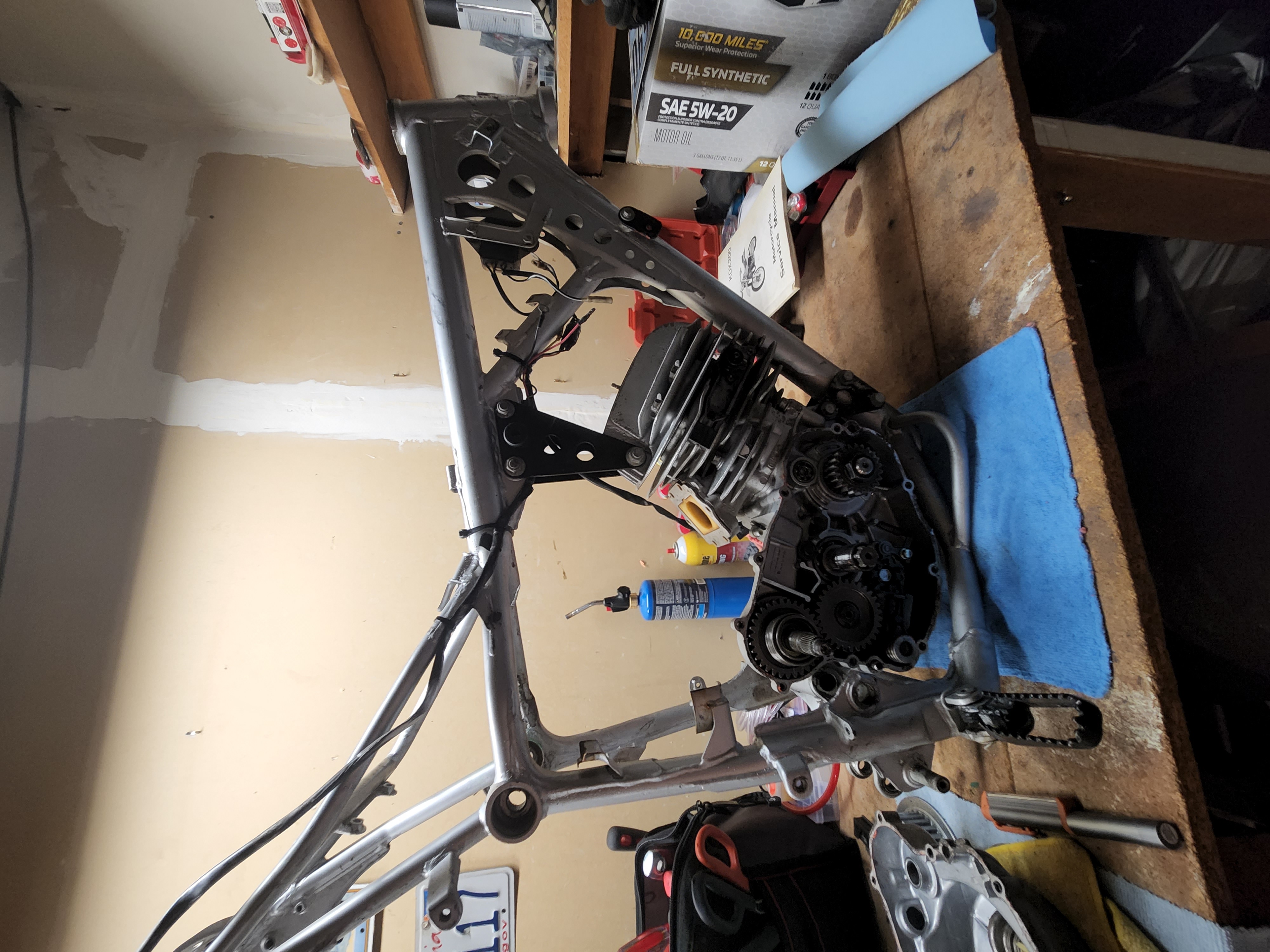

Right now I the bike is stripped down to motor and frame. I'm going to start building it as follows:

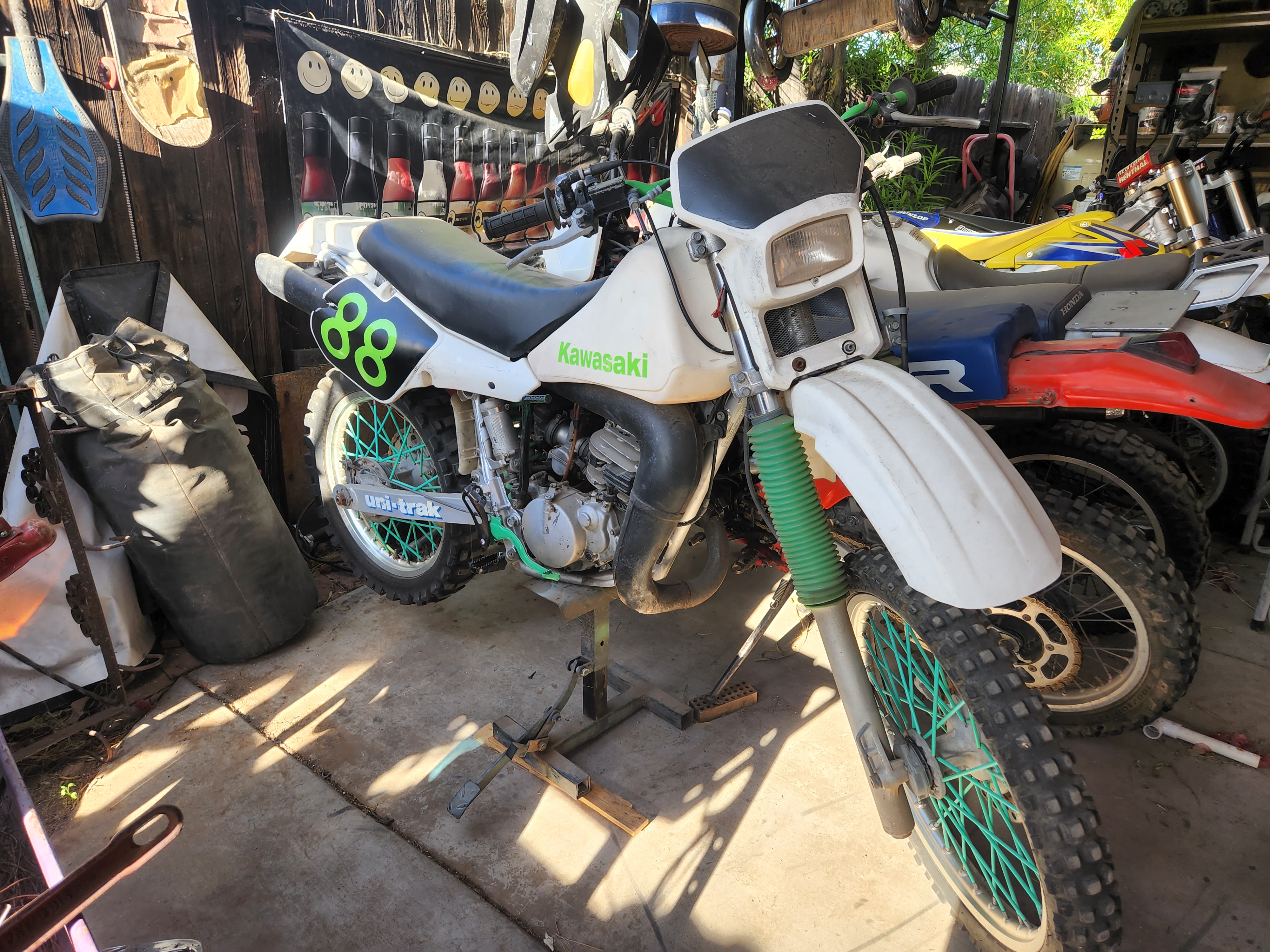

Code name 'TRAILGHOST' for the color and application of the bike. Here are some pics:

Congratulations on the KDX.
Good luck with the project. Take your time.
One note, the front brake hose needs to go inside the fork leg, not out. It can get caught on roots, limbs, rocks, etc.

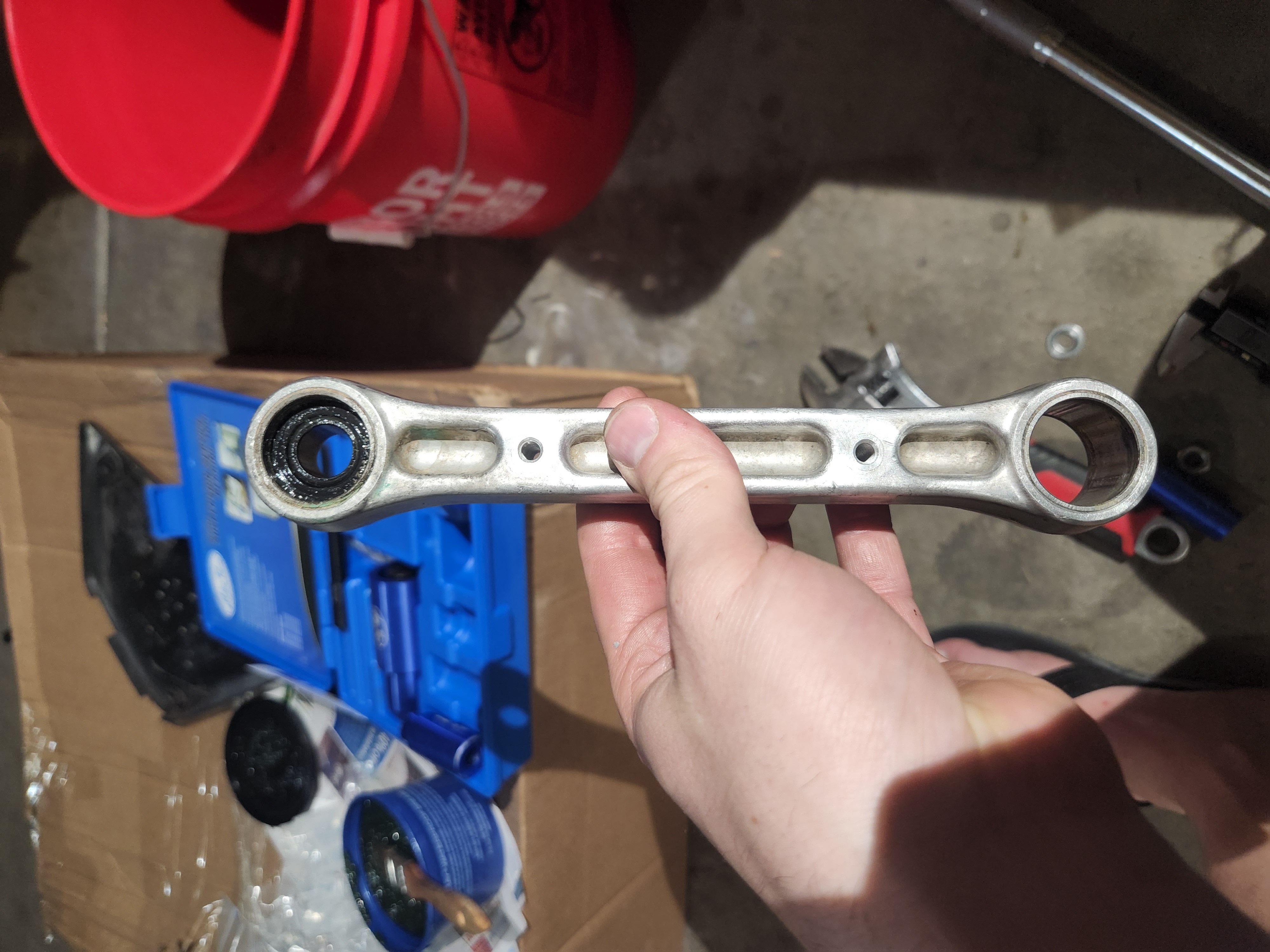

Updates: New steering bearings, swingarm bearings, wheel bearings, and linkage bearings. Cleaned up clutch cover and triple tree. Waiting on fork and shock springs

HEY! Looking good there.
Where did you buy new linkage bearings for the dog bone? Did All Balls have them? I seem to remember they might have had a kit at some point.
If the rubber chain guide blocks are dried out, a guy on eBay (or two) make homemade replacements (and carb and airbox boots). Hotfootmoto and another seller.
Banshee's Veil
Posts: 8
Joined: 05:19 pm May 19 2022
Re: My 1988 KDX200 Build "PROJECT TRAILGHOST"
Post by Banshee's Veil »
KDXGarage wrote: 01:55 pm Jun 05 2022 HEY! Looking good there.
The kit #27-1106 from all balls for select kx250 and kx500 has the linkage arm bearings and dogbone bearings. Also the linkage arm bearings are the same as the swingarm. I have a motion pro bearing driving kit that greatly helps pressing them into place!
