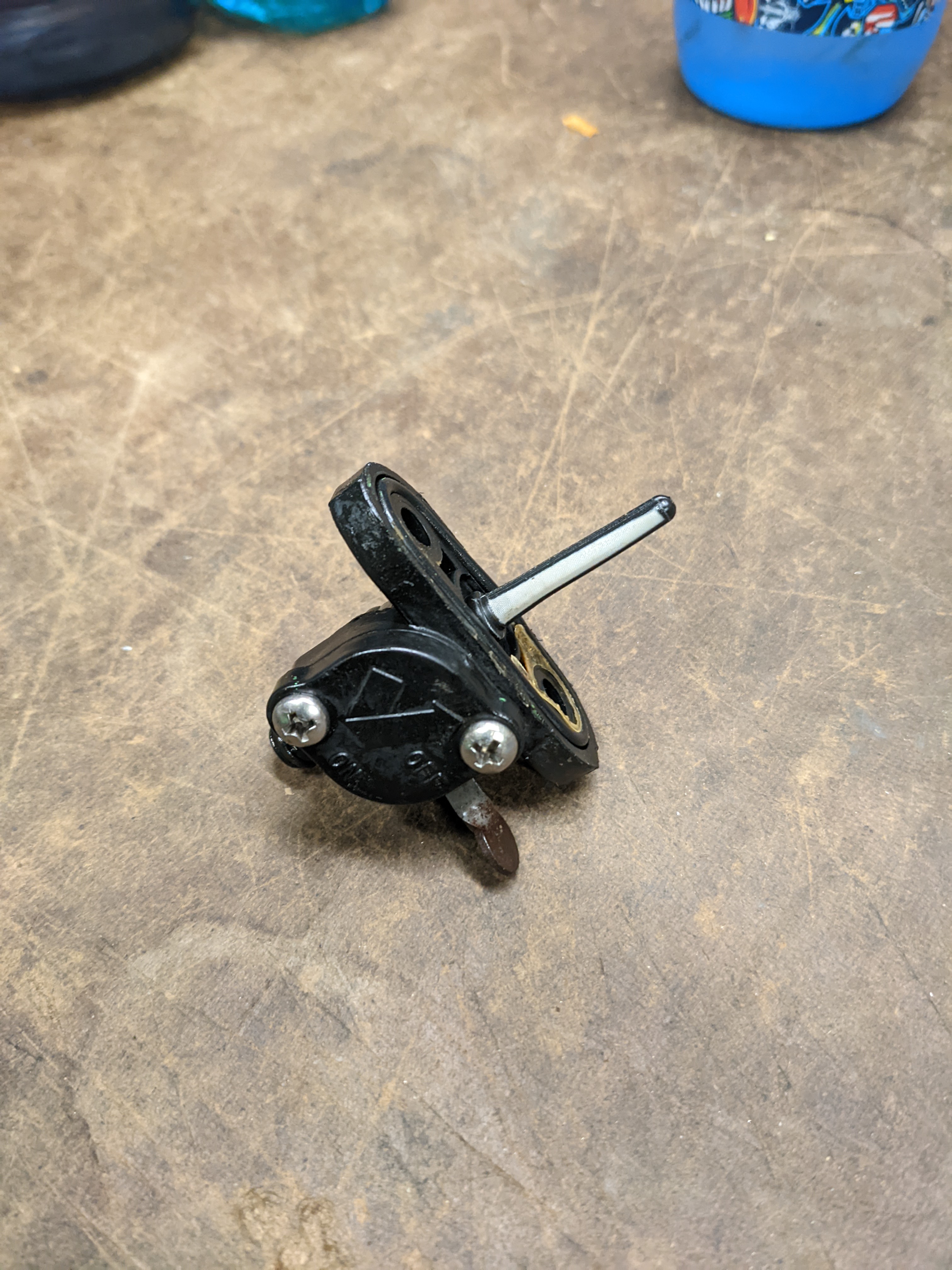

Hi, I'm new the forum. Thanks for the add. Working on a 1980 KDX250 (dual shock). Does anyone know where I can get a replacement petcock? Or, one from a different bike that will work? It's the plastic type with no reserve and the tube is in the middle. Thanks.

Welcome. Thanks for joining.
https://www.partzilla.com/catalog/kawas ... -kdx250-a1
Here's the other bikes it came on. You may be able to just buy an aftermarket petcock.

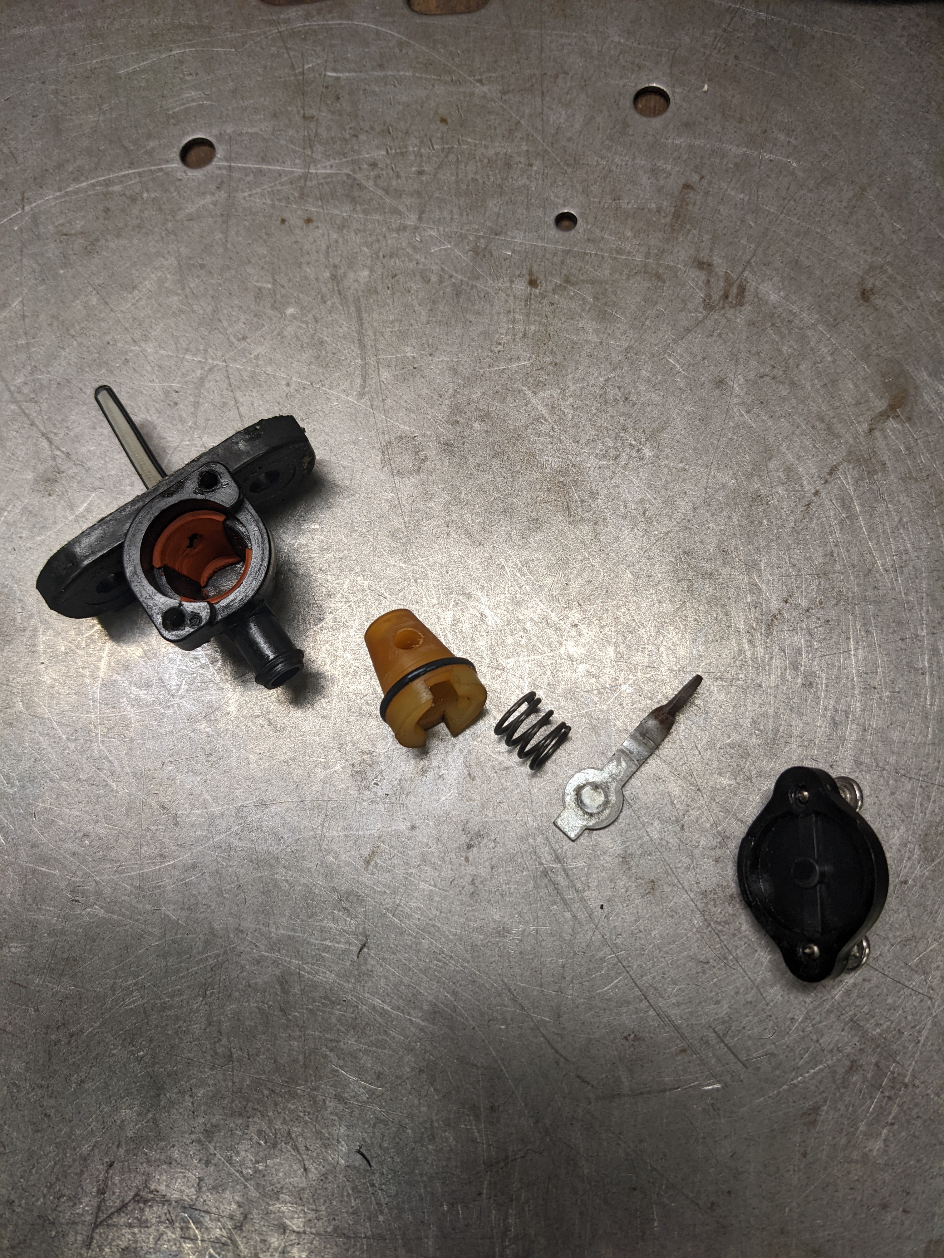

Good idea slotting out the hole in the tank. Would rather alter the petcock though if possible. It comes apart easy enough, but it is not a normal petcock design. It has a cone shaped plastic piece with a hole running through it. The lever is attached to the cone and a spring keeps it tight against the rubber lined inner body of the petcock. Never seen anything like it.

I had an old Suzuki that had a petcock like that. Even after rebuilding it time after time the damn thing would always start leaking again.

WOW! That's even before my time. Yeah, replace instead of repair on that one.

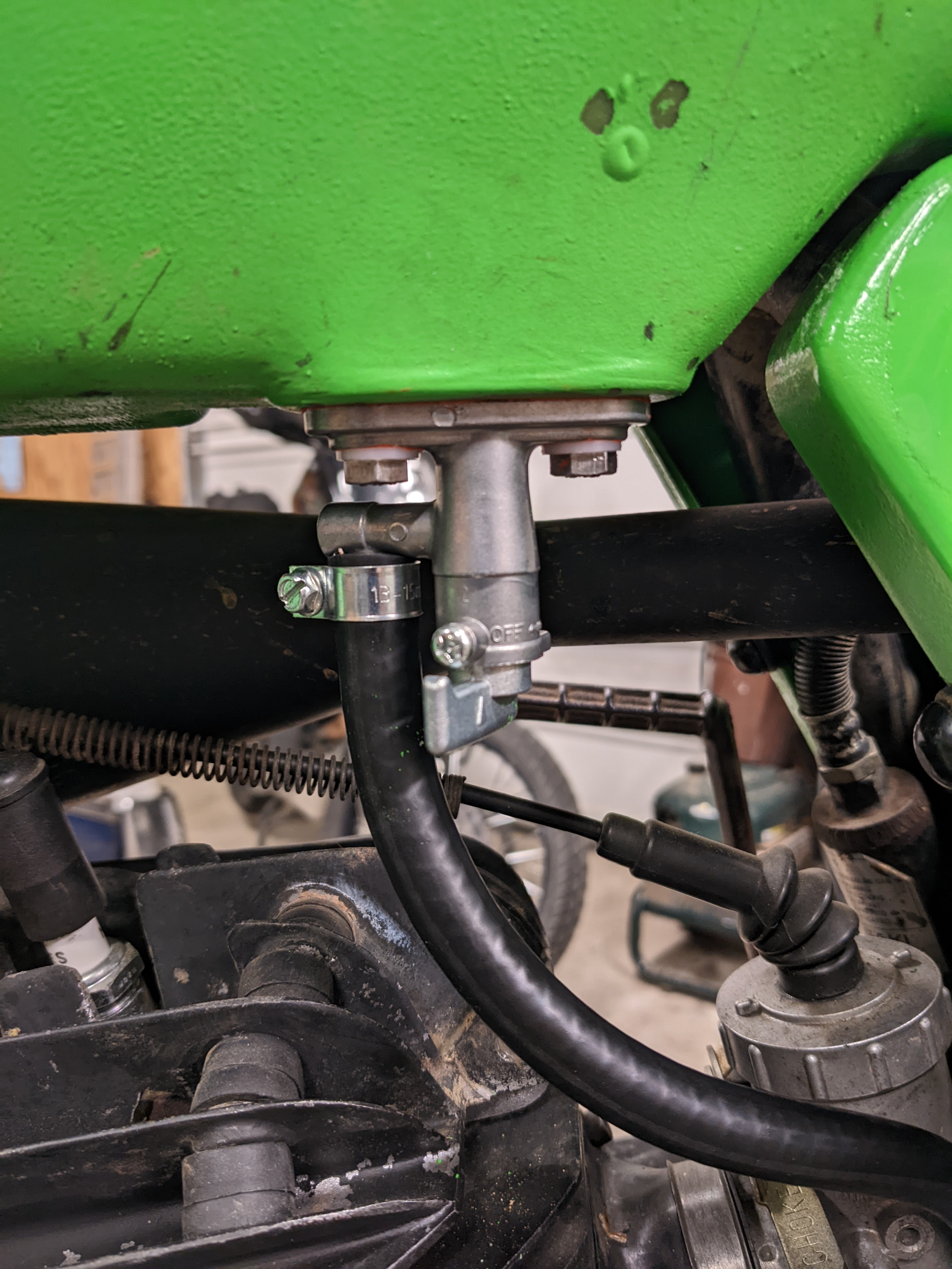

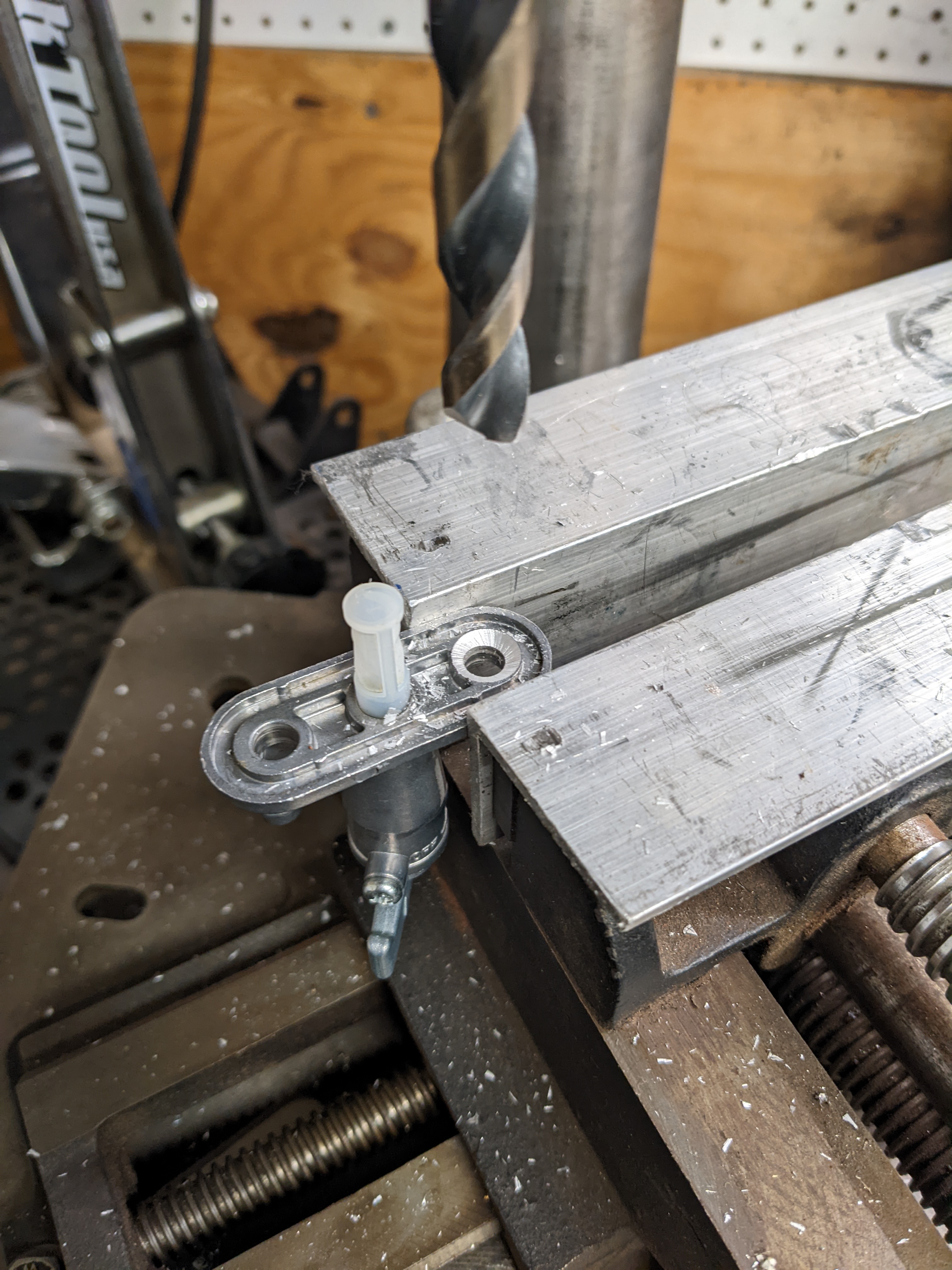

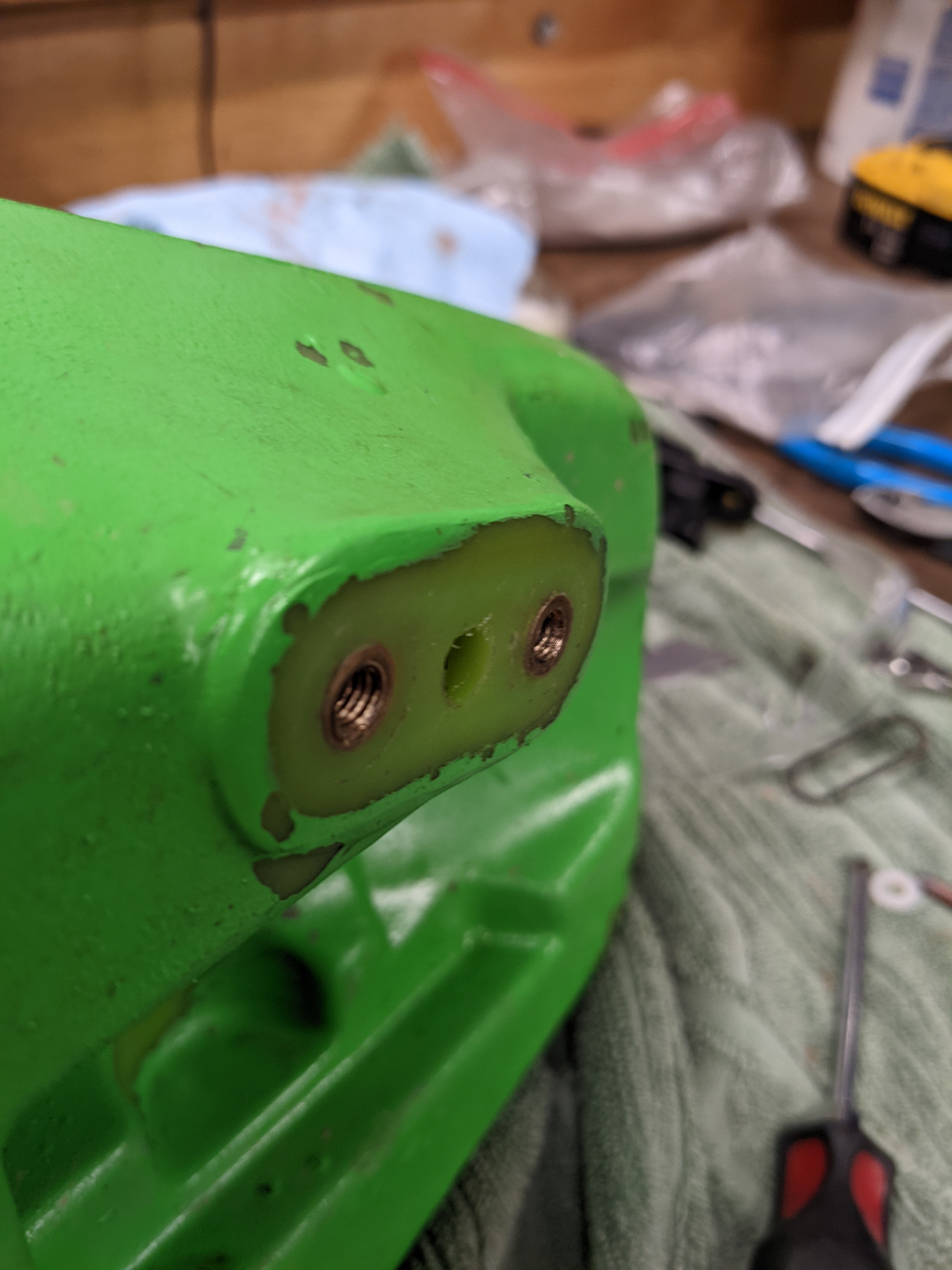

The eBay vintage YZ petcock above worked! I had to make the hole in the tank slightly larger. I also had a hard time keeping it from leaking. I figured out that the brass inserts protrude a little from the tank preventing the base from pressing down far enough on the o-ring. So I drilled an indent so that it could cinch up tighter. Plastic petcock didn't have that problem. Used Permatex Ultra Copper to seal up the bolts with some plastic washers. Not sure if that will hold up for gasoline though. Here are some pics. Thanks again for all of the suggestions.
