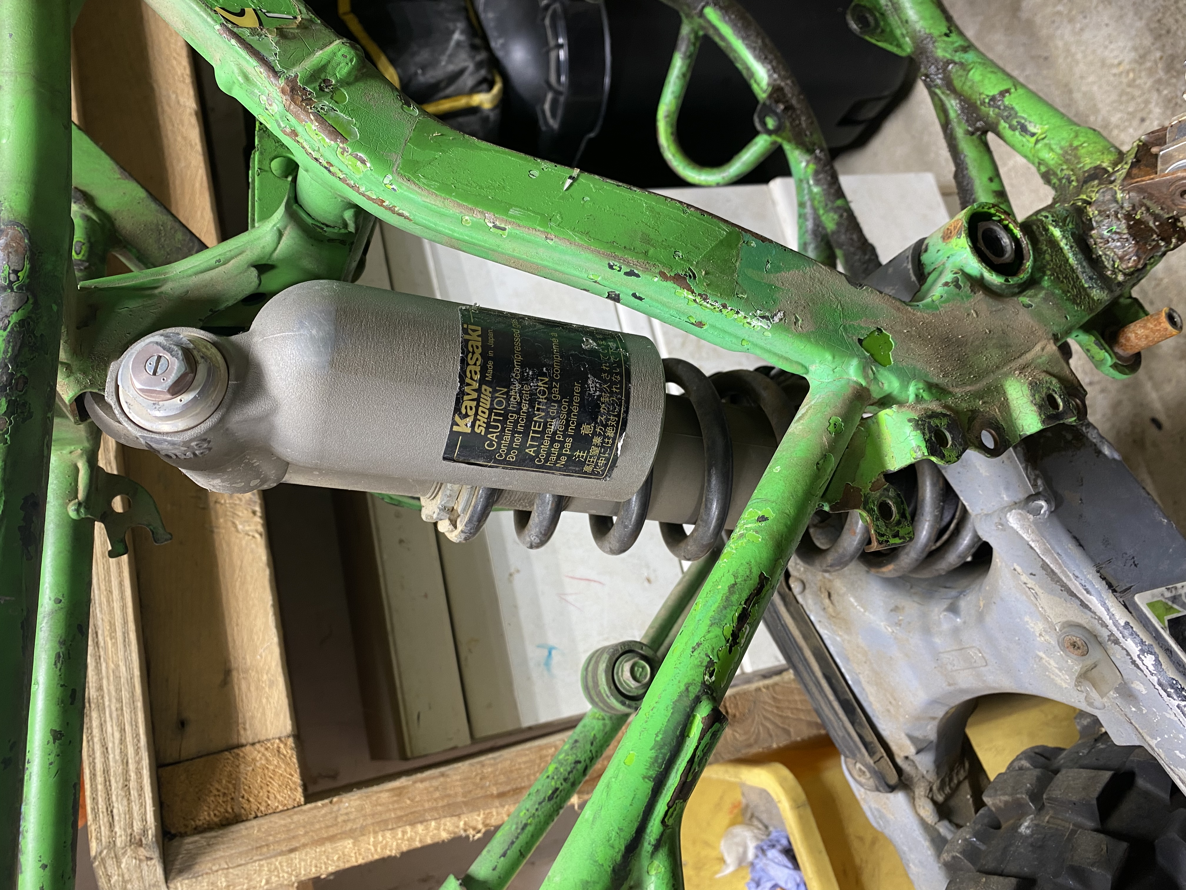

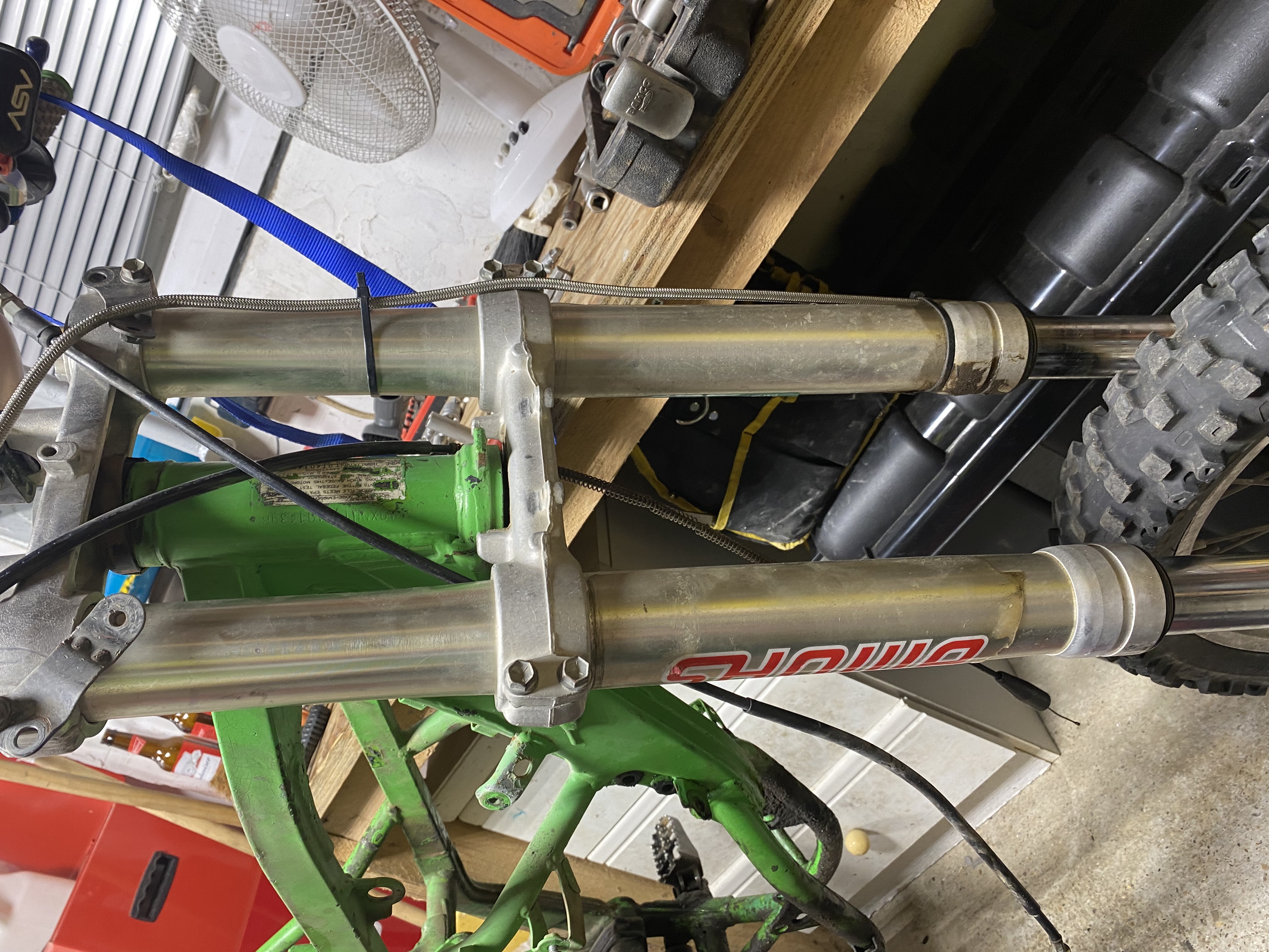

Hi guys can anyone assist with the identification of this US Import to the UK Kdx 200 1996 forks and shock , the triples are stamped with kx 125 J on the underside and the shock looks modified or just not right
Posts: 14676
Has thanked: 66 times
Been thanked: 20 times
Re: Kdx 200 1996
2006 KX250F ??
I think 2006 was the first year for a full-sized KX shock from Showa. 2006 was Showa, front and rear for the KX250F.

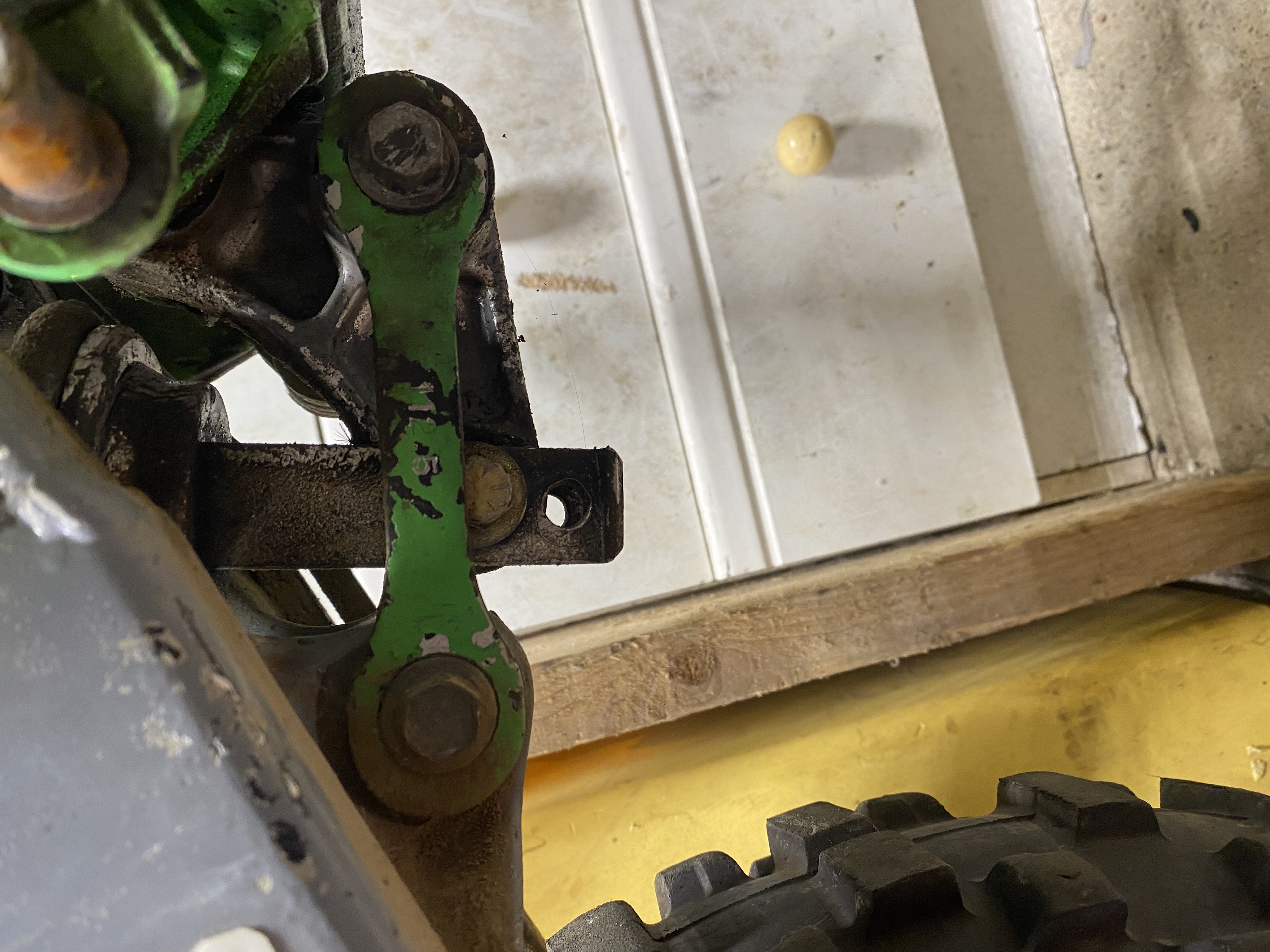

Do you think the lower shock has been drilled out to fit , as it has that hole and sits lower down, looks like that it has aftermarket lowering link also but not sure
Posts: 1691
Been thanked: 2 times
Re: Kdx 200 1996
That shock is off a 2006-2008 KX250F. The clevis has been hacked up to fit. I wouldn't run that. Also, the brake line is just zip tied to the forks? :shock:

The forks are definitely not '06 KX250F forks as I have those on my KDX. The top cap/adjuster, the fork guard mounting, and the triple clamp color is all wrong. However, I tried looking but I can't find anything with that particular fork cap.

Yeah not happy with rear shock being drilled going to swap that out for original or alternative
The foot pegs are welded on the wrong way round again coming off and being replaced
Was just hoping I can rescue the front end

What size are the forks? Those almost look like 43mm KYB’s off a mid 90’s KX
Are the right side axle pinch bolts just clamped down around the hex head of the axle? :shock:

Maybe the forks just have a Showa sticker on them. Check the lugs for numbers and letters. Math those up with some eBay listings.
At least someone was trying stoppies on pavement to wear the tire like that. :-)

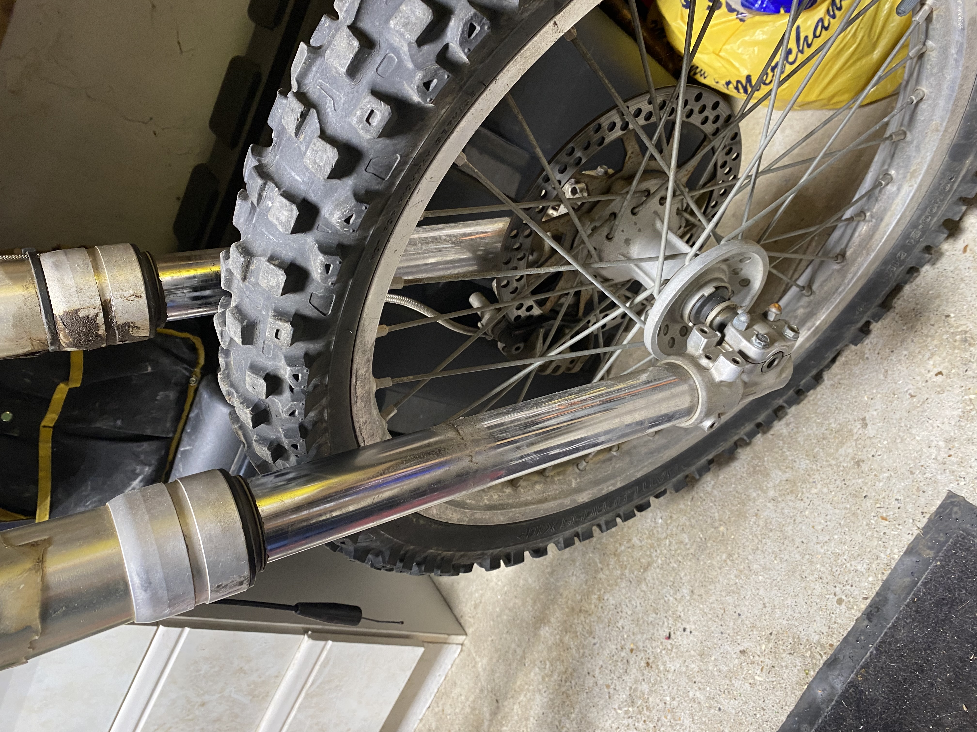

Some dimensions of front end
Posts: 6174
Has thanked: 13 times
Been thanked: 21 times
Re: Kdx 200 1996
So, older 43mm forks. I still didn't find anything when I looked but that does narrow down the year range a bit.

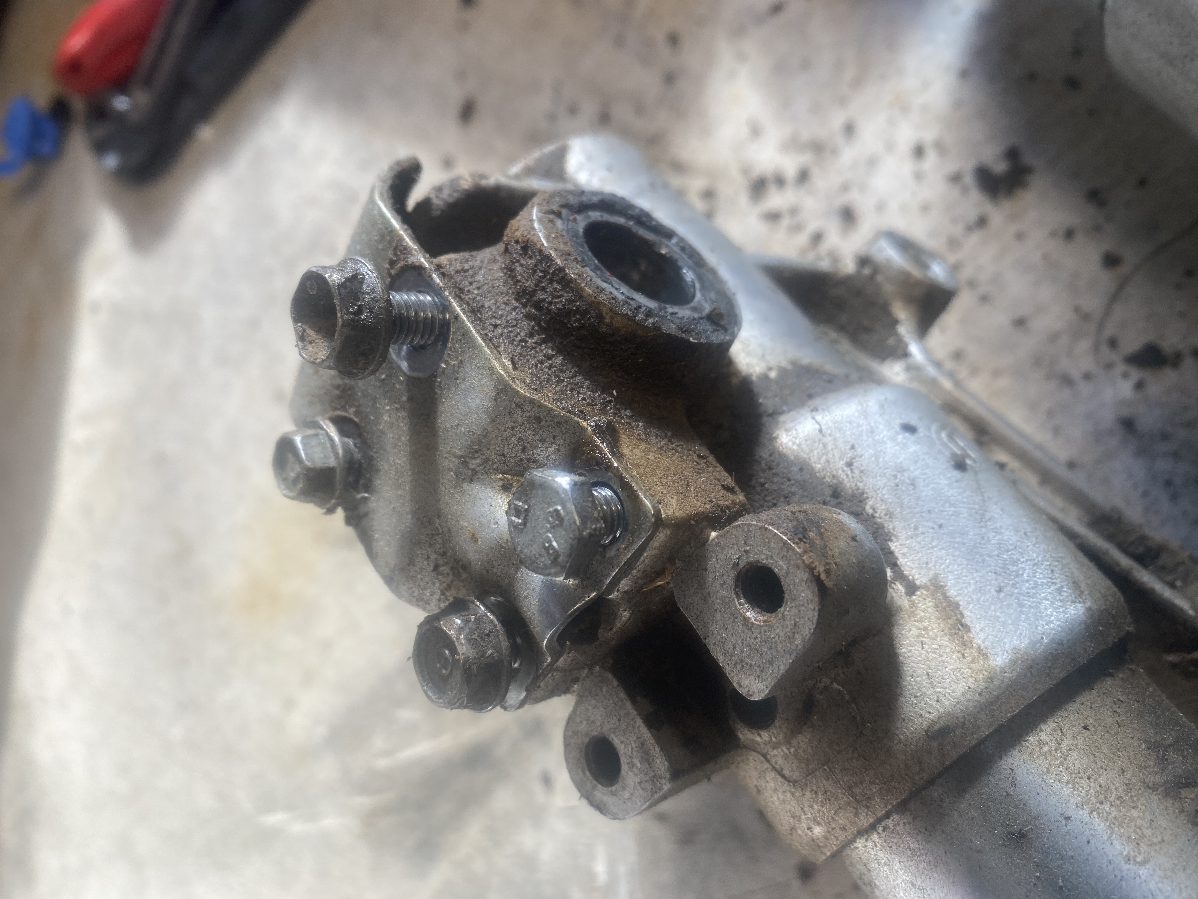

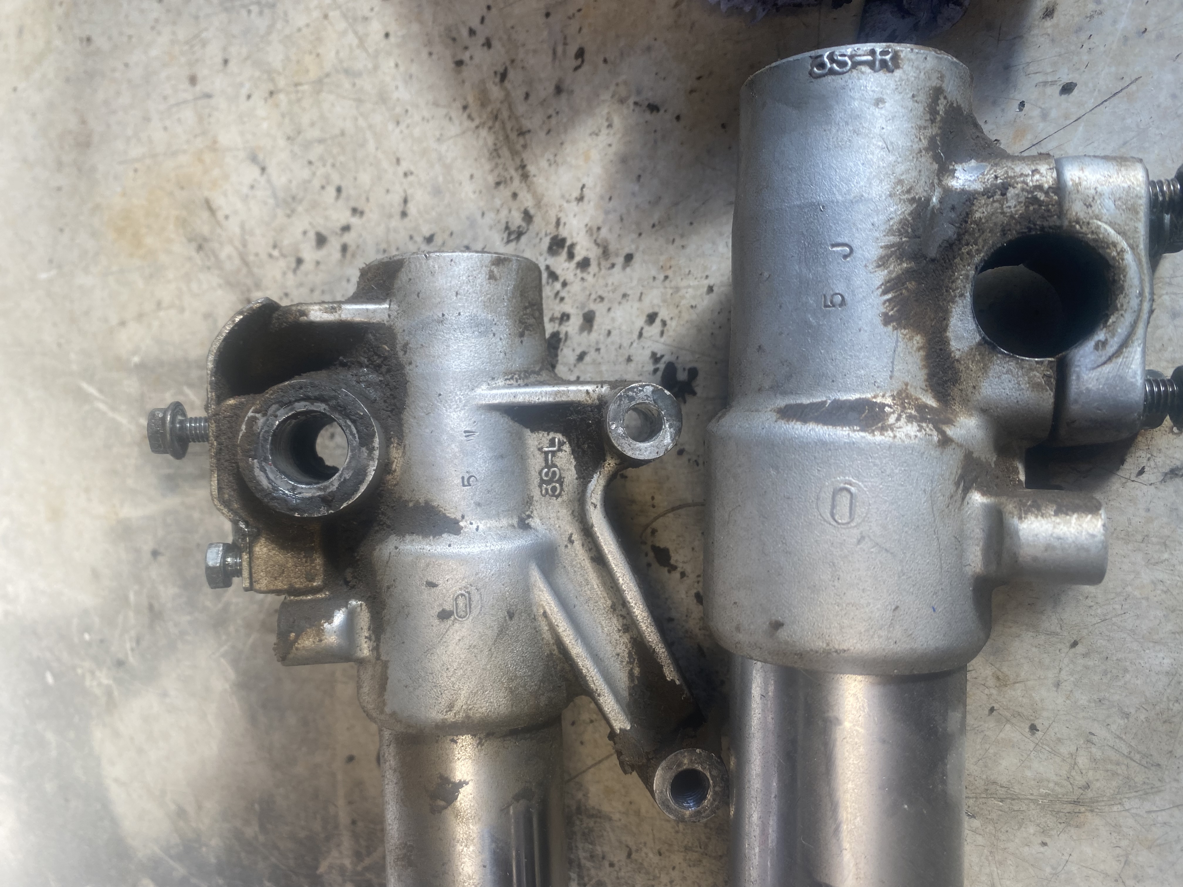

Update on forks now I have them off
Kipsy
Posts: 54
Joined: 02:00 am Aug 23 2021
Re: Kdx 200 1996
Post by Kipsy »
I thought these looked familiar. They look just like my 1992 WR200 forks used to look with that little plate to hold the speedo cable, except that the 200 forks were 41mm. So a little ebay searching and it looks like 1992 YZ250 forks.
https://www.ebay.com/itm/325024545962?h ... SwBuhh93YW
https://www.ebay.com/itm/292397335682?h ... OSwMqBaUBo~
OR
WR500 forks
https://www.ebay.com/itm/144361351321?h ... SwlQ1h1ykE
Strangely I couldn't find any 1992 WR250 forks with the 3S marking. Image searching parts though isn't always the most accurate, though.

Been searching myself and the more you read the more you realise that people have made all sorts of combinations work , I think it has the kx 125 triple clamps and these have been packed out with a spacer , bit of a Frankenstein this one 🤔

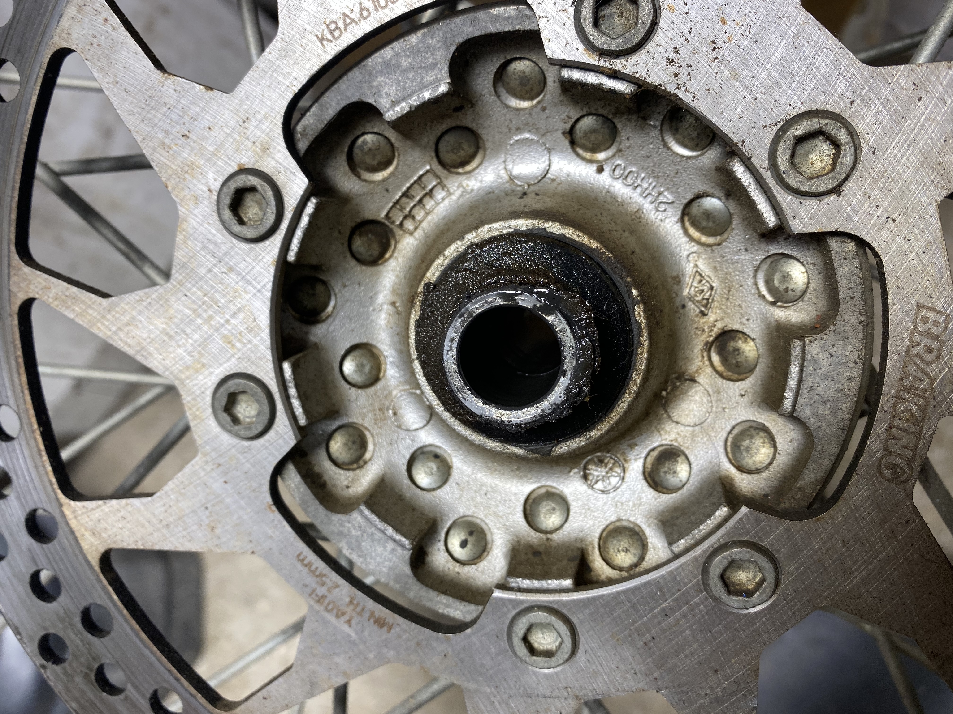

Front wheel and hub if anyone can identify
Posts: 14676
Re: Kdx 200 1996
well, yeah, Yamaha emblem on the hub (tuning fork) kind of means Yamaha parts. :-)
790 on the rim means July 1990, so from a 1991 model
