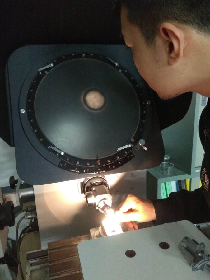

this is the kind of response i expected and all i ever got when asking jetting questions, the needles were the problem, they were too rich on the straight diameter which is now why i now use an 1175 with none ethanol fuel, i genuinely believe jetting bikes close to the equator with altitude thrown in to the equation is different to other parts of the world , i was told my carbs were worn out but it wasn't the case and just to show how indepth i researched it, ive attached a photo of testing emulsion tubes at a technology university using a mituyo light meter, if you can find another person that went to such great lengths , the rb carb wasn't worn out, the chinese pwk was of excellent quality and the emulsion tube was within 0.01mm accuracy, and that was to the lean side, i also tested another genuine pwk with the same tolerances, my point being if people are complaining a JD red needle is rich people shouldn't keep repeating "nothing wrong with the needle"John_S wrote: 08:10 pm Mar 24 2022 Kdxdazz, I remember all the posts you had about your rich idle and trying to work with worn out used carbs and grinding your own needles. There are so many needles that a brand new PWK would idle perfect with on a KDX. I live in hot, humid Florida and I could throw in a stock needle, CEL, DEL, DEK, JD blue or JD red and have it start one kick and idle just by messing with the air screw a little. The needles were never your problem.

having said all of this i have purchased a 34mm lectron with a 3-2m needle which i hope will be a success
- mituyo light meter.jpg (82.39 KiB) Viewed 2098 times
