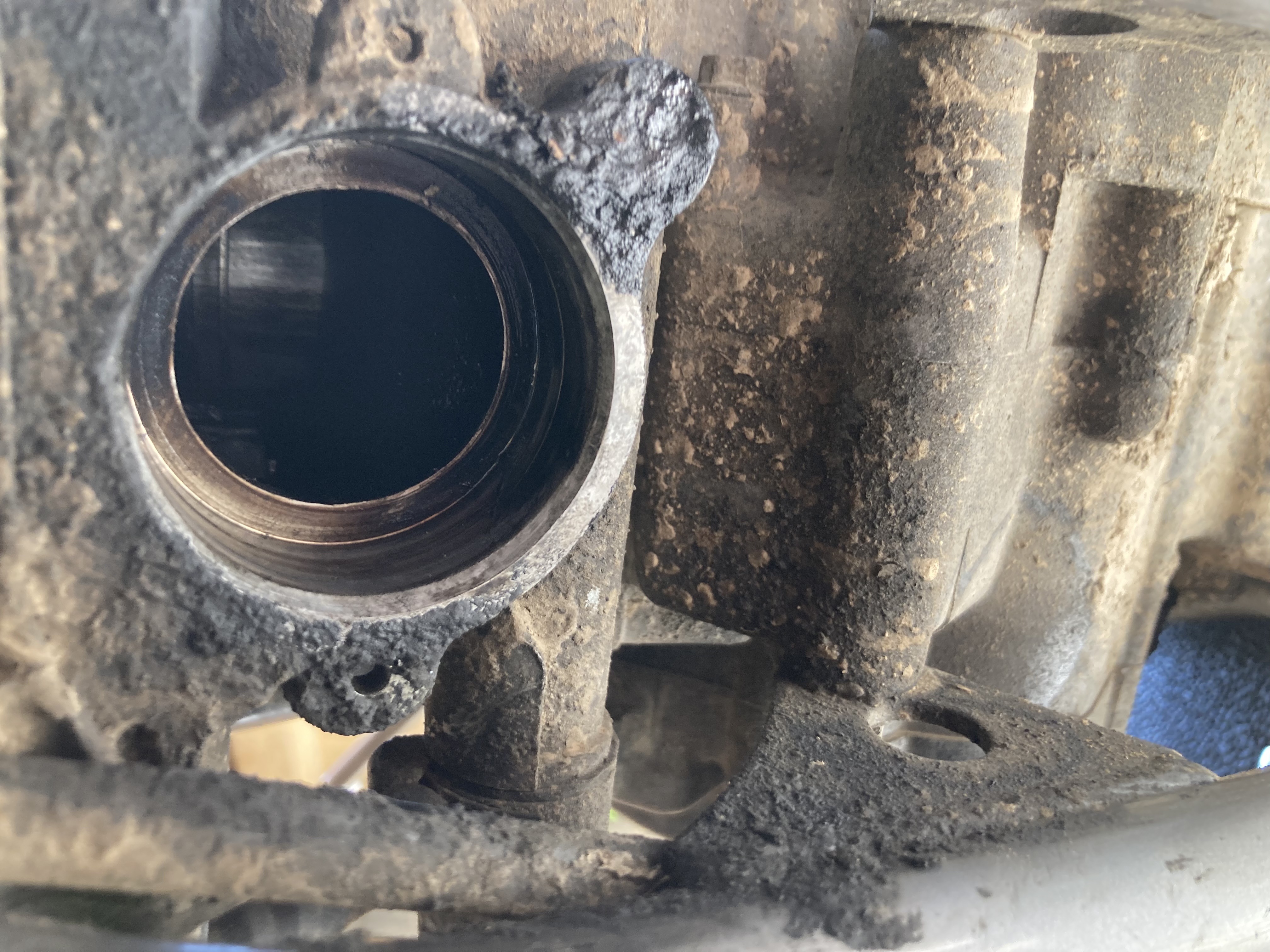

Thanks for your quick reply. Have u seen the video behind the link of my last post? There you can see my KDX were i habe pulled the pipe and i am moving the kips 😁☝🏼

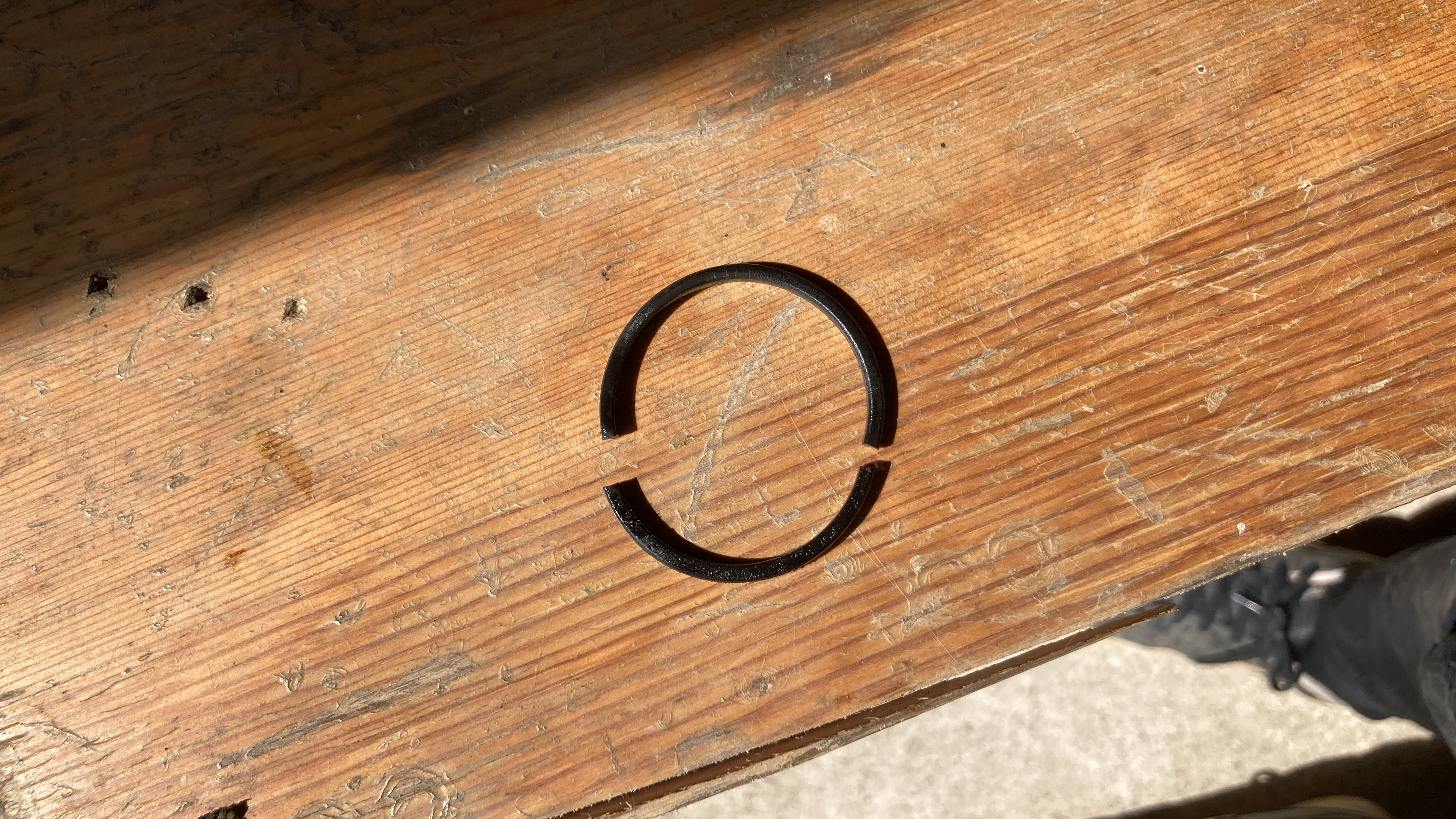

Good deal. didn't see it in the video but did you make sure the right subvalve was working also? If so, KIPS is good to go! However, checkout kdxazz's videos about the KIPS rattle: viewtopic.php?f=77&t=25522 and viewtopic.php?f=77&t=25525 While I do disagree with parts, he does cover some things that should be checked if you have excessive rattle from the KIPS and ways to fix it.
Re: KIPS rattle too load?
There is the copper gasket mentioned in a different thread.

Ok, the power valve is rappeling as hell 😁 you can see here in my video.
https://youtube.com/shorts/x2wd8o6fkBA?feature=share
Im trying the thing with the copper plate from the video above 👍🏼
Is there a special type of oil i should use when i reassembel the Kips? Should i use Locktite for these two screws?
