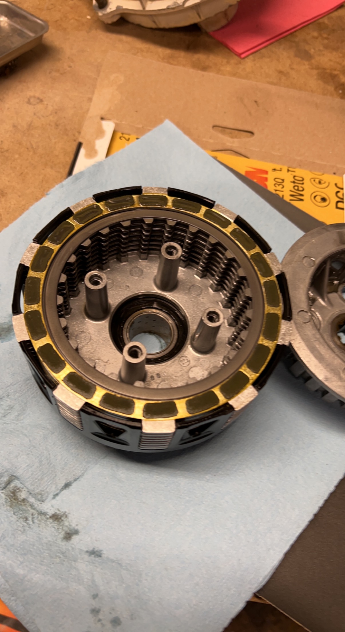

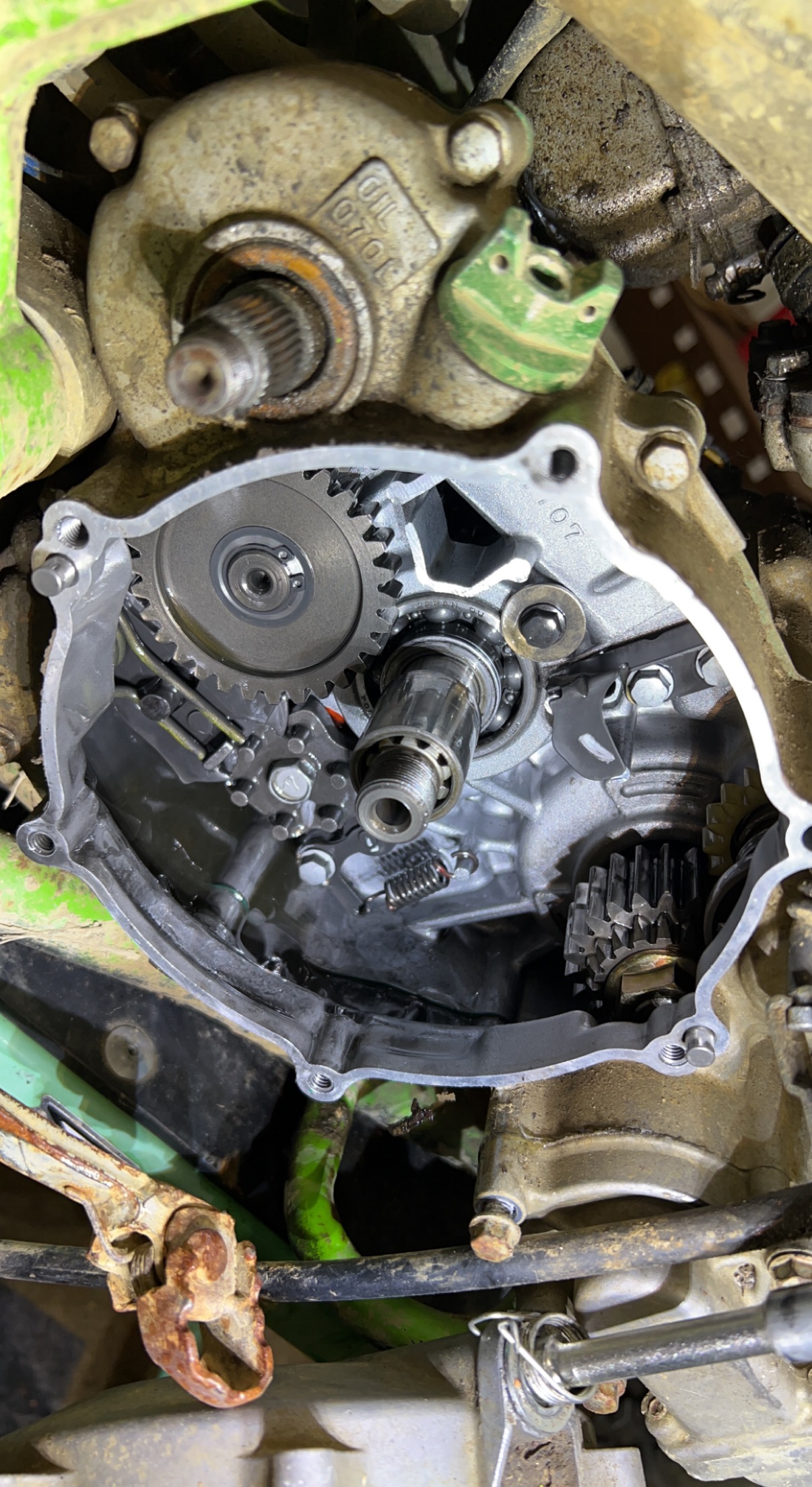

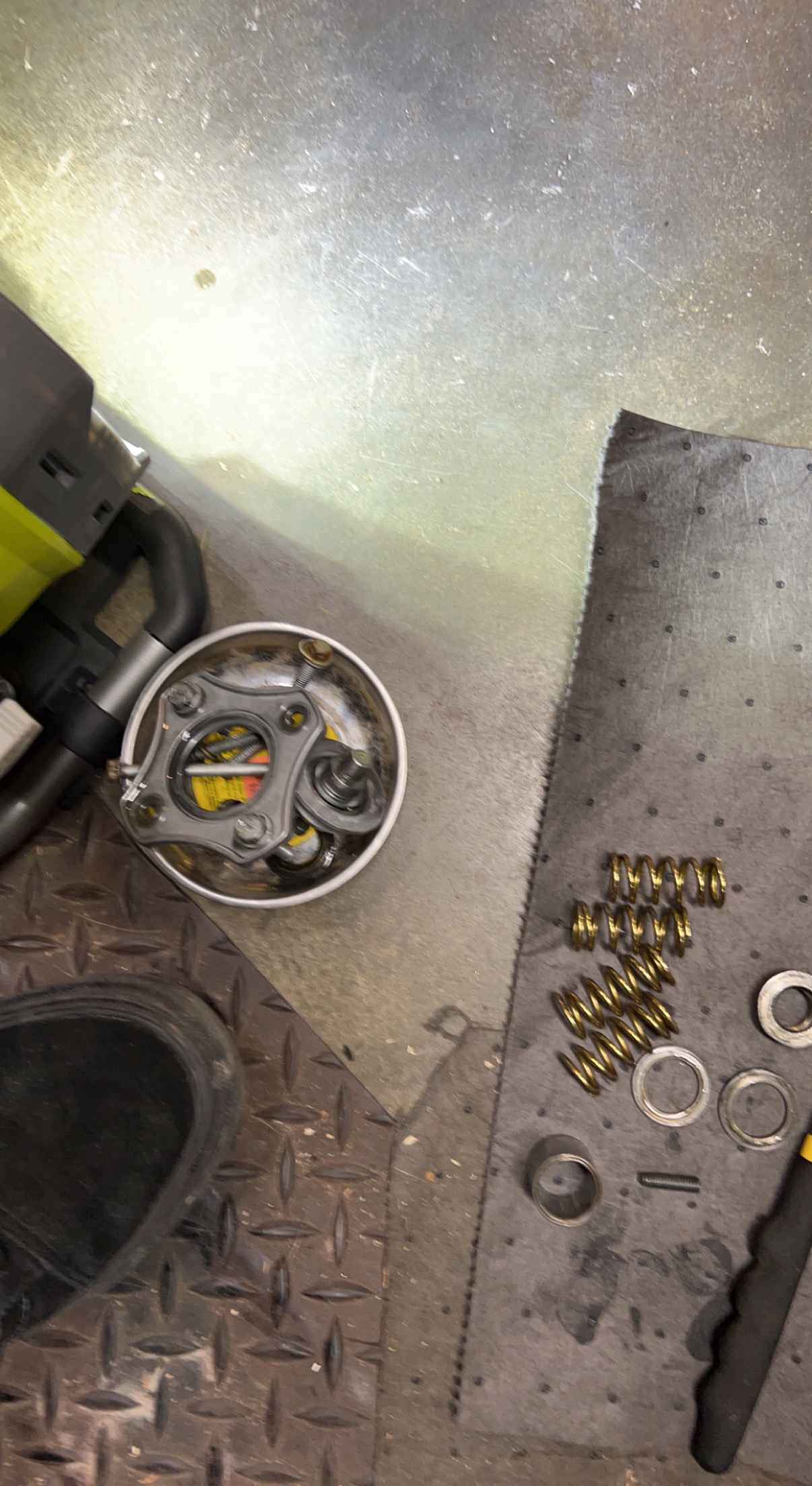

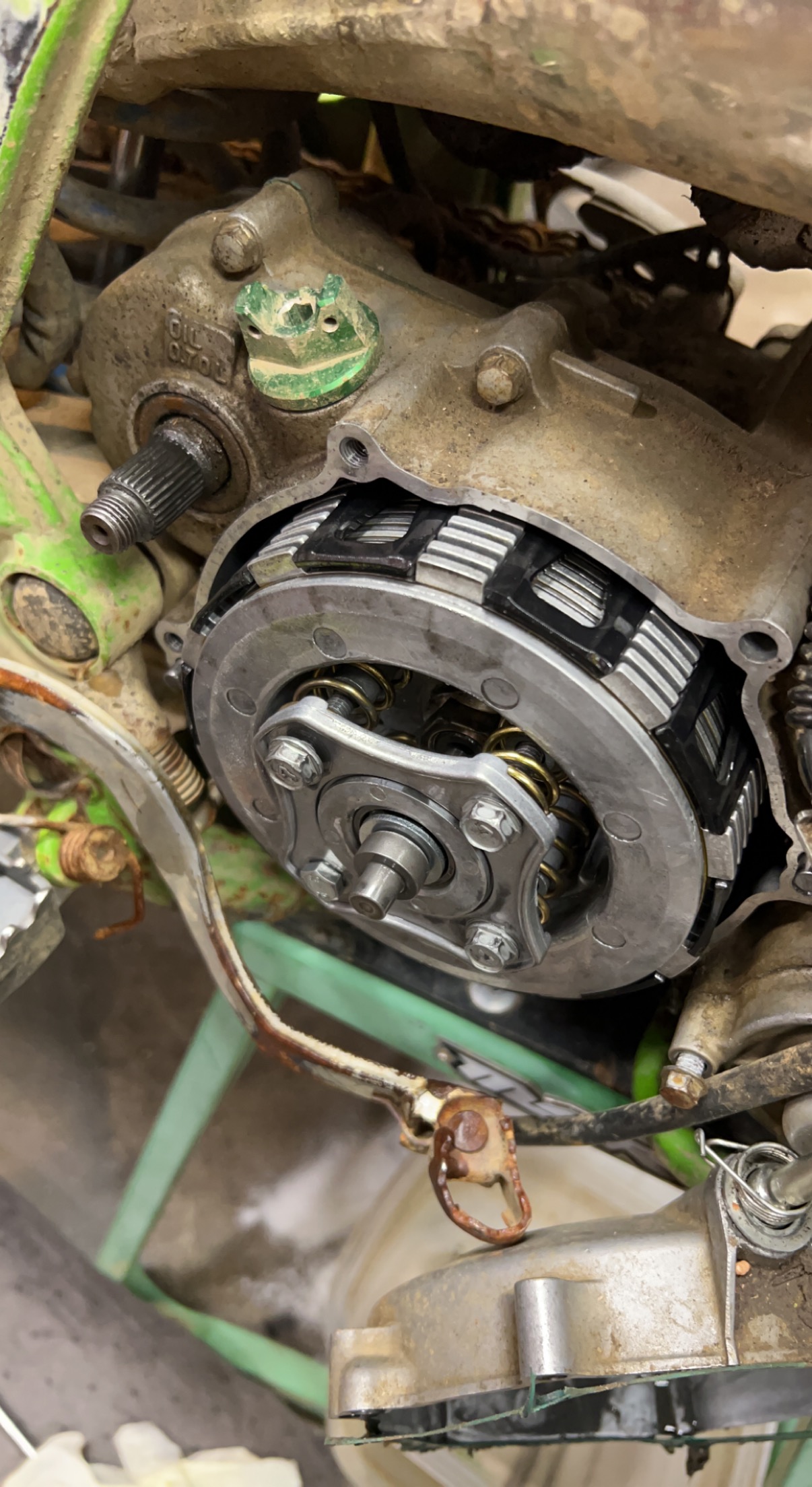

Here are some pics

They’re not new OEM springs. You have to check the free length like bufftester mentioned. If they’re not between 38.7 and 37.2 mm then that’s the problem.

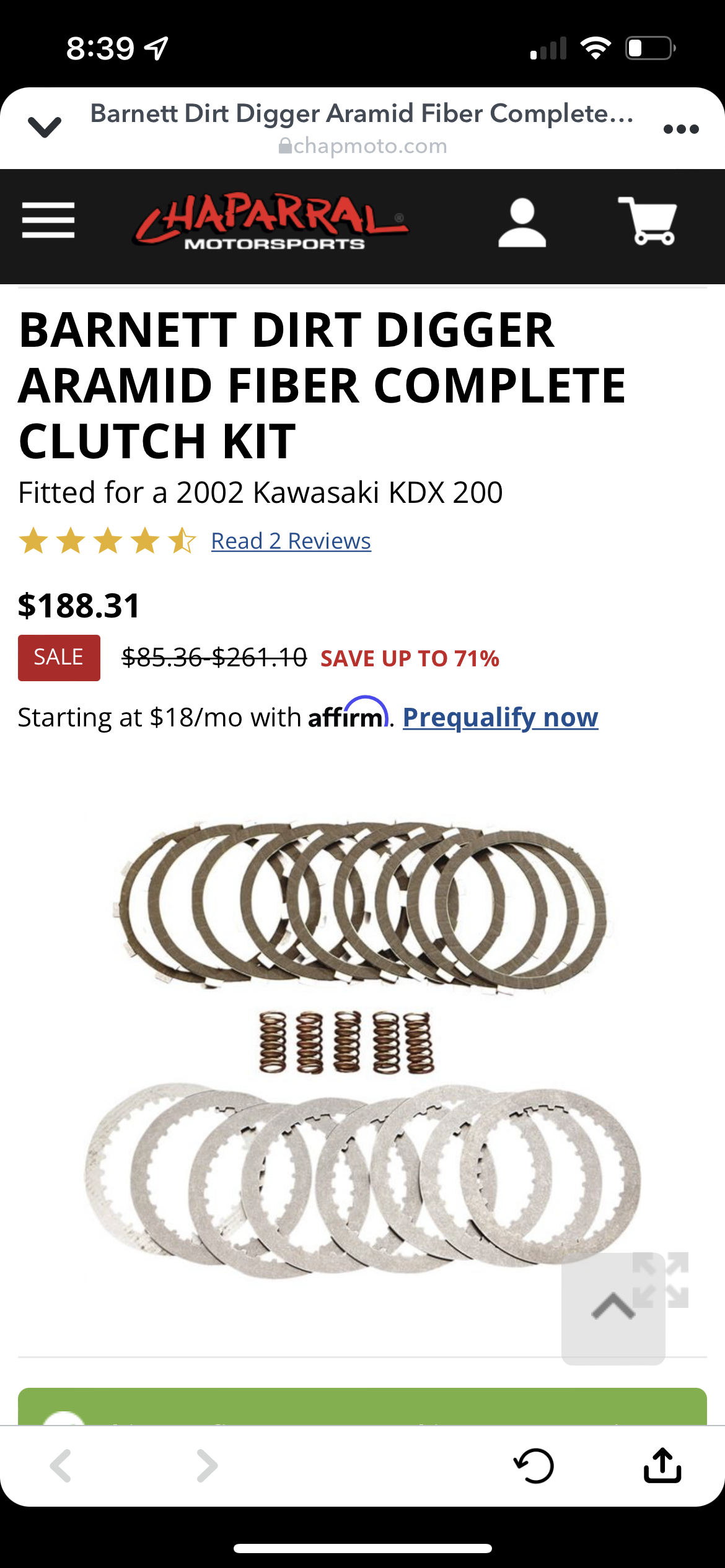

John_S wrote: 07:00 pm Mar 10 2022 They’re not new OEM springs. You have to check the free length like bufftester mentioned. If they’re not between 38.7 and 37.2 mm then that’s the problem.
They are 39-40mm they’re heavy duty springs, it’s got a heavy duty clutch made by Barnett

I’ve gone over everything and this should be right except for torque specs, I have no idea what to torque the heavy duty springs down to, I guess I’ll try stock first just gotta wait for my buddy to get off work since he’s the one with the in lbs torque wrench

Aftermarket clutch springs on the KDX are notorious for not working. lots of threads here and elsewhere documenting.
