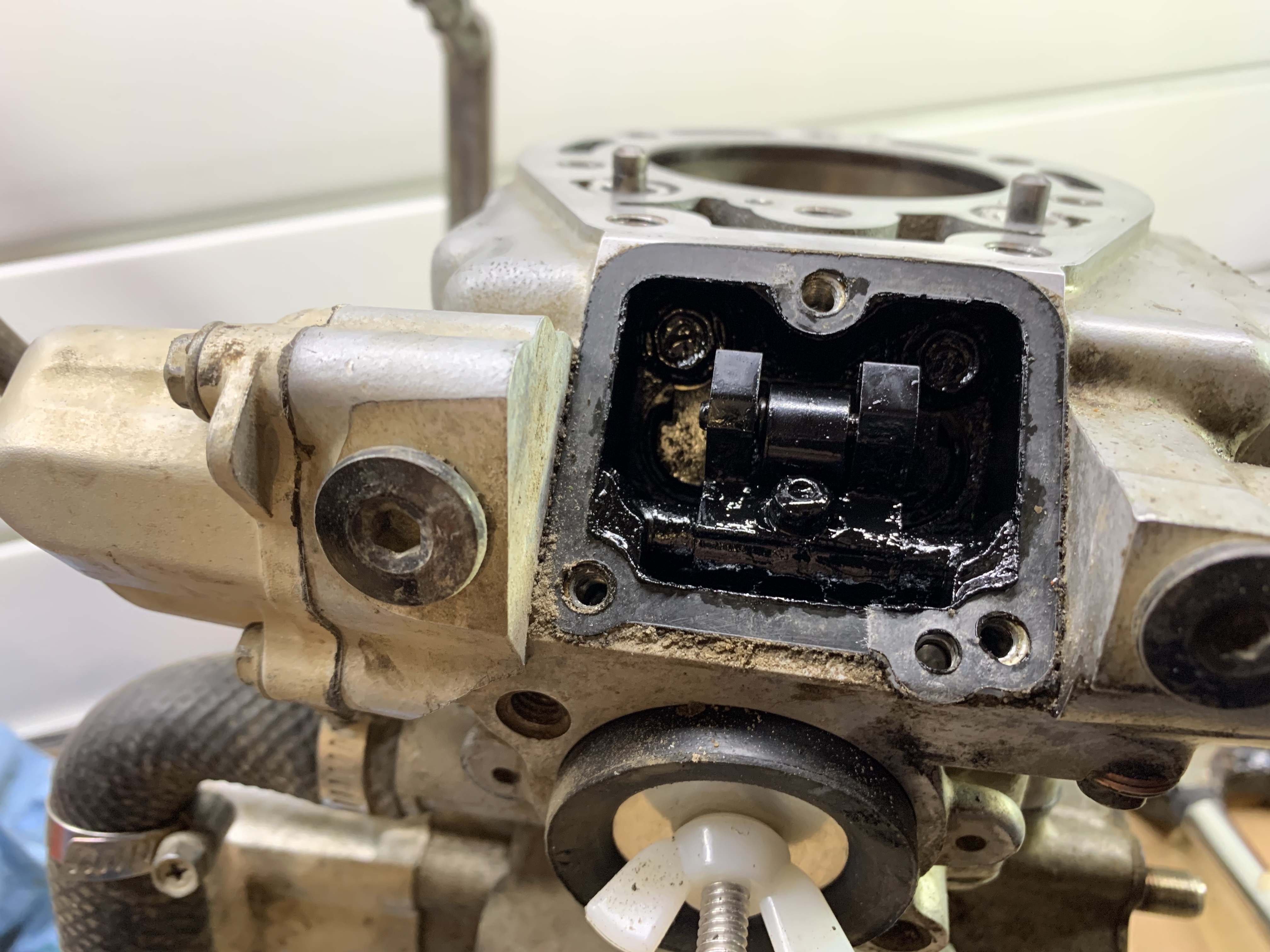

I am starting to work on my newly acquired 220. Compression is 145-150. Leak test was good. I need to open it to look at why the KIPS don’t work and see piston and cylinder condition.

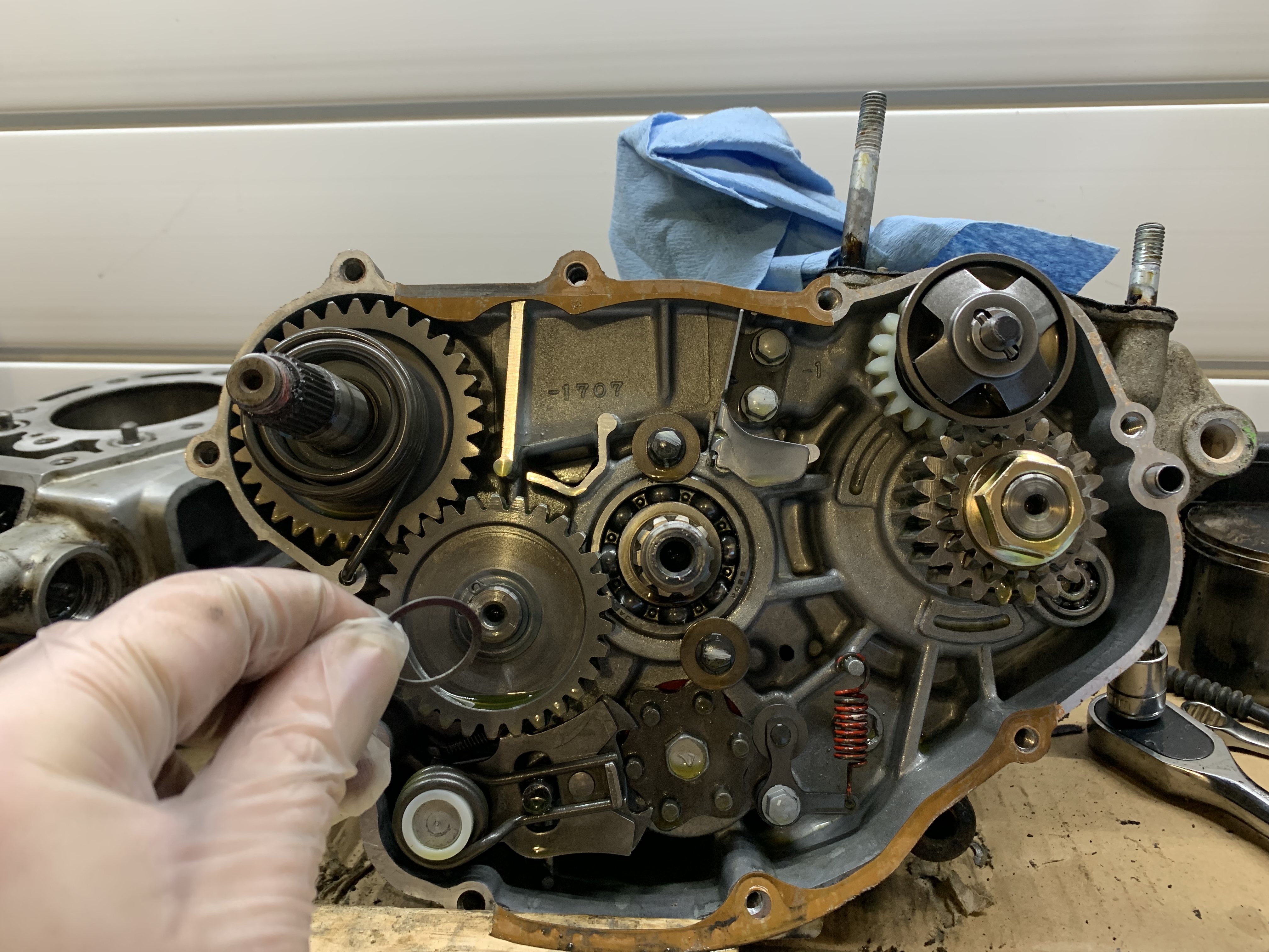

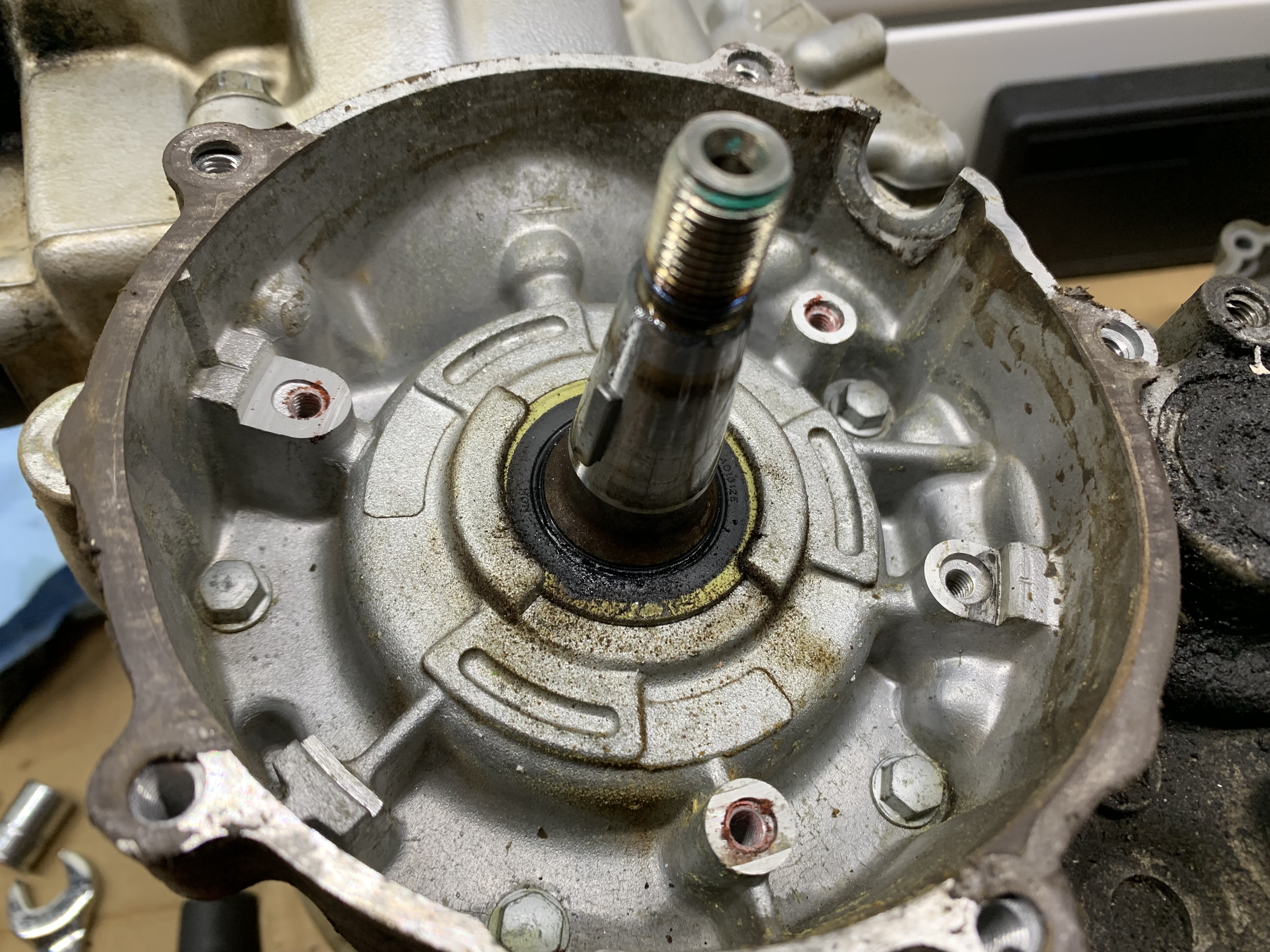

Thanks guys. Got it. Here is what I see now. Not much of a surprise but it looks like I’ll need to go deeper! Crank seal leaking. Splitting the case was not something I wanted to do. I may find someone to do it along with a crank rebuild. You’ll also see a shot of the piston and cylinder. Has a slight score I feel with my nails above the exhaust port. Needs a replate? Compression was good but I think I’ll get it replated. As mentionned in another post, this cylinder was honed. More pics to come when I have the chance to get back in the garage.

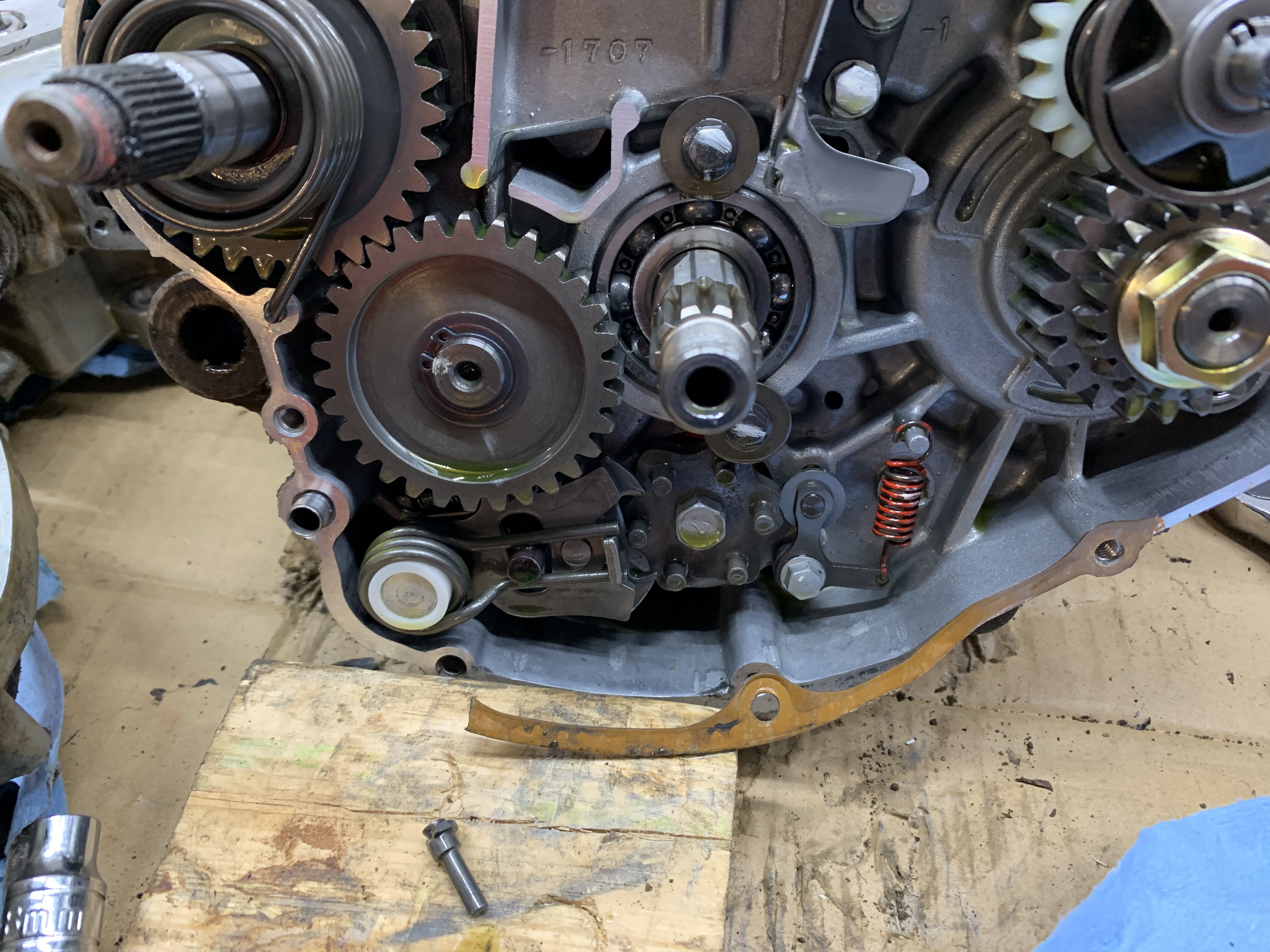

Thanks Nick! I am in Montreal. Not sure what shipping would be. I am now deeper and confirm there is no up or down play on the rod bearing. I might keep the crank as is but I’ll have to split the case anyway to replace the seals and that is a job that I’ve never done before so I will read and decide! I have no press to press the bearing in and to push the crank inside the bearings as well. Seen guys heating it with a slug…I’ll see! In the meantime I found what’s wrong with the kips. I think it is KDXgarage that guessed it right as the actuator pin at the bottom of the shaft is broken. Previous owner messed up when they did the top end. I now wonder where that pin went!! It is winter here and I only was able to drive the bike inside a garage in 1st gear. I did not try to shift it in a stand (my bad). Should I fear further damages from that pin I did not find? Another question: can you point me where that spacer I hold in my hand goes? It felt when I took the cover off. Kickstart shaft?

That KIPS governor pin breaking is a common issue since it’s a left hand nut. Easily replaced.

BTW I found the pin. It is actually visible on the picture on my previous post in the bottom right under the shift forks. It looks like it did some marks on the main shaft gear but I did not see anything major yet.
Coming back on my previous post, any idea on where that little spacer goes. That’s the only thing I cannot reposition at the moment.

The spacer looks like its from the kickstart like you guessed. Mine stayed on the engine cover when I removed it and thankfully saw it before it fell to the floor.

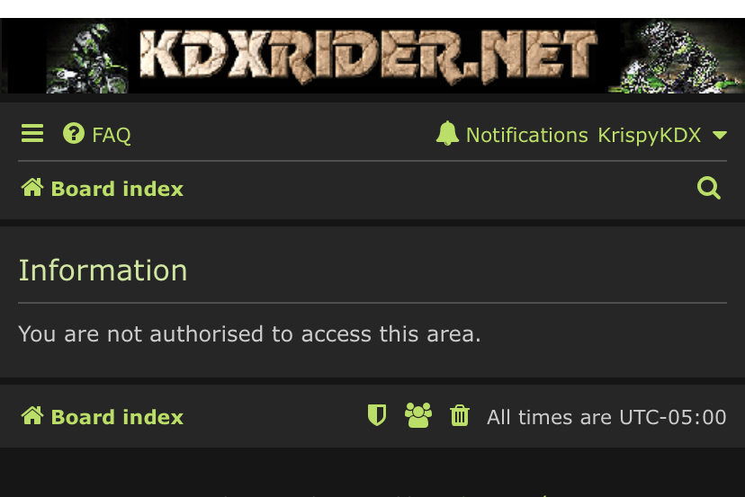

Thanks. Here is what I get following your link. (Tried on my PC and Phone).SS109 wrote: 08:06 am Mar 07 2022Go to this page app.php/donate and look for the gold button near the bottom that says "Donate" on it.KrispyKDX wrote: 06:36 am Mar 07 2022 More than ready to support but I don’t see any PayPal buttons!
- B03CA813-BB98-40FD-9DDD-49E7D10480EA.jpeg (179.61 KiB) Viewed 7595 times
- Posts: 6116
Re: Engine removal and tear down
Sorry about that. I don't know why the permissions for that page are messed up. I'll have Julien D look at it.
Anyway, here's a direct Paypal link: https://www.paypal.com/donate?token=K-t ... WfW1kQP-kZ

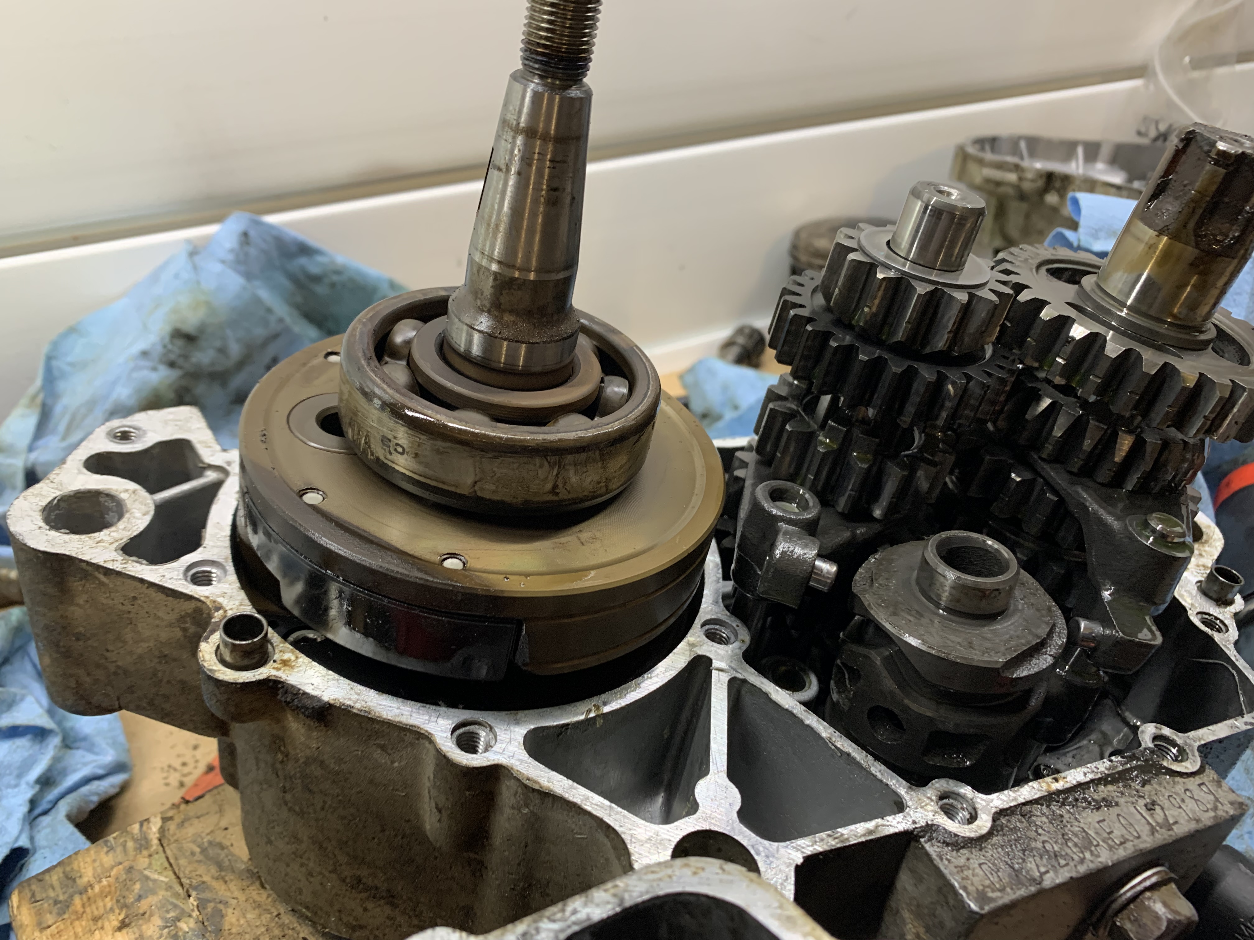

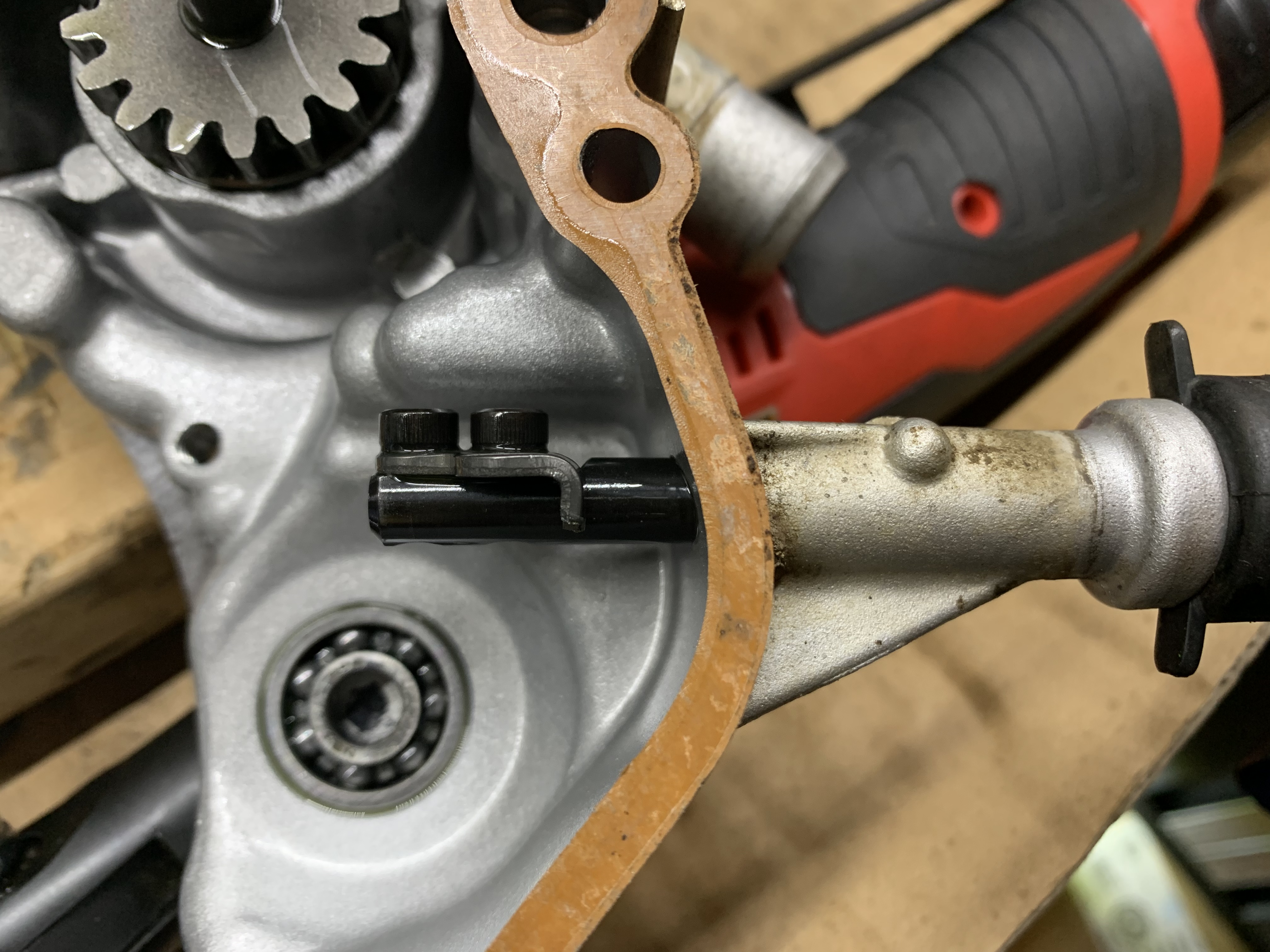

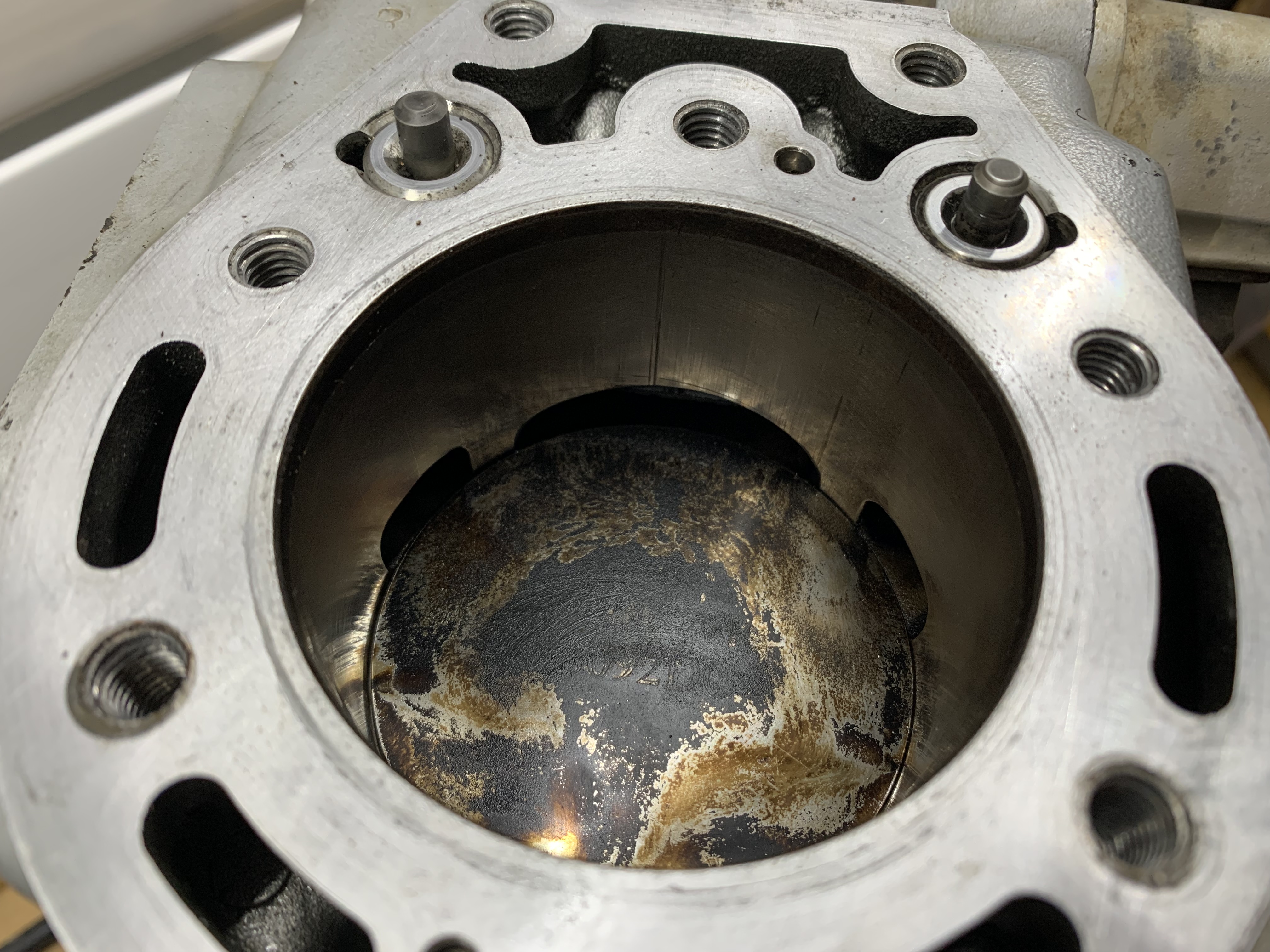

I finally had some time tonight and got back at it. I did split the case but, let me tell you, it was tough…it was actually splitting first on the output shaft side (opposite to where I was pushing on the crank). I started to fear some might have used locktite or inappropriate bond in a previous rebuild since I have noticed red locktite in a couple of places (cylinder studs) so I did heat the joint between the two halves around the crank and it literally popped! It did not split smoothly at all since every turn or so on the splitter bolt it would pop a little more until it eventually split. To my surprise the crank bearing stayed on the shaft! See picture below. I have a couple of 3 jaw puller but there is no way I have room to grab it from behind. Anyone has an idea to help here? I will sleep on it but I am quite confused at the moment to say the least.
Here is an update and the trouble I may be in right now!
I sent my cylinder for a replate and did order a lot of parts from the dealer for the rebuild.
