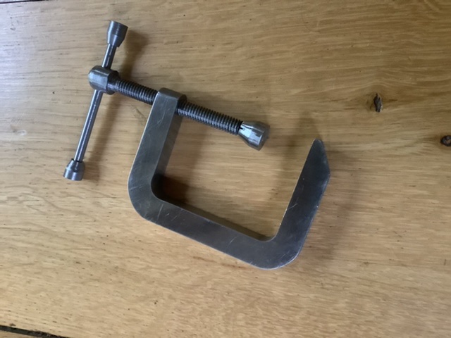

That looks solid! My son is into machining at school (he’s a junior) and just finished up this cool project. Hopefully he can start building improved replacement parts for my old dinosaur in the near future! … currently I have commissioned him to build us a bearing press.

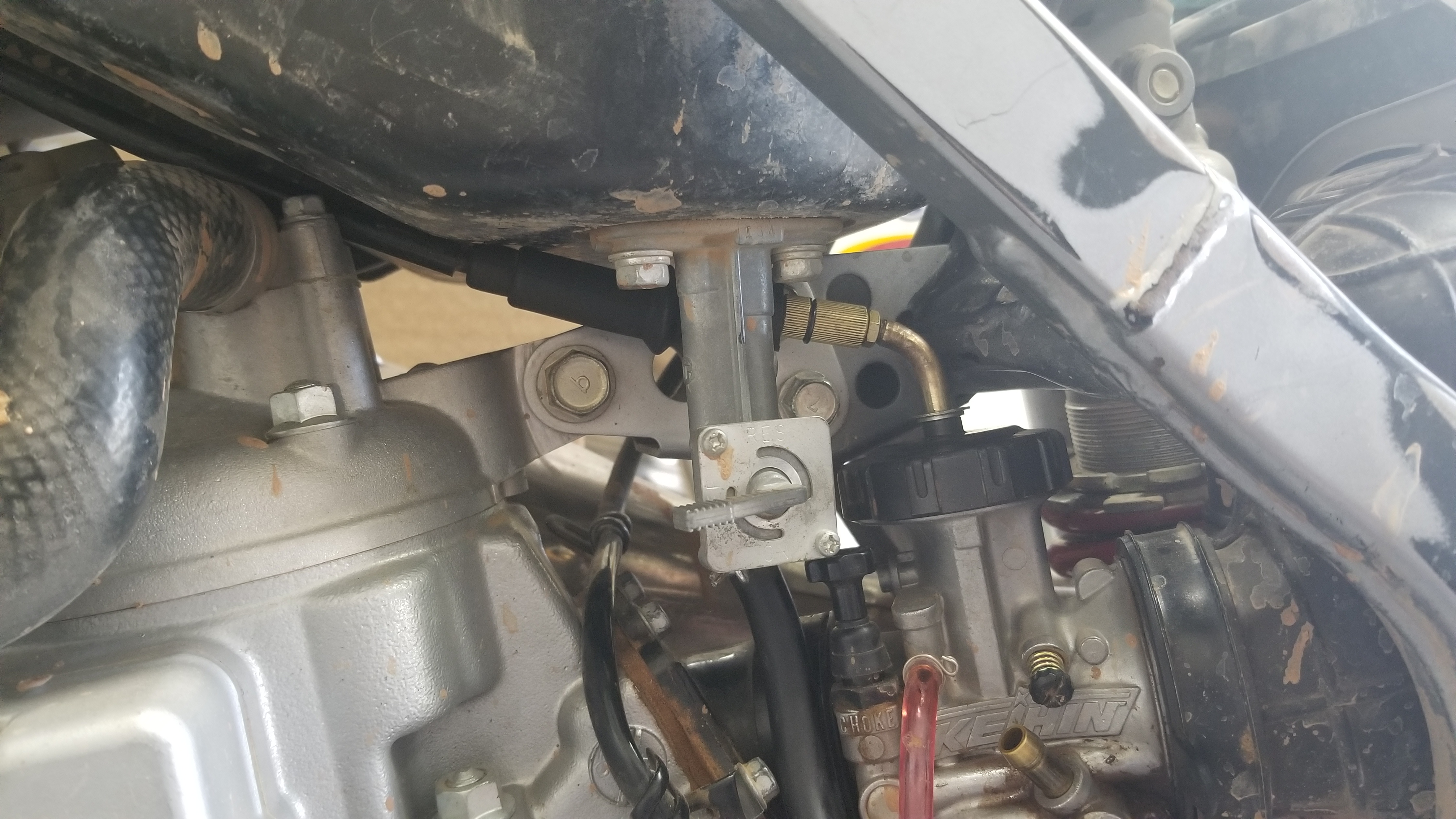

So here we go again..
Got the part done and installed and ready to zip!
To bend the tubing, I had to anneal the brass first. Get it to 800 degrees for a couple of seconds. This reforms the bonds and structure to make it more malleable, like copper almost. Once you anneal brass, you cant un-anneal it though. But I'm not worried about strength. This tubing is ridiculous. Metallurgy lesson for the day.
I did have to bend it a couple of times to get it right. It required a more steep angle than the stock elbow as it sits higher and closer to the tank(see pics). On the next one, I wont leave the neck as long to the bend because I still had plenty of space to get the internal snap ring on. So the next one for the hybrid bike should be a bit better in the fitment department. Otherwise, I need to reconsider the e clip I used on the outside of the cap. I cant get the boot over it. I have a new cable I need to put on, so I might just waller out the boot seal to make it fit. I'll see what mcmaster has for other options.
But otherwise, it feels super smooth, and fits very well.

Does the bendy boot still fit overtop nicely?
Re: 35mm PWK Throttle Cable Guide
Posted: 10:10 pm May 03 2022
by smelonas
Slick_Nick wrote: 07:35 am May 03 2022 Does the bendy boot still fit overtop nicely?
It does slide over the elbow and the seal of the new tubing and tighter tolerances reduces any potential air leaks to zero. currently trying to figure out if I want to use a snap ring or circlip to potentially replace the e clip I used. I like the E clips size, but that is also its down fall. I really need some custom clips made for the inside and outside clips for this piece, but I will make do with what the world readily offers.
