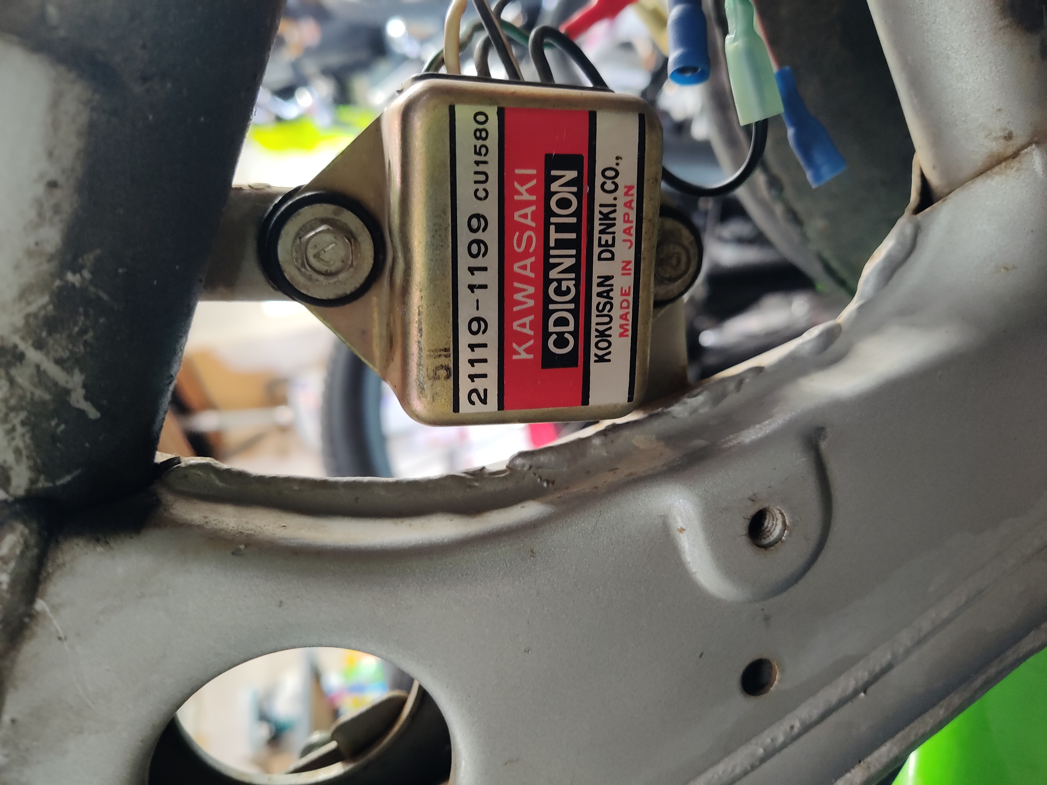

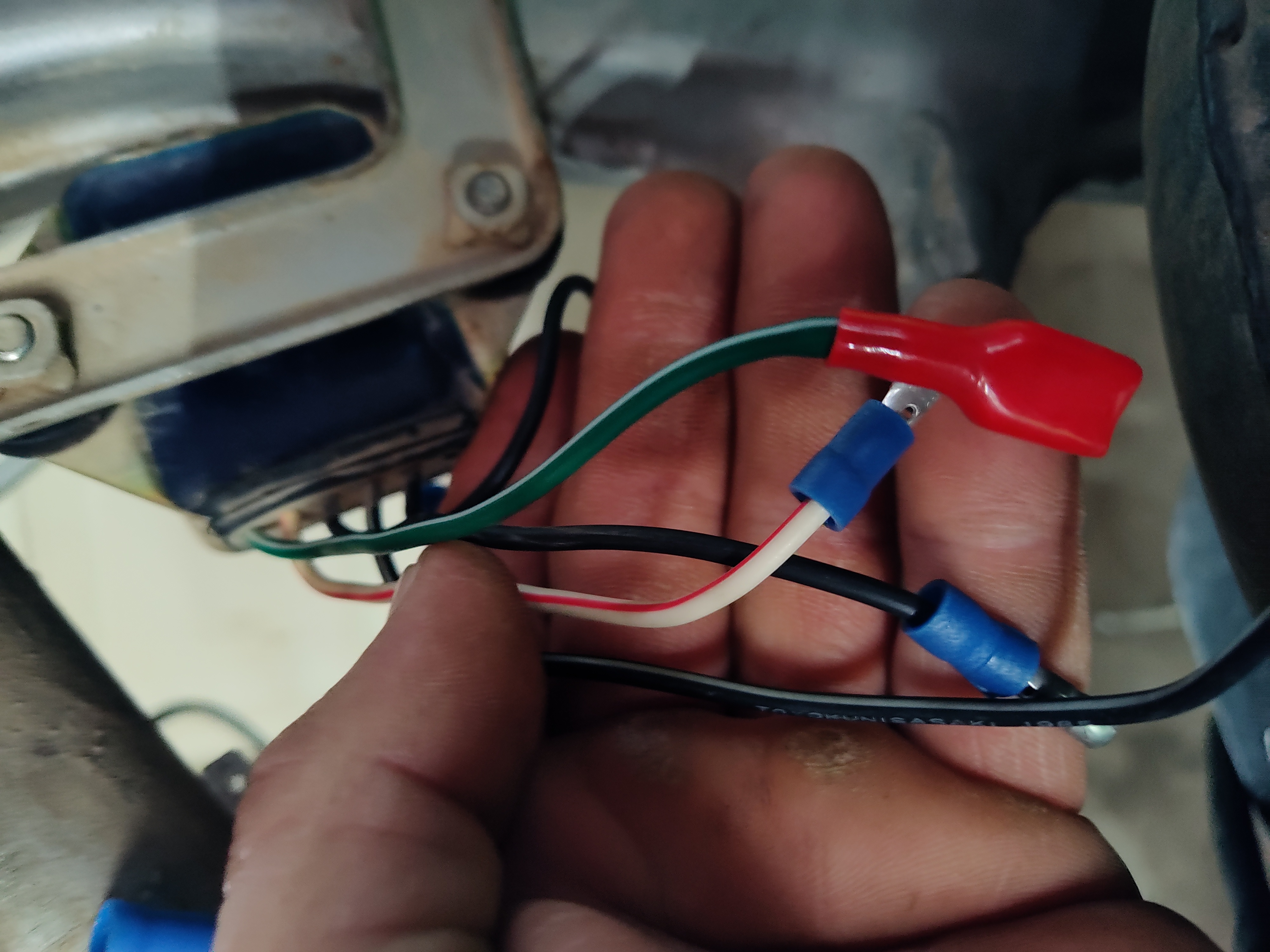

Who can spot the problem. I talked to Ricky stator after I ordered the stator. He let me know it was the wrong one and asked if I wanted to swap it out for an source coil and that should fix me up. The customer service is awesome anyhow. I was on the old interweb looking over some wiring diagrams and noticed that these two do not match that's an even bigger problem than not having ignition right get back to me when you can.

I also noticed via the wiring diagram that the way the wires were set up in the diagram were different than the wires coming out of this particular CDI. The colors were the same except they were in a different order. Maybe somebody took it apart once not sure.
Re: No spark
Those are not the stock connectors. Someone cut them.

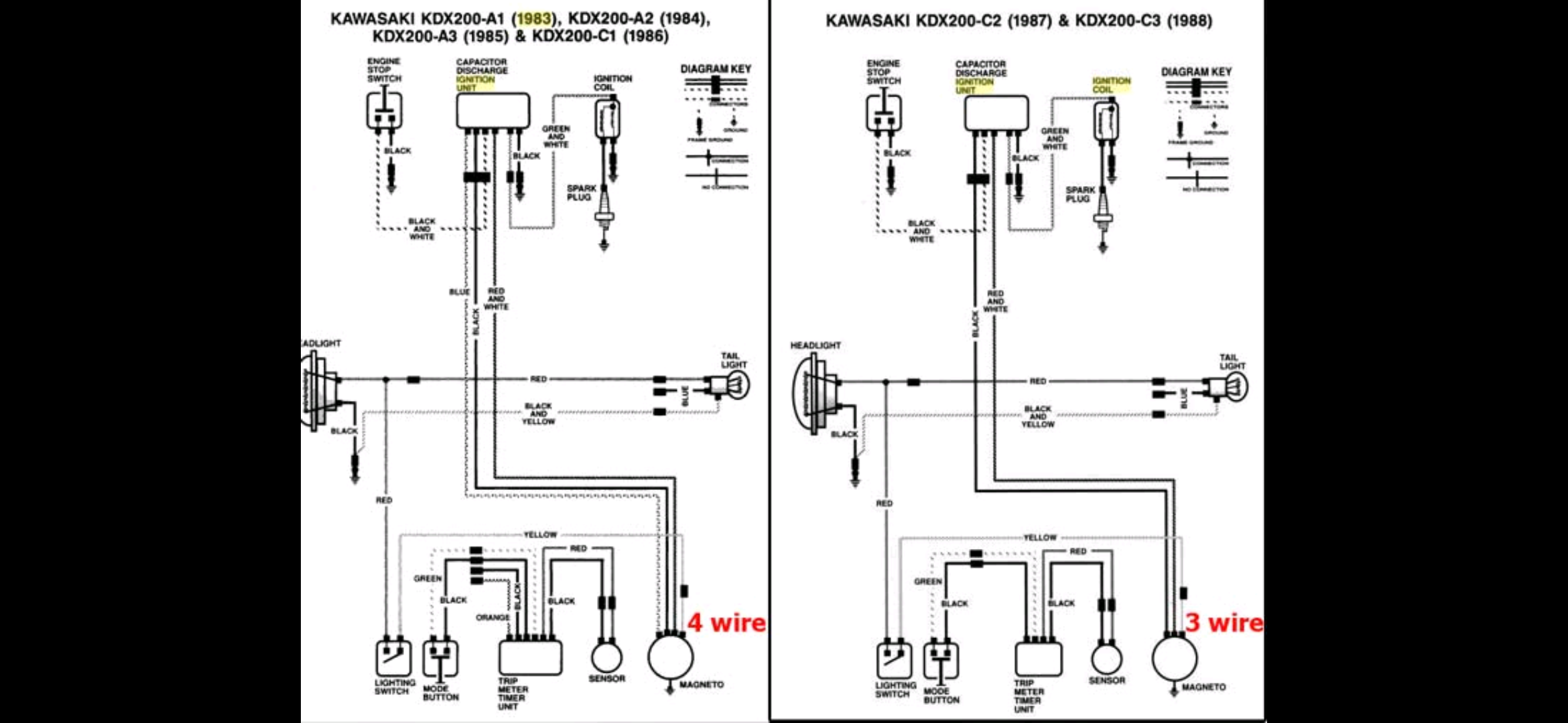

This is the wiring diagram I was looking at

So it looks like I have a C1 magneto or stator with a C2 CDI. These both originally came on this bike that I bought and the wiring was butchered like all of it. I pulled the tank and there was wiring cut up attached to nothing for what I'm assuming was the front headlight and rear light

The CDI and the stator plate is the same for 1986 - 1988.
This Kawasaki 21119-1199 IGNITER fits the following models and components:
Kawasaki Motorcycle 1988 KDX200 - KDX200-C3 GENERATOR
Kawasaki Motorcycle 1986 KDX200 - KDX200-C1 GENERATOR
Kawasaki Motorcycle 1987 KDX200 - KDX200-C2 GENERATOR
This Kawasaki 21003-1178 STATOR fits the following models and components:
https://www.partzilla.com/catalog/kawas ... /generator

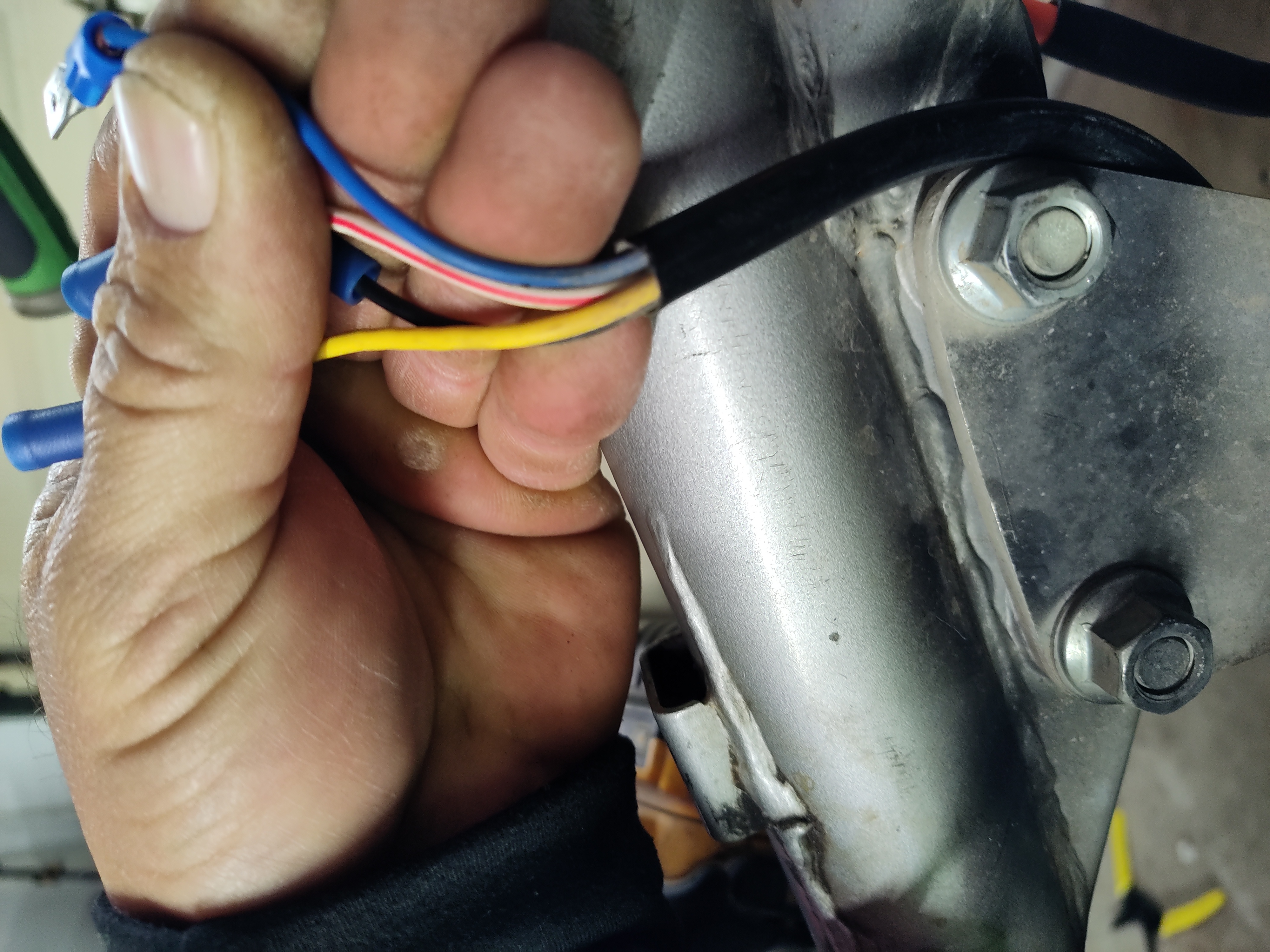

These are the stator wire's. Black, blue, white with red and yellow.KDXGarage wrote: 12:53 am Feb 27 2022 I think it will be fine, jusy got to make sure they match up.
What does the wiring coming off the stator look like? $348.34 at Partzilla. I would try to rebuild what is there or buy used.
- IMG_20220226_130313.jpg (2.76 MiB) Viewed 2751 times
