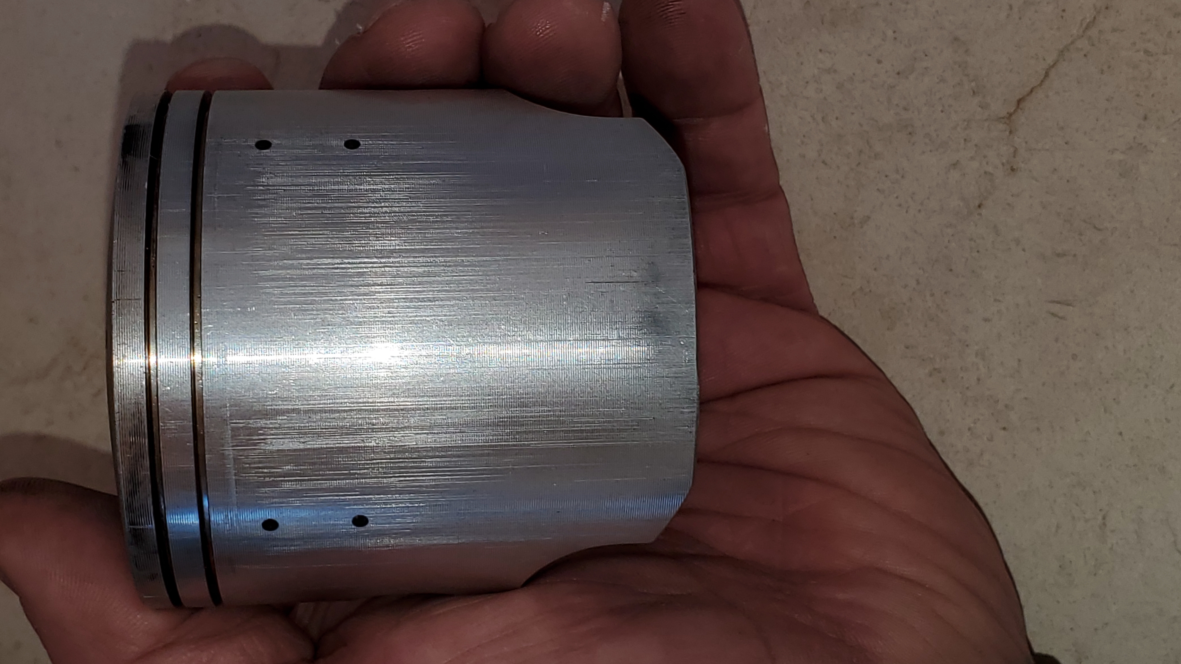

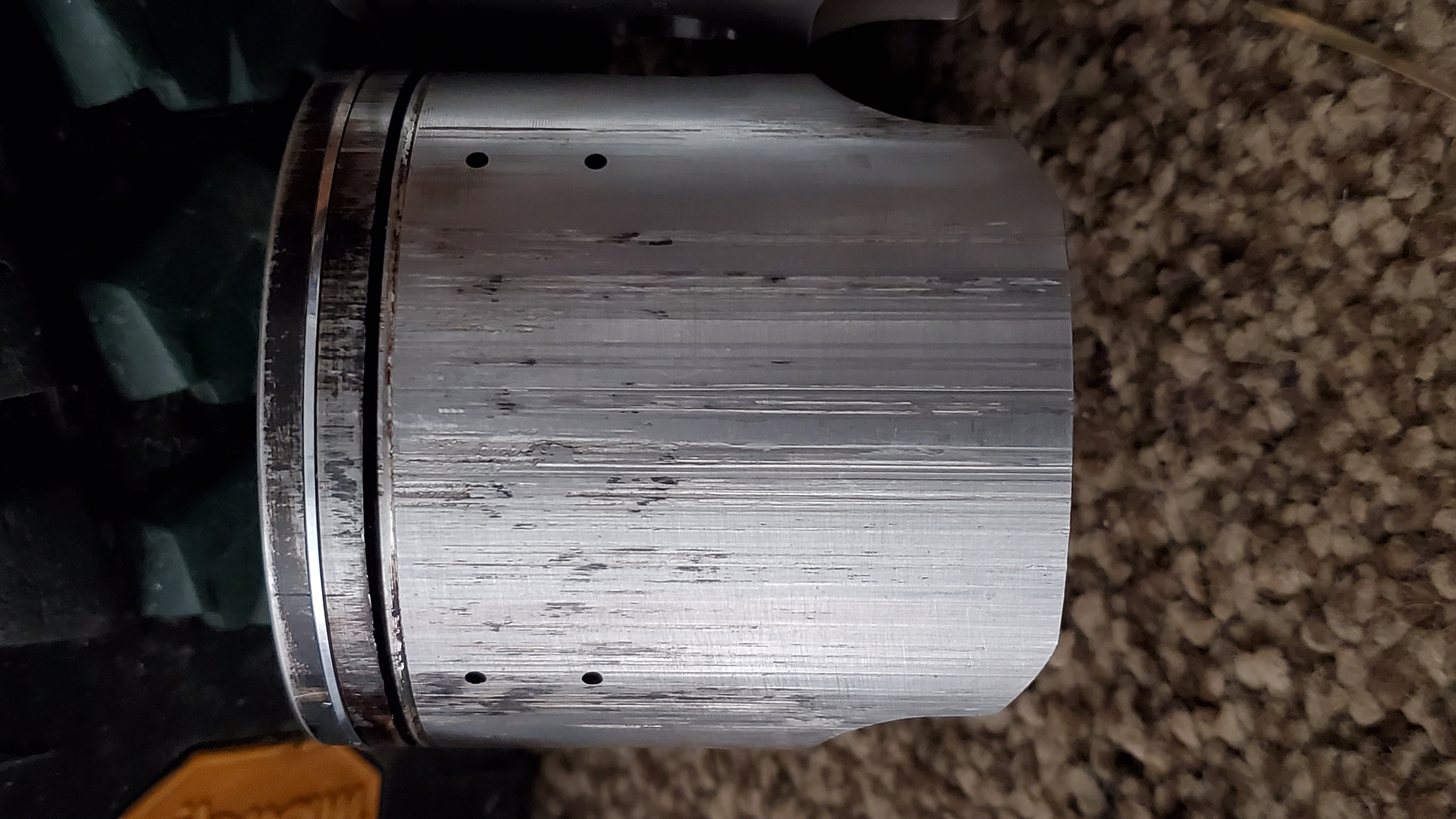

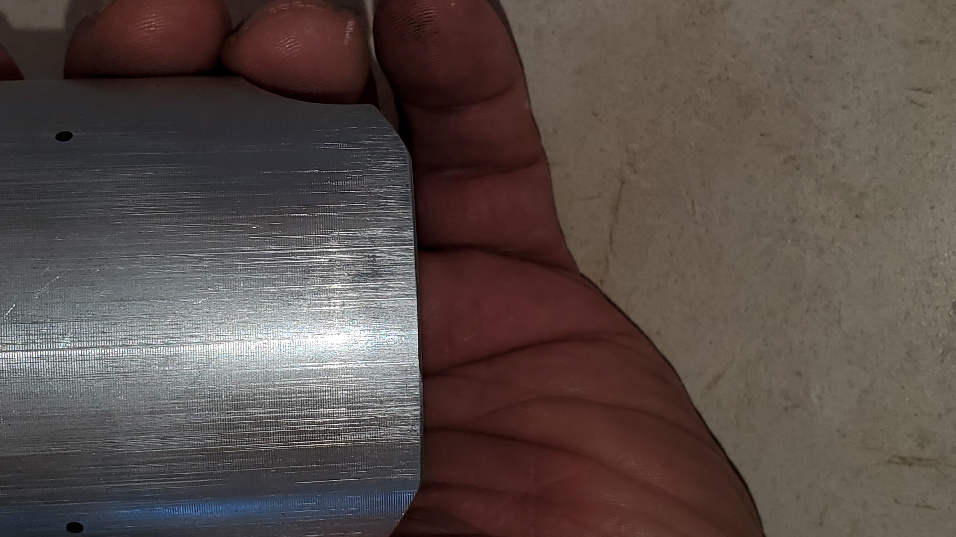

Now is it possible that's why I was down on top end power?? And if you notice exhaust side of new piston in pics, there is a horizontal line that matches up perfectly with the one KIPS exhaust valve, that matches the width of the scoring. Maybe KIPS valve was stuck to close and interfering with piston because that lever thingy was bent at bottom of KIPS advancer shaft??

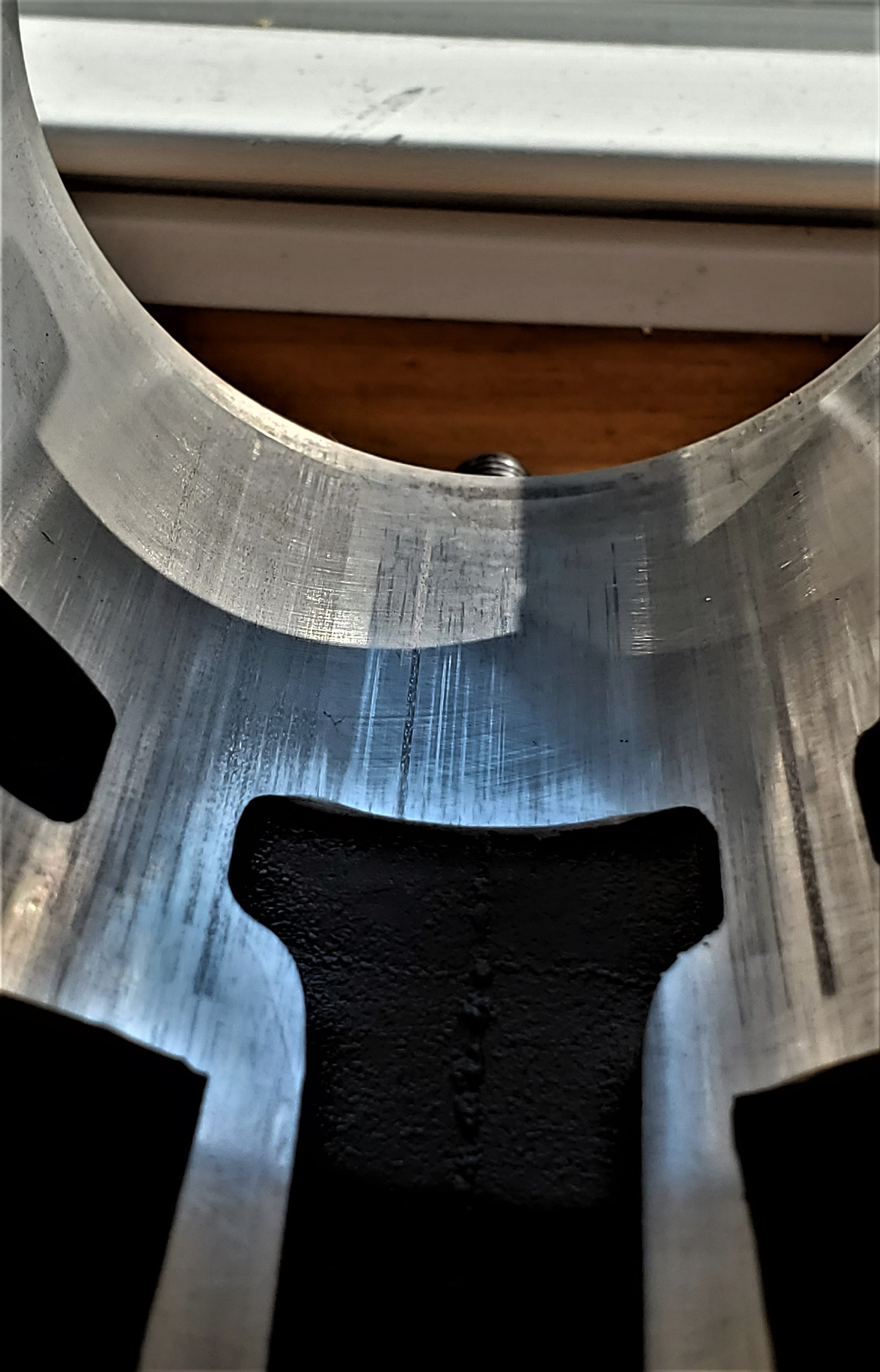

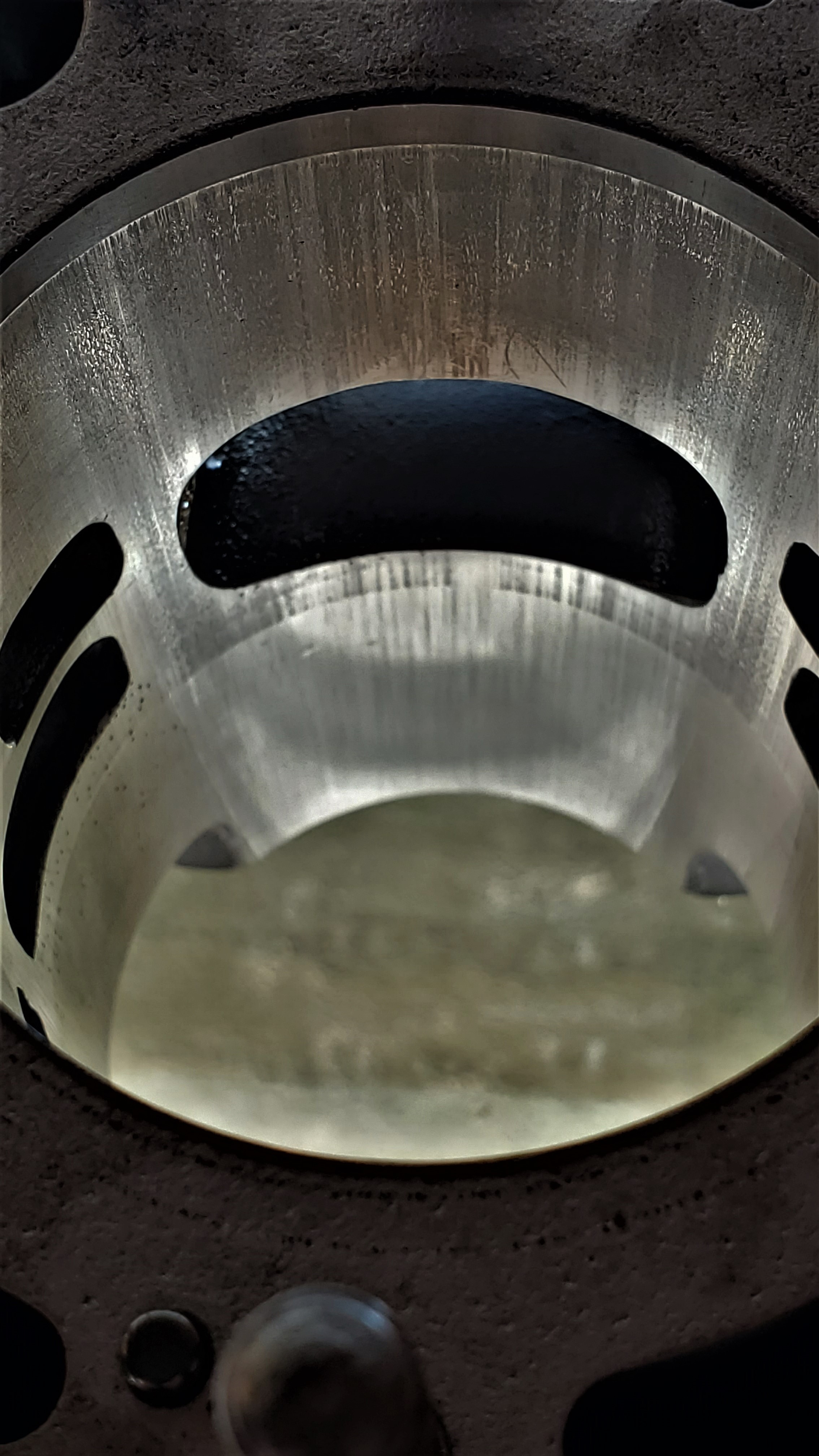

- Replated cylinder intake side at 10 hours with new piston #2
- Replated Cylinder 1.jpg (1.06 MiB) Viewed 4735 times
- Replated cylinder intake side at 10 hours with new piston #1
- Replated Cylinder 4.jpg (956.2 KiB) Viewed 4735 times
- New piston exhaust side from replated cylinder both at just 10 hours. #3
- New Exhaust 3.jpg (2.86 MiB) Viewed 4735 times
- New piston exhaust side from replated cylinder both at just 10 hours. #2
- New Exhaust 2.jpg (2.87 MiB) Viewed 4735 times
- Old piston exhaust side
- Old Exhaust.jpg (3.68 MiB) Viewed 4735 times

I would say debris caused that scoring. It is on more than one side of the cylinder so it couldn't be just the center power valve causing that problem. I would say the engine is sucking dirt in from somewhere. Check how your air filter fits, the air box to air box boot joint, air box boot to carb connection, and your carb to intake manifold connection. Is your air filter properly oiled with no tears? Also, it looks like on the cylinder that the ports are not properly chamfered or am I seeing that wrong?

About the ports, you are correct they are not chamfered. Didnt know that was a thing until last week..lol..just had a former motorcycle mechanic do a quick inspection of cylinder and pistons. He works at local AutoZone had some customers waiting... Anywho, he did take 5 minutes to check it out, he felt the ports and was like, "They need chamfered". So good eye! OK so how do I do that with ruining the cylinder??

Great points from SS. I’ve heard good things about Powerseal but it was their job to do the chamfer, right? I would at least contact them and show them what you’ve got going on. This could’ve caused or contributed to the problem. I’ve always read how important it is on a replate or bore job to chamfer the ports so the rings don’t expand and catch on the sharp edge.
