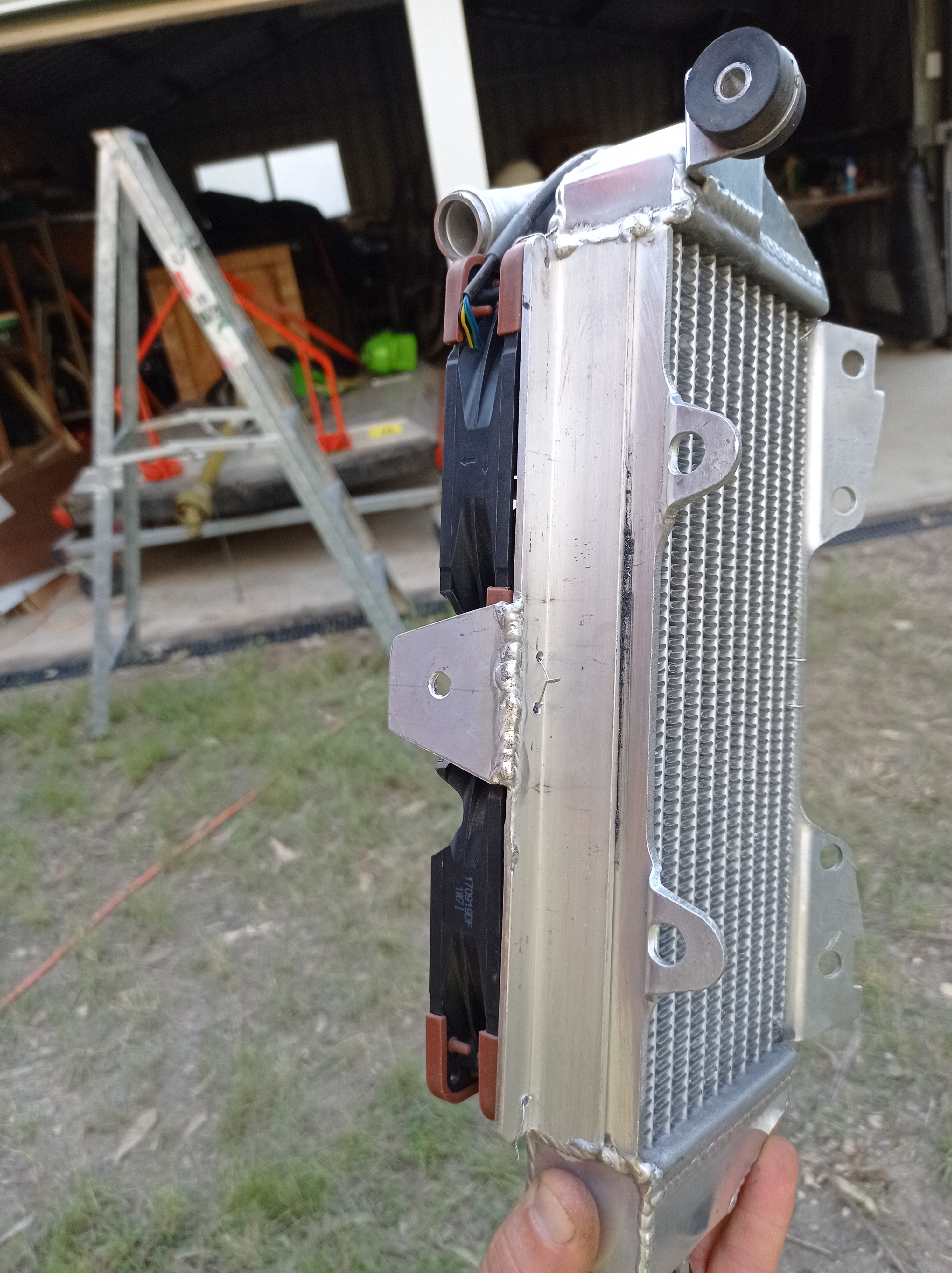

There seems to be so little information on fitting fans to a kdx I thought I would share what I've done, I used 2 X 120mm noctua industrial PPC fans, basically the best computer fan money can buy, I think it works out to about 200cfm for a 0.6 amp draw

It's an Australian kdx, they come with the bigger stator like most other countries, connected to the engine temp light, Australian kdx also has the full dash

Good memory, the radiators you see in the photos are new radiators, I'm currently in Australia and using my kdx here as a dummy bike to fab up the fan mounts and radiator guards, then the whole assembly including radiators will be going back to Thailand with me to fit on my kdx in Thailand, all bikes in the Thai jungle overheat without a fan so new radiators or not ,fans will be needed, I also bought a trails bike in Australia so been taking cooling cues from that, they have a fan and shroud that covers the whole radiator as they have zero airflow from movement of the bike, similar to alot of the situations we are in, in Thailand

These fans are noctuas industrial version so quite often used in harsh environments, they have anti vibration rubber pads and IP52 rated but just to be sure I will cover the shroud when pressure washing

Kdx is AC current and I already burnt out one fan testing it on AC my other kdx is DC but I forgot how it was done, think it was just a bridge rectifier

i ended up buying a lithium battery pack which gives me 3 hours of run time then i carry a spare in my bag, total 6 hours, unfortunately it didn't help my overheating problem at all as that was caused by pinholes in the cylinder, ive since put a sleeve in the cylinder and will reassemble next month, but quite annoying how people say kdx's don't overheat, like its the case across 250 countries and all terrain lol :grin:
