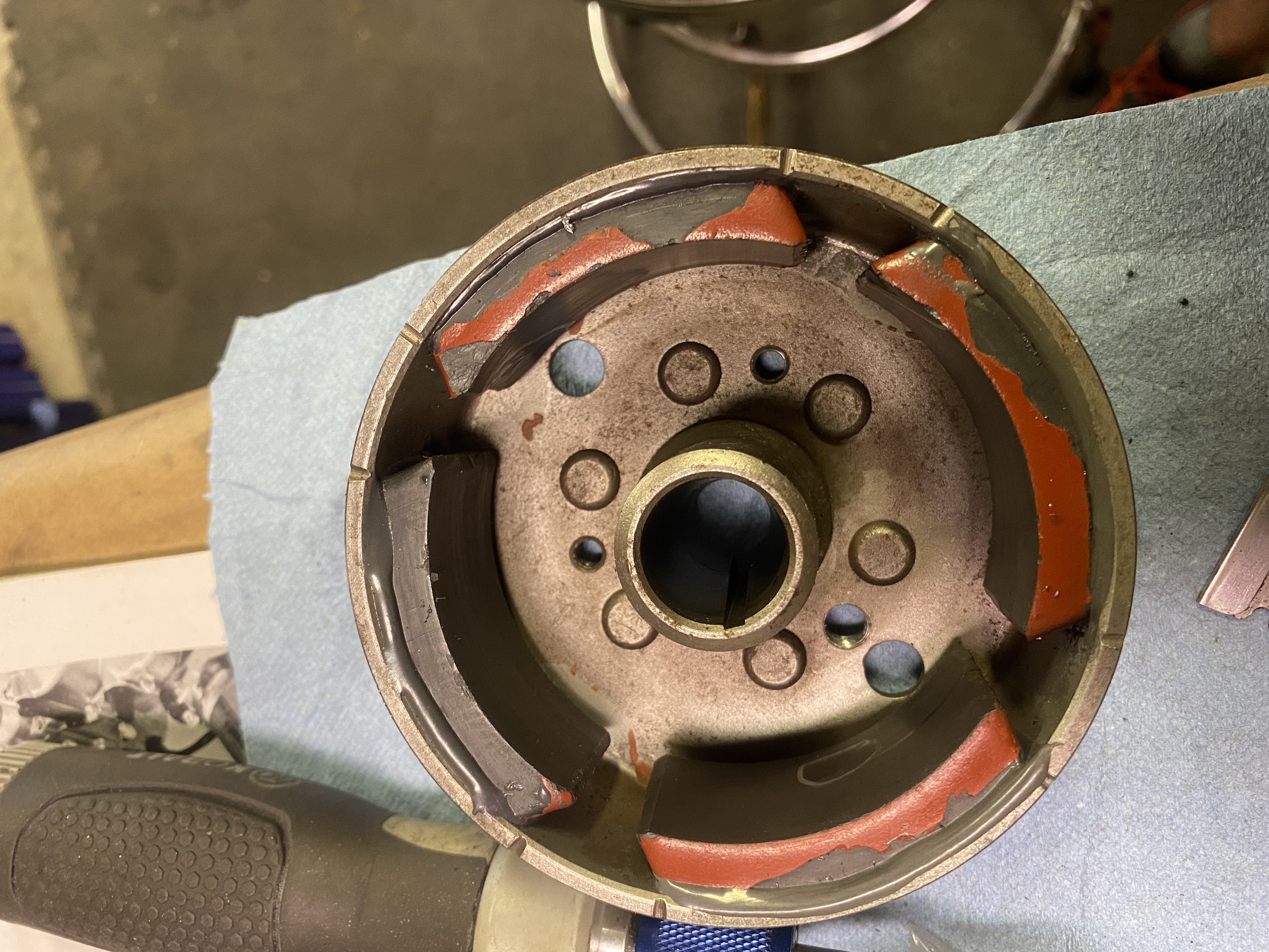

Merry Xmas everyone and thx for your reply’s. I’ve tried to attach a photo of the flywheel. No cracks, just chips, largest is maybe the size of half of a dime. The Clymer stator test specs are looking for 54.5 ohms and 0.5 ohms compared to the number I shared above.
- 9AEF6C03-3121-452C-B27D-7337625B6DB3.jpeg (3.58 MiB) Viewed 40382 times

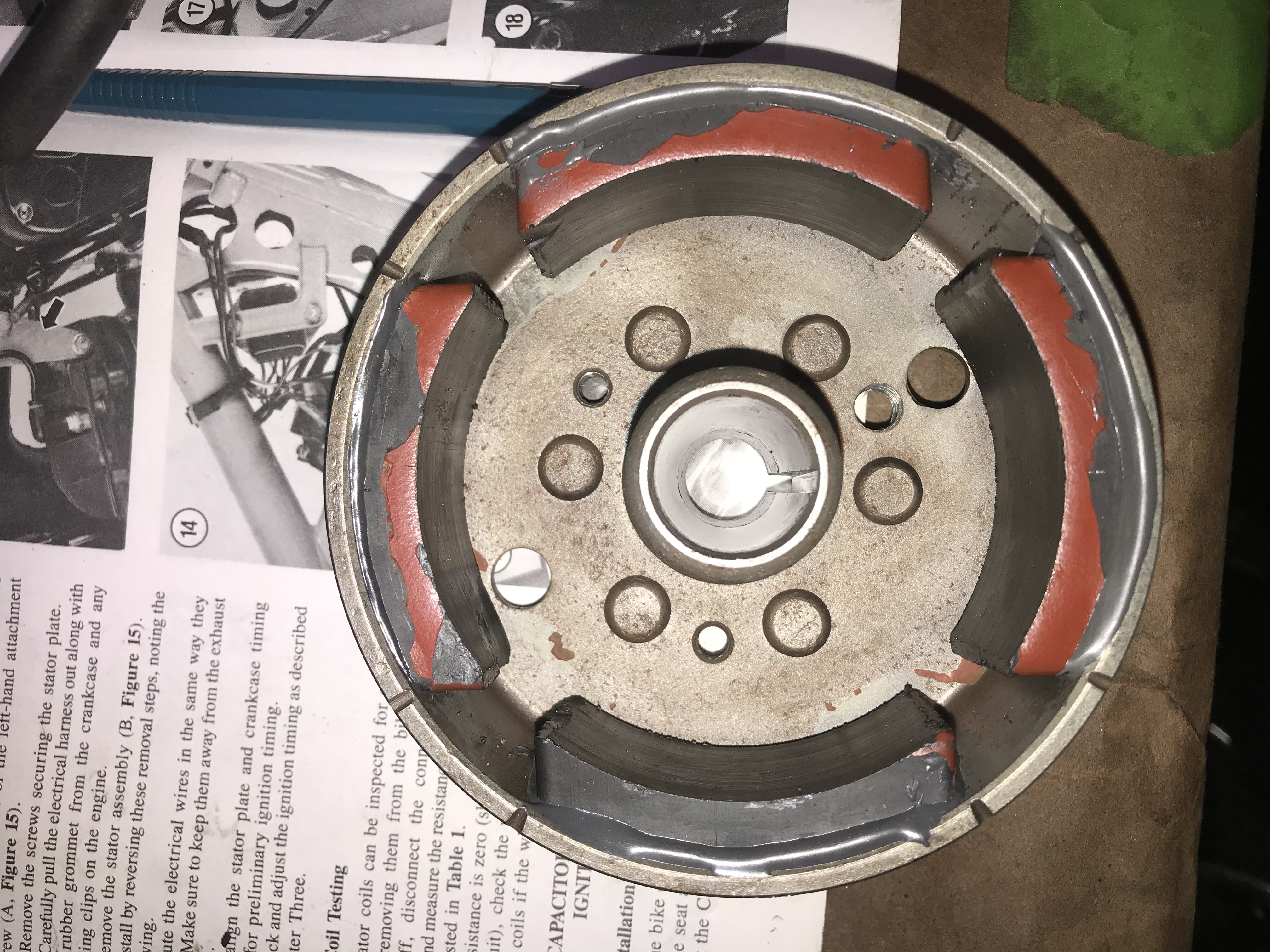

Here is another picture where i circled w/ a pen the areas of imperfection
- Flywheel magnets
- 80F3E510-7F34-461E-83CC-B70320DCFBD6.jpeg (3.22 MiB) Viewed 40382 times

It appears as though whomever epoxied those magnets back on, marked the flywheel with a grinder or something. I have to say though, that even if one of those magnets was off by a couple of degrees, your ignition timing could be altered quite a bit. Might cause you some issues.

Gents, after much trouble shooting I think I finally figured out the problem. When the previous flywheel owner refluxed the magnets he glued them on in the wrong order NNSS. The magnets are supposed to be NSNS. Also there are stops on the flywheel to help you position the magnets correctly. Soooo all you have to do is mix up some JB Weld (I use marine grade) coat the back of the magnet and the top/sides and slide it into position. Of course you need to clean off rust and old epoxy before regluing. But pretty easy. To detect what pole the magnet is you can buy a simple magnet pole detector (another NS magnet on a swivel…pivots to tell you the magnet pole) off Amazon for $6. Super easy to test…you’ll have you answer in less than a minute.
