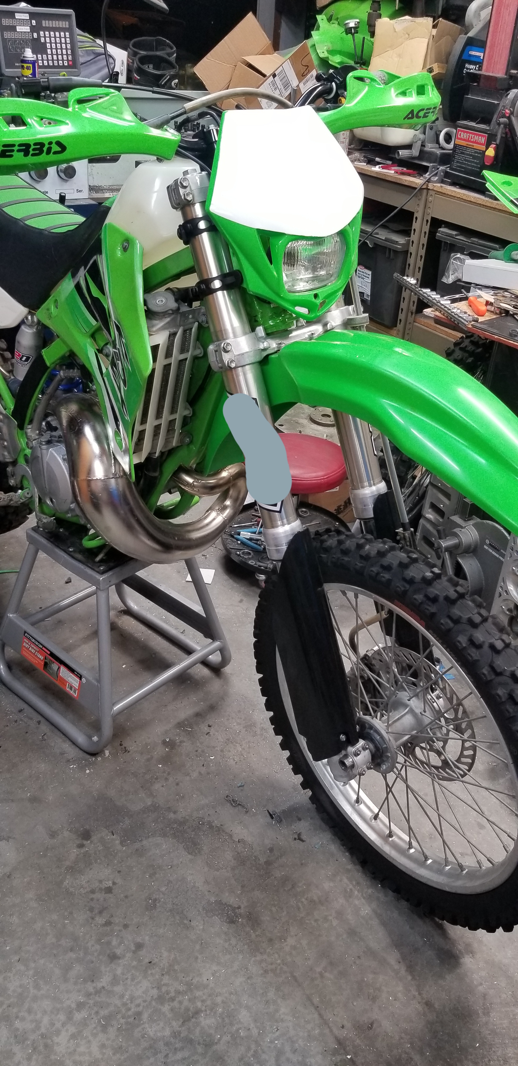

Help! I put 1997 KX125 forks on my 220. The shop I used is well known, friendly and does good work. He sounded confident when I dropped them off but the first configuration he gave me was unrideable. We've gone back and forth 4 times and they are now rideable but no where near compair to my 1995 kx250 which is amaizing. So I know the older forks can be made to work. Unfortunately the guy that did the KX passed away some time ago.
I am 235lbs and used to be fast but mostly ride at just a quick pace these days.
What I know of the current set up.
1 inch lowered internally
.46 custom springs set at 6mm preload
5wt oil
120mm oil height
2 face shims and a 2 stage base stack
Midvalve o-ring removed replaced with spring.
Compression clicker all the way out.
The rear shock works well and the free sag is 35mm and rider sag at 105
So the bike is becoming fun to ride again but the main problem is over small square edged bumps. Like the acceleration/braking type. I would also like to see the clicker not all the way out.
Anyone have any advice as what to change/focus on next?
Thanks!

That's why I took it to a suspension shop. In the hope that it would be close when I got it back. The shock he did works great. We have made progress in the forks but I fear he has lost "enthusiasm". It seems to me that it is a midvalve issue. I guess I was hoping someone would confirm this and know of a good baseline midvalve shim stack and float number so I can give him a suggestion or at least have a clue when I talked to him next.
The big issue for me to take over the valving work is that I would not be starting from stock and I can't seem to find what stock was. I am also buried in work and after 3 month of installing the front end and adjusting it I just want to go riding with my son. I am inclined to just put the stock front end back on because they will be soon closing the mountain riding areas for the winter.
- 20211114_095324.jpg (4.33 MiB) Viewed 6386 times
