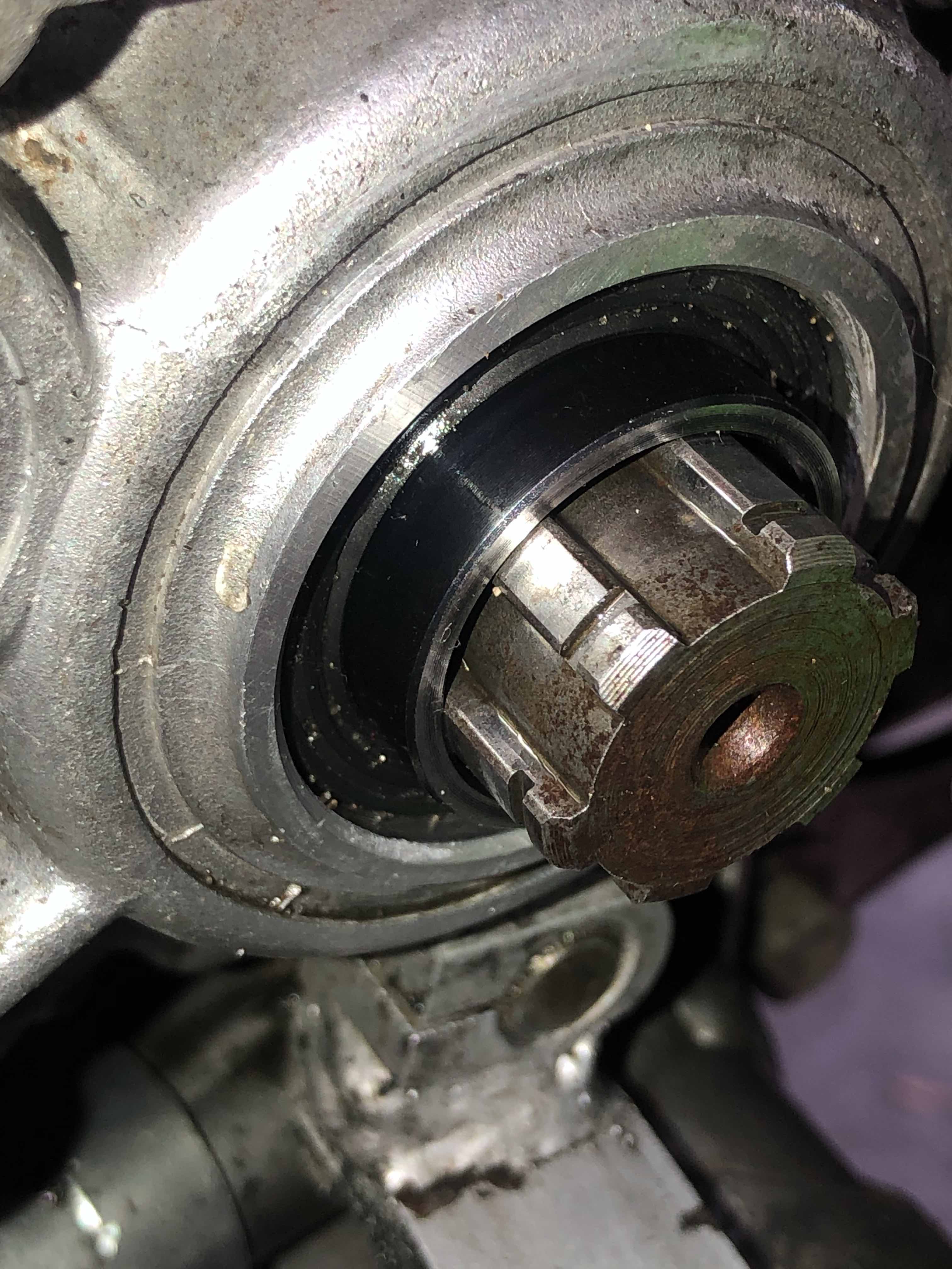

No I did not. However I think I found something. The Cyclepedia manual shows the seal at the edge of the case. I believe this seal needs to be pushed slightly below the edge. I took a pic of where I have it now, and at rest she is not leaking. Will have to do a ride later to see if its tight.
There is no side or up/down play. My chain is not too tight either. Maybe the "upgraded" seal needs to seat further in. Thats the only thing I can think of at this point.

- Posts: 1690
Re: New Countershaft Seal kit but still leaks
That seal is pushed in WAY too far. Should be flush with the outer lip.
- Posts: 14643
yep. that is the problem
The pic is from AFTER replacing the seal that was flush with the case. I moved it in maybe 1/8" in (from flush). It has not leaked since, but I haven't had a chance to ride it yet. Will report back after a good ride this week.

- Posts: 14643
Just lean it way over to the left. You'll find out quick instead of loading it up and finding out your ride is over.
- Posts: 1690
Its supposed to be flush with the case. If it leaks when it's installed correctly, something is wrong. If you push it in too far, it won't allow enough oil to hit the backside of the seal and you'll burn it up in short order. It needs lubrication to slip on that collar as the bike runs.
Thanks Nick. I didn't push it all the way in. Its barely below the case by maybe an 1/8". I understand that pushing it in too far will do damage. Thats why I was super careful. There looks to be enough room to seat it slightly in the case. After 2 tries, this is the first time its holding oil.Slick_Nick wrote: 09:16 am Oct 25 2021 Its supposed to be flush with the case. If it leaks when it's installed correctly, something is wrong. If you push it in too far, it won't allow enough oil to hit the backside of the seal and you'll burn it up in short order. It needs lubrication to slip on that collar as the bike runs.

- Posts: 6116
Eh, I think you'll be fine. You should still get oil to the back of the seal when running and leaning to the left so I, personally, wouldn't worry.
Three, 30 min rides. All seems fine and no leaks. Will keep an eye on it tho.
