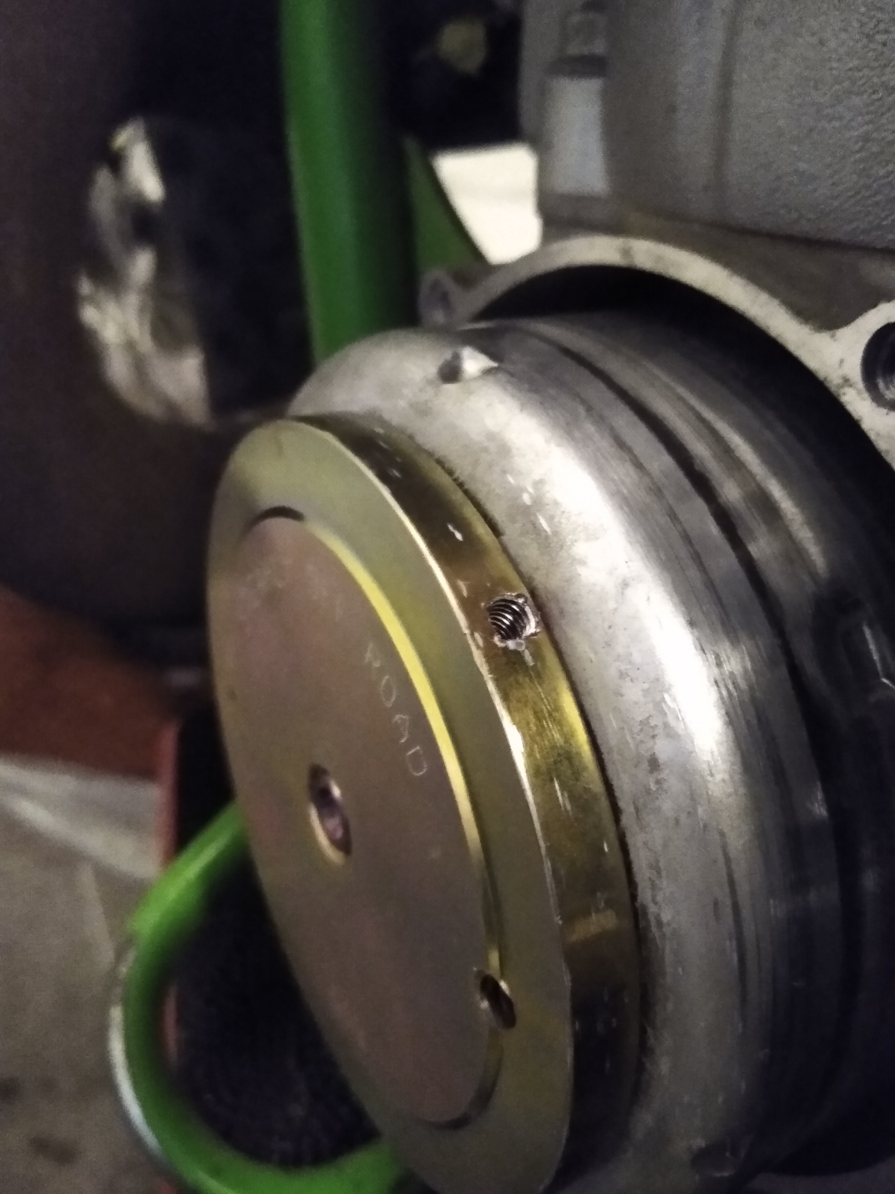

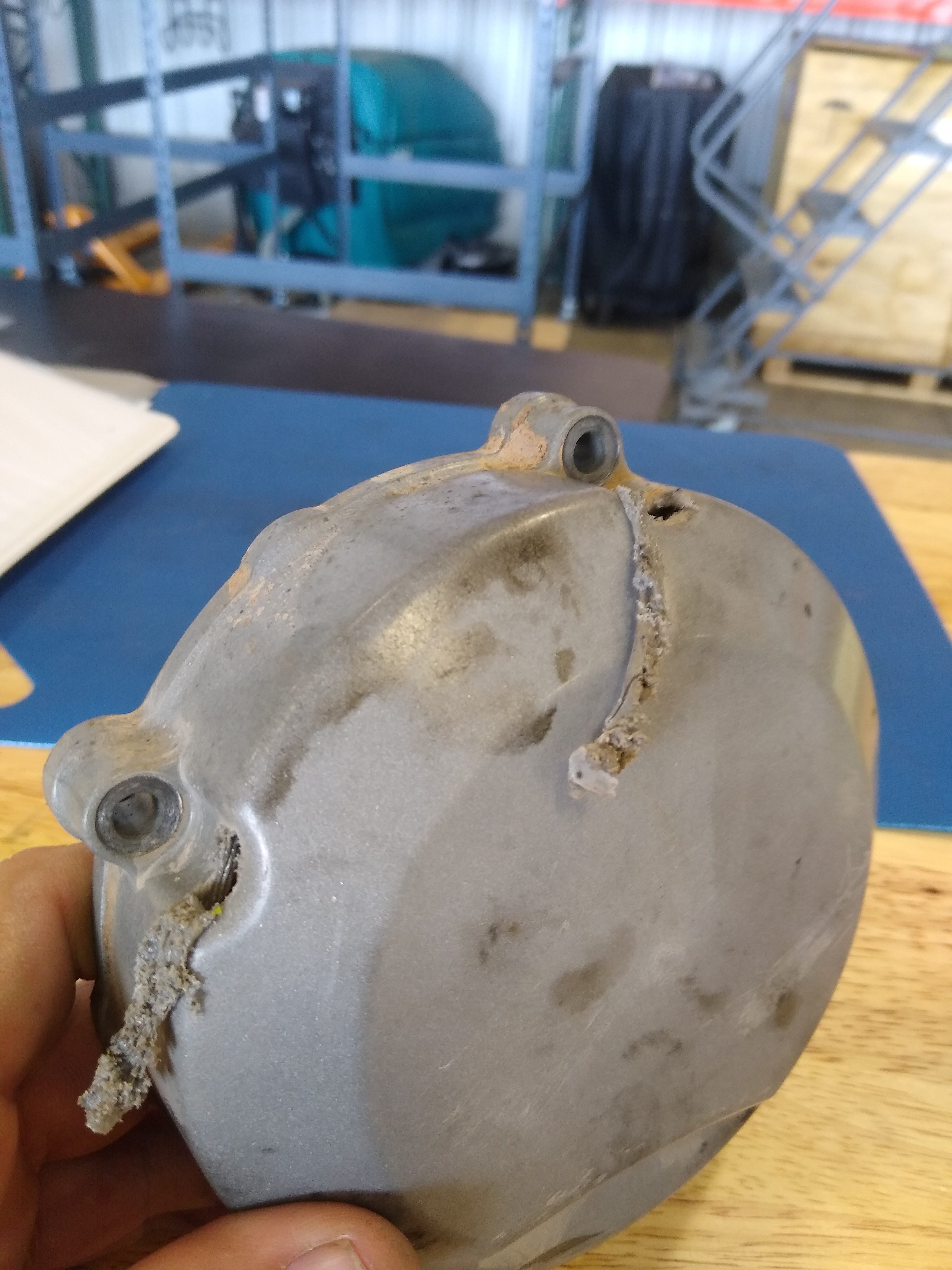

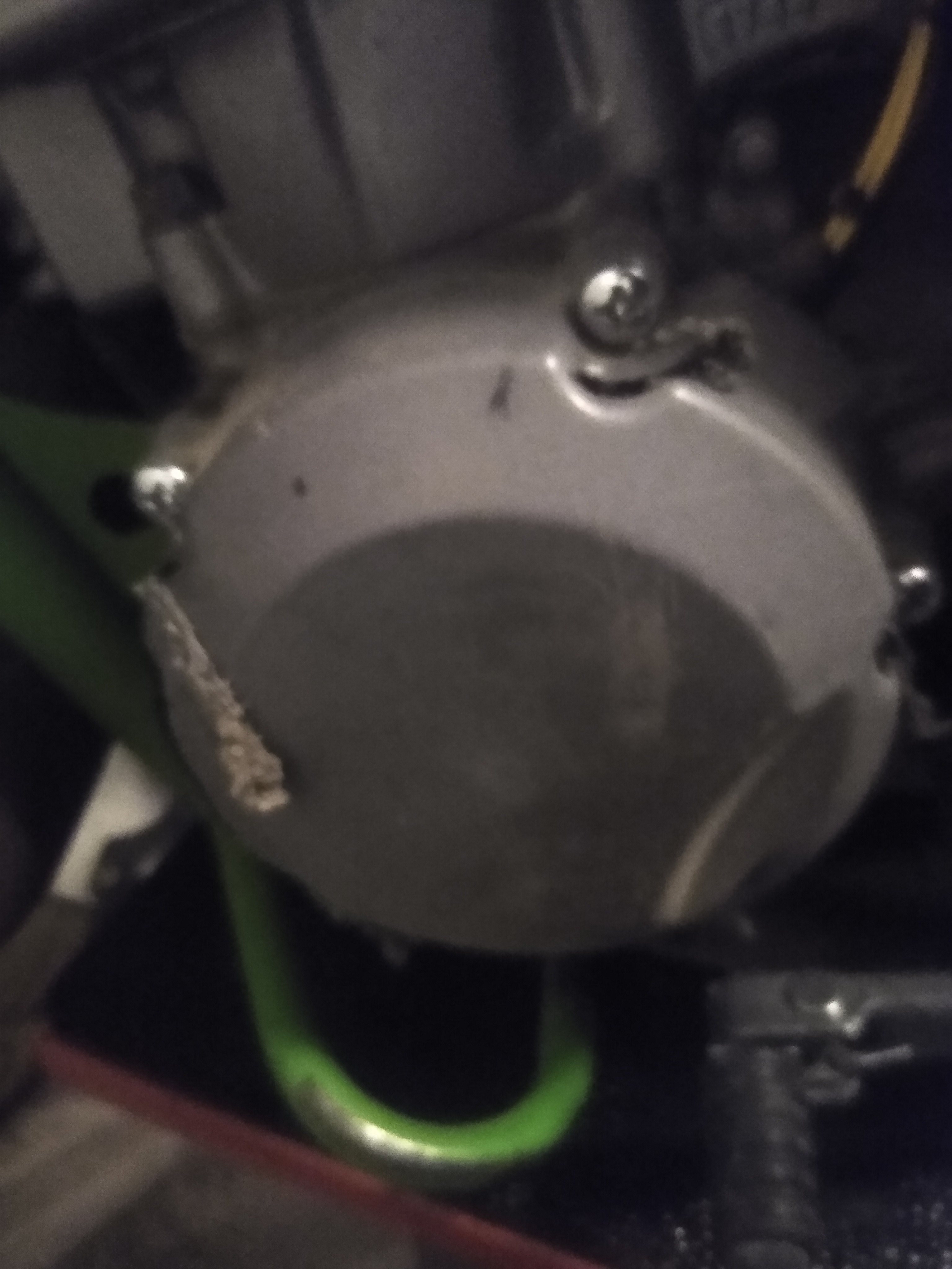

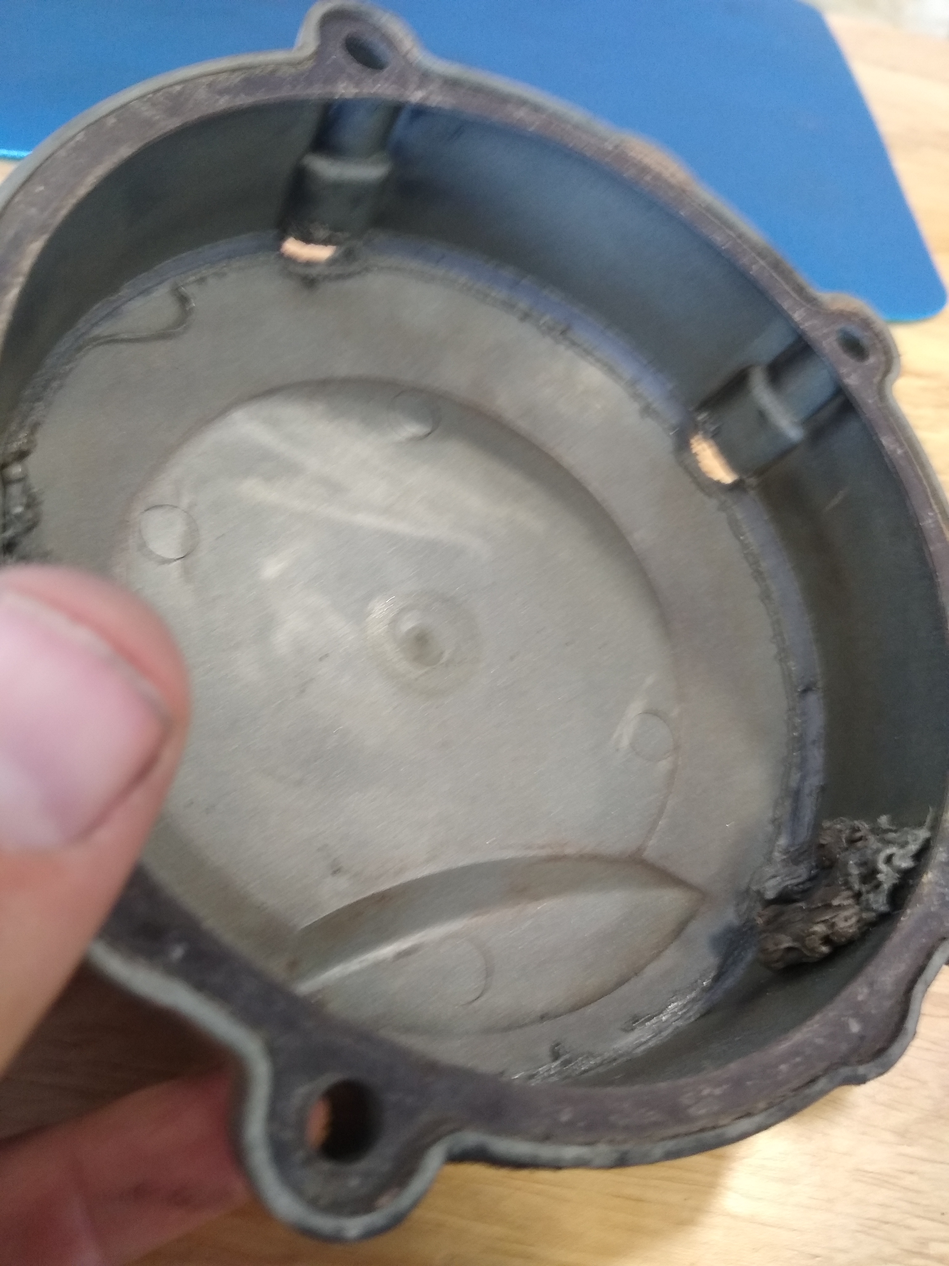

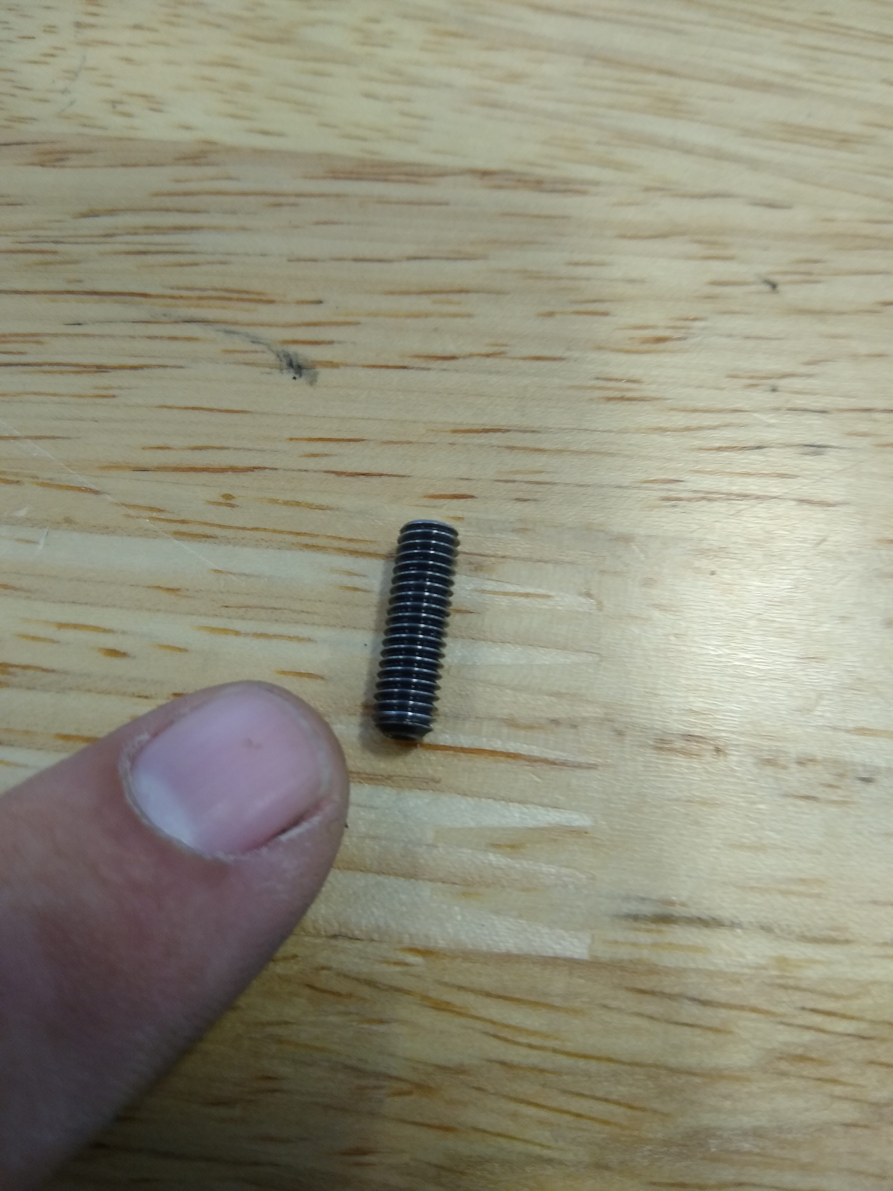

So this happened...
the Steahly off road flywheel weight had a come apart and wrecked the cover. One of the set screws backed out. There is three of them. I checked when I installed it, considered putting on some threadlocker on 'em, but I didn't because they are peened in there...This shouldn't be possible, but it happened to me.

Murphy's law i guess, If it can happen, it will happen.
Any other damage beside the cover?
Will you keep the weight, or do without?

Bummer. Never trust anything if you don't have to! When I install a flywheel weight for someone that has the little set screws I always do so with some medium strength (blue) loctite on them. Just gives me peace of mind knowing they're not going to come back to me with a failure like yours. You can probably save that cover using some epoxy like JB Weld (not the putty type) or similar.

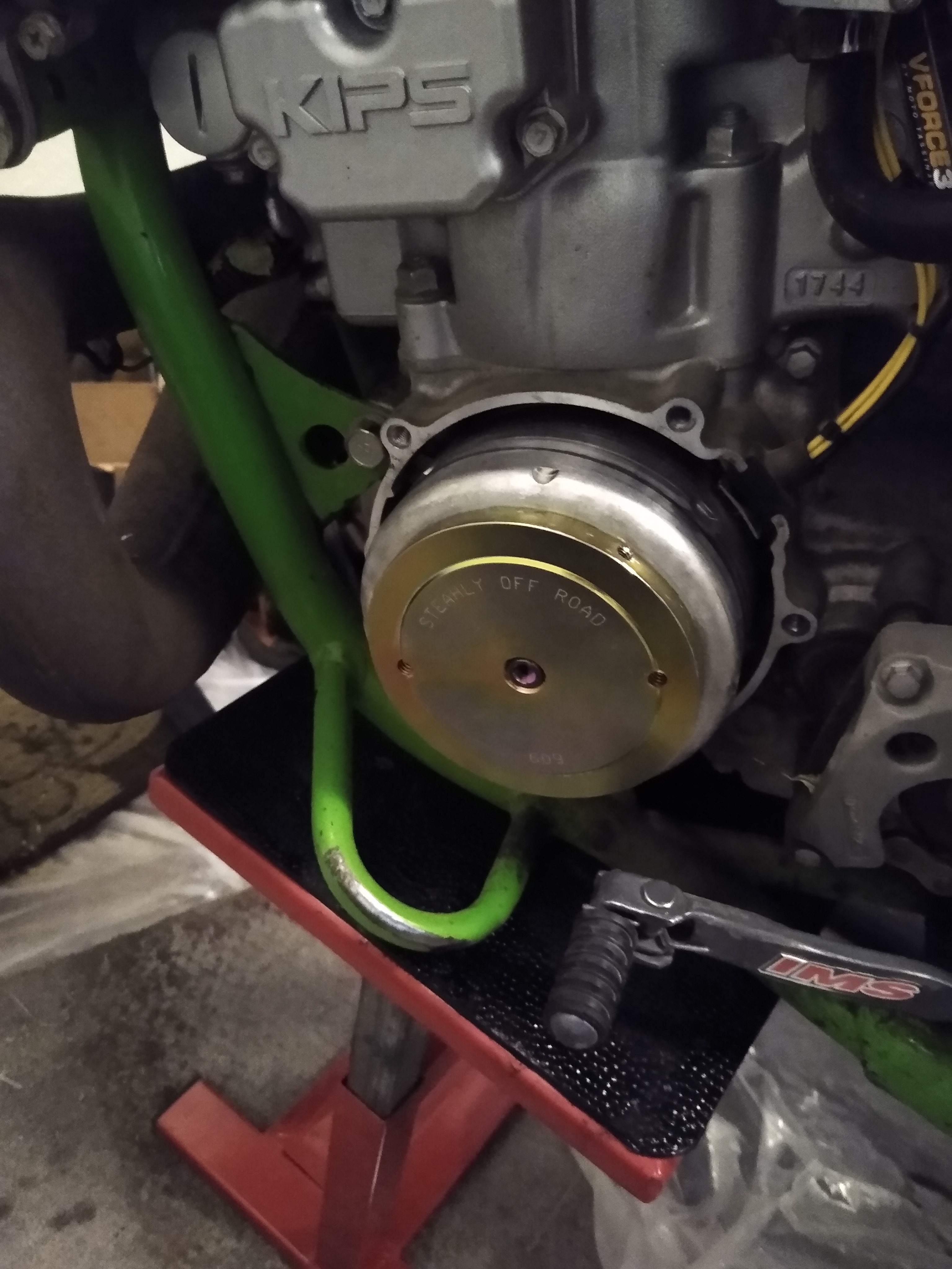

Doesn't seem to be any other damage. I'll probably put it back in with some loctite and try to peen 'em a little better. I found a cover on ebay, so that's on the way. True that the KDX comes with plenty of flywheel. This is probably not the most necessary of mods, but I kinda like it. It chugs along through the more technical stuff. Makes it that much harder to stall. Seems easier to find traction, and I stay off the clutch as much. So that probably keeps everything a little cooler.
