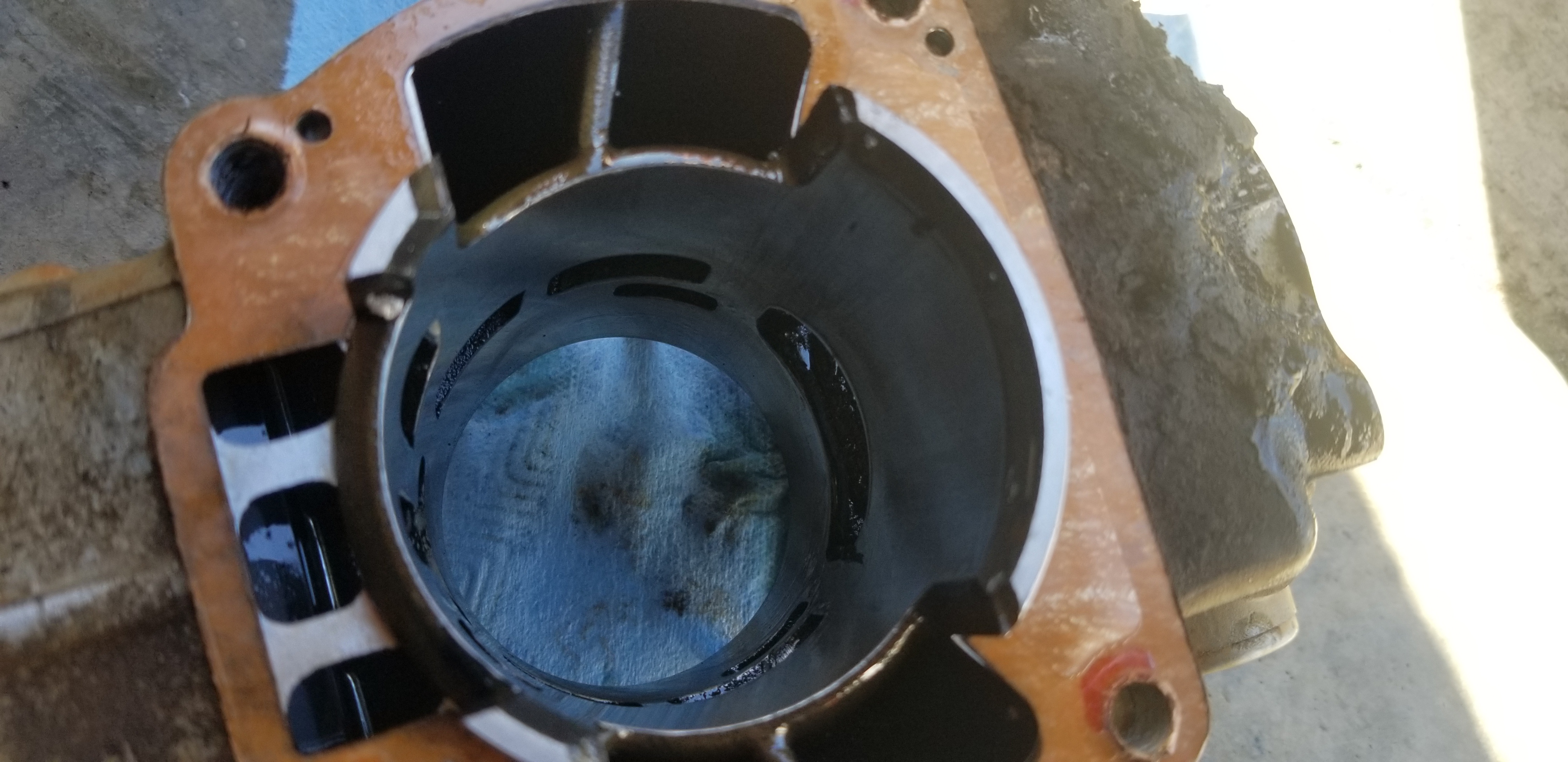

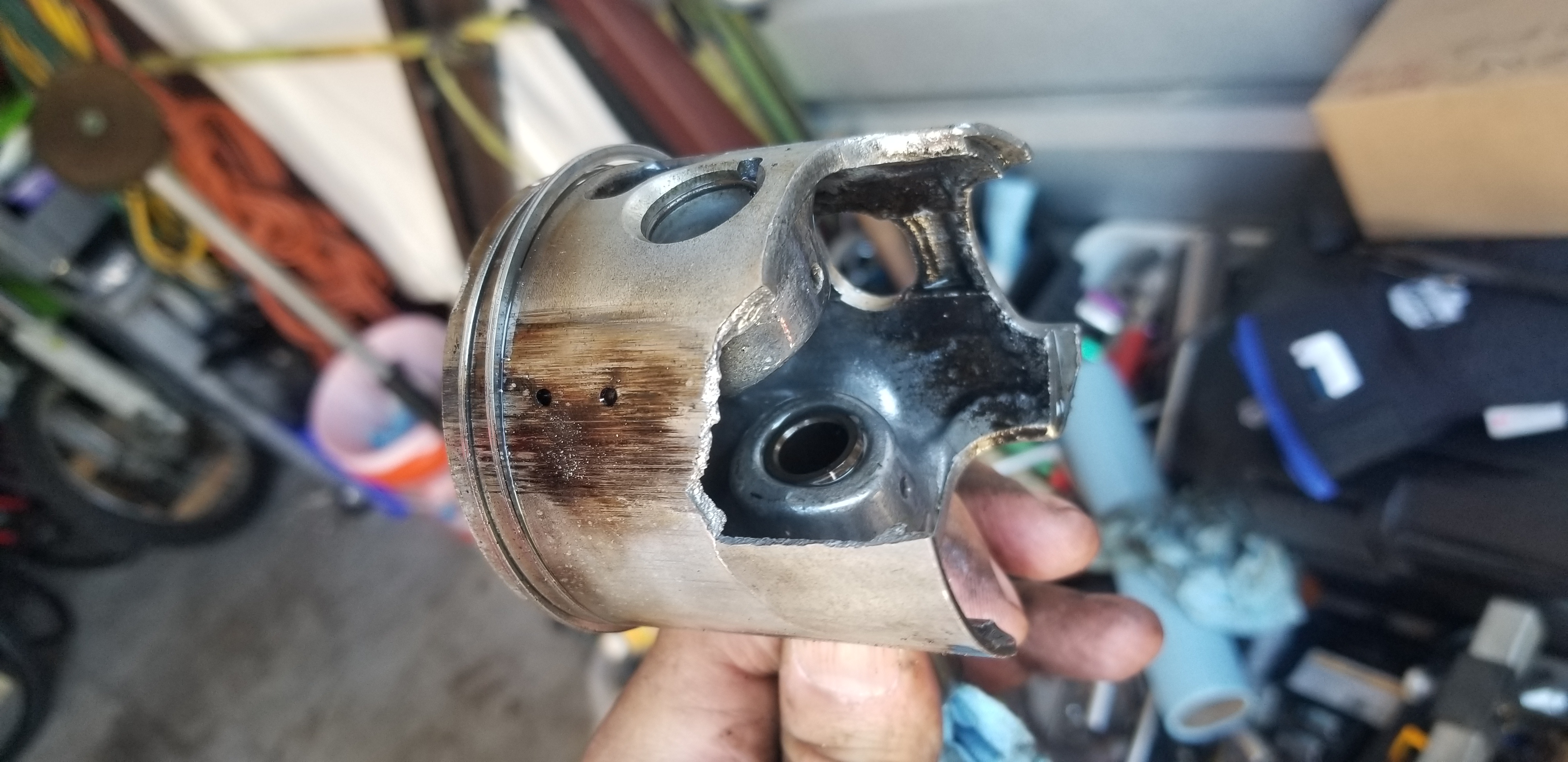

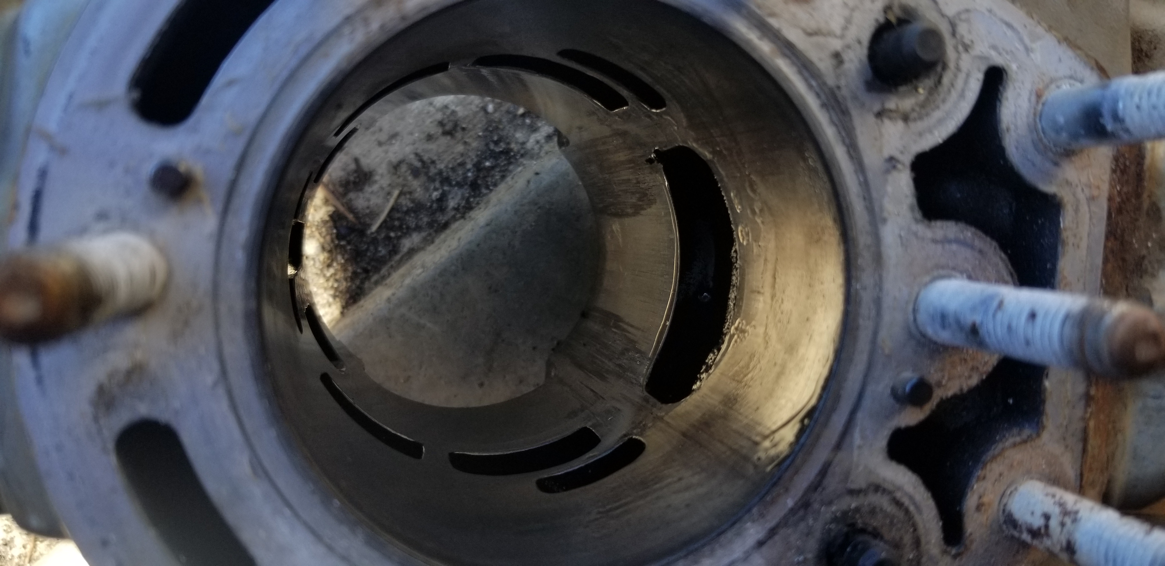

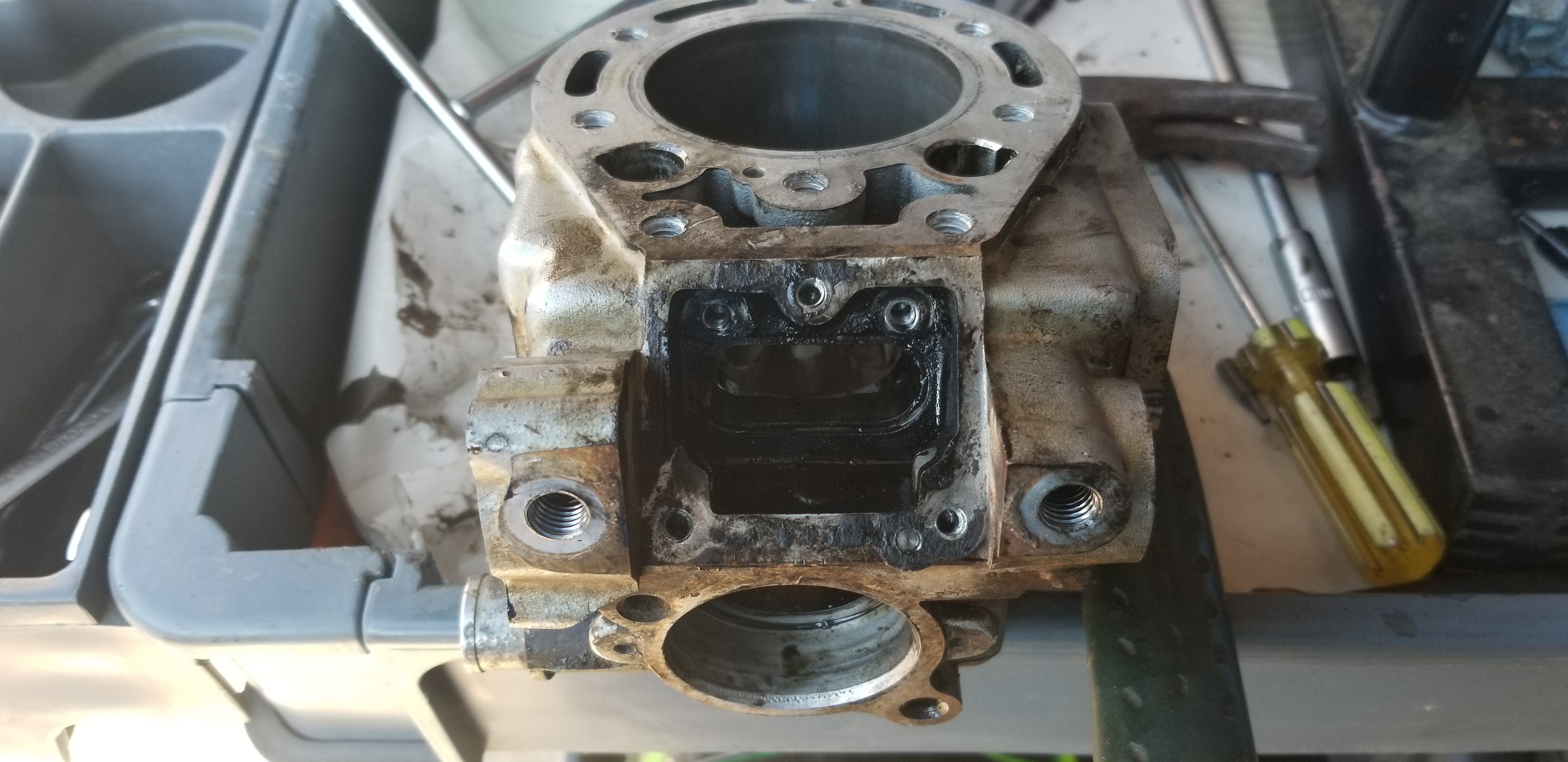

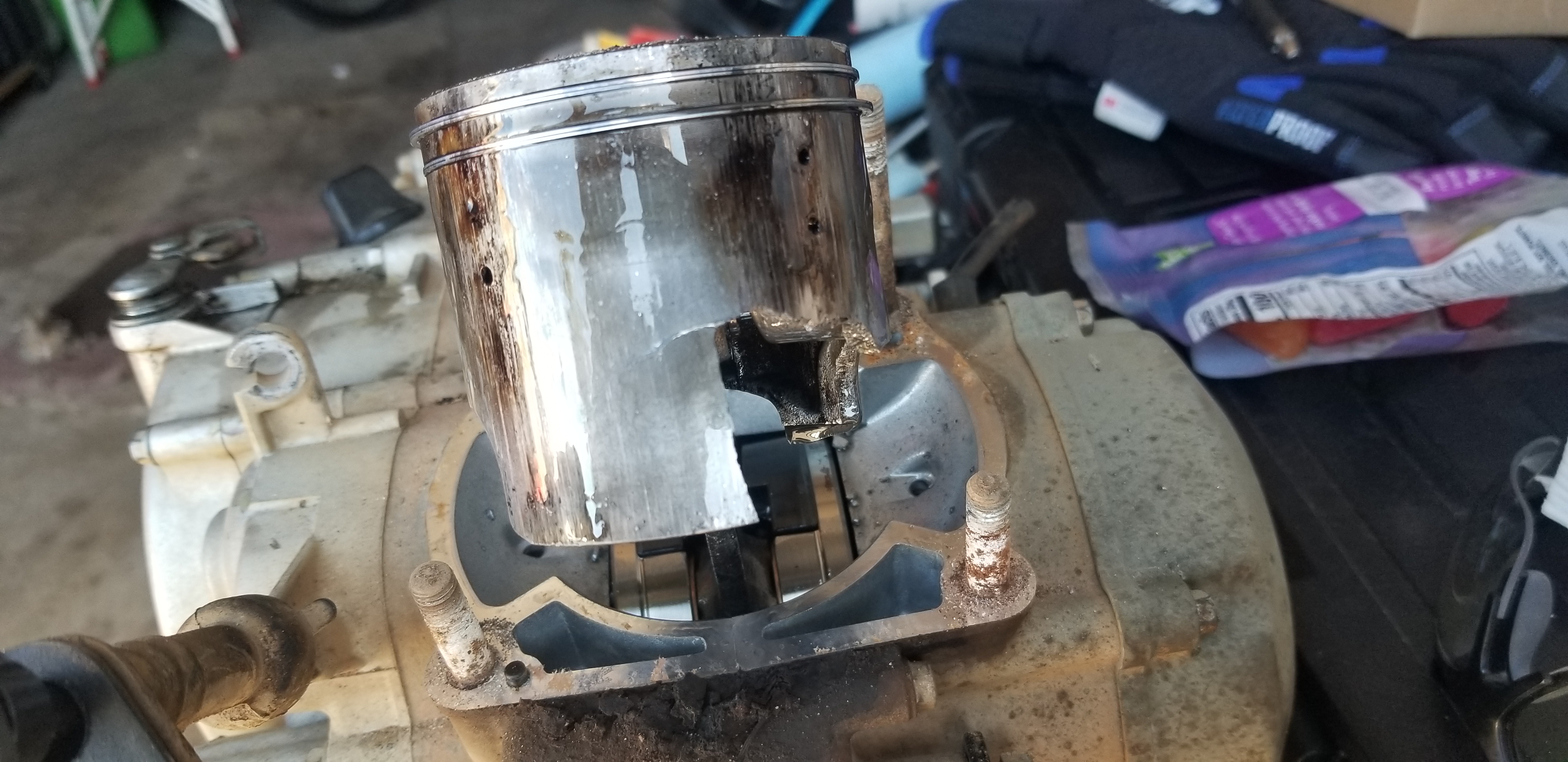

We've all heard the horror stories, and seen the recommendations, and I'll add my experience to the list. I have owned my 220 since it was brand new in 2001. Spent a lot of time in the Florida panhandle woods the first few years. Then 4 years in North Dakota where the riding season is short, and the last 11 years in the Pacific Northwest. Probably around 4500 hours on it between it's original form and the hybrid it is now. I never heeded the advice because honestly I'm cheap and would rather ride than wrench, and always figured if it did blow up then it was a sign to get a new bike lol. So about 8 miles out into the woods it meet it's demise. It wasn't a bad event, the bike just lost power on a climb and turned over but wouldn't start. Pulled the plug which was very wet, thought "huh, that's odd", and put a new plug in. Fired right up and made a sound no body ever wants to hear out of their bike so shut it down. Conferred with my riding partner (son) who said something smart mouthed like "guess you should have taken you own advice" or some such rubbish and we found out way out to the nearest FS road where we employed the tow strap (I do take some of my own advice
) and we made it back to the truck for the drive of shame home. Initial pics below hurt to look at. The financial advisor (wife) was quick to affirm that it was repairable and there would NOT be a new XC\W under the Christmas tree lol. Of course now I have a good excuse to do some tear down pics on the way to a fresh motor. It will be getting new bearings and seals throughout, as well as the wiseco and possibly a replate. Initial look send like most of the skirt went to the bottom end and not a lot of damage to the head or cylinder.
- 20210920_141246.jpg (2.07 MiB) Viewed 5192 times
- 20210920_141236.jpg (2.73 MiB) Viewed 5192 times
- 20210920_140721.jpg (2.15 MiB) Viewed 5192 times

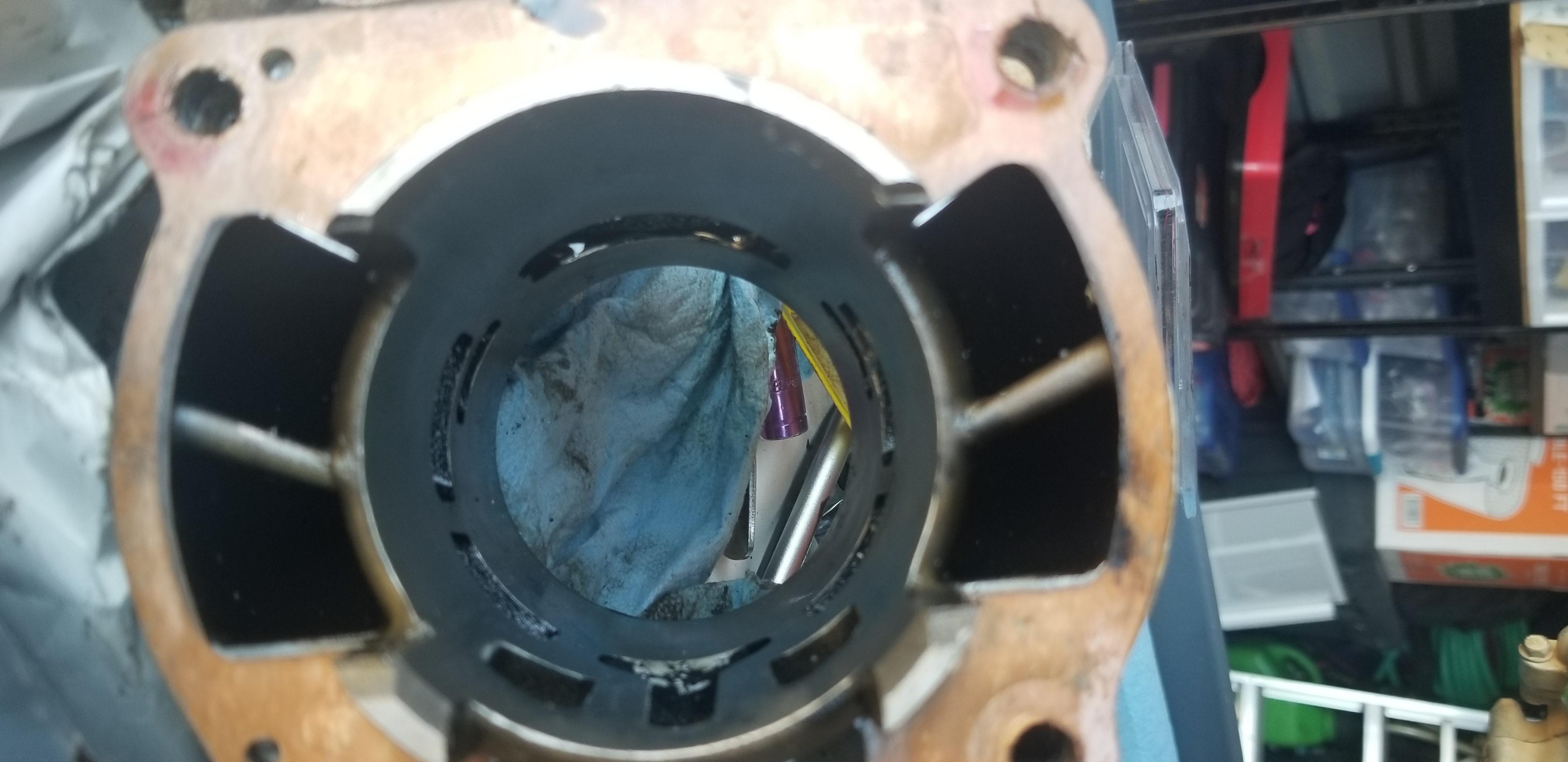

More, looks like a replate is in order
- 20210920_140635.jpg (2.22 MiB) Viewed 5191 times
- 20210920_140624.jpg (2.47 MiB) Viewed 5191 times
- 20210920_140706.jpg (1.99 MiB) Viewed 5191 times

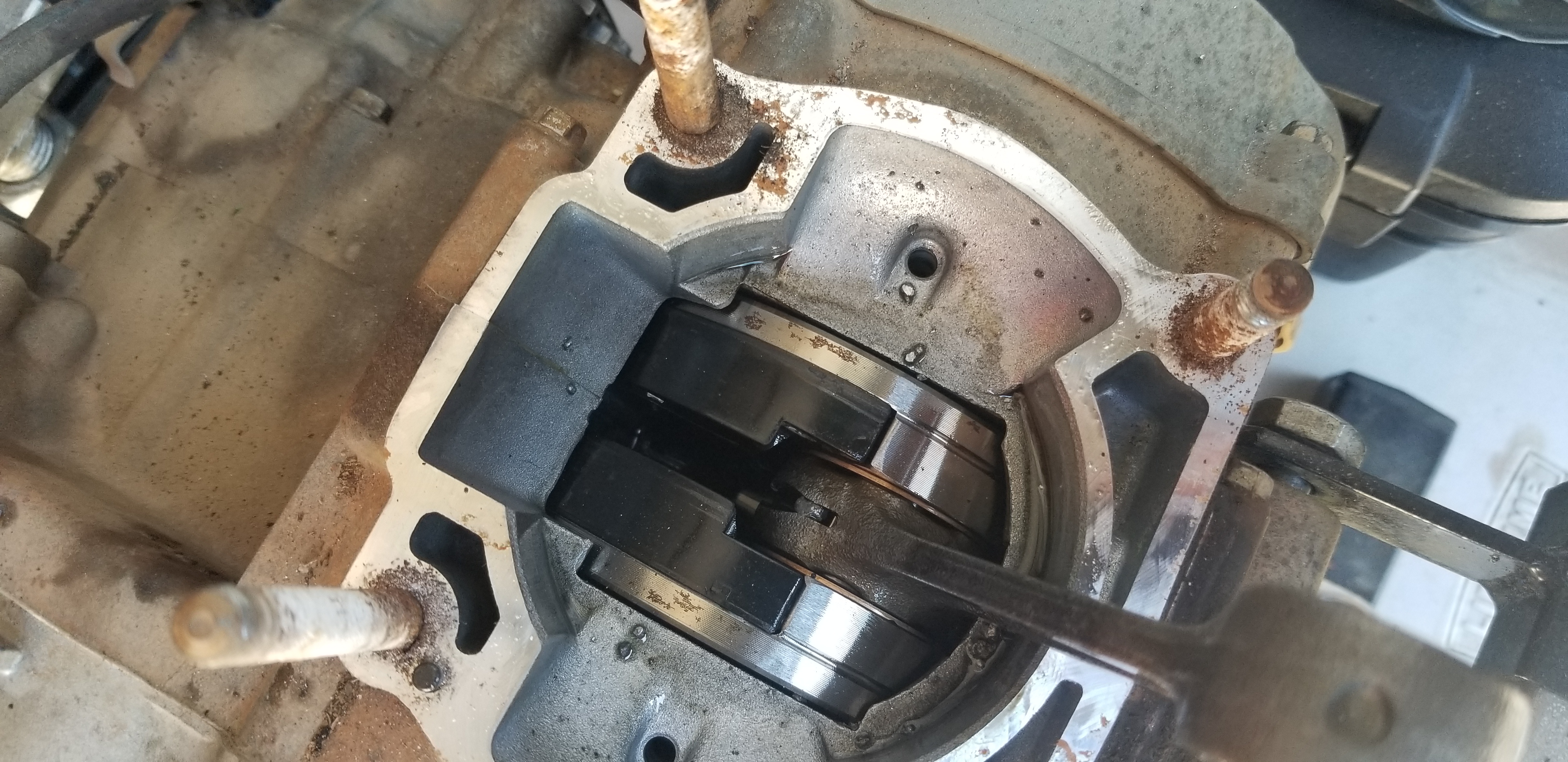

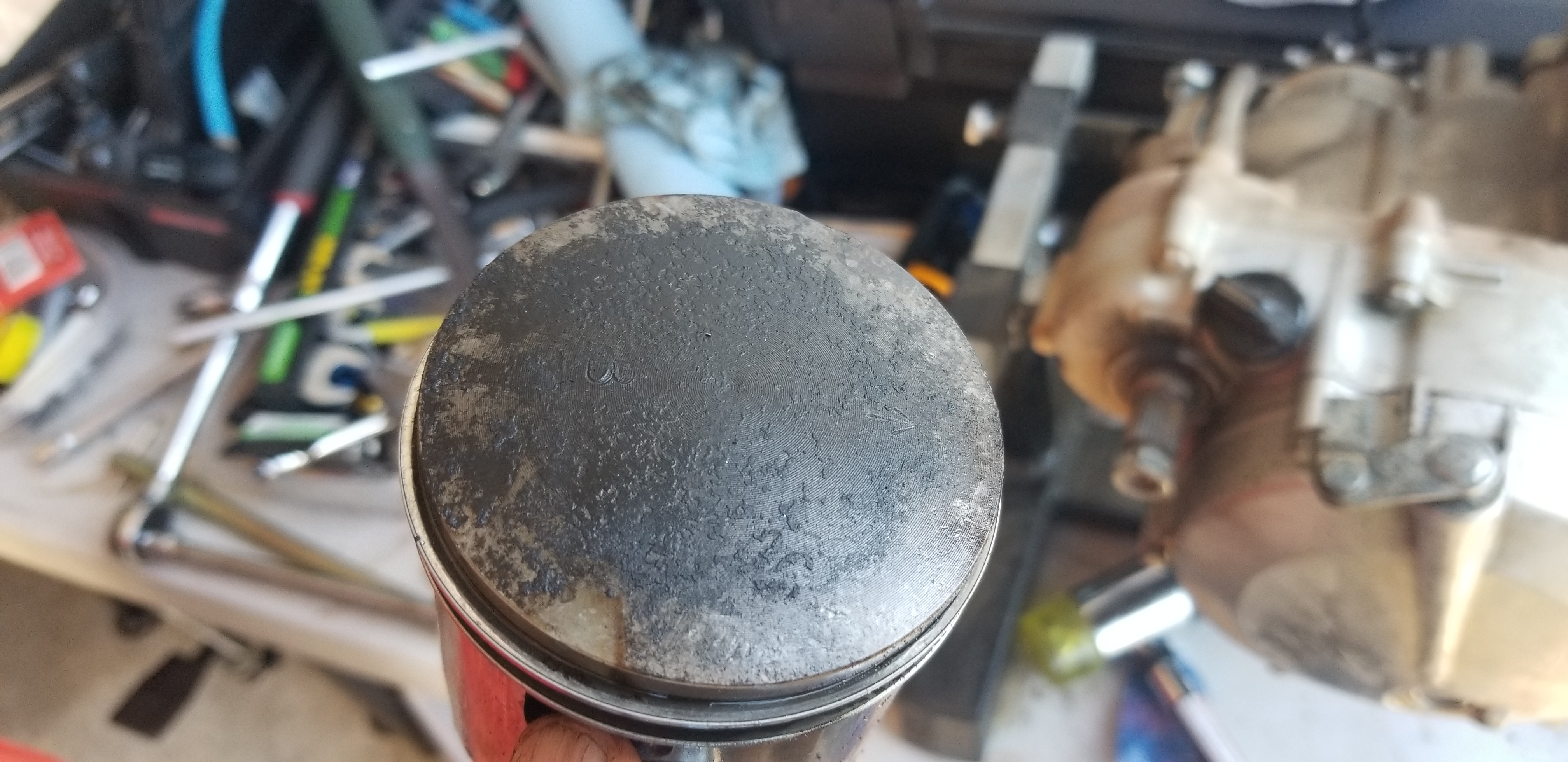

And more. Piston doesn't look too bad for the hours on it.
- 20210920_141442.jpg (2.34 MiB) Viewed 5191 times
- 20210920_141447.jpg (1.82 MiB) Viewed 5191 times
- 20210919_190539.jpg (2.65 MiB) Viewed 5191 times
- 20210919_190424.jpg (2.36 MiB) Viewed 5191 times

SEE!! Only got 20 years and 4,500 hours on it! REPLACE IT IMMEDIATELY!! :-)

Man, you were lucky! You ended up with almost zero damage. You're also lucky in that a stock 220 piston lasted that long. Should have replaced it at least 2000 hours ago!

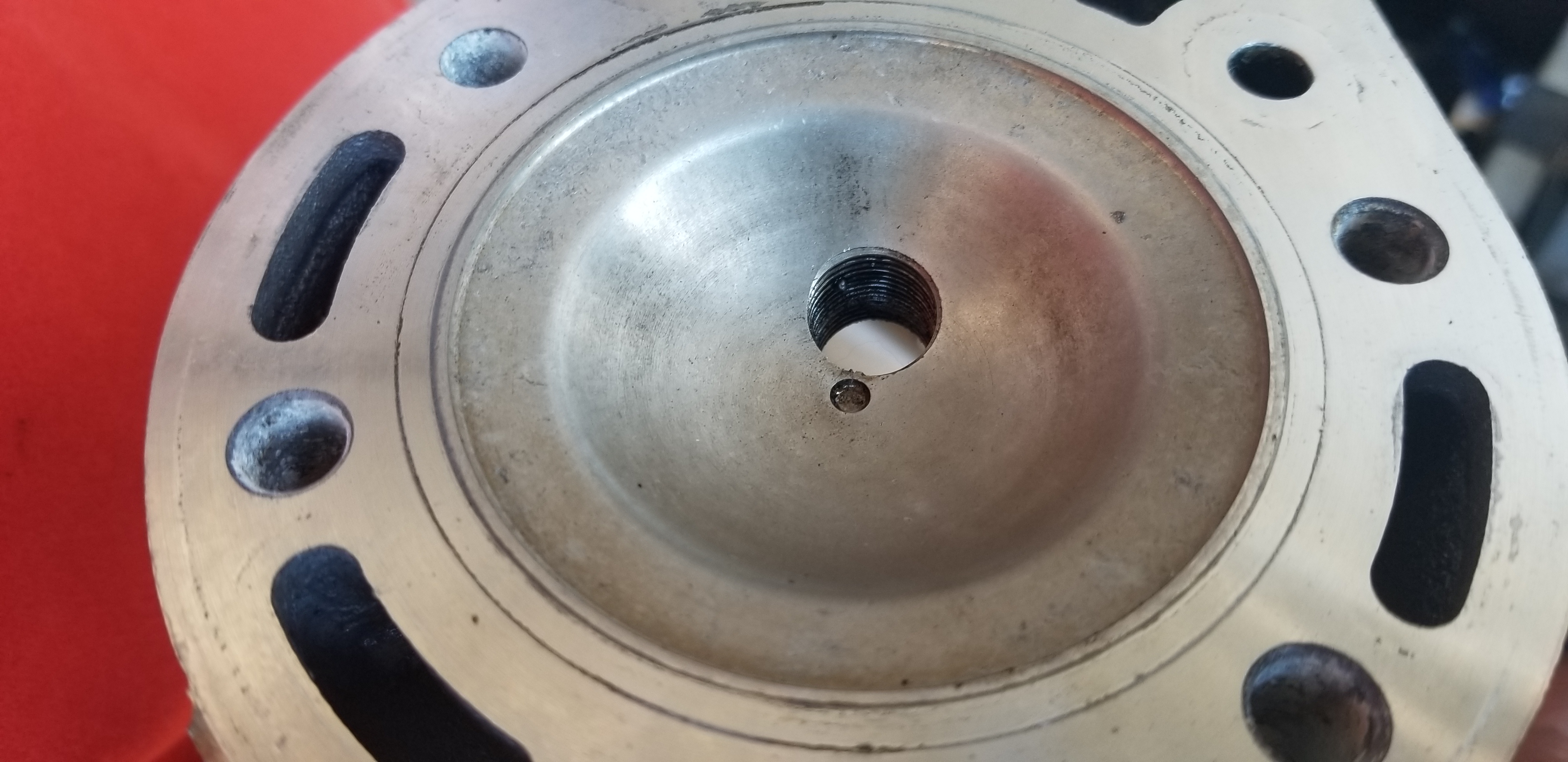

- Posts: 14643
Re: Another 220 Piston Story.
MoonStomper, it's not a Honda Civic. :-)

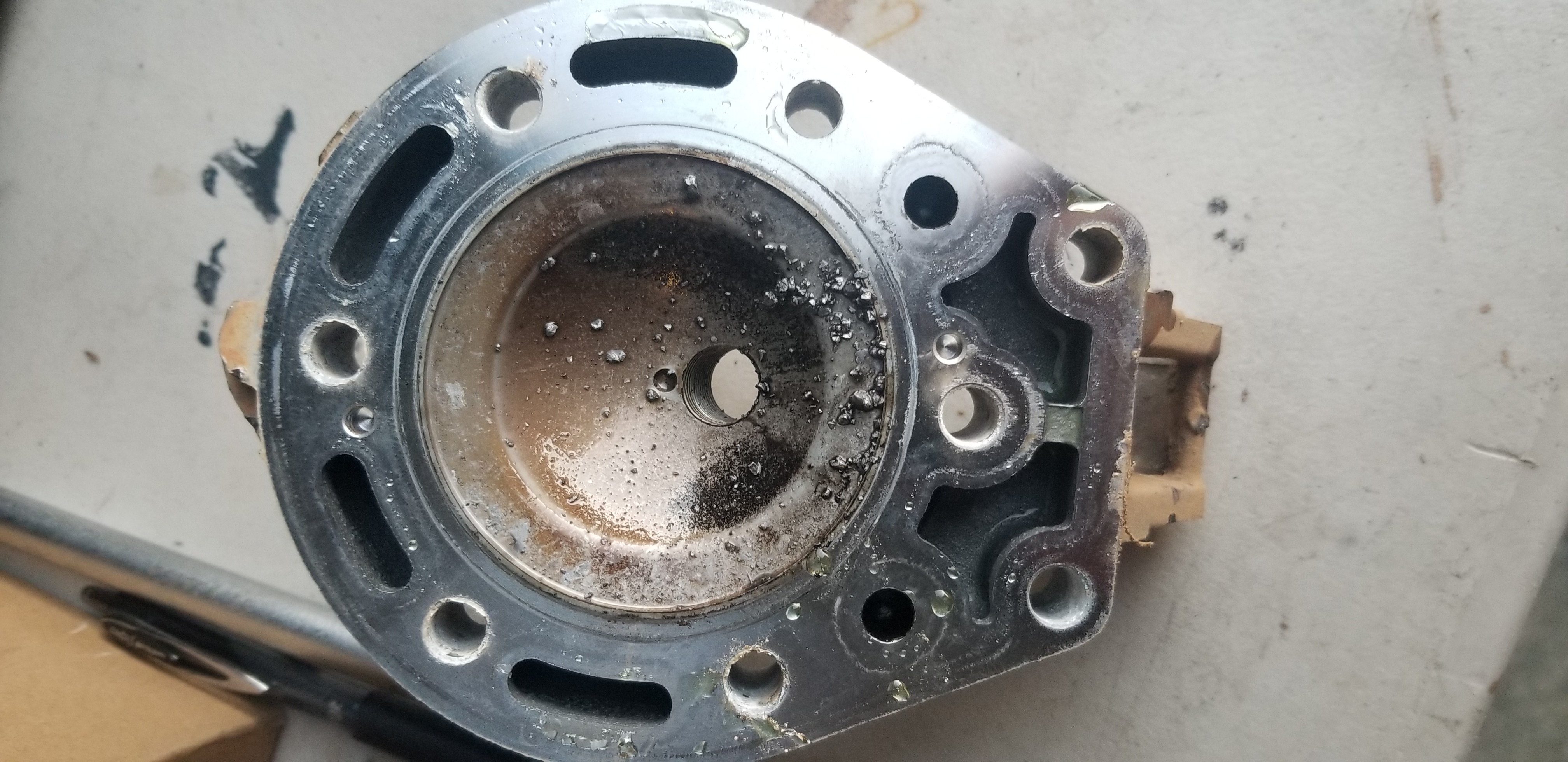

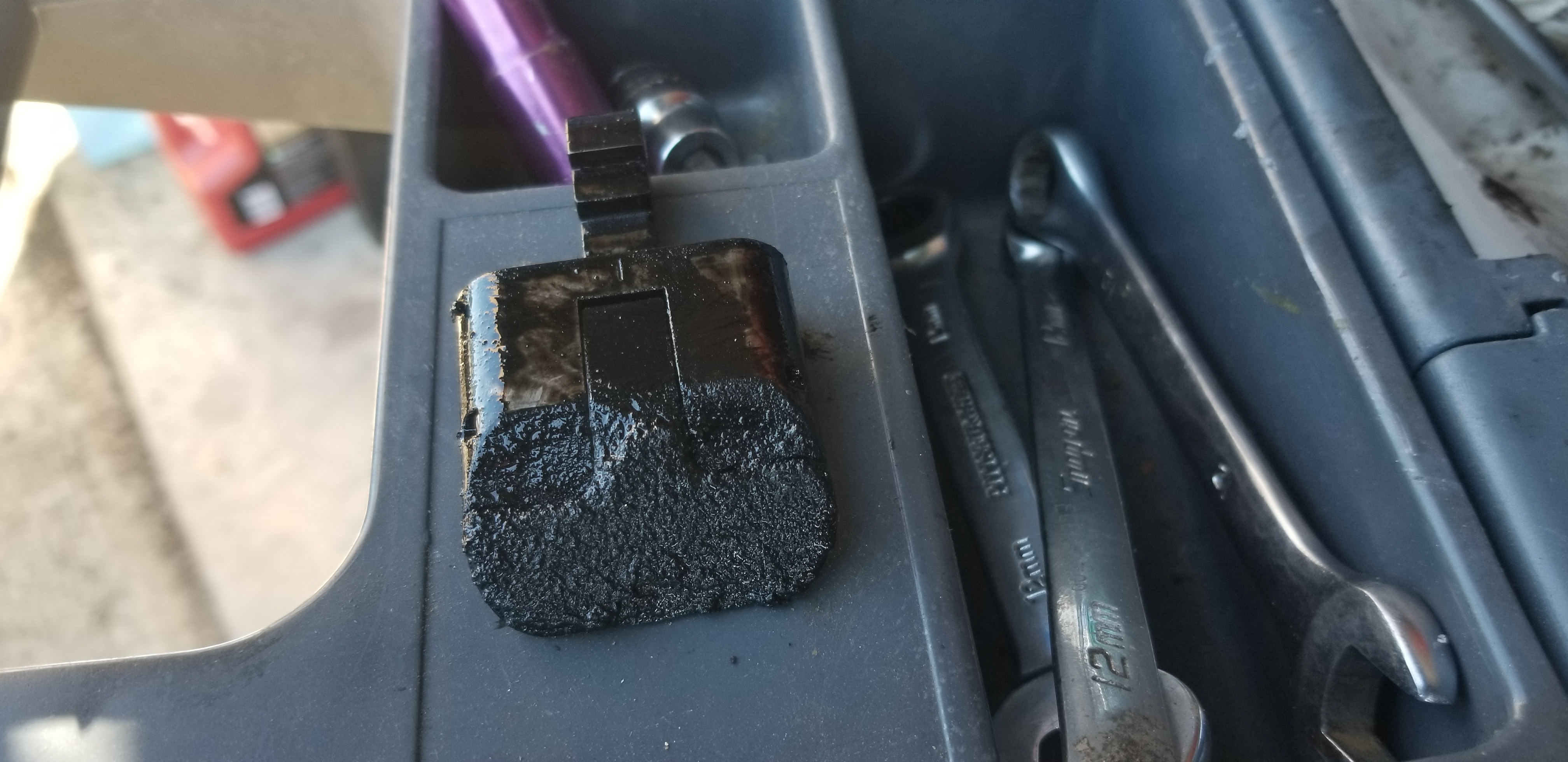

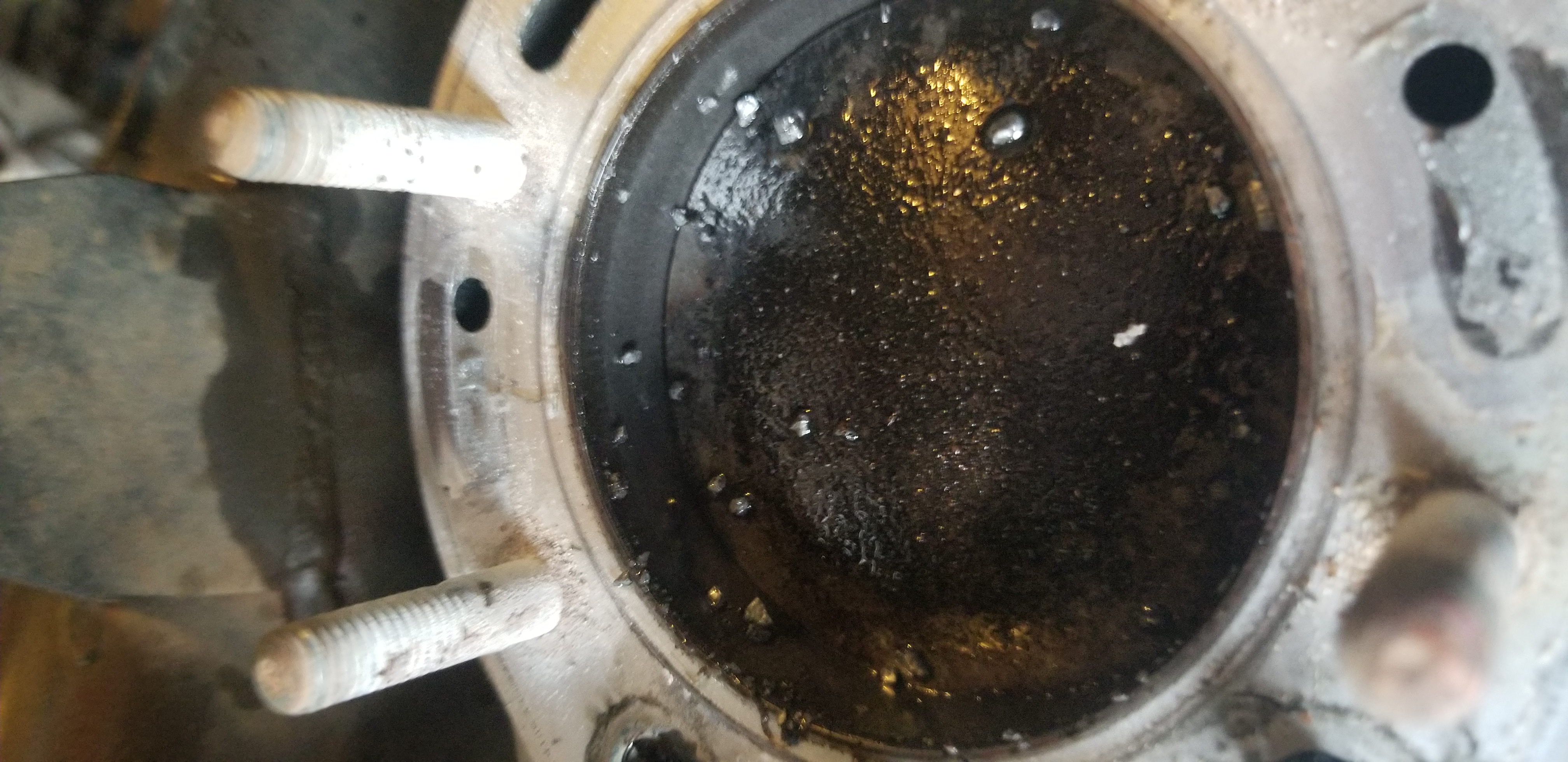

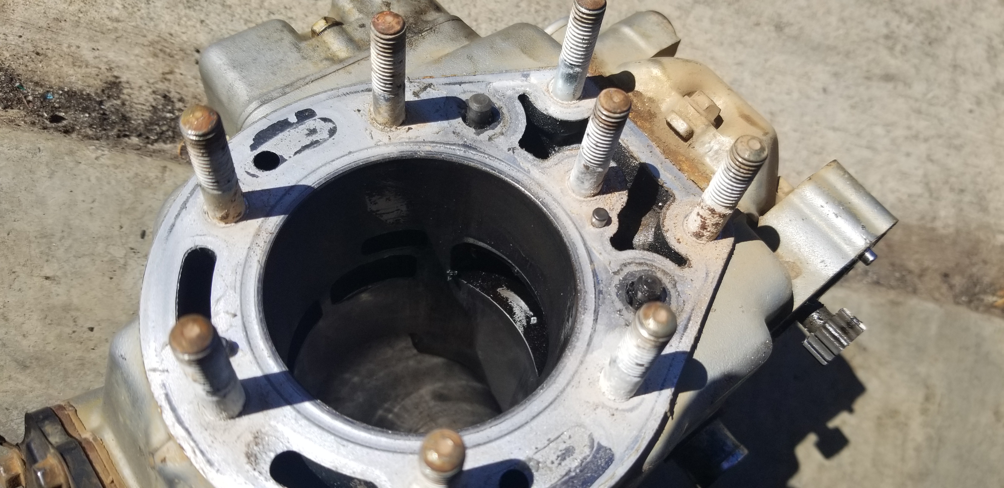

Few more pics from tear down. Carbon build up not too bad, plenty of lubrication present lol. Cleaned up now and what initially looked like damage was just carbon and debris from the skirt. Actually looks pretty good, given it's she it'll still get a replate for good measure.
- 20210925_134346.jpg (2.11 MiB) Viewed 5056 times
- 20210925_122853.jpg (1.63 MiB) Viewed 5056 times
- 20210925_134407.jpg (2.14 MiB) Viewed 5056 times

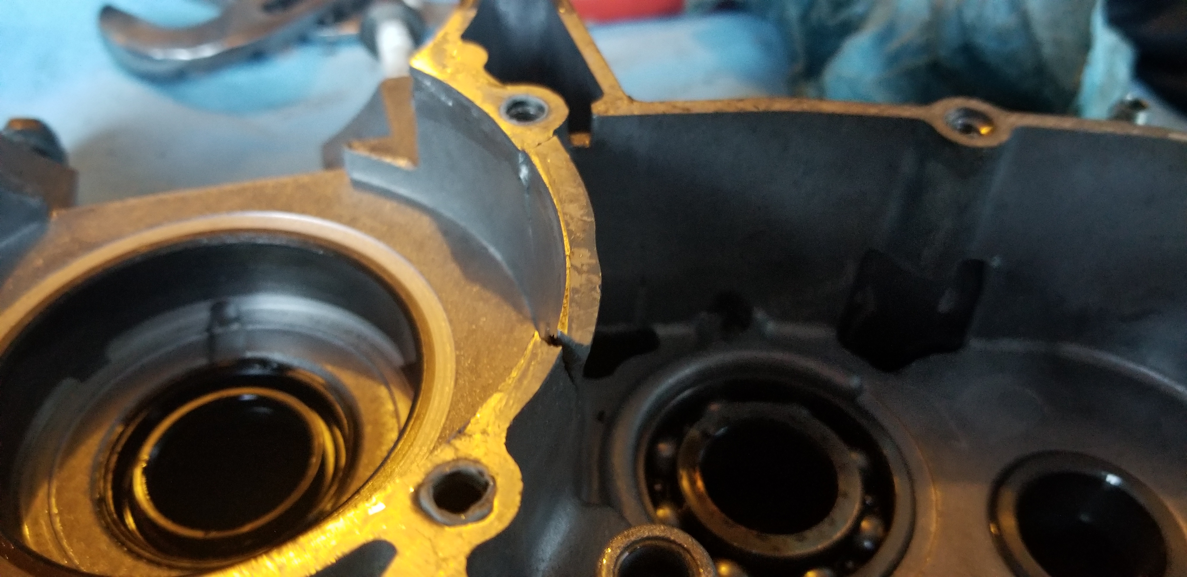

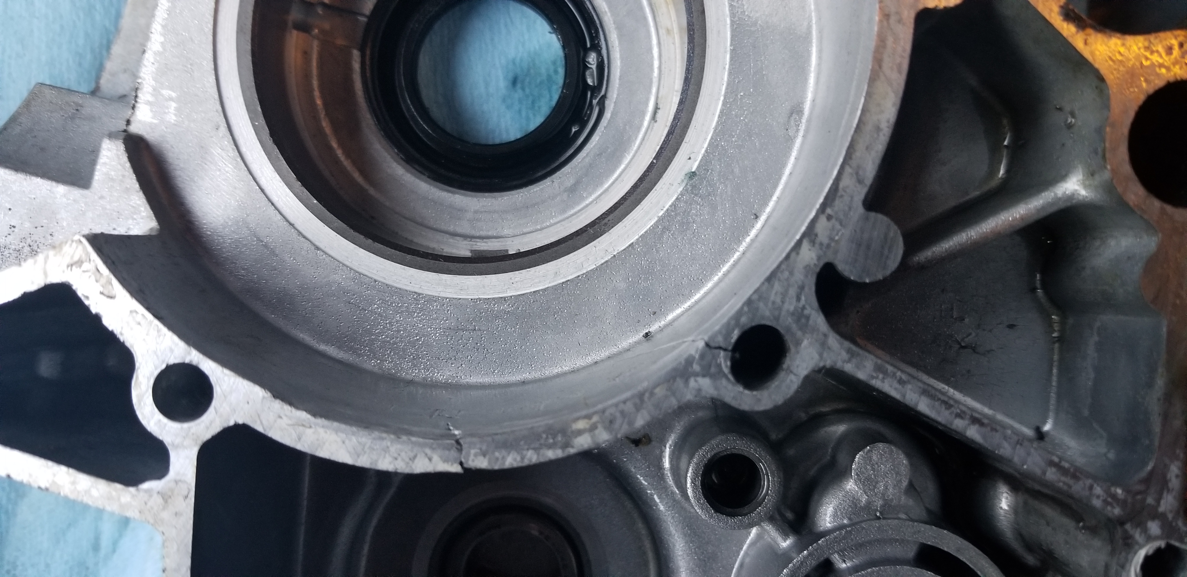

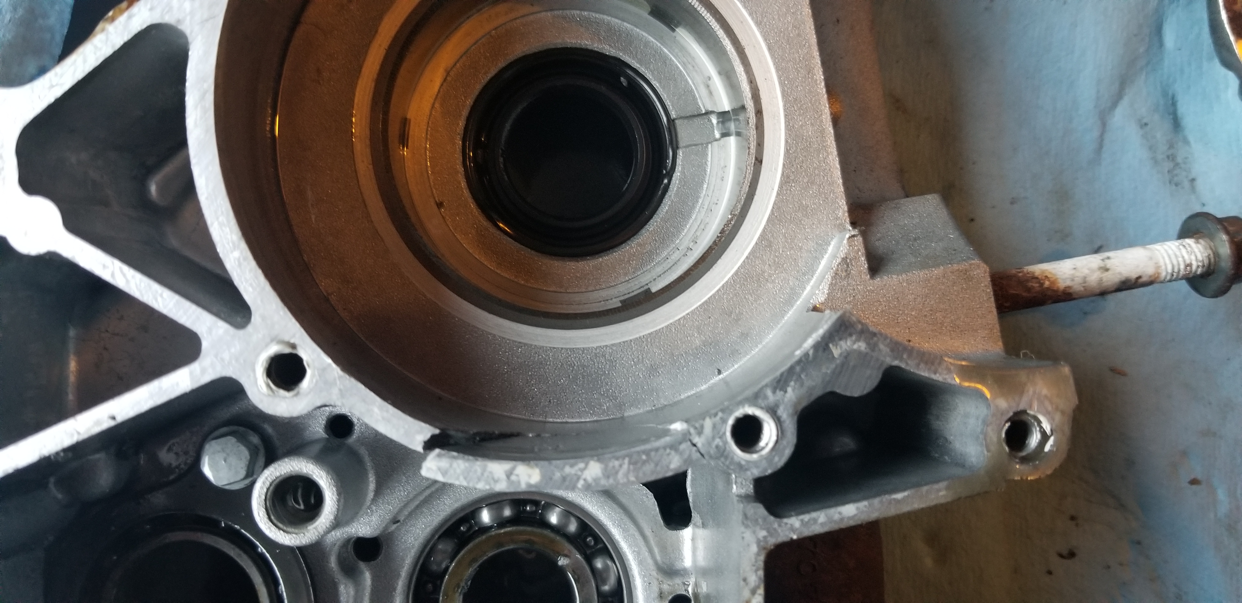

Finally got around to splitting the cases today. The good news in all this is that my cylinder suffered no damage. Off course that means there is bad news, and it is that I am now shopping for new case halves. Going to have a welding shop that specializes in engine work take a look, but I fear it may be unsalvageable.[album][/album]
- 20211024_173216.jpg (2.59 MiB) Viewed 4859 times
- 20211024_173149.jpg (2.4 MiB) Viewed 4859 times
- 20211024_173156.jpg (2.38 MiB) Viewed 4859 times
- Posts: 6116
Ouch!
Is that damage from the piston coming apart?
- Posts: 14643
Oopsies.
Check the cylinder for egg shaped wear also.
- Molly's 70
- Posts: 668
That can be welded.
- Posts: 3552
Yes, looks as if the skirt came apart in big pieces that were then used to jackhammer the internal baffle between the bottom end and the transmission. If it can be welded that will be a minor miracle.
- Posts: 6116
This is why you can't trust a cast piston in the 220. Most people get pretty lucky. Sadly, you did not.bufftester wrote: 03:18 pm Oct 25 2021Yes, looks as if the skirt came apart in big pieces that were then used to jackhammer the internal baffle between the bottom end and the transmission. If it can be welded that will be a minor miracle.
