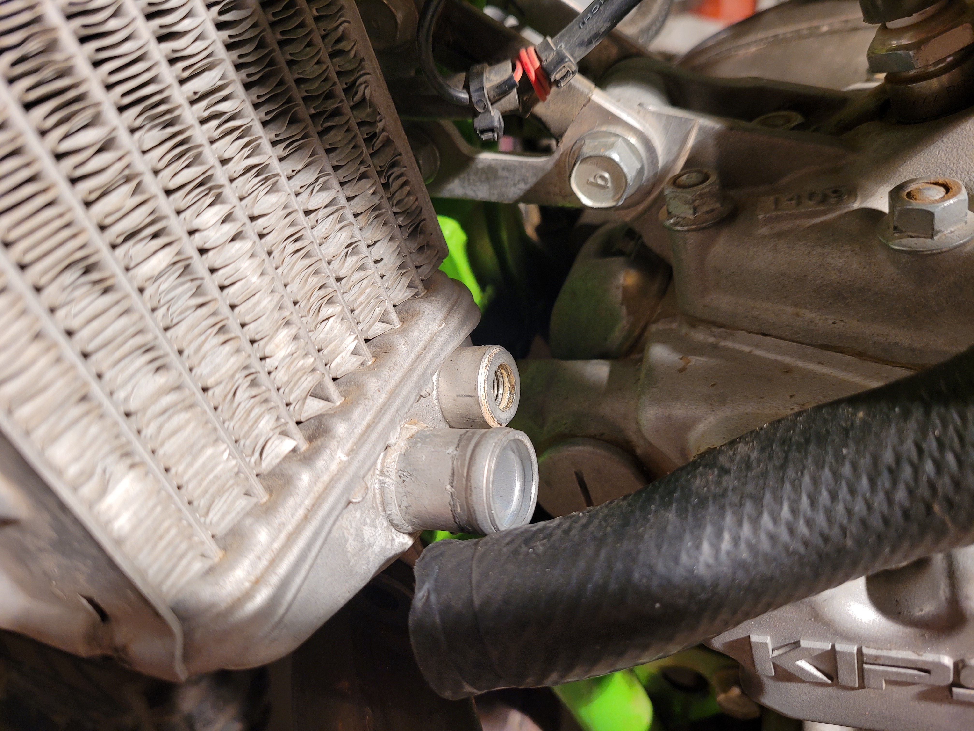

Photo 1 shows view of lower portion of left radiator. The 19mm inner diameter (I.D) black tubing comes from the cylinder head. The coolant is hottest when exiting the cylinder head. Inboard of the 19mm tubing nipple is a threaded coolant system drain. The OEM plug is a black ferrous bolt with a flat head requiring a 5mm allen wrench to remove/install. I modified this plug.

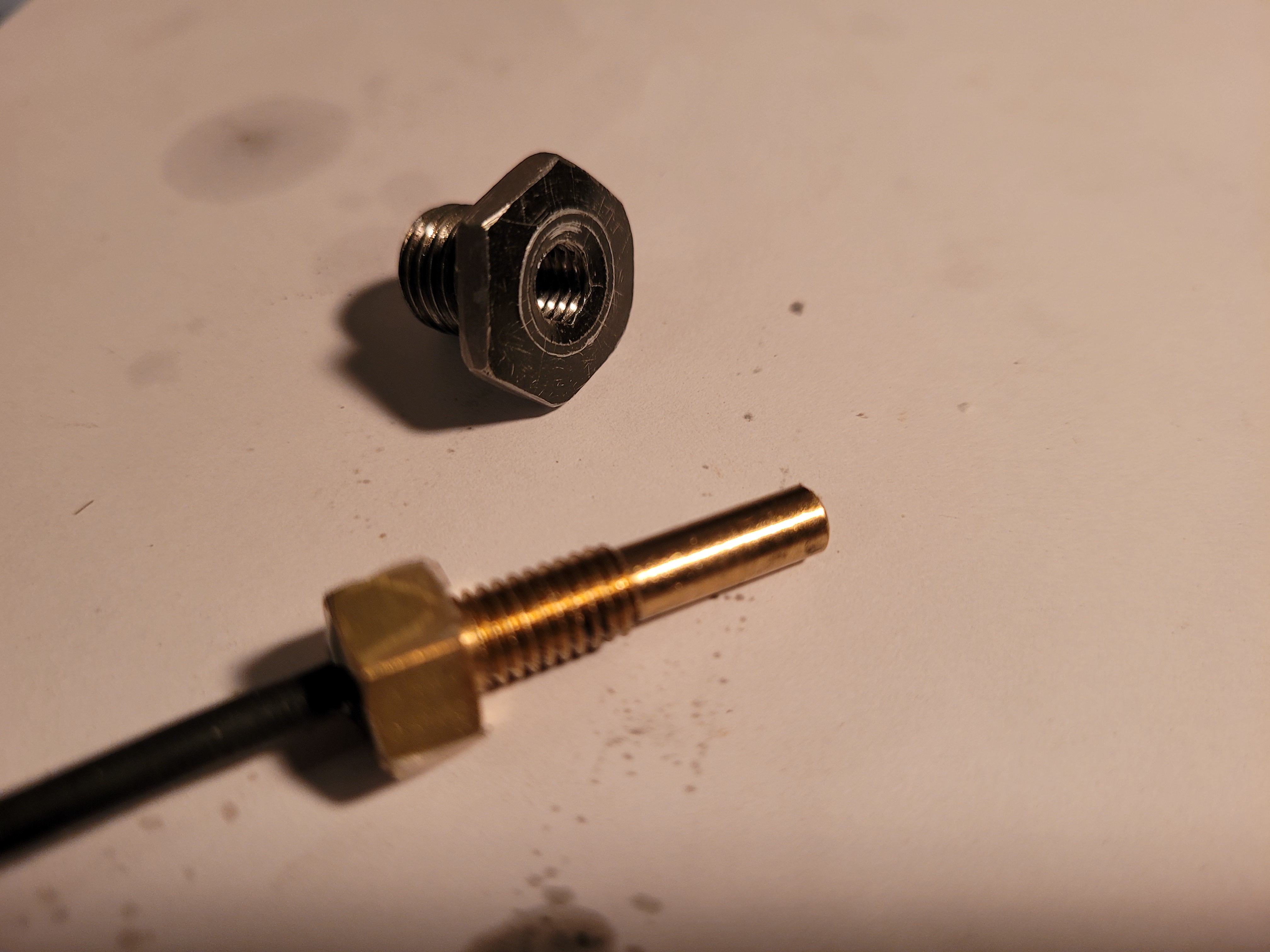

Photo 2 shows the modified radiator drain plug. I drilled the plug through its center resulting in an 13/64-inch hole. This hole was threaded with M6 x 1.0 mm tap. I also filed 6 flat surfaces on the originally circular plug head to accommodate a 16mm wrench. This photo also shows the thermocouple V300-003 that will be installed through the modified drain plug. Before it was possible to use the thermocouple, it was necessary to significantly increase the wire length. Thermocouples are not sensitive to wire length and are not calibrated to a specific wire length (like other temperature sensors). I actually transplanted the relatively long wire from the thermocouple installed in the 25mm boss. CAUTION: these stranded wires are very fine! It’s easy to damage them and/or accidently cut them when stripping insulation from them. After soldering the wire from one thermocouple to the other, shrink wrap was installed onto wire splices for a professionally looking job.

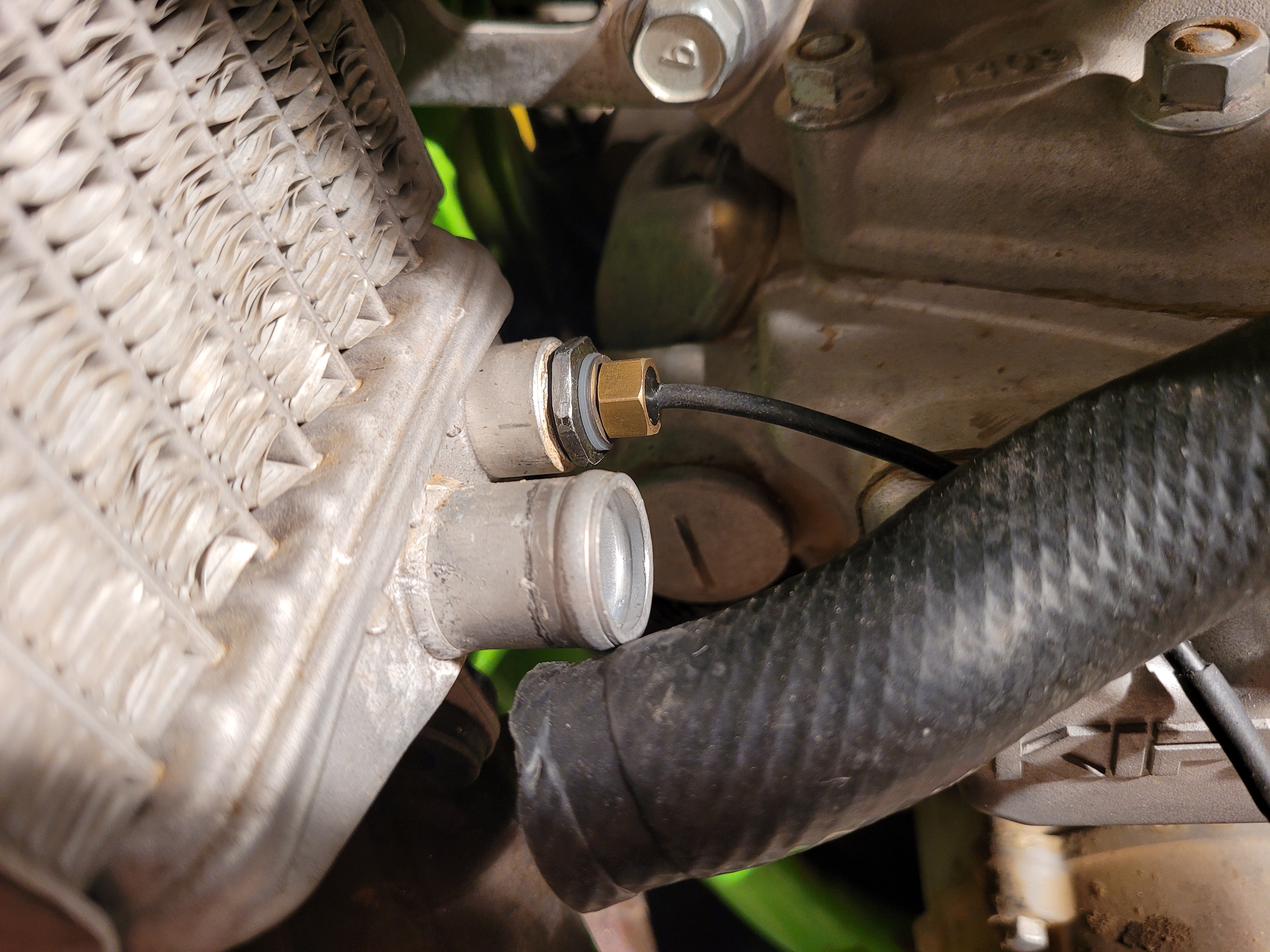

Photo 3 shows the modified radiator drain plug installed. The plug was installed with ThreeBond 1184 (gray) liquid gasket on the threads. A minimal amount was used to assure excess did not get into the radiator. You can use Yamabond, Hondabond, if you like.

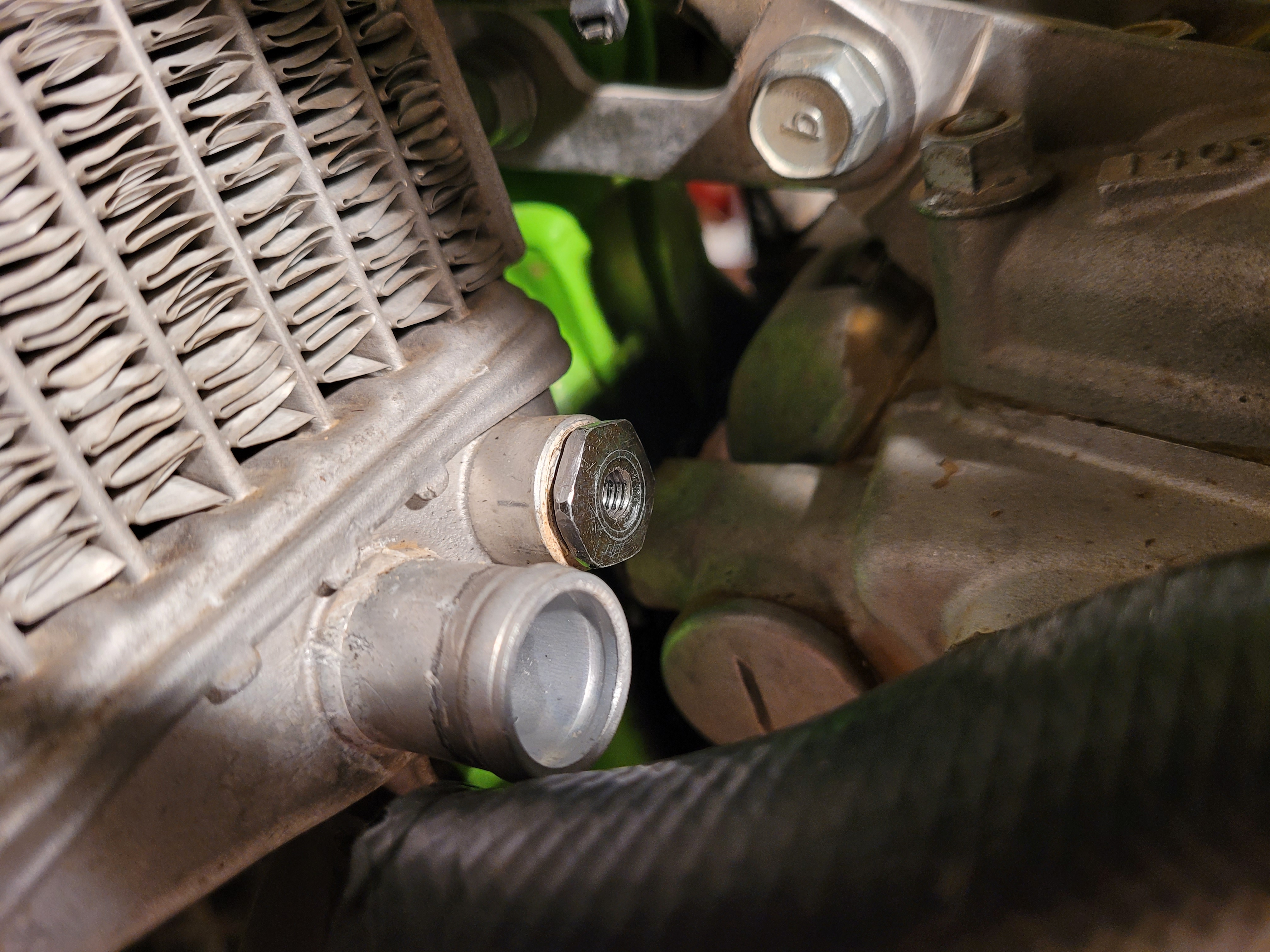

Photo 4 shows the thermocouple installed. The white nylon washer came with it. I placed a crush washer like those used for brake lines between the hex head and white nylon washer. Three bond 1184 was applied onto the thermocouple threads prior to install. It is necessary to not overtighten the thermocouple because too much force will break it. I went with “just enough” knowing it would be leak tested at temperature. If it is necessary to drain the cooling system from the bottom of the left radiator then I will simply remove the 19mm black tubing. Benefit: draining will be much faster than from the sacrificed radiator drain plug.
