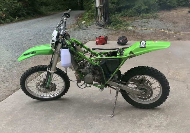

Jelly in the bowl. Fired back up 2nd kick.
Back on the path to recovery.
I bought one of those mini tanks to hang on bars. Cost way more than it should but sure is handy when the bike is in many pieces!
