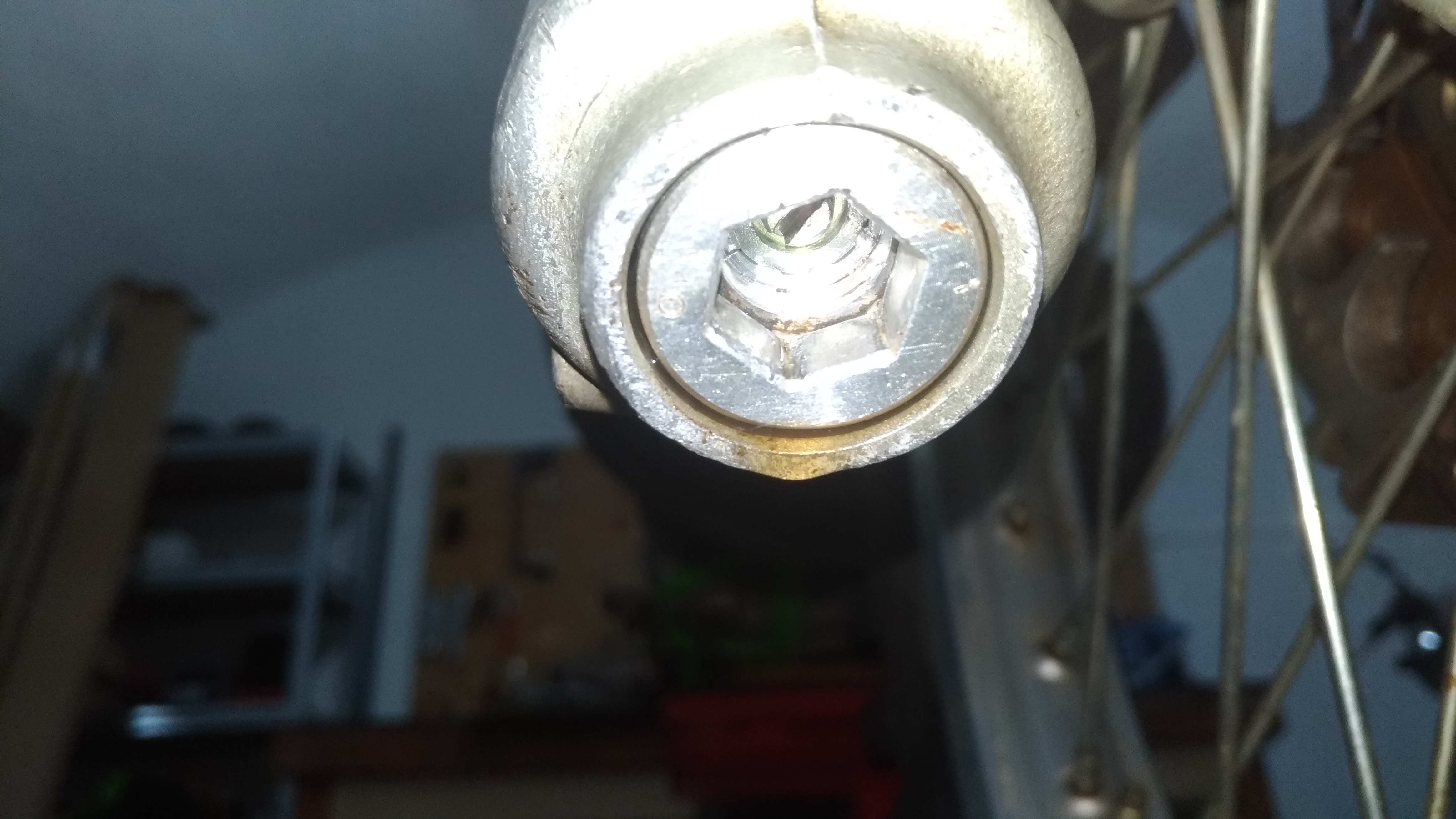

Re: Fork leak at compression adjusting screw
Here is a picture
- P_20210906_205042.jpg (3.16 MiB) Viewed 4617 times
- Posts: 14643
I would disassemble it and check it out. Did someone have it apart before? There is a torque listing for it. Holding the cartridge still while it is tightened is required.

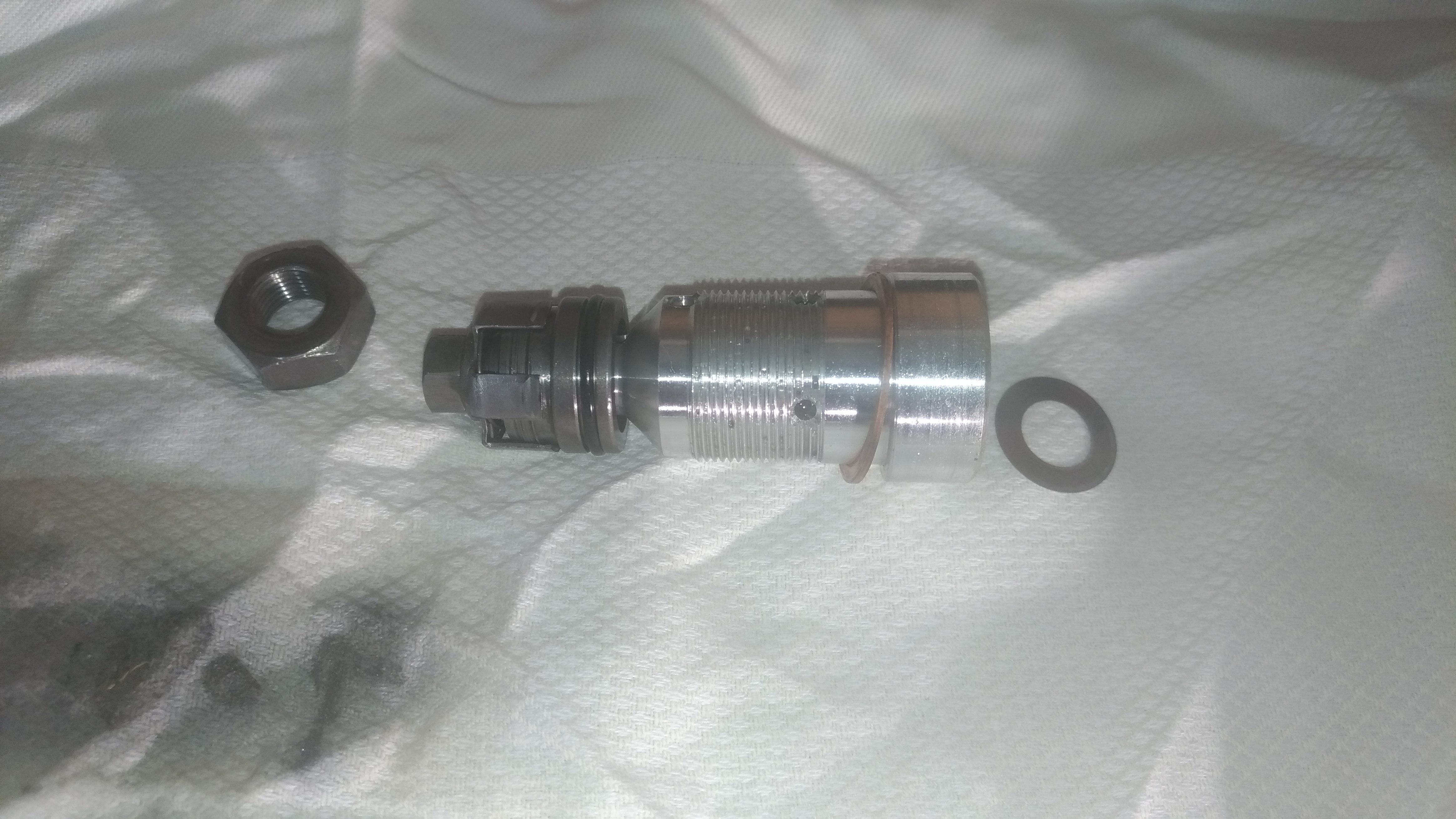

Here is a pic of the lower valve and gasket. Also the removed shim.
- P_20210912_230541.jpg (3.15 MiB) Viewed 4485 times
- Posts: 14643
With the front end off the ground (bike on a work stand), lightly turn the bars from side to side. You will get a feel for too loose and too tight.
The forks just have one o-ring on the base valve and the copper gasket. I assume someone did not tighten it to the proper torque and/or did not change the gasket.
