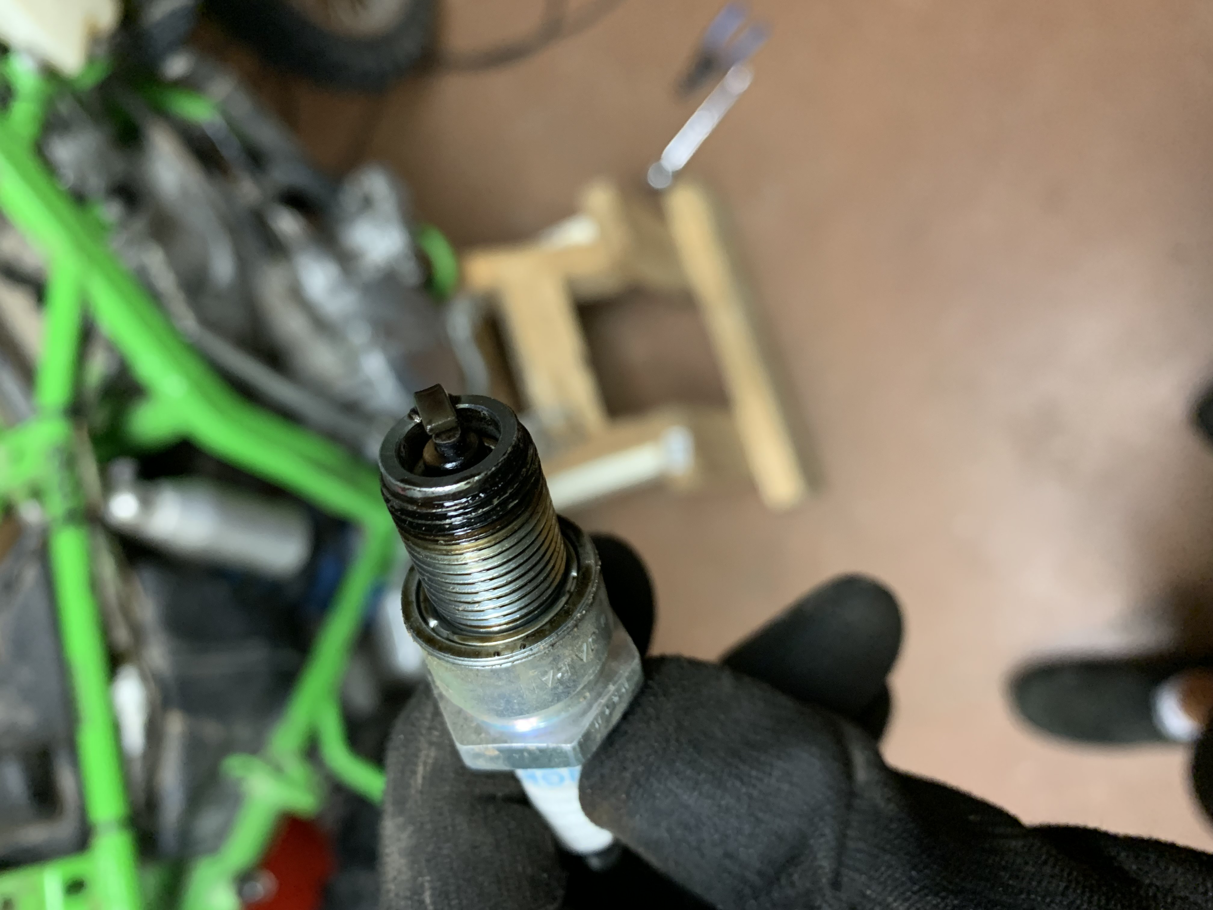

It's difficult to tell from that plug but the electrode part of it looks light brown to me? indicating the jetting might not be too bad and all that gunk might just be years of build up and no servicing of the PV.

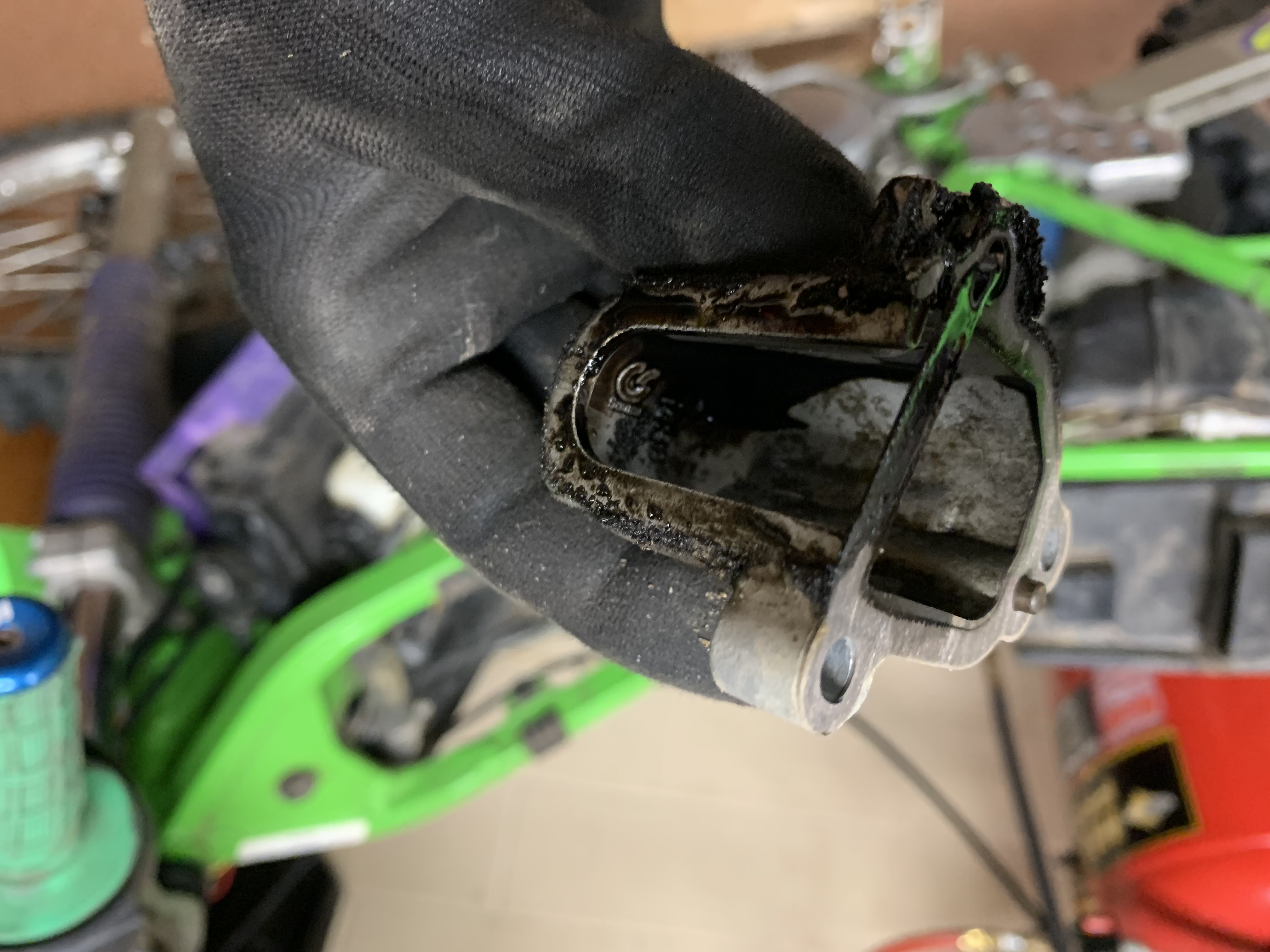

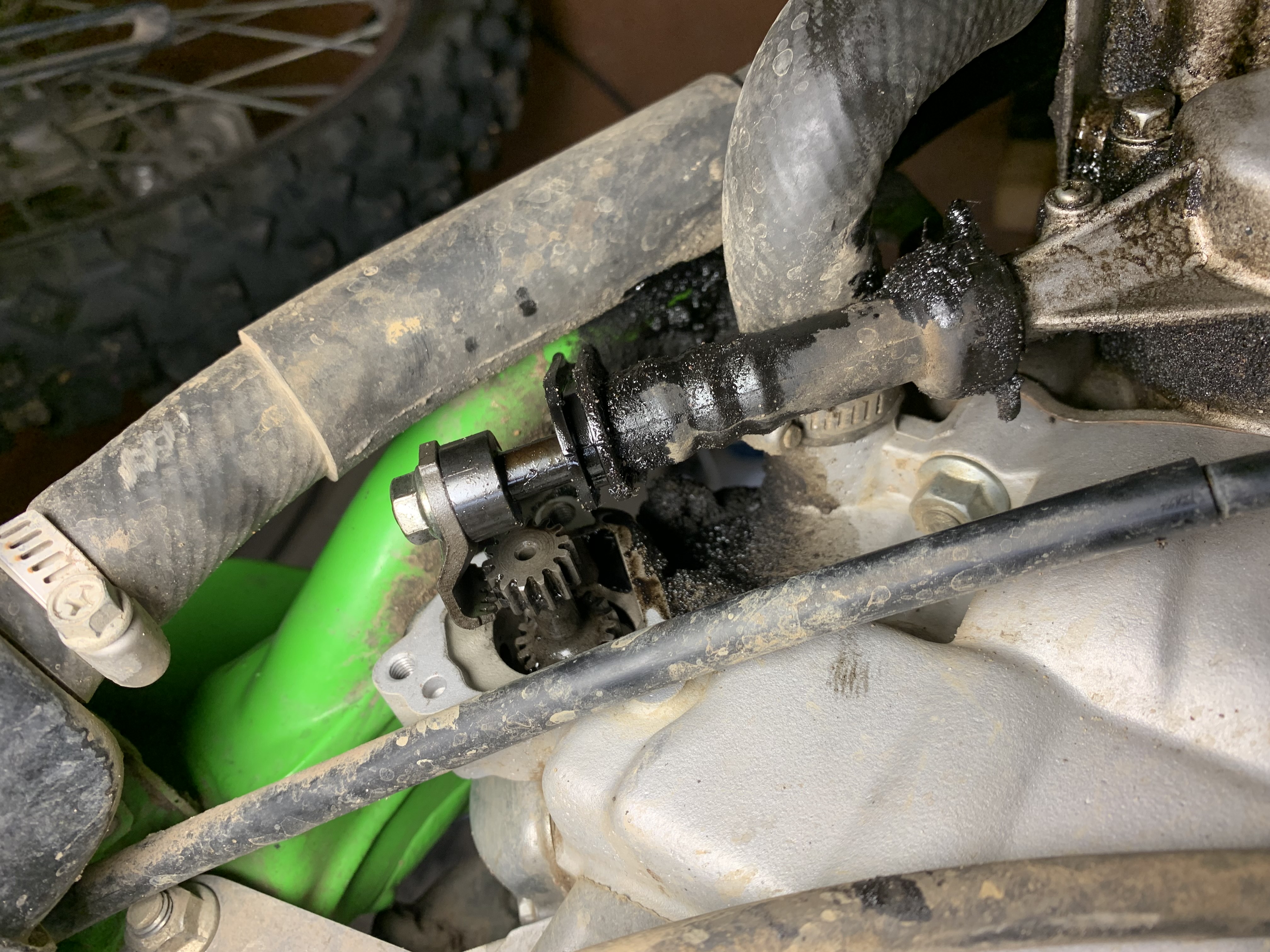

2. PV clean. given its age, if it hasn't been serviced in awhile it's well likely the PV system is really full of carbon and needs a good clean. i'd say thats the case with your bike.

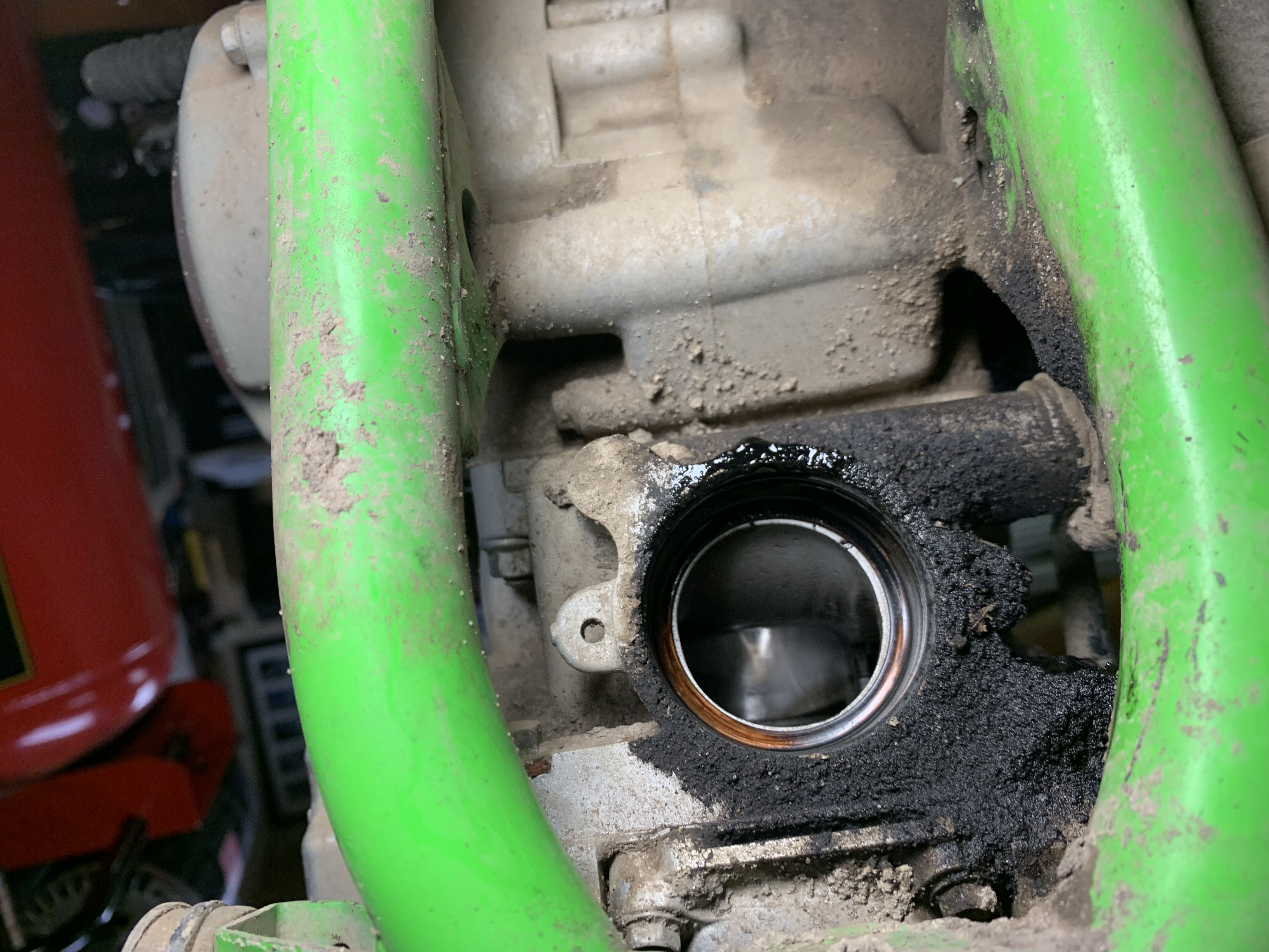

3. Excessive spooge leaking like that is often due to leaky o-rings at pipe/cylinder. If that carbon/gum was inside of the PV cover then you may have leaking PV seals and you should replace those. on each side of the PV shaft there is a seal pressed into the cylinder.

People advocate for plug chops but if you dont have capacity to do it, like a lot of people, there are some pretty good ballpark jetting figures available online that you can use. provided you adjust slightly for any altitude difference you should get jetting within a reasonable range. i really dont think a plug chop is necessary to get a decent base line level of jetting.

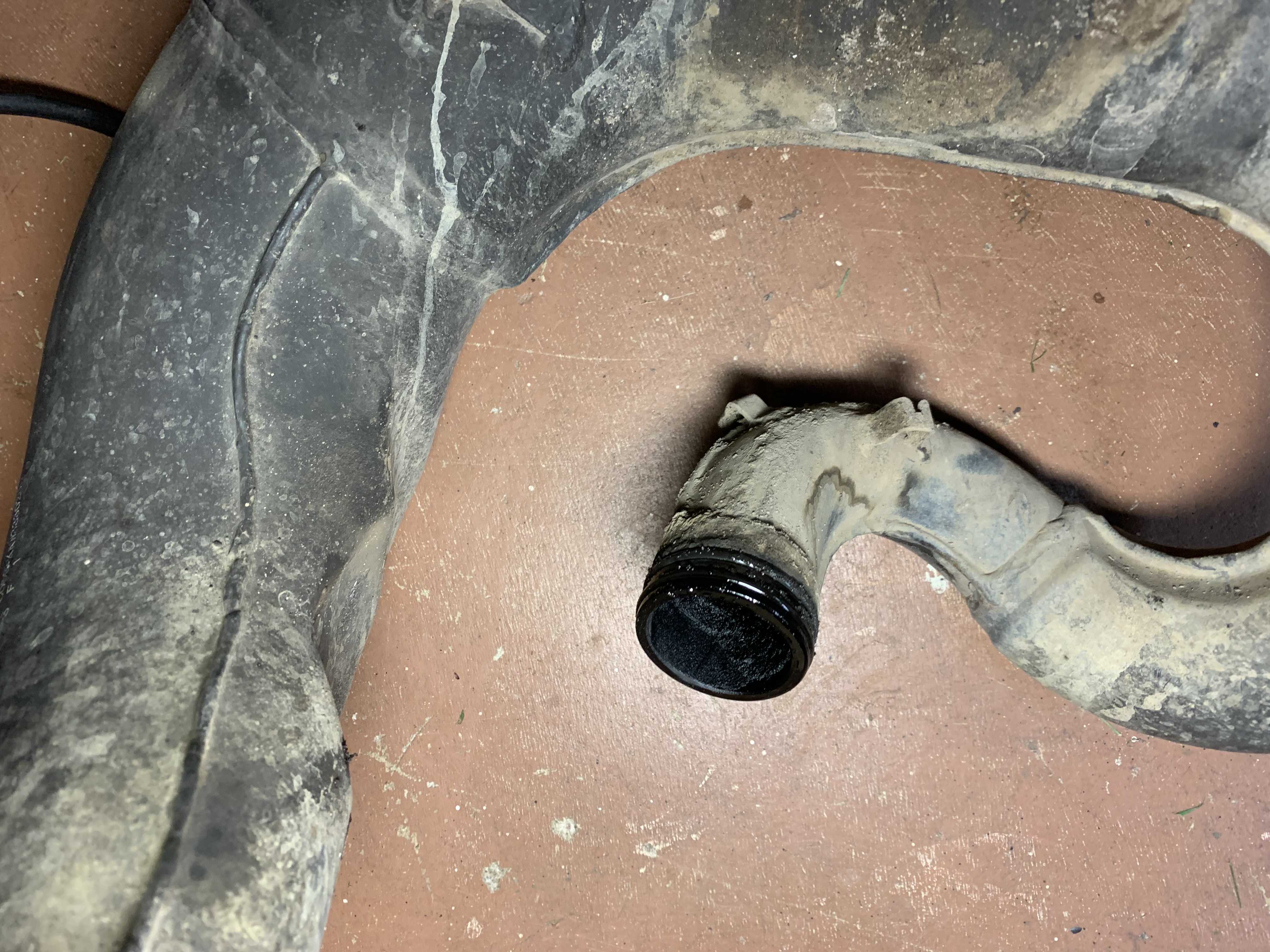

Looks like a typical KDX run at 32:1 and not cleaned regularly. Probably got it dripping from the pipe/silencer junction and from the end of the silencer. Needs a good cleaning, new plug, and go ride.

- definitely need to clean out the silencer / expansion chamber, so I'll give those a good cleaning while I have everything else apart... the manual says to pull the drain plug on the silencer with the engine running so I'll give that a shot when I get it back together too.

If you pull that drain plug, have a rag under it, you will paint everything black if you don't

Ha thanks Buff, I'm going the long route. Decided to just rip it all apart so I can give everything a proper cleaning. Piston, Cylinder, all look like they're in great shape, so at this point it's a spooge clean up.
Going to order gaskets, etc, clean out the pipe and silencer, replace some seals while I have it all apart and then put it back together.
Does anyone have a method to get the KIPS shaft out w/o pulling the cylinder jug? Just wondering if I can skip wrecking 1 gasket while I'm at it. Part of me wants to just check the piston rings anyway, but based on the condition of the bore it's all fine.
