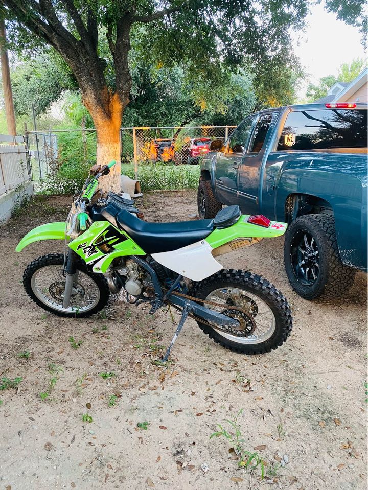

that only picture he have
Re: i found a 2004 kdx220 with title for 1800 is a must buy ?
From just looking at the picture, if I were in the market for one, I would go look at that one.
The frame, swingarm and kickstand have been repainted, but it seems in good appearance. No telling on the motor, suspension, etc.
Posts: 6054
Hmm, yeah, frame and swingarm has been painted and possibly (I hope not!) the fuel tank. Of course, if it runs good and and everything checks out, those things can be fixed or changed if so desired. Being a 220 I would want to know that the piston has been changed (with receipts!) and, if not, add in the cost of a top end, even a possible replate, in to your buying decision.

My 2004 has a black tank and it has not been painted.
Posts: 6054
NickP1969 wrote: 07:56 pm Aug 20 2021 My 2004 has a black tank and it has not been painted.
I'm just not used to seeing them. Most I see are green or purple.

FWIW, there are 3 KDX 200s on CL in my area - 1 is asking $2,600 and the other 2 are asking $3k. If it's in good condition and piston replaced, I think it's a decent deal at $1,800, and you might be able to get it for less. It looks good, but It's hard to tell from only one pic.

i wouldn't have hesitated. Love KDX220 and pay more than this in western USA for them in poorer condition. I like to pull the head right away and if not a forged piston like Wossner (preferred) or Wiseco will: 1) send cylinder to Millennium for replating, and 2) install new forged piston. It doesn't cost that much and better assures engine integrity.
I see good tires and performance pipe in photo!

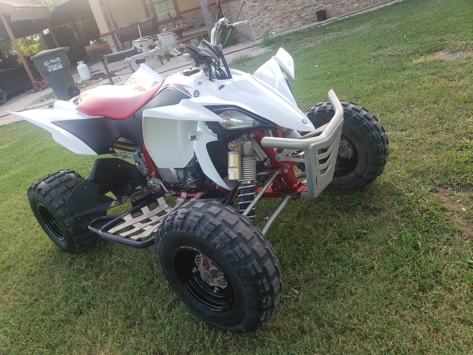

i try my best to buy it but the guy deleted his post he stop messaging me he was like 5min away from me sadface but i bought a yamaha yfz450R for 2800
