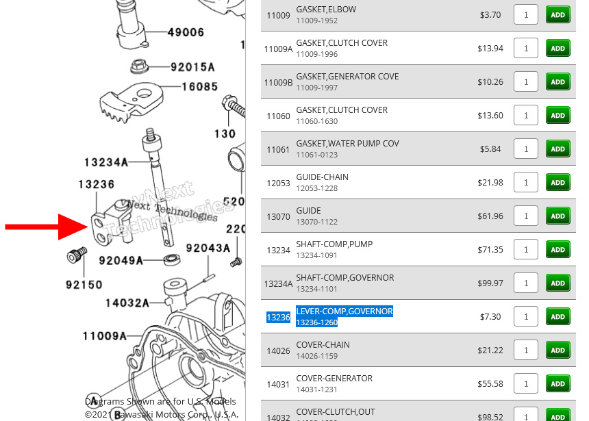

Well, on the KIPS it's bad news. By not supporting the KIPS shaft (detailed in the service manual) you bent or broke the KIPS pin that engages the KIPS governor and must be replaced. It is located within the outer clutch cover so you need to remove the complete inner/outer clutch cover, locate the broken pin/pieces and remove it/them, and replace with a new pin, and reassemble following the procedures in the service manual.
Re: Actuator shaft alignment and cylinder wear
yep, you broke it

thanks guys appreciate the parts breakdown - looks like I'm in for job. Is there a good thread on here about how to fix that? i dont have a service manual and they are very hard to come by here as must be shipped ex japan and it takes forever during covid. I had been using cyclepedia when i did the rebuild but my subscription has lapsed.
