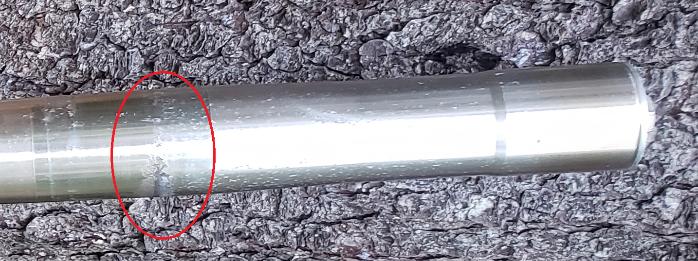

Can you post a pic of the fork leg where it was mounted? That makes me wonder if it is cracked or aluminum damage.
(last pic, about a foot down)

These pics are all of brake side. The last 2 pics are the same view of the upper and lower portions of the leg in the same orientation as the pic you questioned. I think you may have seen a piece of grass as they have yet to be cleaned as im on vacation. The first pic would be the overall view but 180 degree orientation to the first 2 pics. I hope this makes sense. I thought the finish looked good for the year. A worry I have is investing in the wrong year triple clamps and not having it fit so thank you for the info regarding years.

Looks like corrosion but this may have become a learning experience for me. Your thoughts?

That's some pretty serious corrosion damage. IIWM I'd be a bit leery about running that fork leg.

That is damaged and dangerous in my opinion. Do you have a link to the listing?

I think the pics look worse than in person but its obvious I should move on. Here is a screenshot I have
