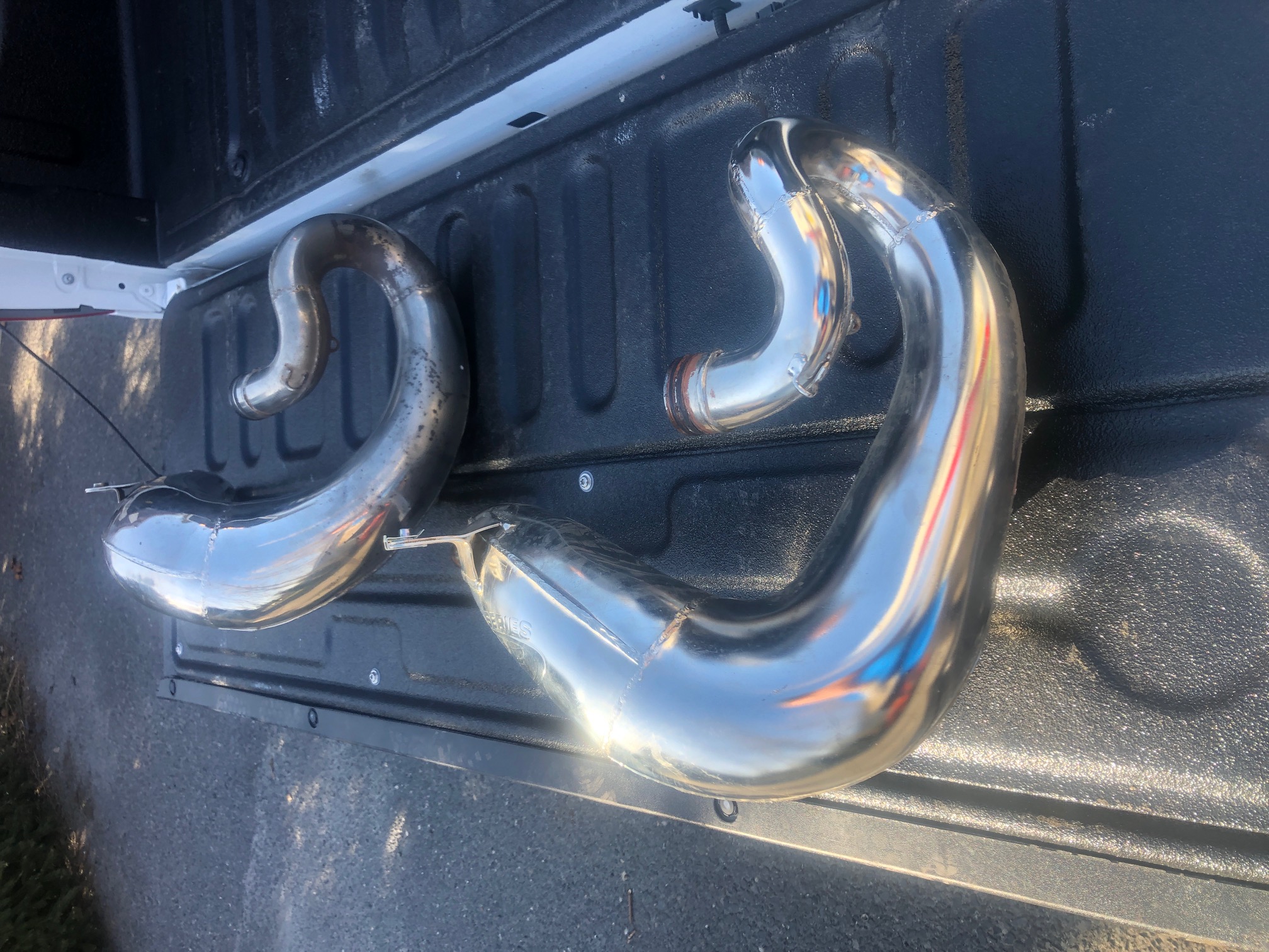

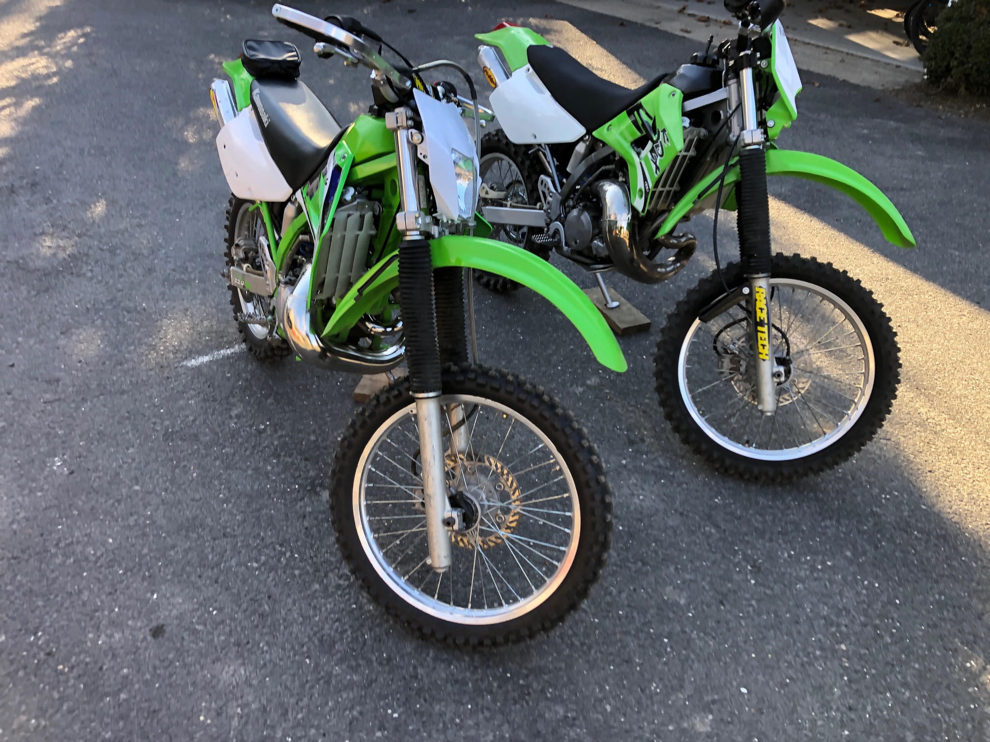

With regard to the FMF pipes, I had the same issue a while back. I was not sure which pipe was which.. There is a model number on the pipes that will tell which it is.. Here are pics of the two pipes on two bikes. The bike on the left has the woods pipe, its shape flattens out on the bottom. the bike on the right had the rev pipe on it. The pipe on the bottom of the tailgate is the woods. At least that is what I remember.. I run the woods on my 200 and probably should run the rev on the 220 but I am too lazy to change it out. Hope this helps.![Image]()

Pipe is definitely the Woods pipe. Thank you Architect!

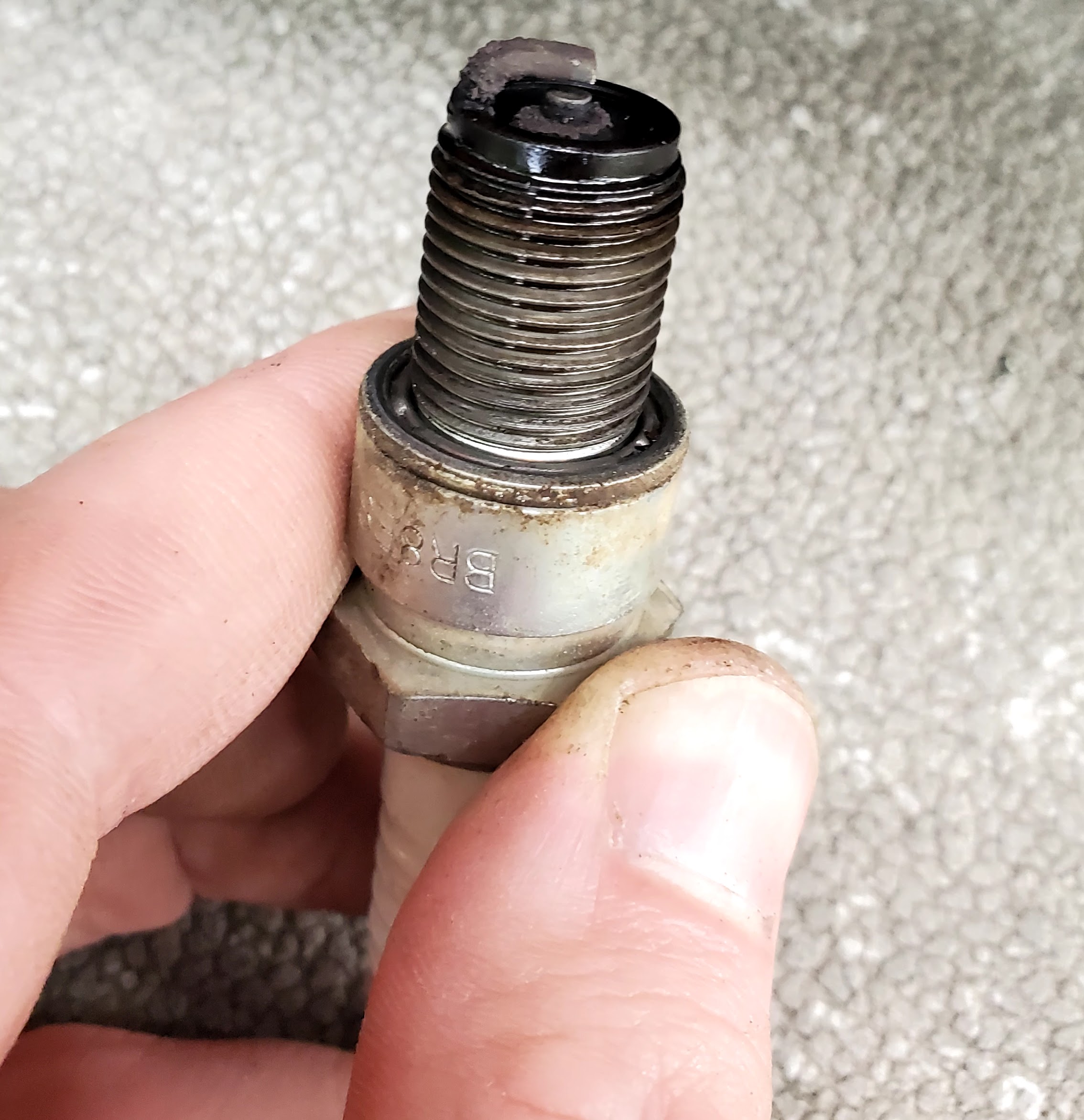

Results!
I did the compression test today; with a cold bike I got 175 PSI. According to my repair manual, the bike should be 90-150. Any guesses on what the high pressure reading could mean?
I think the spark plug is a bit past the time when I should have replaced it...

What is the goop on the electrodes?

looks like carbon build-up, I noticed on the last ride that there was more gunk coming out of the muffler. I think the bike might be too rich after the carb rebuild.

I totally disassembled the carb, soaked it, rinsed it, then rebuilt the carb including the jet block gasket. That plug probably isn't a great indicator of health when it's the only one I've put in the bike since buying it.
