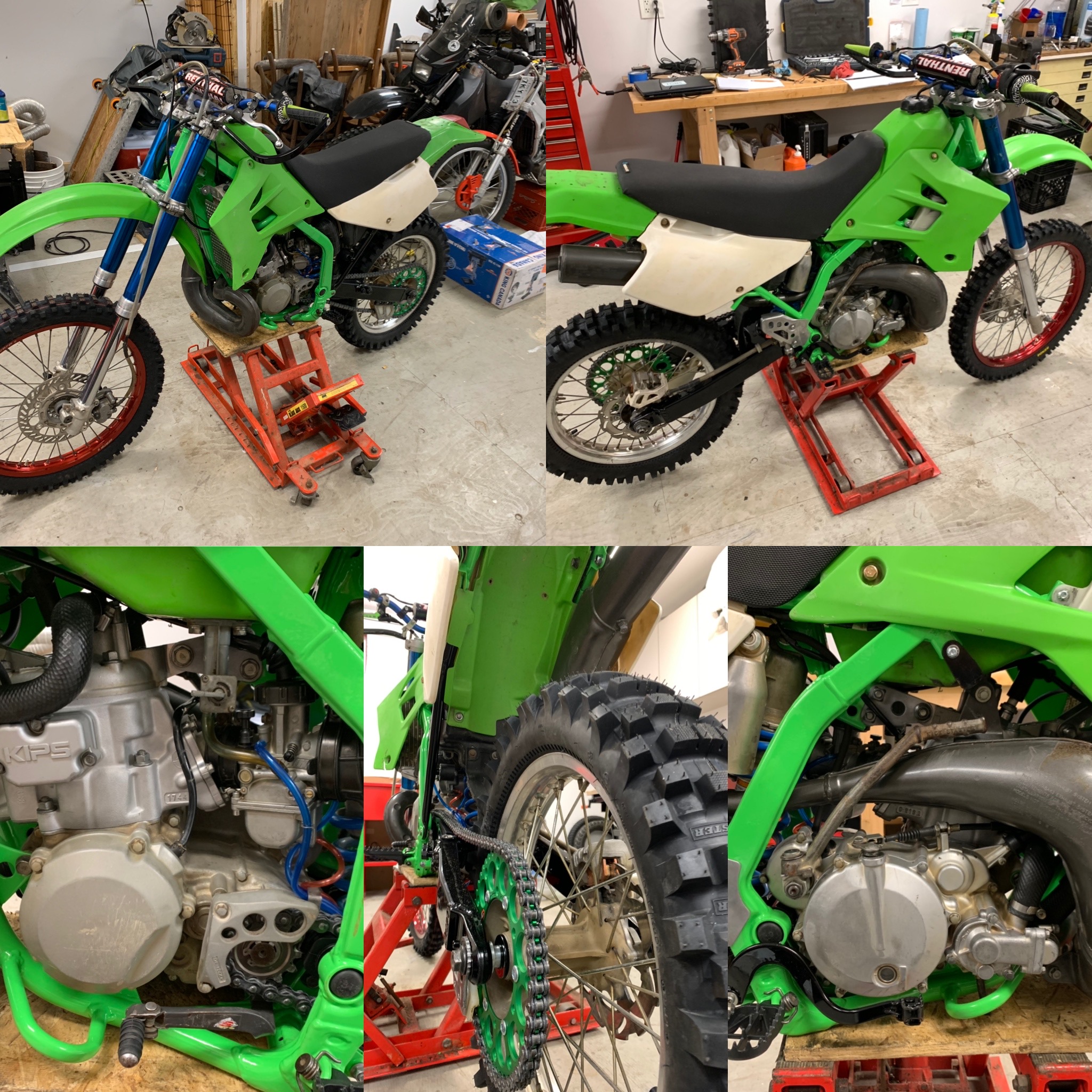

I’m about due for some new fork oil, so I’ll pull my springs and see what I’m starting with. You’ve given me a lot to read up on! It’s appreciated.
Em
Em

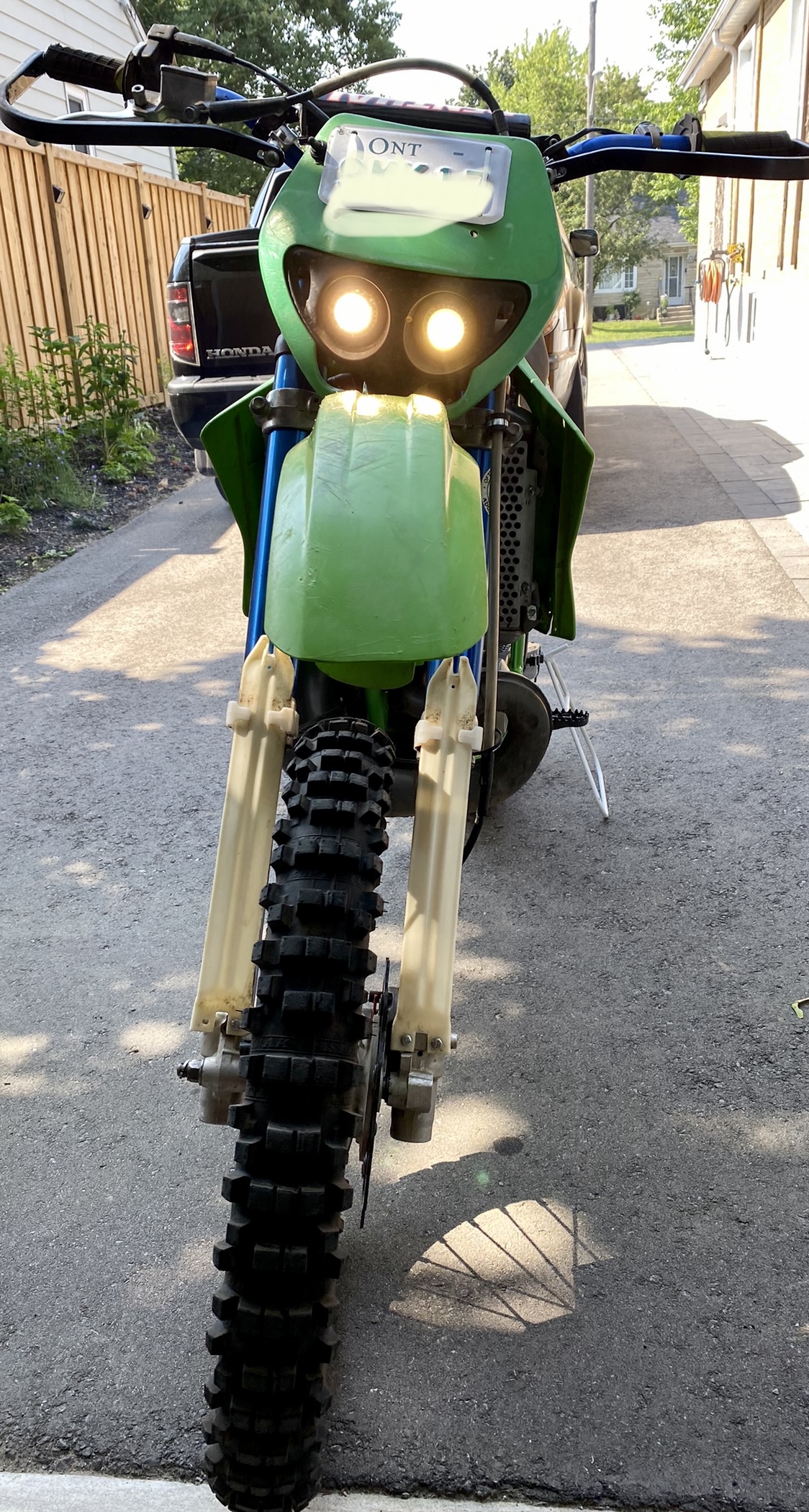

Re: 5.2 Spring - Holy Weaponry, Batman
I do, that’s just after I put her back together two years ago.. I hadn’t yet figured out where the forks were from.
