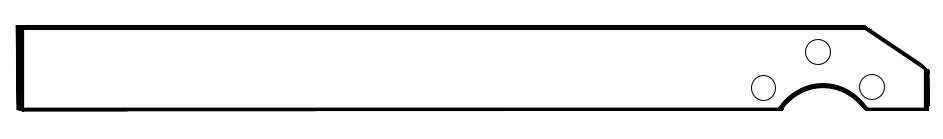

yes but how do you stop the drum rotating when you try to undo the 12 mm bolt.

I made a special tool for it. I just used a flat piece of steel and drilled three holes to go over the pins on one side. Then I ground a groove out of the side of it so the socket could get on the bolt. Worked perfectly. I can't remember what the diameter of the pins or the spacing are but it doesn't have to be perfect. Looked almost exactly like this...
DIY shift drum tool KDX.jpg (21.62 KiB) Viewed 1917 times

great advise on the tool ,i will make one up on my mill .
