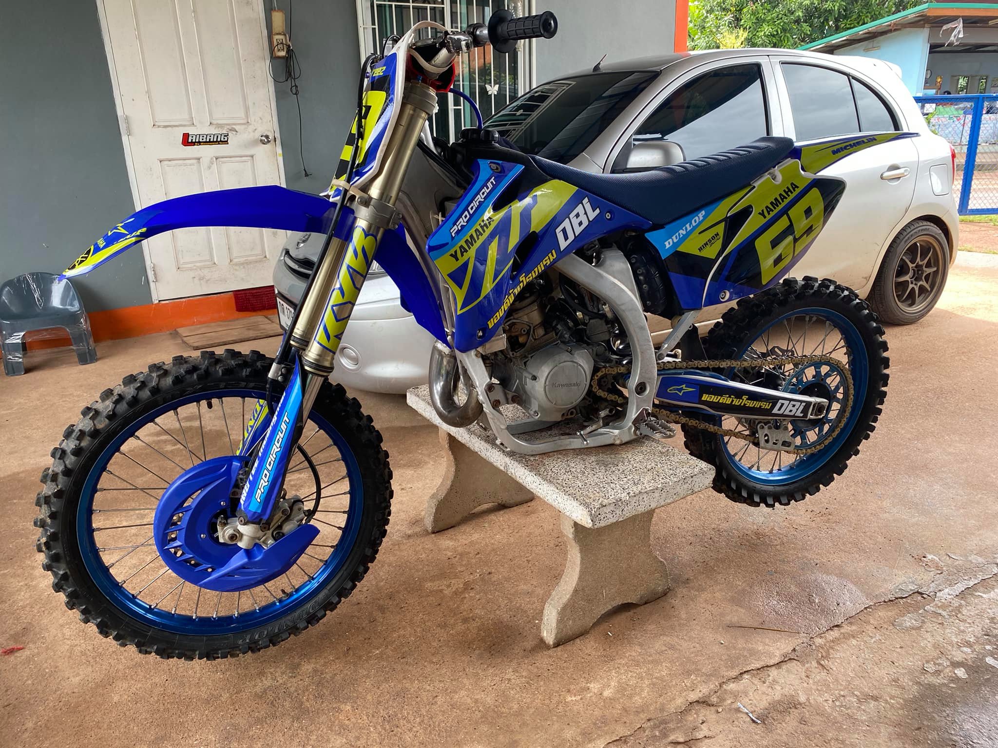

This is the KR engine in a 09 YZF chassis. The seller wants $2,000.
KR YZ.jpg (550.79 KiB) Viewed 34596 times
The racing block for this bike gives it a bore and stroke of 68mm x 54.4mm, the KDX200 is 66.0 x 58.0. Does anyone have an idea if the power would be similar or could be made to be similar? I know nothing about engines and porting. It's very difficult to get accurate info here.

Re: KR150cc Kawa 2 Stroke
That little KR engine sounds like it's ready to go to the Gran Prix. I think it's safe to safe the two engines are completely different in their power band.
