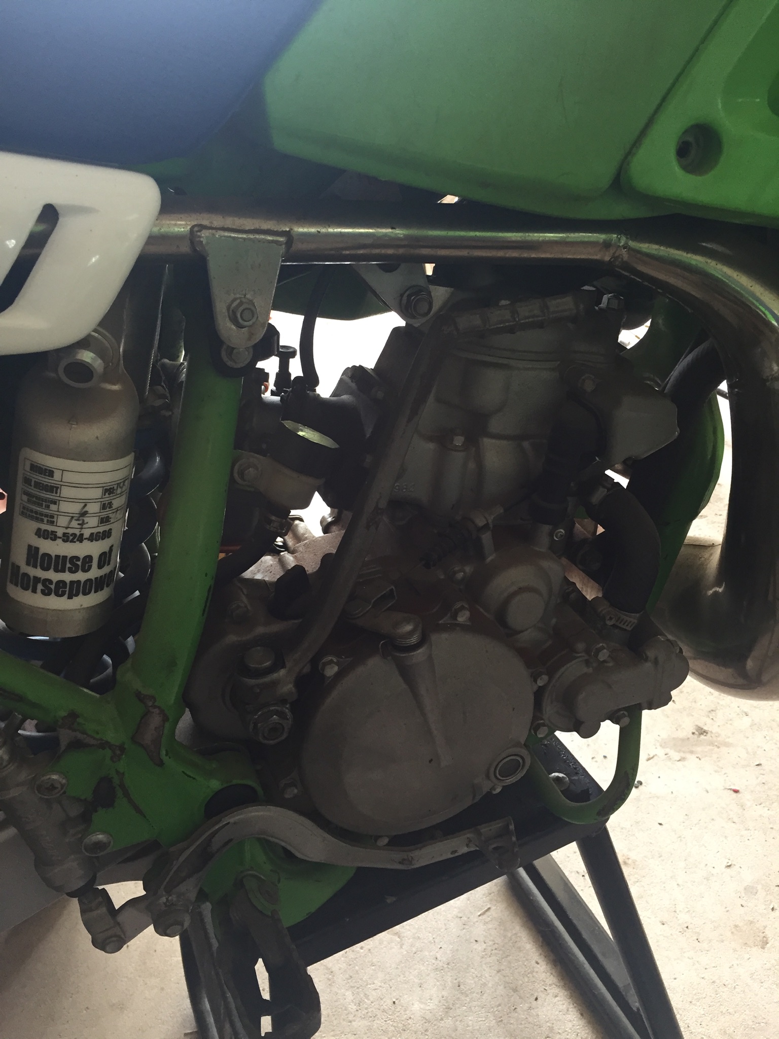

Had a previous post breaking my actuator and finally was able to get a replacement however; I can't for the life of me figure out how to get the darn clutch cover back on and get the actuator in the correct position to let me do so. By looking at the clutch diagram it seems when it's on the little inlet notch at the bottom should be facing the bike but my clutch cover will not go back on. This is how I broke it last time and it's a miracle I was able to find a new one. I've tightened the clutch spring bolts to spec and the push pin is in place with one washer.
It seems this is the correct position but it will not sit flush against the case. I messed with it for a good hour or two playing with the actuator and finagling with the case cover to get it to sit flush but nothing. It just won't go on.
Everytime I install It always seems to go to this position and it's the only way I can seem to get the case over back on. If I try to pull it towards the engine when I've bolted it on to connect it to the clutch cable it gets super tight and I feel like I'm going to break it...I don't know if I should keep pulling it..until it goes into place?
I believe this is the correct position below when installing and when the actuator is on the bike..correct?
I feel this shouldn't be this hard! Any ideas on how to get this darn thing back on??

Here’s a pic that I had available that shows the orientation of the arm and the spring. Let me know if you need a better pic.

Re: Can't seem to get clutch cover on with actuator
Post by John_S »
The way you have it installed without the cable looks correct. At about the 8:00 position. From there it should swivel freely to about the 10-11:00 position. Loosen the clutch cable at the adjustment barrel and the perch or like KDX said remove the cable from the perch. Then connect it to the release arm, at the perch, and adjust the cable as needed.
If after bolting it on it won’t swing freely from that second pictures position then don’t force it. Something else is going on.
