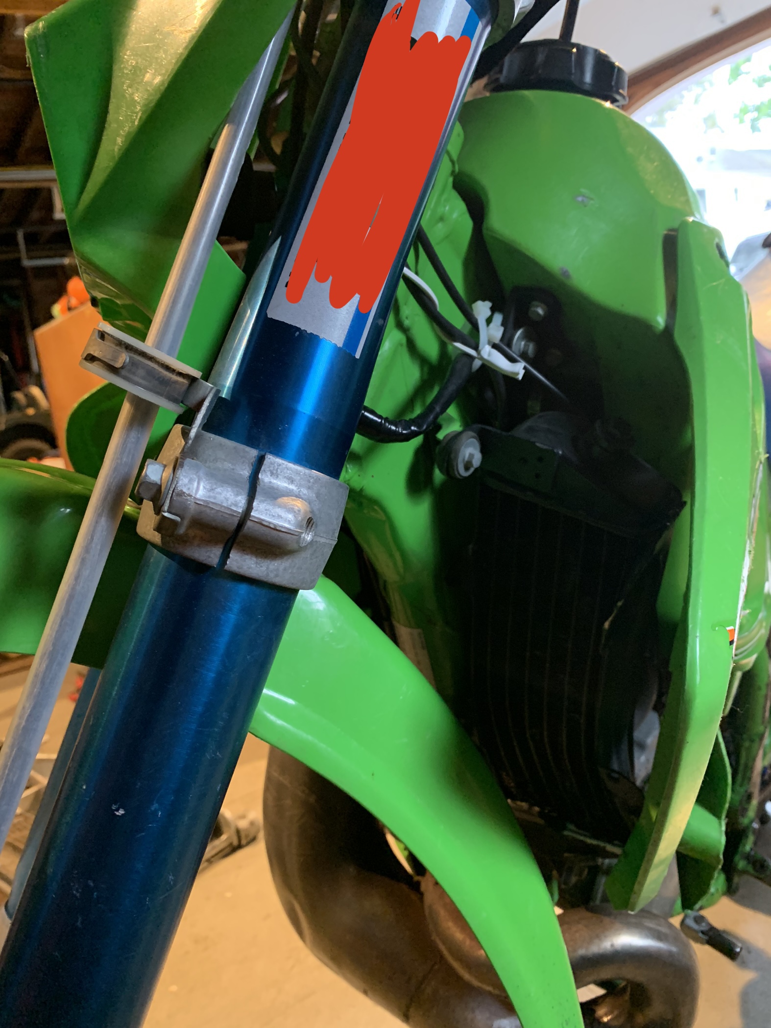

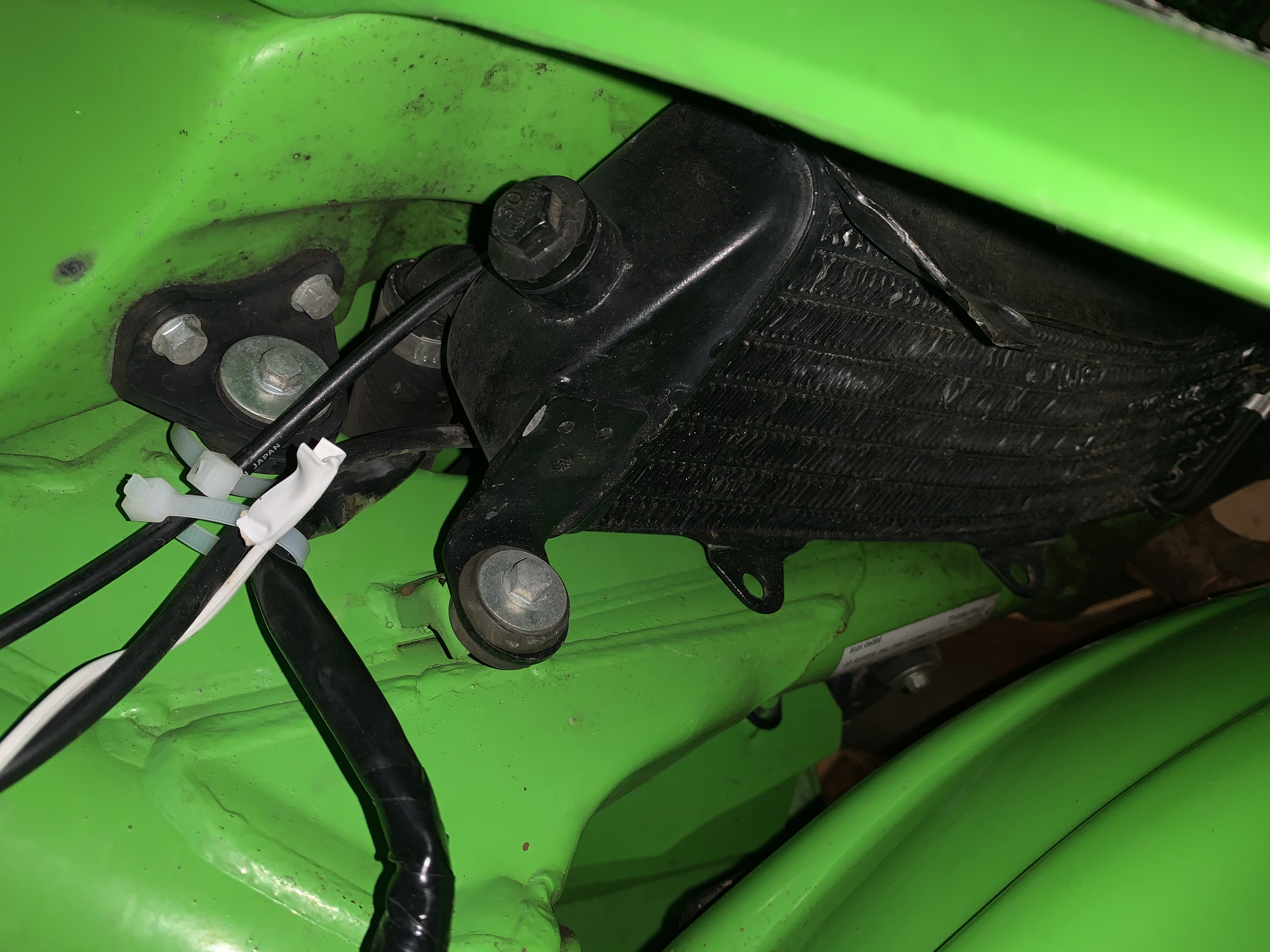

Radiator:

You definitely need a radiator. Are you sure you aren’t just hearing the radiator banging against the frame while you’re riding? Stick a piece of rubber between the radiator and the frame and see if the noise stops. Is the radiator mounting tab broken off the frame?

A bigger problem is the crack in your triple clamp. This bike took a very awkward hit.

Goofaroo wrote: 02:00 pm May 30 2021 You definitely need a radiator. Are you sure you aren’t just hearing the radiator banging against the frame while you’re riding? Stick a piece of rubber between the radiator and the frame and see if the noise stops. Is the radiator mounting tab broken off the frame?
rad is solid and does not move or rattle. I do plan on replacing it, but i am 100% sure that is not the noise. mounting tab is not broken either. and theres at least 1/4" between rad and frame and i cant make it touch the frame or even wiggle by pushing on it.

Goofaroo wrote: 02:11 pm May 30 2021 A bigger problem is the crack in your triple clamp. This bike took a very awkward hit.
haha you had me worried for a second because that photo makes it look like a crack. but nope, thats just the clamp. My theory is the bike fell over onto a rock/sharp edge at a stop, and the rider weight added to the impact.
heres the clamp so you can see it.
