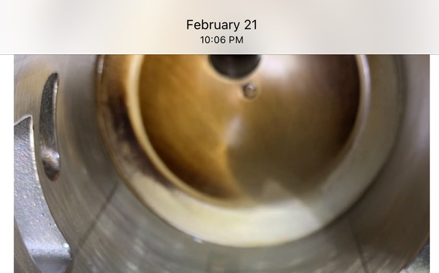

The 220 head has a distinct dimple in the dome, both heads are marked 1409
- Posts: 51
- Joined: 06:54 pm Dec 24 2019
Re: 200 vs 220 head?
220 head
- 220 head
- 4DD045B9-A6A1-45D6-A896-9D2AD9255E2C.jpeg (48.02 KiB) Viewed 2051 times
